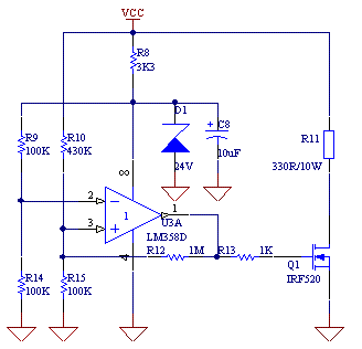

another method is to use a zenner voltage limit circuit similar with a crowbar, but instead shorting the voltage, will connect the power resistor in the circuit. i will explain how to do this if there are peoples interested. also, i can explain how to measure the maximum transient voltage with just a multimeter and few components.
Cristi - could you please share with us on how to measure the maximum transient voltage with just a multimeter and few components?

to measure the maximum voltage you need an electrolytic capacitor, few uF to 100uF, one fast rectifier diode rated at at least 1A and 100V and one high input impedance multimeter (>1MR). most of the new digital multimeters are good for this, except the 5$ ones. conenct the capacitor with - pin to GND and the diode between the V+ and positive lead of the capacitor, with anode at the SMPS and cathode to the postive lead of the cap.
start the smps, wait for a while and after measure the voltage on the cap. this will be = max. voltage - diode drop.
the crowbar circuit which i mentioned before, can be used to prevent the voltage to rise to dangerous values. to prevent the on/off oscillation, i added one resistor between output and non-inverting input which will add a small hysteresis. for 60V maximum voltage rails, this resistor values shold be used. for different values, can be recalculated. note that R12 will determine the hysteresis range and R10 the tripping voltage. the resistor R11 must be power resistor with the value in range of 220 to 470R at at least 10-15W. the transistor should be an ussual N-channel MOS-FET, 100V and >5A.
