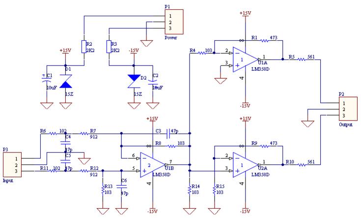

how to wire TA3020 out of phase
One solution to the pumping issue it to use large power supply capacitors to absorb the pumped
supply current without significant voltage boost. The low-frequency pole used at the input to the
amplifier determines the value of the capacitor required. This works for AC signals only.
A no-cost solution to the pumping problem uses the fact that music has low frequency information
that is correlated in both channels (it is in phase). This information can be used to eliminate boost by
putting the two channels of a TA3020 amplifier out of phase with each other. This works because
each channel is pumping out of phase with the other, and the net effect is a cancellation of pumping
currents in the power supply. The phase of the audio signals needs to be corrected by connecting
one of the speakers in the opposite polarity as the other channel.

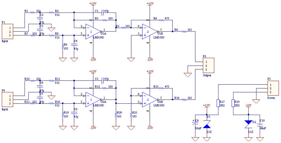

Cristi - how do I wire TA3020 out of phase with your TA3020 module? Please advice.
180* shifter
for TA3020 amplifier and not only, to prevent the supply rails to experience bus-pumping phenomenon, one simple sollution is to drive the L and R channels with 180* shifted audio signal. one of the loudspeakers, from the channel which use inverted signal must be inverted the polarity too. another advantage is that the amplifier can beused directly in BTL mode.
i will attach 2 schematics, one for mono, balanced input, which drives both channels in BTL mode, and one for stereo, also balanced input. if you don't want to use balanced input, just connect the inverting input to GND and use only the non-inverting one. the gain of this stage is given by the resistor between output and inverted input of the op-amp and the res. to gnd. easy to calculate, i don't insist on this aspect. for best performance, the OP amp must be low-noise one, NE5532 or OPA....
for mono BTL, and balanced input, the cheapest and most siplest sollution is to drive the amp directely, one channel with inverted signal. one with non-inverted.
