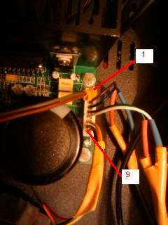

Finally manage to connect everything, but I still have issues testing the amp (TA2022). What happens :
- the two leds are on => means mute is on if I understood well
- the speakers make a small ploc when putting the amp on
- after that, no sound at all comes out of the speakers :-(
I'm pretty sure of my connections, except for one point : on the input connector, which one is 1 and which one is 9. Could you confirm with this picture ?

for the TA2022 amplifier pin 1 is the square one, so like in your picture. i cannot see where the wires go.
one important thing which you need to check, i wrote about in the manual also. the amplifier will enter in mute mode when the supply voltage is either lower or higher than the normal range, +-25 to +-33V. measure the voltage values of both rails. also measure the output DC offset without load. it should be lower than 10mV. i adjusted for all amplifiers before testin and shipping, but durring the installation is very possible to touch the variable resistors for DC offset cancellation and to alter the setting. an DC offset higher than 150-200mV with load connected will automatically lead to voltage pumping and amplifier mute. so, disconnect the load and turn on the amp. if this is the problem, the red led will not light after turn on and you will have a DC offset higher than previous mentioned value.
I have a theorically 2*22VAC transformer, actually the measured voltage is more around 2*23,5VAC . Should be no more than 32V DC, so I guess it's ok.
OK, that was the reason, but I'm afraid I have an offset much higher than 200mV, even with no load connected ... it's actually more than 2V !! Tried to turn the variable resistors, but obviously doesn't make a big difference ...
The problem is only for one output, the other is very near to 0mV, and I measured the offset directly on the board as well (with nothing connected) to be sure the problem didn't come from a connection mistake.
I'm afraid it's one problem solved for a bigger one leaved unexplained ... would you have a clue ?
try again to adjust the DC offset without load, with the multimeter connected at the output. turn the pot. slowly and see the changes. it should decrease or increase depending on the direction where you turn. another reason for having high DC offset is if you changed the input caps and the new ones have large leakeage current which create unballance at the input of the amp. also try to make a visual inspection of all soldering joints from the pcb. if one resistor from the feedback loop is desoldered, same result. on the backside of the board are 2 res. 000 value, check the continuity to gnd on both their sides. check the voltage on pins 28 and 29 and pins 30 and 31. should be about 2.4-2.6V the value is not very critical, but they must be equal. the difference between them will be amplificated and see at output as DC offset. you can imagine this amplifier as an OP amp and these are the inputs, inverted and non-inverted. the gain is given by the resistors from pins 22-23 and 25-26 and the resistors from feedback loop. so, check the differential voltage between pins 28-29 and 30-31. if you find more than few mV there you should start checking the reason.
