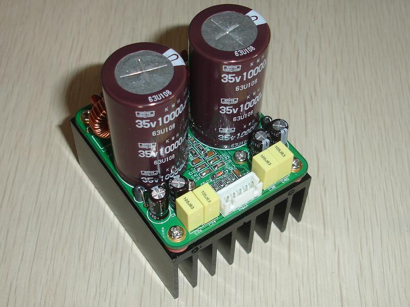

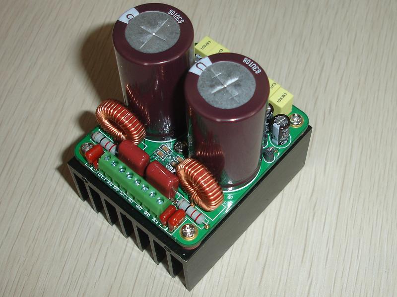

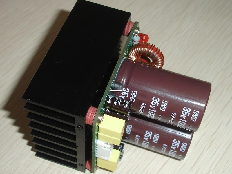

TDA892x v2 Module with heatsink pictures
i made some photos of the new TDA892x module, with the heatsink which is available as an option for this amplifier. the heatsink measures 58x30x70mm and has 2 threaded holes on each end for easier installation.
