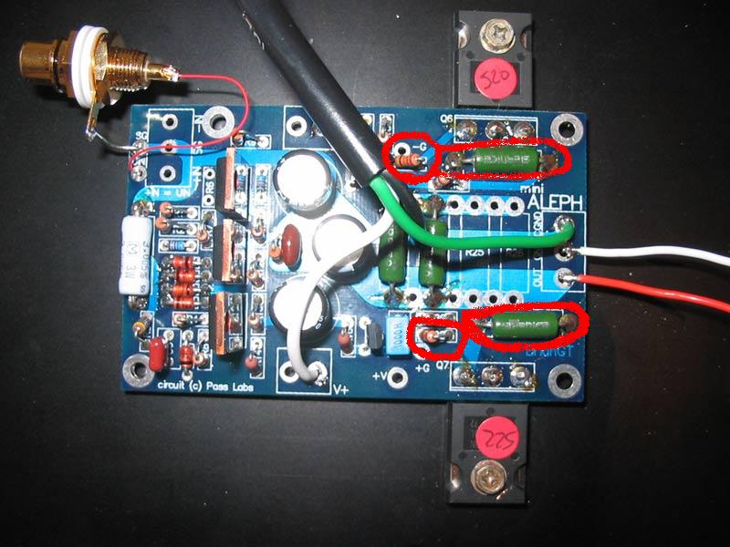

fcel said:Jason,
Your blue color cap for C5 is beginning to make me wonder too. What is the vendor name and part # for your C5 and C6?
Yours is correct according to Brian's Excel Spread sheet and the picture he took of his boards.
Also please note that there are differences in resistors between your and Jason's boards.
I will get the exact componet numbers and post them.
I wasn't aware that there are differences in resistors value between Jason's part list and Brians's part list - that is what you meant, right? In any case, I followed Brian's part list/number & it worked fine.

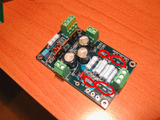

Let me clear my statements:
R17, 18, 19, 22, 27 and 28 are different in the 3 (three) instances of the pictures in post # 777 and 778 and the kit I was sent from Jason.
Also C5 and C6 are different between the two posts (#777, 778). This is an easy fix as I will go by Brian's Excel SS and the blue cap will go to C6. Which means I did not get either (one of is missing) C4 or C5 in my kit...
I completely understand the fact that Jason's is a Mini-A and Fcel's is an A30... But why the difference in main board components(R17, 18, 19, 22)?

I'll see if I can help a little.
From this spreadsheet http://www.diyamps.com/aleph/docs/miniALEPH-parts_list.xls there are actually two spreadsheet in one. One is for A30 and the other is for mini-A. The resistor values ARE different - for those resistors that you have listed. The value for C5 and C6 are the same though for both amp.
I'm probably making this more confusing or have misunderstood you but may be Jason has already clear it with you.
