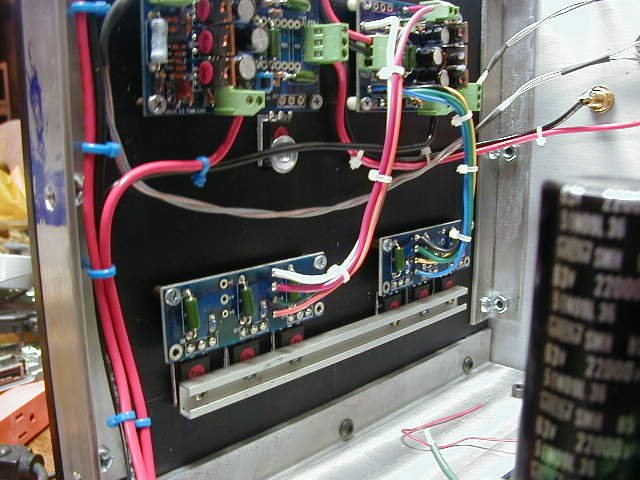

Looks sweet.. Good job. Hope you like them. My mini a's have now been running 1.5 months all day 24/7 no problems at all. Now to design and start building chassis 😀..

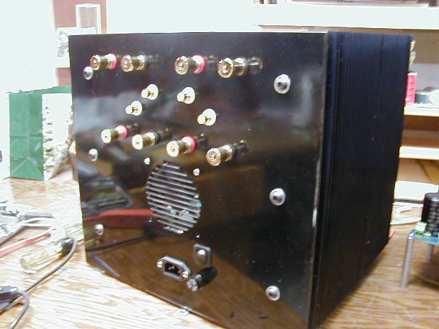

This is a moc-up of a pair of chassis i would like to build My fins on my heat sinks will be facing up and Down like yours chpco.

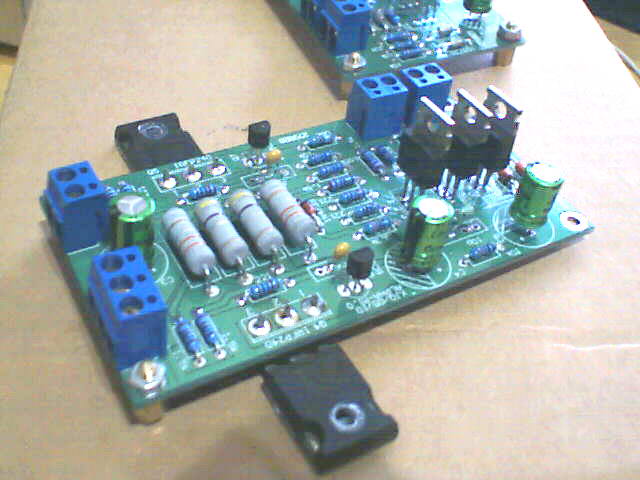

Nice amp, Chipco🙂 Thats a neat way of clamping down those output fets😉 Good work.So here's my project...

BTW those chassis must be an overclockers dream🙂 Heatsinks enough!

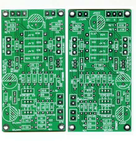

when i go away on holidays to Brian's house i'm going to be working on a new design all smd type mini a's. Since the mini a's are my fav and i like the smd version better i'm going to redesign the boards.

Yeah, I liked the simple look of the SMD Aleph layout that I made a while back. If Jason wants, I will work with him to revive and revise this layout. Would be getting rid of the SMD transistors, adding balanced capability, and possibly using through-hole caps instead.

Any more demand for the Mini-Aleph pcb set? I can still do another run of them if people want them.

I think there's a very big interest in the smd edition.
Balanced and through holes for better caps would be even more interesting.
I surtently am 😉
Ohh Yeah

Only a few modd's needed to this original layout is..
One the ztx transistors need to be not smd because they dont do well under a little bit of load thus why you see in my picture/ Brians picture they are soldered in place of the smd version.
