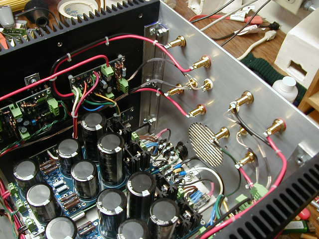

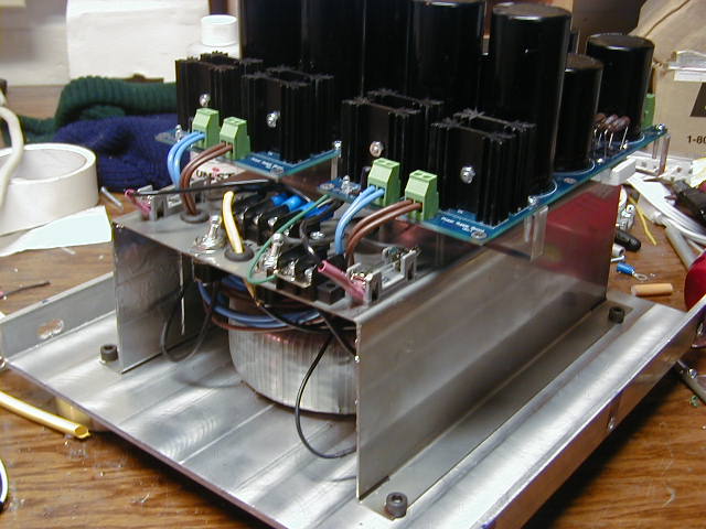

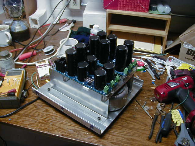

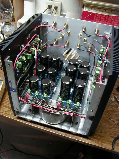

This is the bottom of chassis for my Mini/30 4 channel
Ya baby!

chipco3434 said:
Almost ready for the light bulb trick turn on...
need a bottle of courage.
Please don't connect a speaker or a input to the amp 🙂 it will help 🙂 Trust me 🙂 if you need any other help just post or email me..
Jason
To be honest i didn't even use a lightbuld bor variac 🙂 i just plugged it in with no load or input 🙂
HOLY COW!
It all came together tonight and it sounds GREAT.
Had a little speaker with Dayton Neo and four NSB's. I had been listening to it for a few days on the Aleph. Sounded like poo in full range no tweet and even worse with a cross.
I broke out the MOX active project I completed a year ago, all the time with the 4 channel Aleph in mind. 10 watt side to the tweet and the 40 on the midwoofs.
The results were UNBELIEVABLE. Fantastic clarity and control.
GO ACTIVE
GO "A"
Thanks for the help!
