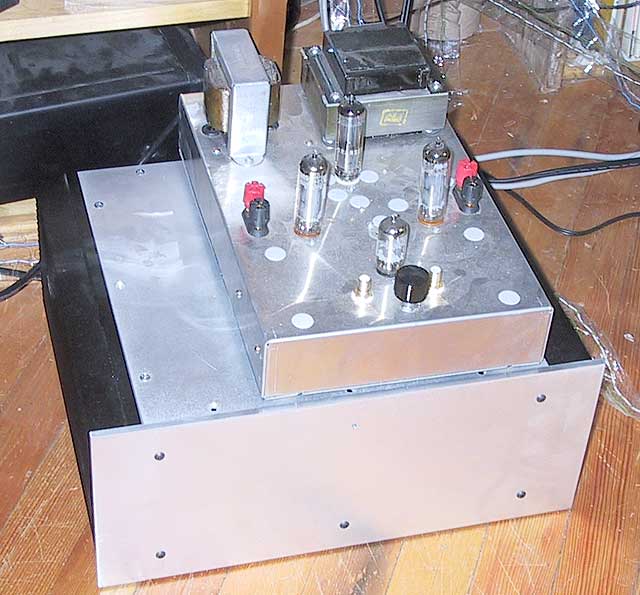

Just thot i'd post (not quite finished) a pic of Chris' miniA.... the other amp is a ptrototype RH84
dave
