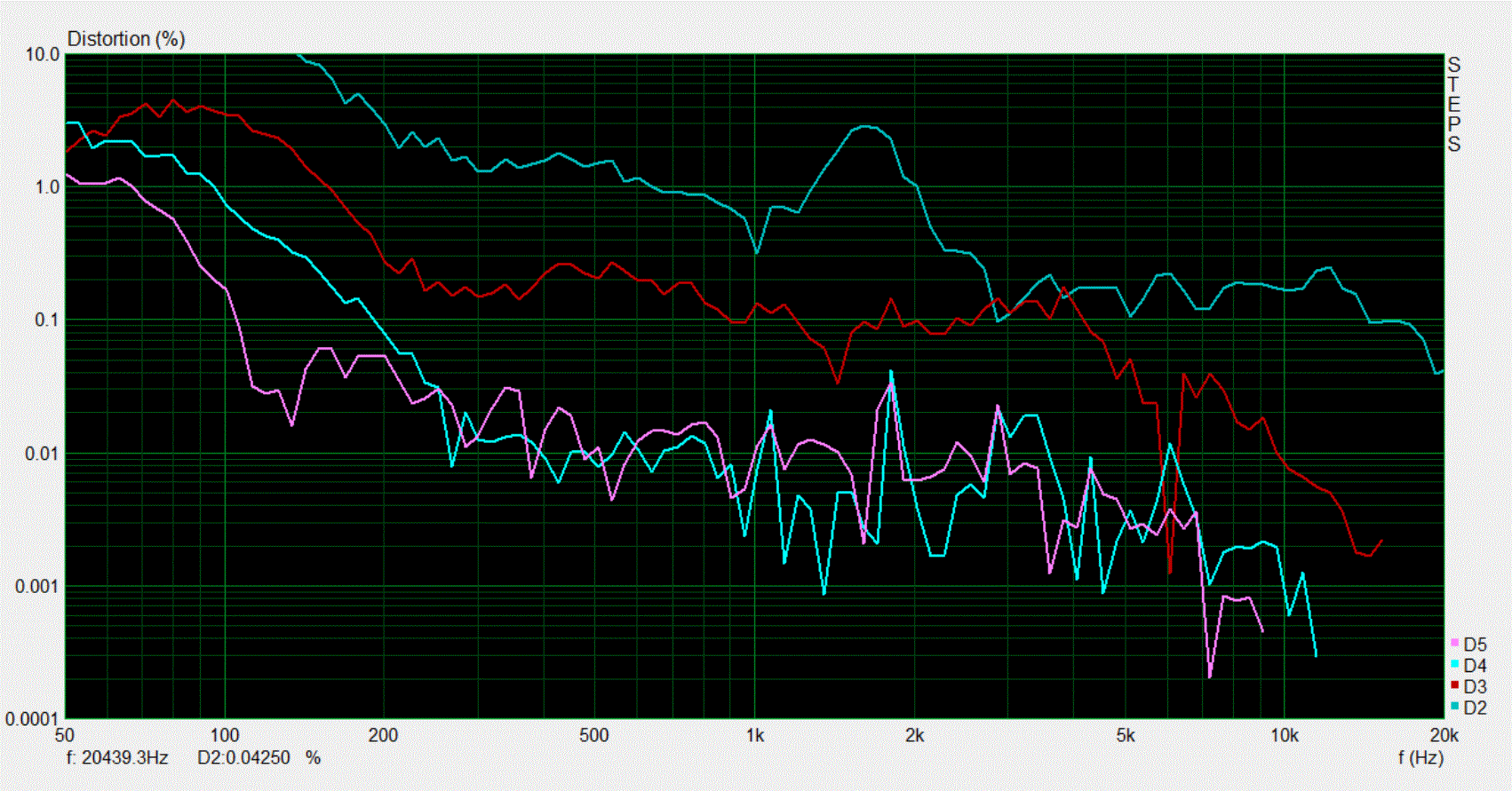

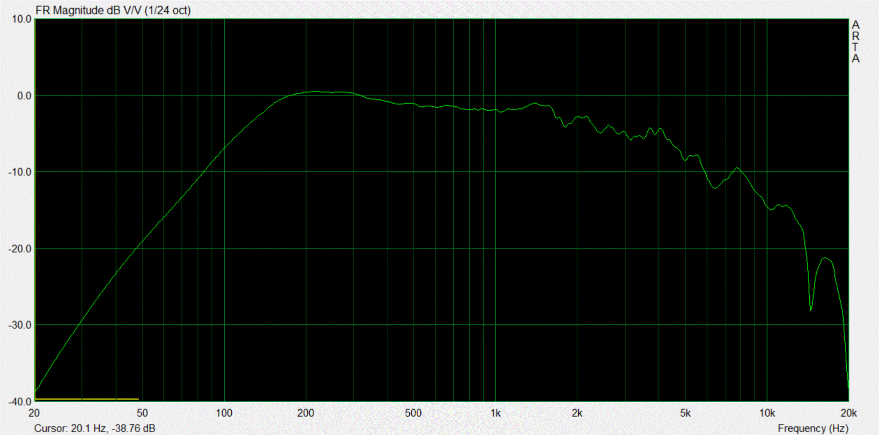

So I got a pair of these a couple of weeks ago and got their cabinets finished. These are a very small pair of cabinets 15x12x12cm out of 10mm thick material. The material is dense mind you, it's made from sheets of polyester resin impregnated with marble dust. One cabinet + driver weighs almost 2.5kg.
First measurement is a nearfield one, done mainly to show the low end extension (or lack there of). The tiny cabinet explains the high Q alignment, these are sealed.

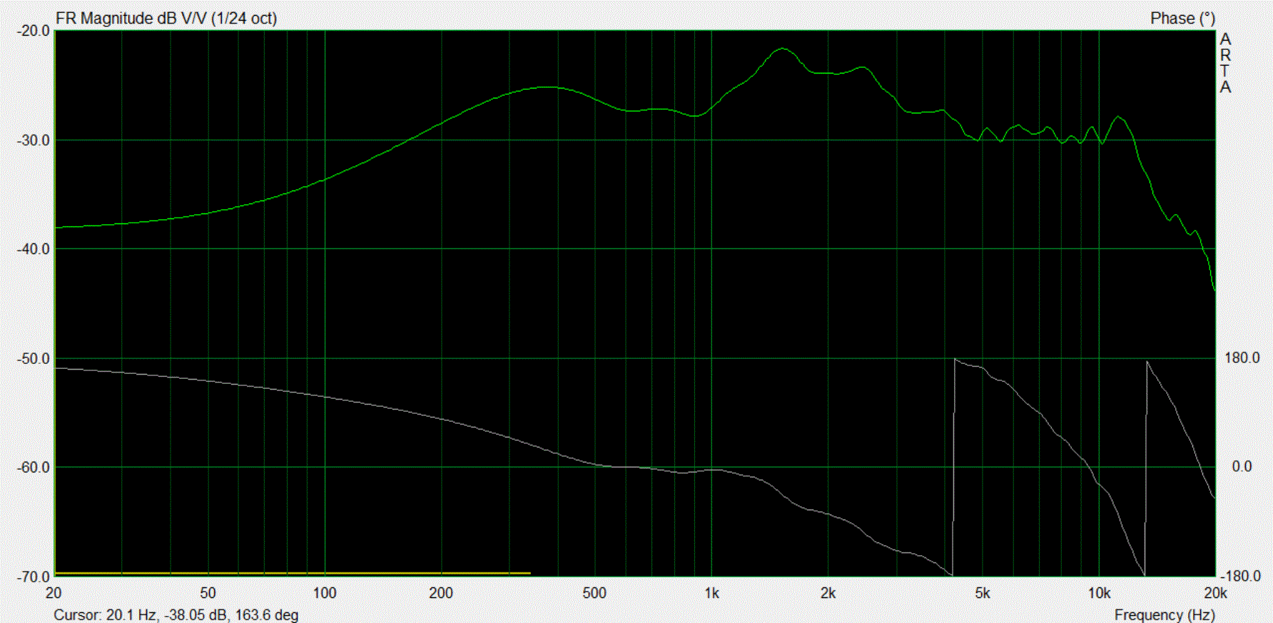

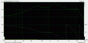

Next up is a gated far field measurement done at around 30cm.
attachment.php
They don't posses 20k extension which is evident from listening and they obviously beam far more than a dome tweeter. A massive resonance issue occurs around 1.5kHz too. This needs two notches to get rid of properly.
Next is harmonic distortion at comfortable listening level.
attachment.php
The first thing to note is that the aforementioned resonance shows up very clearly in the HD plot. Thankfully this only appears in the HD2 which is likely to make it pretty innocuous. Otherwise the HD plot is very clean except it would be nice for the HD2 to be lower overall, especially at low frequencies.

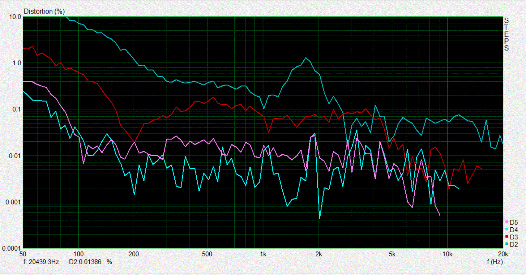

Next is the distortion run at a smidgen below 2.83vRMS.
attachment.php
Pretty much the same as above. Low levels of HD3, 4 and 5 but with high levels of HD2 and that resonance peak.
Quite where the resonance comes from I do not know. In a driver so small there is no reason for it to have any resonances up until breakup proper occurs. Still it only mars the HD2 which isn't as bad as it could be. The high levels of HD2 clearly point towards the motor and suspension being unbalanced, ie the outward motion isn't the same as the rearward. From a visual inspection this doesn't appear to be due to coil offset, but without a Klippel test I am just guessing.
Moving on, the driver is clearly built very well. A nice cast frame that is well ventilated. The spider isn't ventilated in a typical sense but it does have some holes perforated in it to allow it to breathe. As observed earlier on in the thread the top plate is very thick and the motor is indeed underhung.
Make from that what you will. Competition from the TC9, FR88EX and from a midrange perspective, the Scanspeak 10F are strong. The circular frame of the AIR320 is a big bonus though as it makes it a lot easier to use than the Vifa. Then there's also the FU10RB from SEAS.

Hi bear, in the bottom right corner there is a key. The different lines represent the different harmonics. I wont decribe the colours as I am colour blind and will probably get it wrong, but the top line is the 2nd harmonic, the line below this, the 3rd, then the two below this are the 4th and 5th. The darker of the two being the 5th.
