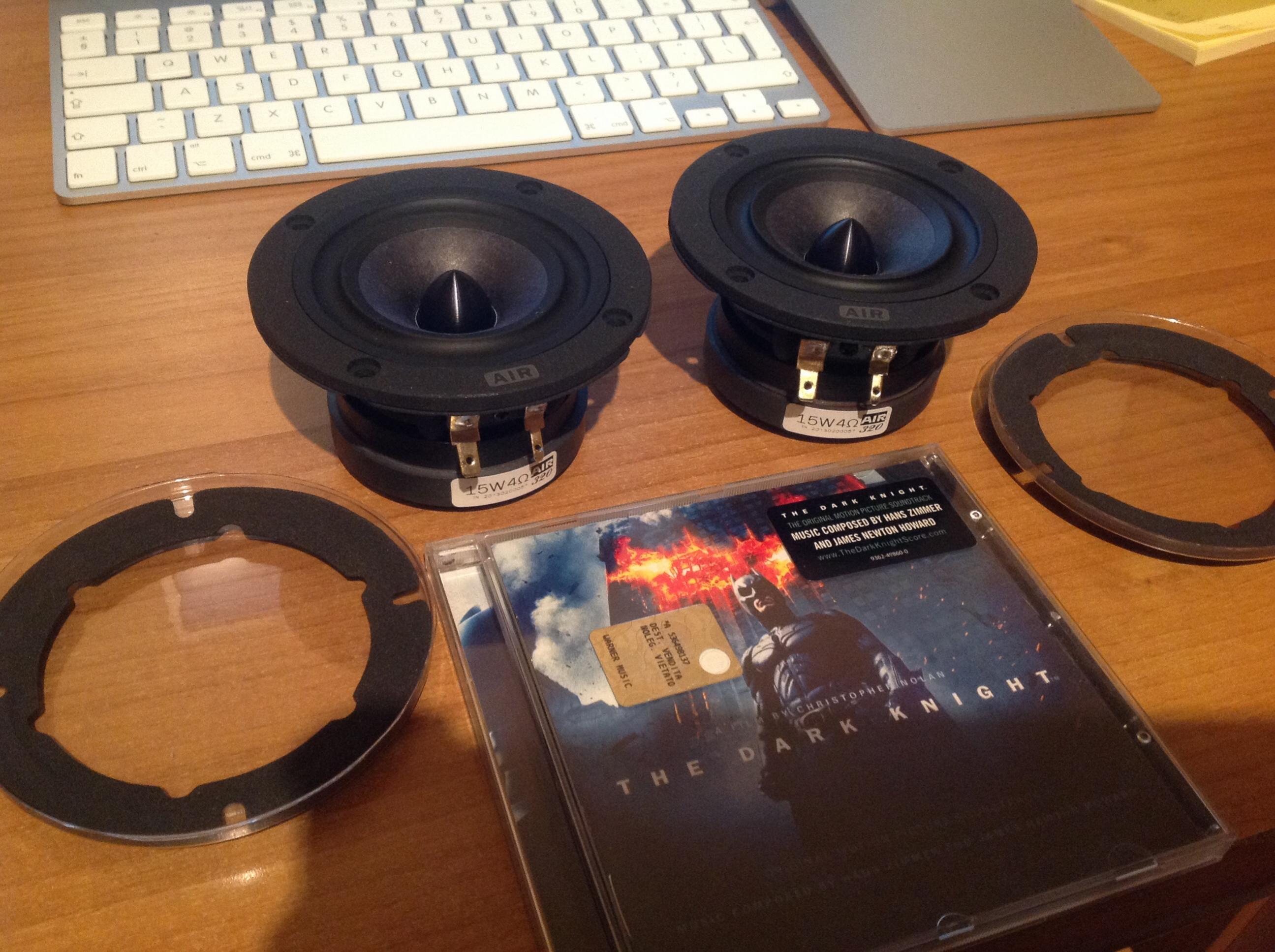

Here is a picture right out of the box.
Those specs are likely to drift a little as the mechanical parts soften. Needless to say the published and measured are close enough imo, especially as T/S parameters change with drive level too.
That is one thick top plate. Unless the thickness is the top plate + a spacer.

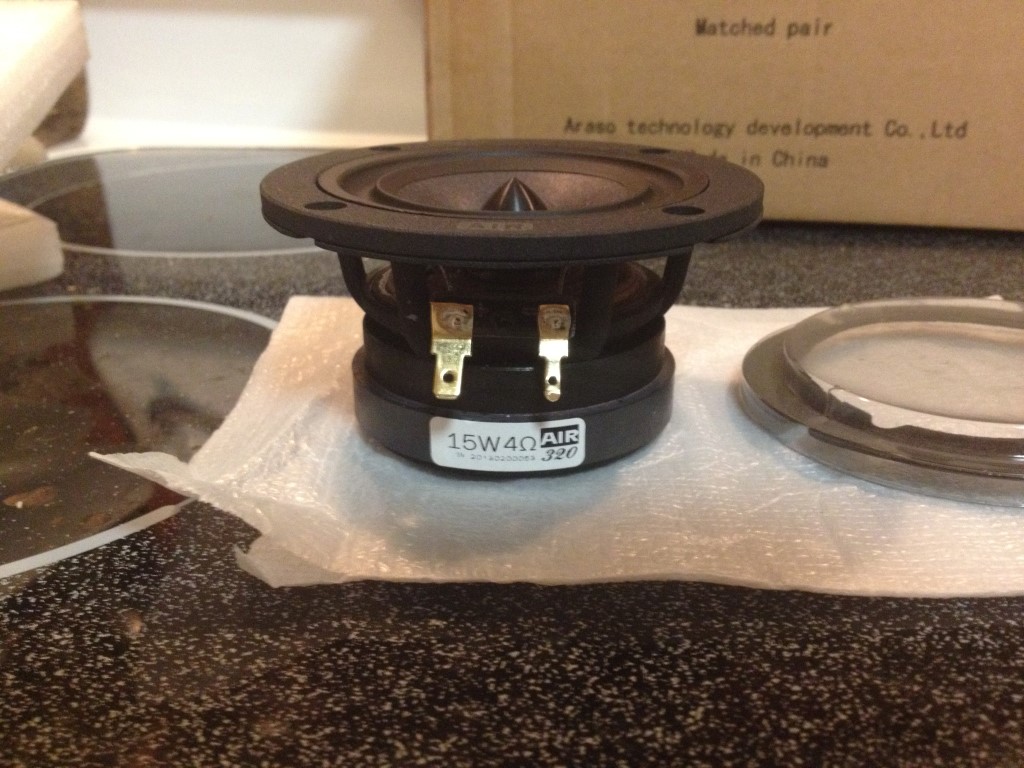

Received my pair in perfect condition, very well packed. Looks small but the quality of the driver is great - up to the level of the best Scandinavian examples. Measurements soon. Hopefully boxes soon too.
P.S. What are the dimensions of the port?

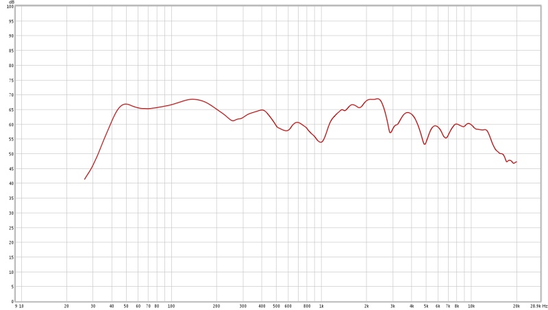

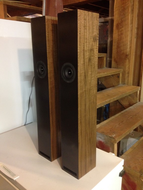

Here are my completed TABAQs with the Air320 drivers in them.
I've attached a measurement I took outside with REW. This is with 1/6th octave smoothing. I very much don't know what I doing when it comes to taking acoustical measurements so please keep that in mind when you look at the graph.
It looks like diffraction and comb filtering could be marring the results.
The dip at 1kHz, followed by the peak at 2kHz is what you would possibly expect from cabinet diffraction with a cabinet around that width. The uneveness in the treble looks like measurement artefacts rather than being strictly driver related. Of course the driver will show uneveness itself but who can tell what's really happening.
If you could though, try measuring them indoors instead and place the mic around 30cm away from the driver. Make sure there is nothing close to the loudspeakers too and see what you get then.
Due to the small cone diameter you should be able to place the mic as close as 15cm I'd reckon without it totally screwing up the high frequency measurement accuracy. Of course at this distance you wouldn't measure bafflestep or cabinet edge diffraction accurately, but it would give us a better idea of what the driver can achieve on its own.
