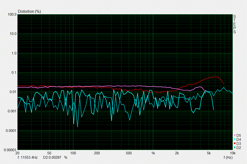

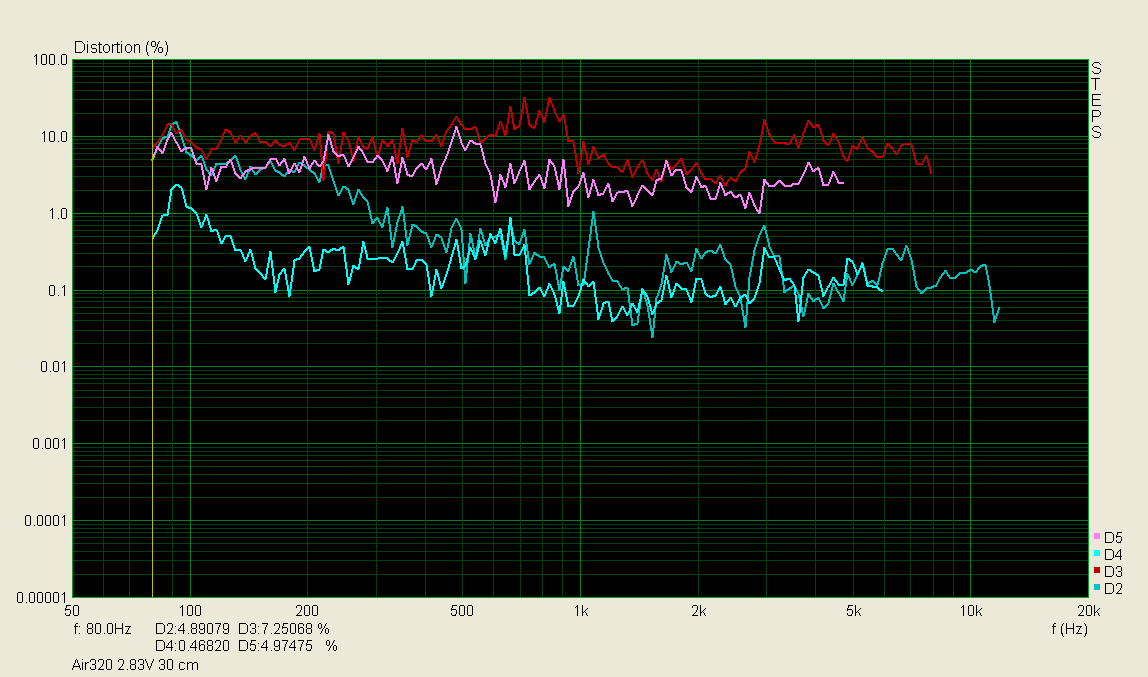

Okay, something isn't right there, it looks as if something is clipping somewhere. The distortion % should be far lower.
Depending on the quality of the driver you should be generally looking at 0.1-1% for the 2nd harmonic. 0.01-1% for the third and 0.001-0.01% for the 4th and 5th.
Of course these can be quite different depending on the specific driver, but should be ball park figures.
I've attached an example of how things should be closer to looking.

Its a Lepai LP-2020A+.
I measured one of my EL70's using the same method and result was a graph with mostly the same magnitude of measurements.
Could background noise in my room be tainting the results?

So we're basically looking at high 3rd, high 5th and lowish 2nd and lowish 4th order harmonics.
This could be entirely amplifier related. Some class D chip amps are known for having high distortion and are almost always bridged. In such a configuration the dominant harmonics are the odd order as the even order products cancel out somewhat due to the balanced/bridged nature of the amplifier.

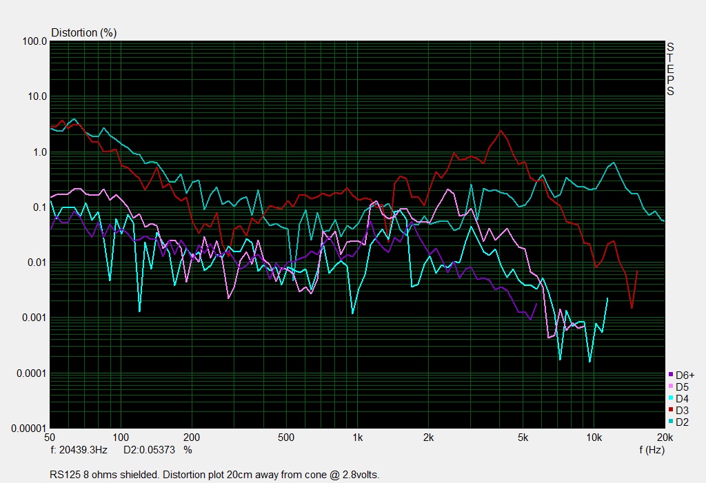

I've attached an image of a distortion sweep I've run of a TAS5706B build that I've done and this highlights what I am talking about. As you can see the 3rd and 5th are an order of magnitude higher than the 2nd and 4th.
If the amplifier distortion is really swamping the results to this bad a degree throw it in the bin as by any standards it would be considered faulty. 10% distortion of any kind only appears when you are hard into clipping or there is something else not right. If it was just the 2nd order products that were high, I could dismiss it as a design 'flavour' such as a single ended valve design. Or if you had high 2nd, lower 3rd followed by lower still 4th and 5th then it could again be a design feature, like the SE designs, but this is not what's going on.

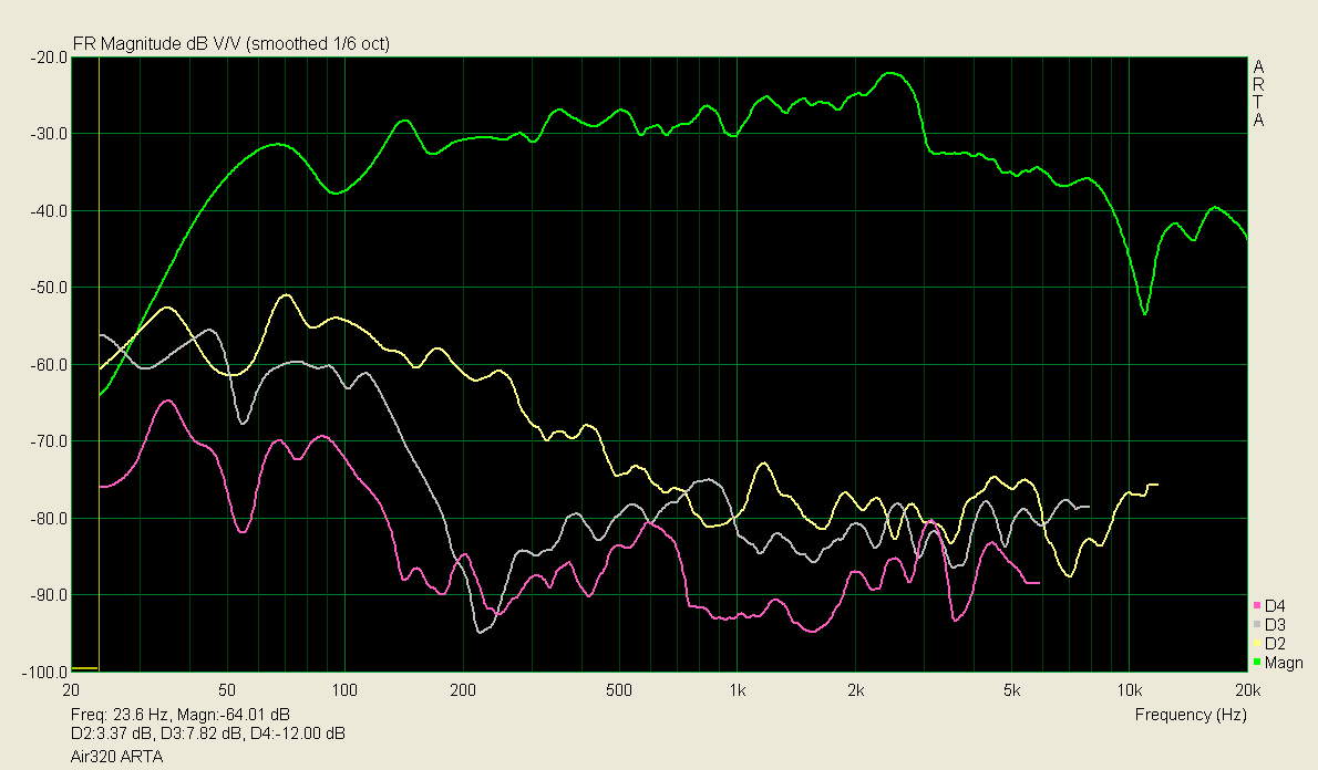

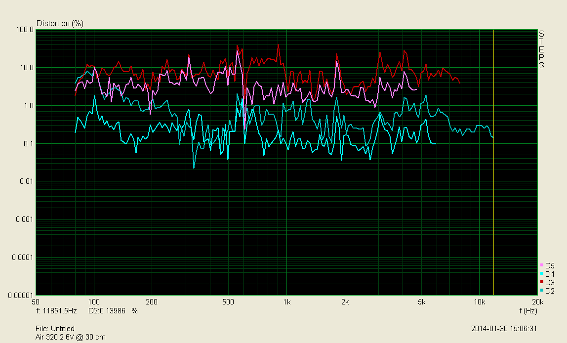

I tried testing again with an old 70's Sony amp I've got laying around. I assume it is not Class D. Unfortunatley it requires an 8 ohm load so I had to wire both drives in series to get the impedance up, I don't know if that would effect the results or not.
The results look different, but the magnitudes seem about the same. Maybe the audio hardware in the laptop I'm using aren't up to the task. I'll try a different sound card and see what that does.

Thanks for trying that out, the results are indeed quite odd.
The old Sony should be absolutely fine with a 4 ohm load providing you keep the volume low. Meaning here that it should easily be able to drive a couple of watts into 4 ohms unless its hideously designed.
If you wanted to keep the load 8 ohms, you'd be better off using a resistor in series with the driver, rather than using two different drivers.
I take it you tried the test using low signal levels? As you're using a laptop, you're probably using the line out into the amplifier? If so make sure you alter the signal level output by STEPS down by say 10dB and turn the volume up on the amplifier as some sound cards exhibit higher distortion when operated at full volume. I mean I'm surprised that any modern chipset inside a laptop would sit around 10% THD. Do make sure you've got any noise cancellation or effects processing turned off as this could possibly be the problem.
I have to say, I am quite surprised that the input to the laptop is as bad as it is. What mic and preamp are you using?
It's also nice to see that the TA2020 amplifier isn't as bad as I thought it was.

That's good to know that the Sony should be able to handle 4 ohms, at least at reasonable volumes. It says 8-16 ohms on the back so I wanted to error on the side of caution.
I have been using the line out on my laptop for testing. I had the volume set pretty low coming out of it (< 20% of max) so I wouldn't think that would be the problem. Though I don't have a lot of faith in that laptop. I've got a Behringer USB DAC that I'll try using to see if that makes a difference.
The mic I'm using is a Dayton UMM-6, its a USB mic so no preamp is needed.
I'm glad my TA2020 amp doesn't appear to the problem. I've got a couple of those things and I've been really happy with them thus far.
Tomorrow when I get a chance I'll do some more experimenting to see if I can figure out what's going on here. Now that I know what it should be looking like I can at least tell if I'm making any progress or not. Thanks again for all your help.

I ran the test again using my Behringer USB-DAC and it looks like it improved things significantly.
I did three tests. One at 2.83V, one at significantly lower volume, and one more using ARTA at 2.83V.
I think they look a lot better. Hopefully now I'm actually producing some data that other folks will find useful.

One thing that I notice is that in ARTA the SPL level drops off at around 3kHz and this, you could say, corresponds to the increase in distortion around the same point in STEPS. The two might not be linked at all, but as this driver is supposed to be pretty flat out to 20kHz, I am tempted to say that the drop off could be related to the mic position.
Does this drop off also happen in STEPS on the main screen? If it does you might want to try playing around with different mic distances or take the measurement slightly off axis and the cliff that occurs at 3kHz might go away.
I have noticed a similar thing happening myself and sometimes a cliff like that does directly correspond to an increase in distortion where the level drops off as the signal to noise ratio decreases.
Peaks in the harmonic distortion like this are often caused by driver resonances, or by things like the cabinet, or anything close to the cabinet vibrating.
I'd be interested in seeing where this resonance comes from because it's the only fly in the ointment. I would like to see lower levels of the higher order harmonics however, but for low listening levels the distortion is decently low.
