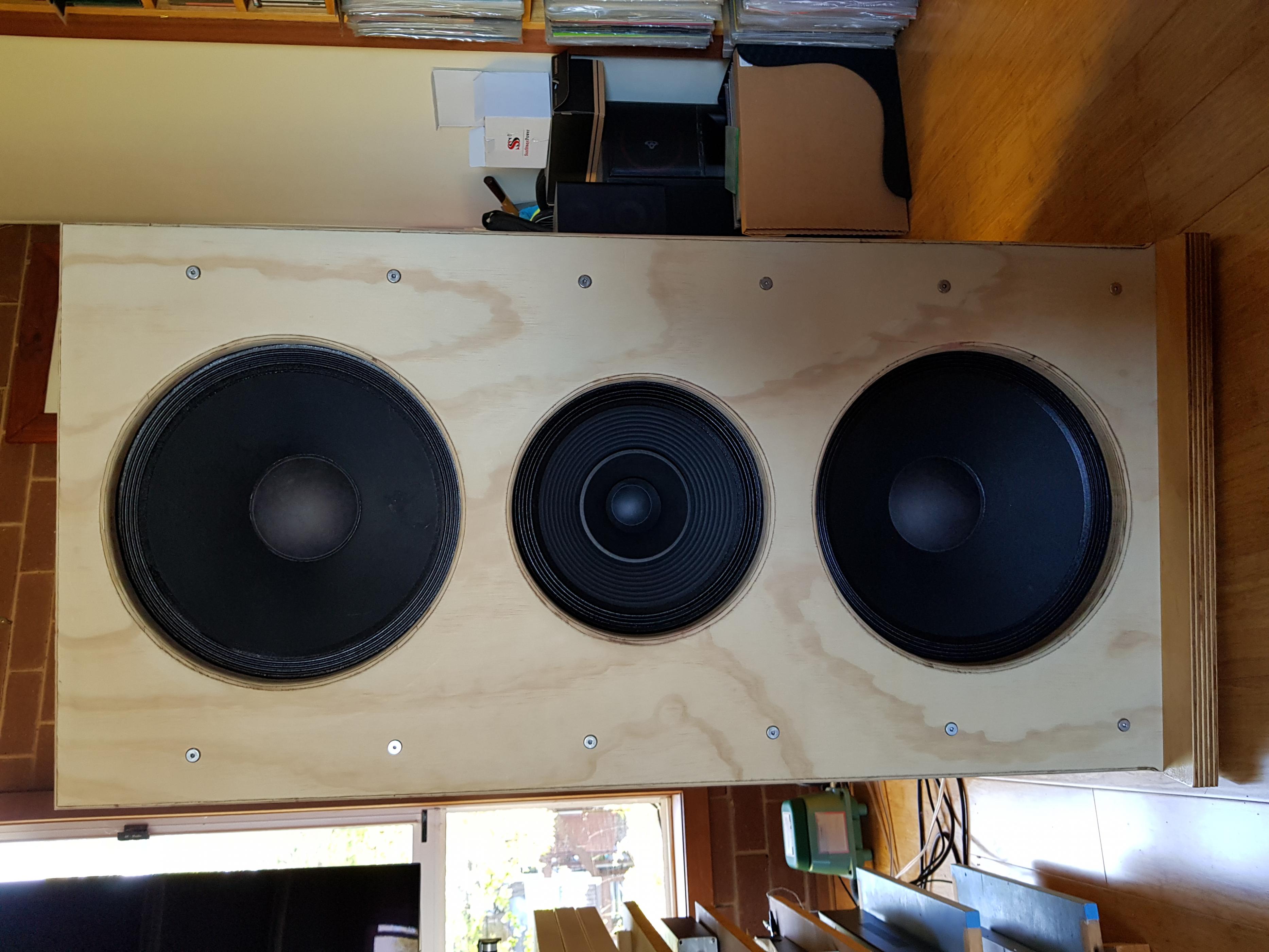

I built my OB WAW system last year using a 8" full range speaker and 2 15" woofers. Project description is here.
My OB Project
I am still enjoying this sytem, but just for kicks and because I had time on my hands, I decided to swap the wide range to a Fane 12-250TC. I have now finished first speaker of 2 and hoping to finish off the other next week, here are some initial impressions.
Straight out of the box and listening full range the bass is a bit light but as other posters have mentioned, these drivers need some time to run in. But since I am also using 2x15" woofers, overall system bass is just fine . I was crossing over my older wide range at 250Hz as recommended by Boyd, but have now gone down to 100Hz which the Fane manages easily with its extra cone area and power handling. I have been running the system pretty much continuously since Wednesday and will give a few more days for the suspension to settle in before I think about any measurements
As for the treble - wow. I am listening in a large room (which is why I wanted a big full range) and I sit about 3.6m from the driver. There is good integration of the sound at this point and I don't hear beaming or a treble peak, but the extension is extraordinary. The Fane 12" has replaced a 8" full range which was helped along with a small Dayton AMT tweeter. I can't say the Fane is better, maybe the older driver still has a nicer mid range but I reckon that the Fane by itself is extending further than the previous set up. Lets see what some sweeps reveal later next week, I am gonna keep the remaining original speaker for a few more days so I can run a few comparisons and see if my ears are really telling the truth.
So far I am very impressed with the Fane 12". I hope to post sweep results with some updated commentary later next week.
My OB Project
