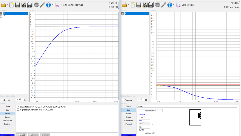

Pending on what you intend to feed them with, I wouldn't be concerned enough to implement any high pass filter at all. Especially the 15", but the 12" can also tolerate some abuse.
If you ever find yourself exceeding xmax and get some distortion, then implement the hp, but make a switch with a bypass.
You're right. It doesn't hit xmax before about 105dB. Which is certainly good enough.

"?" indeed. If I input a simple sealed box of 100l in winisd, the max spl graph (xmax limited) gives a maximum of 105db at 50hz, with a power input of 50w. The cone excursion hits 5.25mm and we're at 19v at the driver. Edit: to compare apple to apple: output @40hz is 101.5db when xmax is reached.
Once a Linkwitz transform is applied (f0=70, q0=.85, fp=50, qp=.71), the EQ will eat into the available power. We start in the midrange with 15w for 105db. But there's +2.5db @50hz, +4db @40hz, +6db @20hz, with the corresponding power increase. So the final curve gives 105db @100hz, a f3 at about 50hz, a f6 at about 37hz.
Yeah, with a xmax of 3.5mm, winisd and your sims match. 100l sealed+LT (and a mild hpf) gives a max of 103db in the midrange, f3 at 49hz, f6 at 38hz.
If I read correctly your post 343, it's a 100l BR with a port of 13*36cm, tuned at 30hz ? Displacement under 25hz goes crazy, isn't it a concern ?
edit: of course, once corrected the 200l sealed isn't that good anymore. Less than 1db of improvement over the 100l one.
