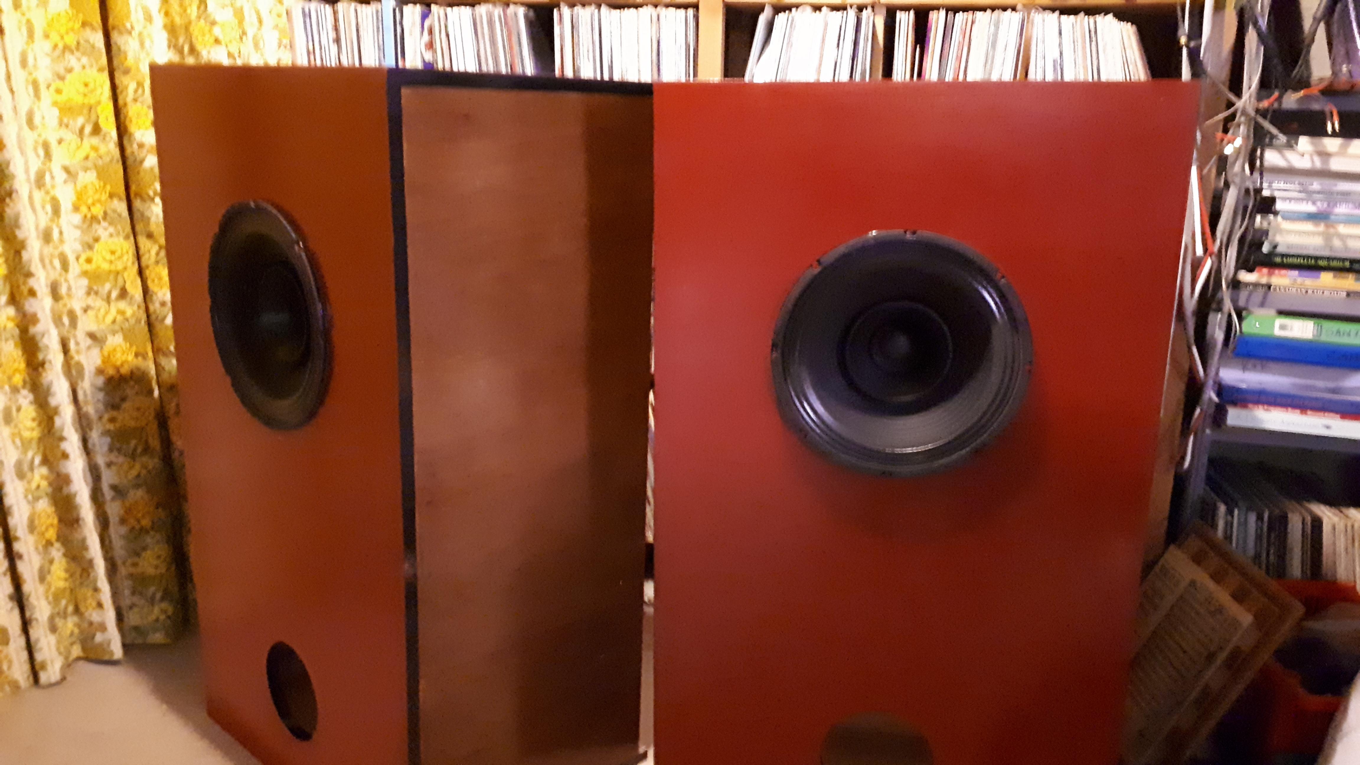

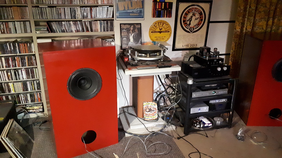

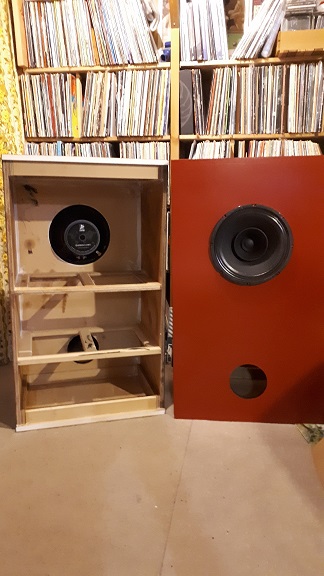

I built the Scottmoose suggested design for the Fane 12-250TC. I am thrilled with the results. Here are some pics and note a few differences from that posted by Scottmoose on p.39 of this discussion.
One changed is that I only used a single layer of 3/4 MDF and 3/4 Marine grade plywood, left over from other projects (I didn't have enough material on hand for a double layer). Another change is that I didn't have enough material to make longitudinal braces, so mine are horizontal. The exterior dimensions are 41.5H inches by 24W by 17.5D.
Right now I am fiddling with speaker height (adding different sized wood feet under the cabinets) and internal stuffing. For internal tuning I am using layers of Myskgras, a bedding product from Ikea. I don't know of anything cheaper for stuffing.
This is my first DIY build and it's replacing a pair of American-made Cain&Cain Abby speakers.
I wonder if I need more internal bracing and how to tell if I need more internal bracing...thoughts appreciated.
Thank you to Mr. Scottmoose! I am glad I took a chance and purchase the Fane 12-250TCs from Solen.ca and got off my butt and made the cabinets - as you can see from the pics, it's a pretty easy DIY build.
