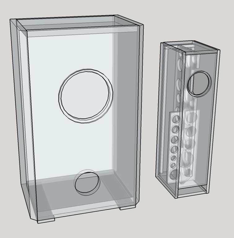

Fair enough. I suppose I should list a few caveats / points to keep in mind though.
-These are physically large by most current standards, and fairly high output, or would be sans damping.
-In design terms they're derived from a traditional bass reflex, as opposed to a Small type vented box. So they're treated and tuned in that way. There are some notes in the png file.
-The box tuning and alignment has some flexibility. One method of tuning pre-Small (strictly, pre-Novak) bass reflex enclosures, which I've used here, was to staple damping material over the vent, once the basic box Fb was sorted. The design as-is assumes a layer of damping stapled over the vent. Adjust that & the internal damping to preference. Since this is a traditional box, keep it simple & use the click test (attached). Minor note there: the click test is largely to determine overhang rather than output. Here we have the option (likely need in many cases) to reduce enclosure output also, so keep in mind.
-If you put enough damping over the vent, you'll end up quasi-aperiodic. Not what I intended, but if that's what you like, great. If you want to do without, that's also fine (obviously), but the LF output will probably overpower both midband and room. It can be sealed completely as an extreme measure if desired, which will give a Q around Butterworth. One point about vent damping -fixing whatever is used in place is advisible or it will tend to beat against the duct.
-Cosmetic additions e.g. end & top caps are fine. Same goes for feet.
-This is the world's worst drawing. I have zero CAD skills & can't inflict everything on Dave, so I'm stuck with Windows Paint. Sorry.
-I've added anechoic plots from a couple of different pieces of software, but there is some variability between different software assumptions when it comes to damping, & since adjustability is part & parcel, it's a bit of a moot point per se. They give a rough idea though. I didn't include Le as it doesn't affect the behaviour of this design.
-I don't make any promises that anybody will like it.

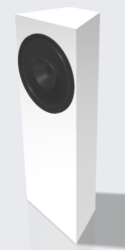

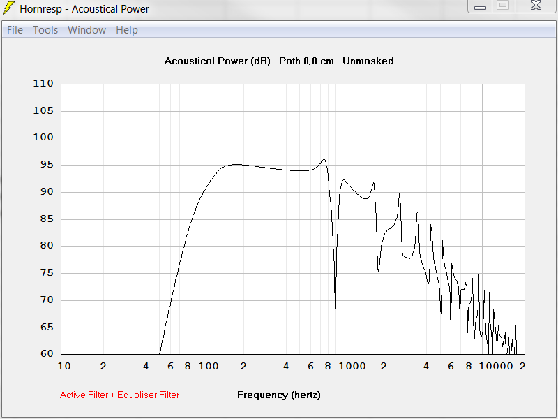

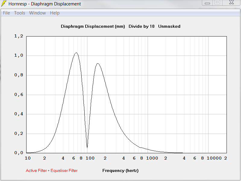

That's a good idea, thank you! I was thinking of a closed box, but this looks much better. I took it further with HornResponse and reduced it to 25 listers, 100Hz tuned, then active EQd for a good response down to 100Hz (-6dB). Group delay is 8,4ms there.
HP is 85Hz 24dB Butterworth, EQ 130Hz -11dB Q1,8
😎 That in a small-ish floorstander, and subs below...
Is it just me or is a 25L box for a 12" driver going to have some funny proportions??
It will probably be just large enough to house the driver, possibly a cube.
I was just looking back at Scott's draings and i realized the proportions on the drawing he provided were a bit misleading (to be totally fair Scott has stated clearly that they were not to scale in any way, so it is only my neglecting to read the numbers on the side that had me not realizing its size until now). In case anyone is curious, here is a side-by-side of the Pensil 10p (i used them as comparison as i have a pair in my living room so i know how big they are). Huge is the right word 🙂 That said, if i had the right room for it i would definitely build it...
Yes, my apologies, I have no CAD skills at all, and I didn't have time to get the old ruler out with Windows Paint (old version) to approximate the proportions more thoroughly. Many thanks for the comparison above, gives a better comparative idea. TBH, acoustically speaking, that box isn't huge, although physically larger than most people are willing to put up with these days, unlike the '60s when it would have been relatively par for the course for a hifi fan. Different times. I suppose I should add that I don't personally like this driver. No reflection on Fane at all, I'm an admirer of their products / engineering. It just isn't what I'd use for home audio. Ideal for its intended purpose, but the upper mids & top end melt my ears, even well off-axis & with amplifiers & wire that don't exactly meet the definition of 'aggressive'. YMMV as always; we all of us have different requirements & conditions.
Be that as it may, as an observation, I'd be a bit wary of dropping Vb to 25 litres with the Fane, even with active EQ. There are all kinds of compression effects & potential internal reflections that can spoil your day by mass-loading the moving components under dynamic load conditions. You may get away with it, but it's something to keep in mind. Granted, I'm a brontosaurus.

What I simulated is very small, but possible. A small floorstander, 900mm high, 320 wide, and 200 deep with trapezoid shape has about that volume and can house that driver. It may be better to make some more room around the driver for more damping material.

Agreed, this 25 liters is only a simulation, I merely wanted to show myself how much volume would be required to get down to 80...100Hz.
