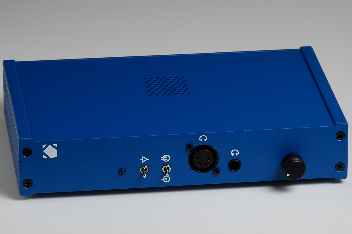

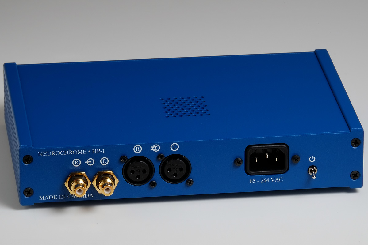

Per request: New pictures of the blue chassis. This time a bit better exposed and with better rendering of the blue colour.
Tom
