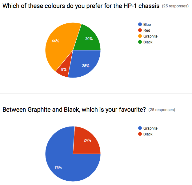

As promised, here are the results of the chassis colour survey. Graphite seems very popular. It also seems people are either "black" or "anything but black", indicated by the rather large slice of "graphite" in the graphite vs black pie chart.
The next stack of enclosures will have a couple (2 of 10 probably) in blue and the rest (8 of 10) in graphite.

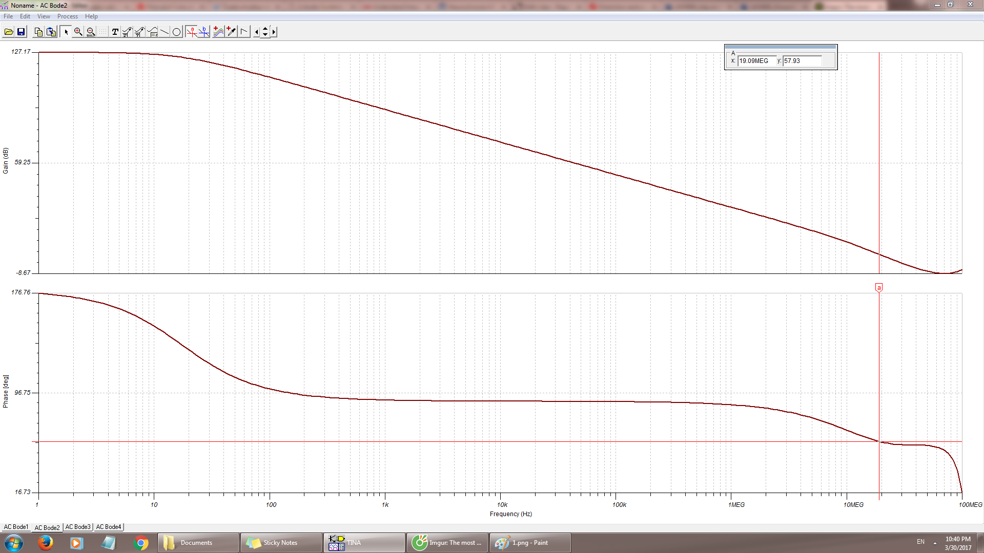

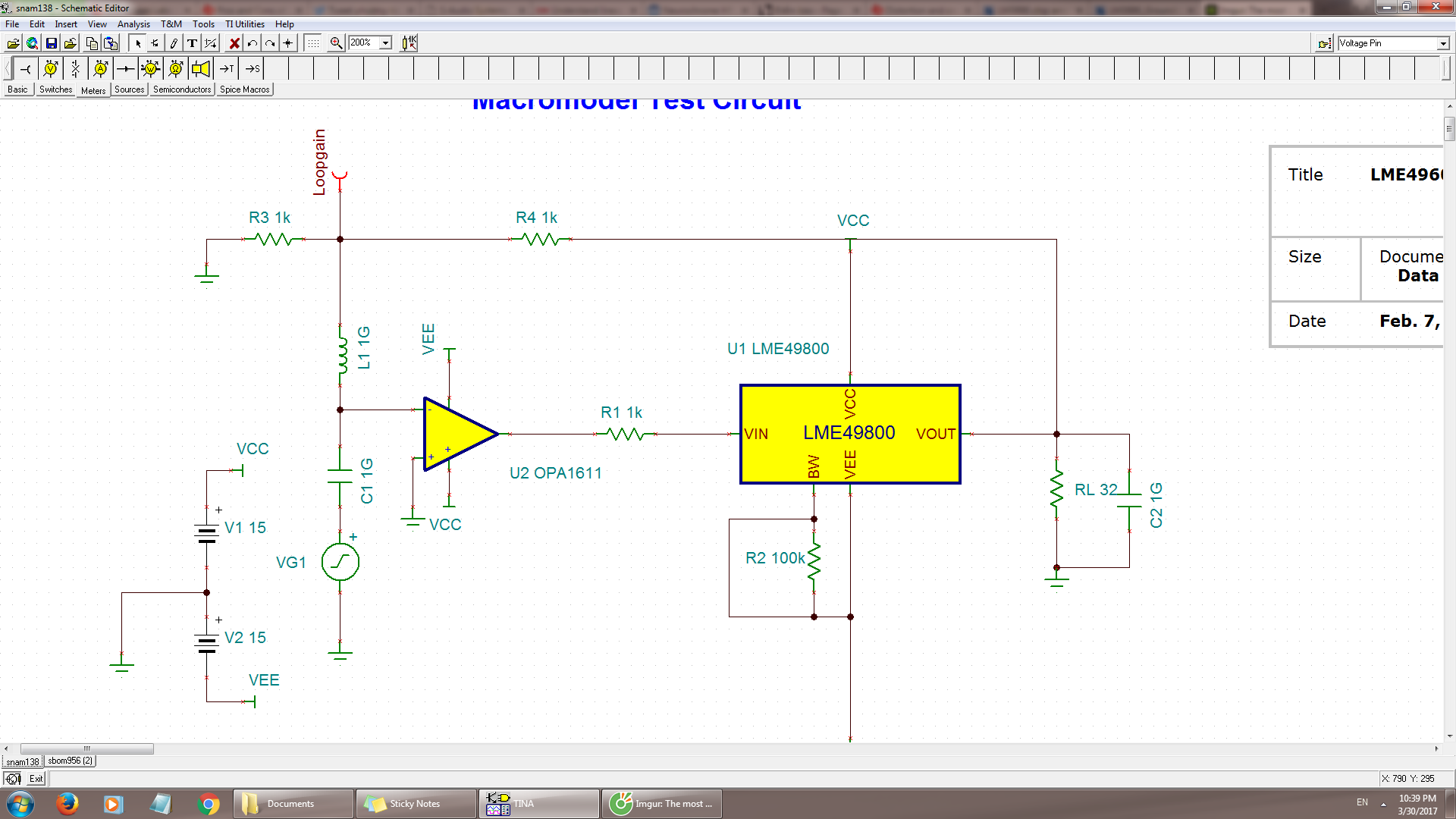

Hi Tom,
Your design looks great and i really like your series "Taming the LM3886", i have learnt a lot from it. I have some question about your design:
1. Which model of the LME49600 did you use to simulate? I use the model by TI and the loopgain response doesn't change when i change the value of Cload, the Buf634 come with the Tina installation simulate well
2. One of the most critical point was emphasized in your design is that the amp stable even with 10nf load but in normal situation, the headphone cable is only about hundreds pf, so this is only advantage at some extreme case?
3. When i simulate amp with and without the compensation capacitor, the THD is often higher when compensation is used, even double the THD. Do you observe this in real measurement?
4. About stability, amp oscillate when the phase is -180 degree at frequency loopgain = 0 but this only happen when there is a signal at the input so the output go to infinite and oscillate, if there is no input signal at that frequency, amp won't oscillate, right?

I agree that the model provided by TI is worthless. I started with that and then took measurements of the LME49600 using my HP 3577A network analyzer to develop my own AC model for the LME49600. I backed that up with quite a bit of prototyping to ensure that the amp would be stable across a wide range of load capacitances. As I'm sure you'll find if you build the circuit as shown in your sim sheet, the LME49600 will oscillate quite happily in the 75-150 MHz range. I finally got to use my 2.9 GHz spectrum analyzer for the purpose I bought it for ... to detect oscillation in amps. 🙂
My stability claims go beyond "stable at 10 nF". Perhaps I should communicate that better. The HP-1 is stable with 0 pF to 10 nF with no holes in the range. It's easy to build a system that's stable at 10 nF but isn't at 100 pF. You have to make sure that the amp is stable in the entire range. Otherwise you'll end up in a situation where the amp oscillates when a user plugs in a 3 m extension cable but not when they use the 5 m extension cable or the headphones plugged directly into the amp.

Simulation of THD is not challenging but pointless in this case, since the model TI provides is not a transistor level model.
