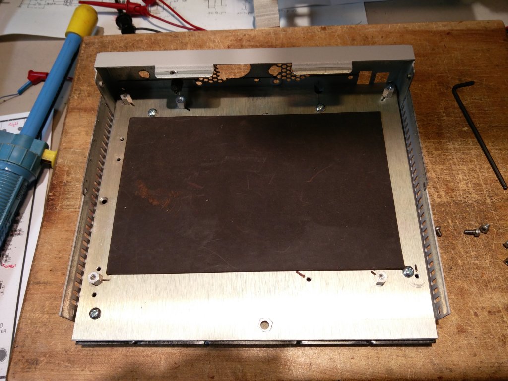

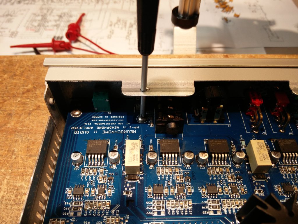

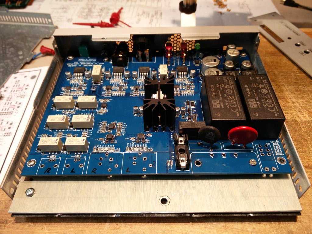

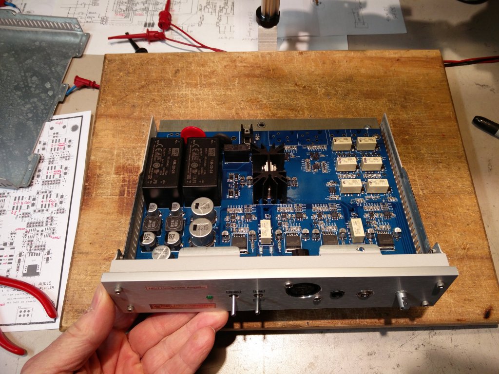

My Own HP-1 version
At To reqeust, here a few pictures of my own built of his HP-1. I bought only the pcb, and made it fit into a recycled enclosure. Width and height were about right, but it was too deep. So I installed the pcb on the front, and the rear parts on the rear panel. I'll run flying wires to the pcb from there.
To match the original enclosure bottom builtin standoffs I used an aluminum interface plate, shown here with some vibration damping pad.
Then I had to drill the existing front, to match the pcb parts, not an easy job, but went well. I had also to make a special access hole just to be able to install all the cpb screws 😉

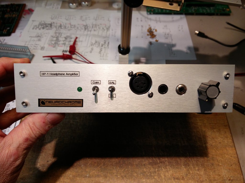

Finally since the original front was ugly, installed a matching brush aluminum plate. You can see that I added also a 1/8 HP jack to the existing XLR and 1/4 jack.

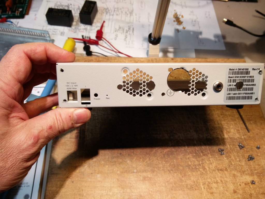

Did the same on the back, but it was much easier this time, since I decided where to put the parts.
A few custom P-Touch labels later, it was done...

Algar_emi,
Nice work with the case modification - end result looks good.
How does the amp sound to you? What headphones are you using?
p.s. Also kudos on populating the PCB by yourself. In my experience Tom's documentation and support is top notch, so hopefully everything went smoothly.
