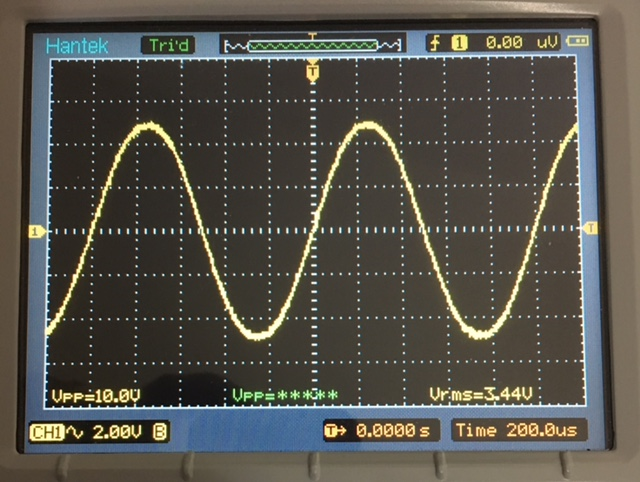

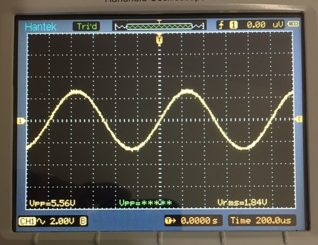

My battery powered SE Class A amp can't deliver the kind of power your Class AB chipamp can do that's for sure. But the balanced drive does work to almost double the output swing. In single-ended output I get about a 5.56v peak-peak output into a 270R load, whereas putting it into balanced drive mode I can get about 10v peak-peak. It's not quite 2x the voltage probably due to the limitations of this topology and the limited 55mA bias current. But it definitely boosts the output while keeping the amp working well within its lower distortion range. One thing to note, you need a battery powered o-scope in order to make the floating ground measurement in balanced drive mode. Here are some screenshots.
Single ended drive mode (5.56 Vpp):
624362d1499334372-neurochrome-hp-1-ultra-high-end-headphone-amp-single-ended-data-270r.png
Balanced drive mode (10.0 Vpp):
624363d1499334372-neurochrome-hp-1-ultra-high-end-headphone-amp-balanced-drive-data-270r.png
Edit: for the single ended mode, I used the built-in 270R load resistor that is always present on the PCB, and for the balanced mode I have an extra added 270R load externally in between the two outputs. Thus the load is lower impedance in the balanced drive mode and hence max output swing is less.

My friend who loaned me the battery powered scope took it back today. My wall plug non-isolated scope doesn't work to measure floating signals. It shows clipping like artifacts. Nonetheless, the Pocket Amp was designed for portability and longer battery life in Class A so then bias was a modest 55mA - suitable for 250ohm and higher headphones. I am certain that clipping will occur at lower voltages than for the 270ohm/180ohm case. If I built some SE Class A headphone amps designed with higher bias for 50ohm headphones, I think it will be fine. Actually I guess I can try it out with my Silicon Harmony, which runs a 1100mA bias current and should handle even 8ohm headphones. I will only get one channel of balanced drive though.
Your scope will work just fine. You just gotta know how to use it... 😉 Hook channel 1 to one output and channel 2 to the other output. Use the ADD and INVERT functions on the scope to perform CH1 - CH2.

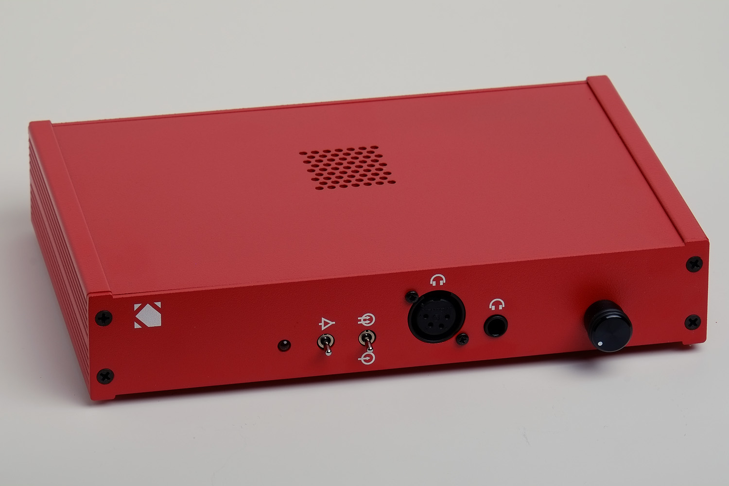

Playing with colour. This time Carmine Red. I must say that I rather like it. I might just have to hold onto this one for myself. 🙂

The default LED colour on the HP-1 is blue. I've found the only non-blinding one on Mouser it seems. On the red chassis, I went with a HeNe red, of course. 🙂
I did ask a while back which colours people prefer. Colour definitely appeals to many, though when push comes to shove black boxes sell. That's why I've chosen to only have one blue and one red made.
