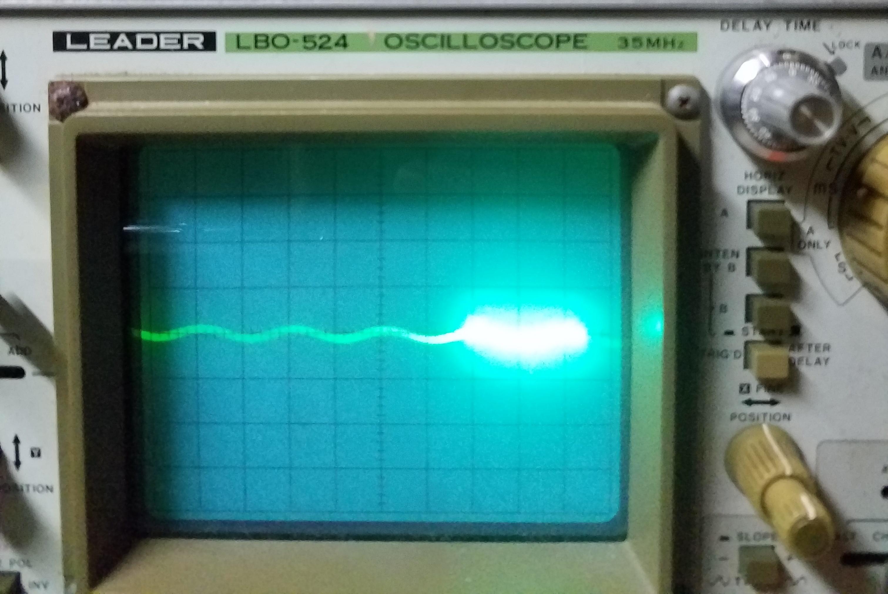

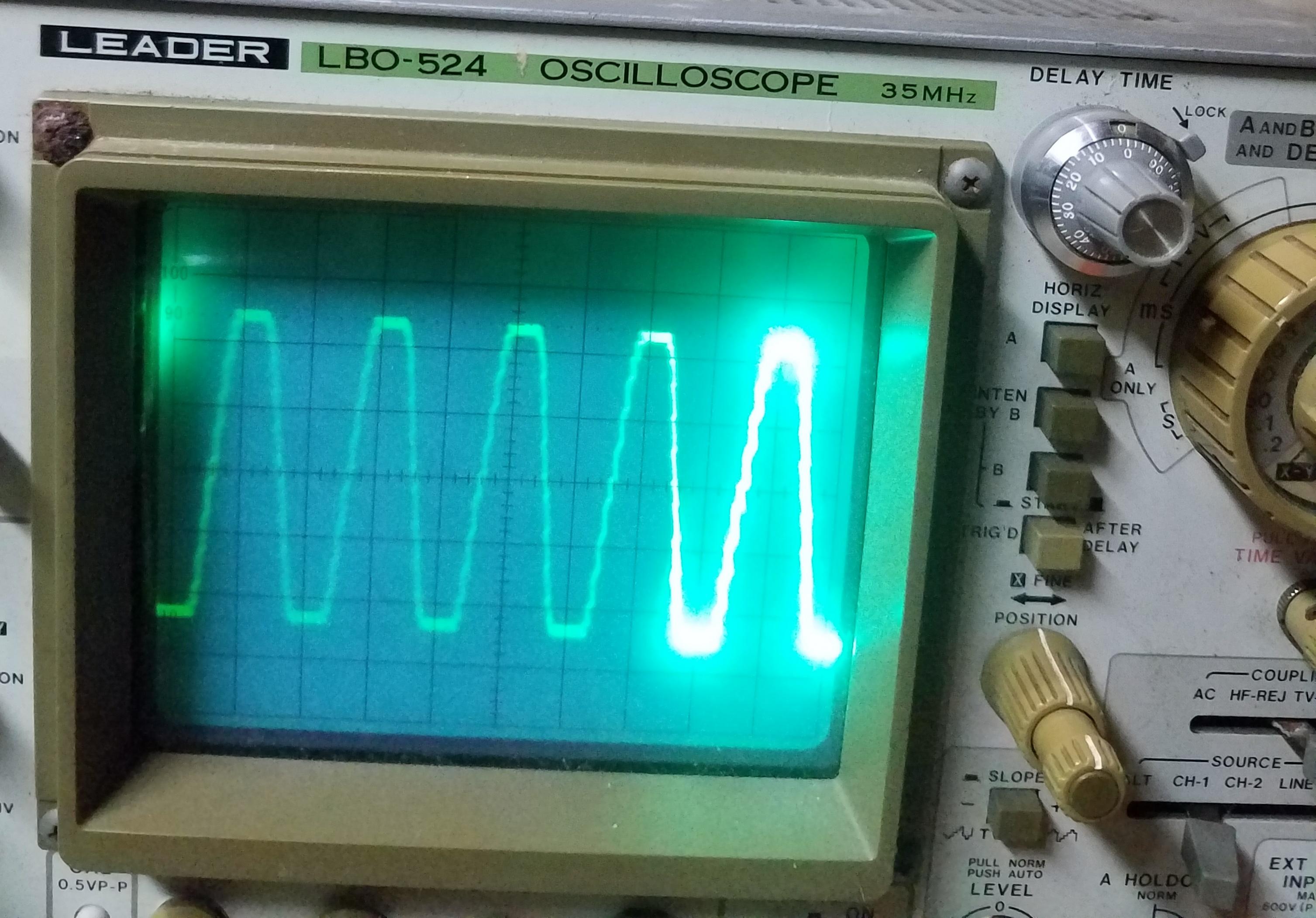

Post images of the waveforms on the two inputs and the output of the 5534 just before and just after the output clips. 6 images.
If the speaker output is still clipping at 10v and the rails are still well above 10v (30+v), there's no need to post photos of the output to the speaker terminals.

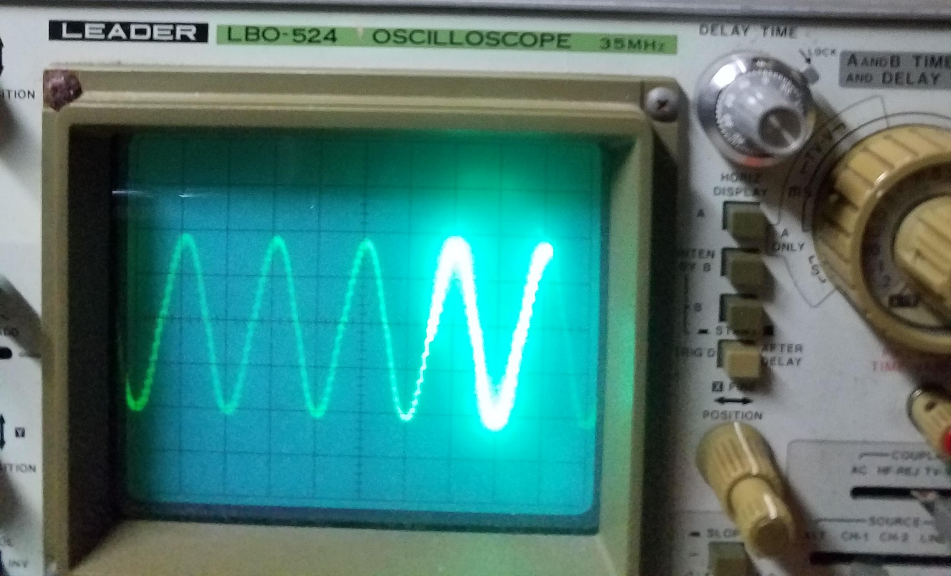

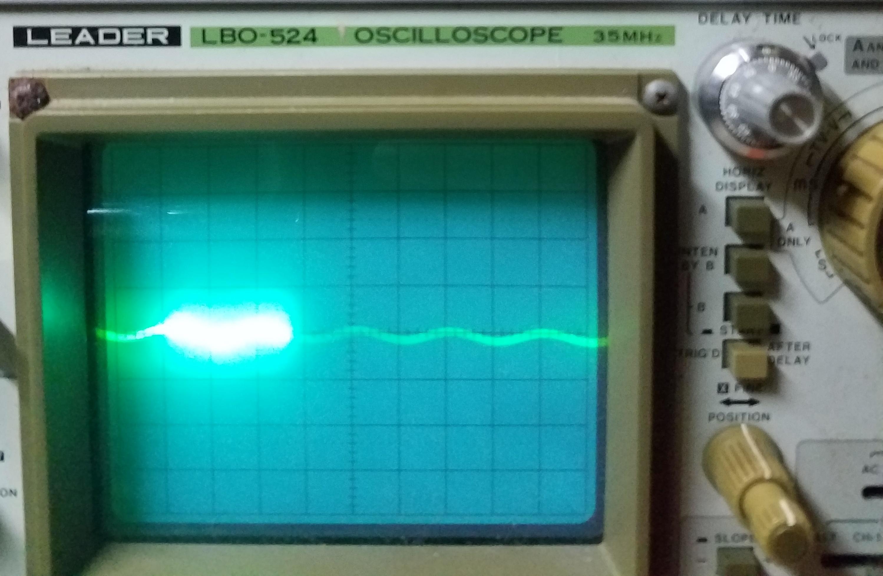

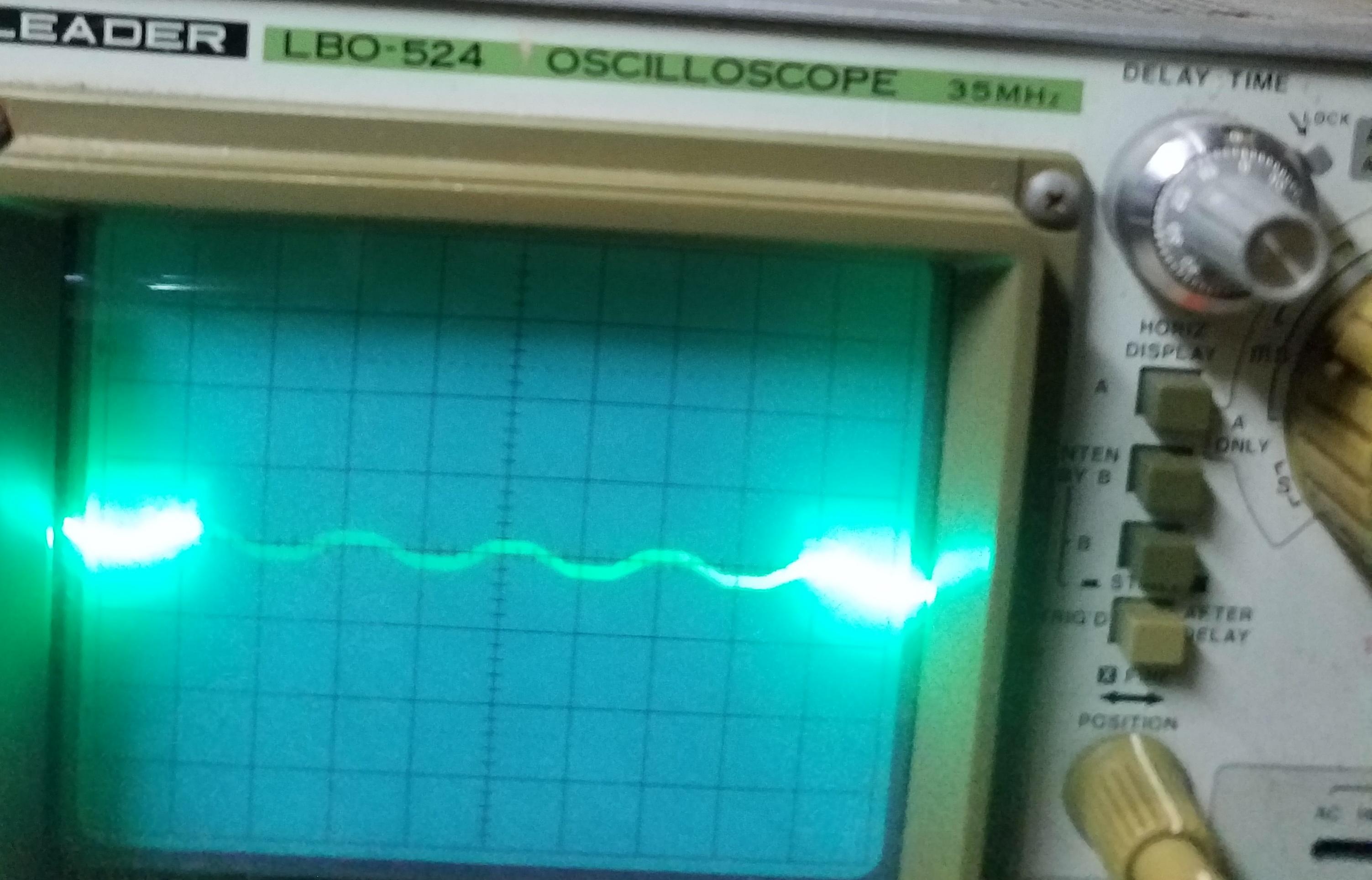

Scope set at 5v/div.
The photos are of the 5534 input pins 2 and 3 and output pin 6 left to right.
First 3 are just prior to clipping, second 3 are just after clipping.

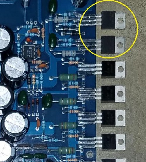

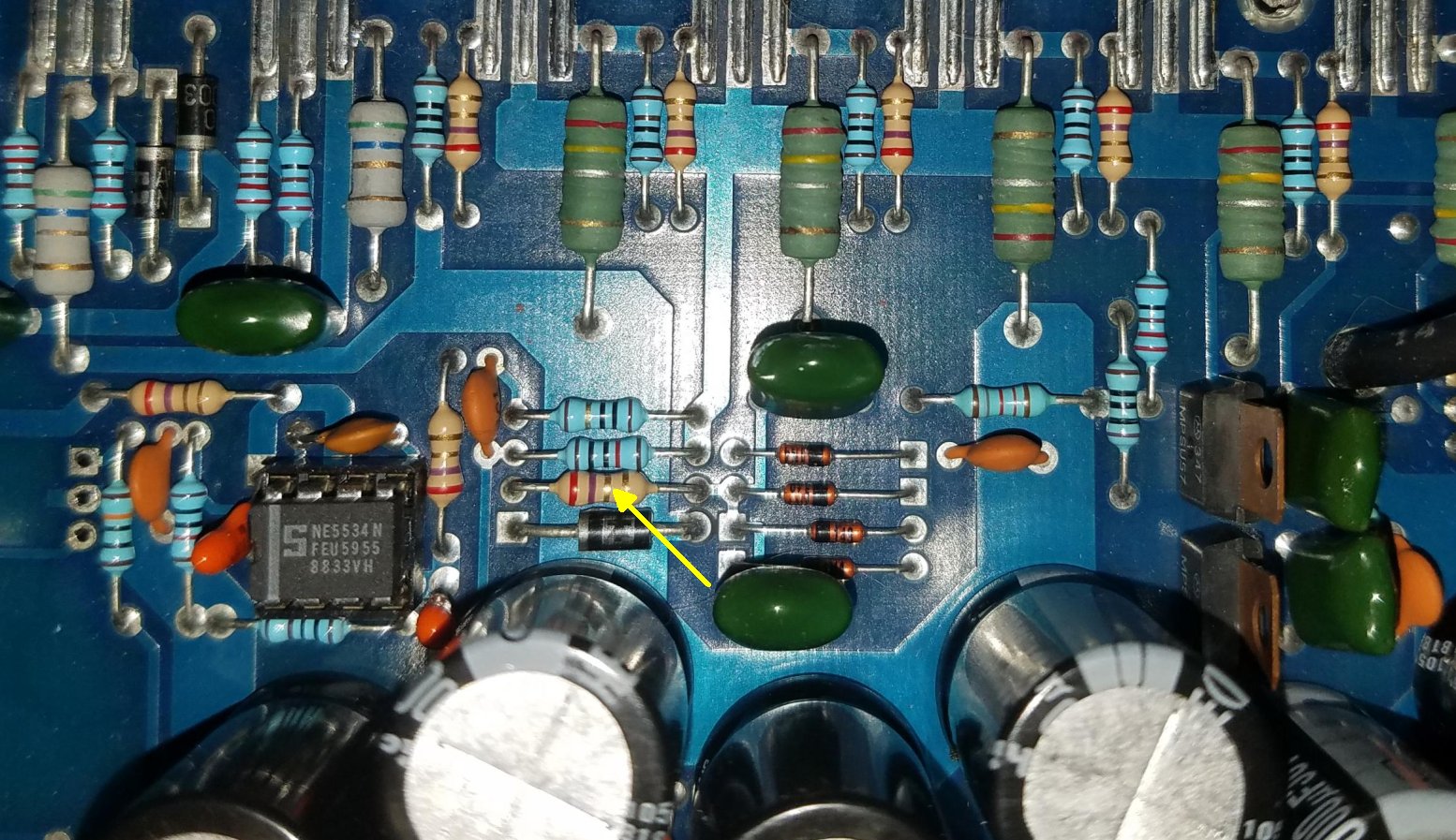

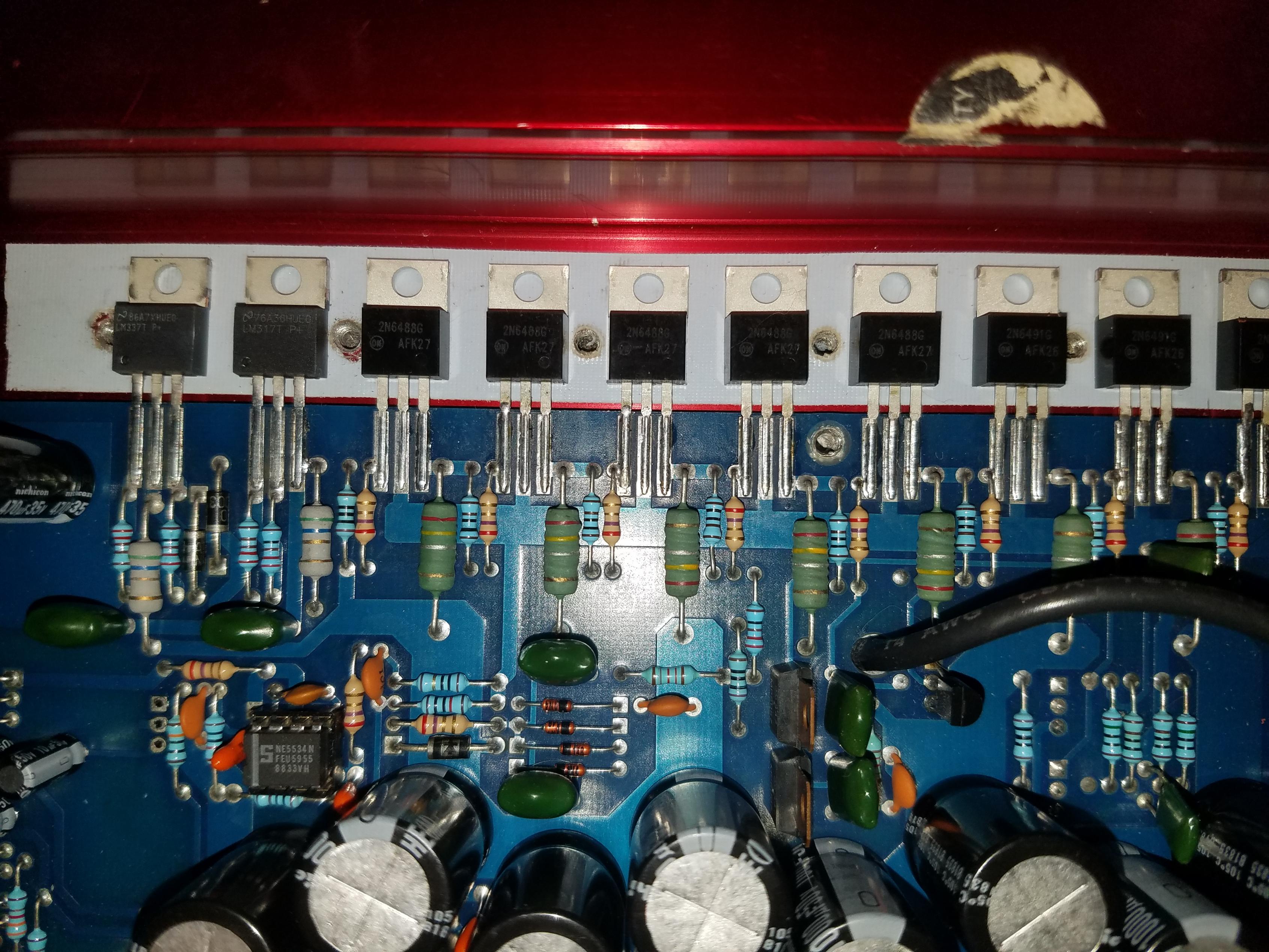

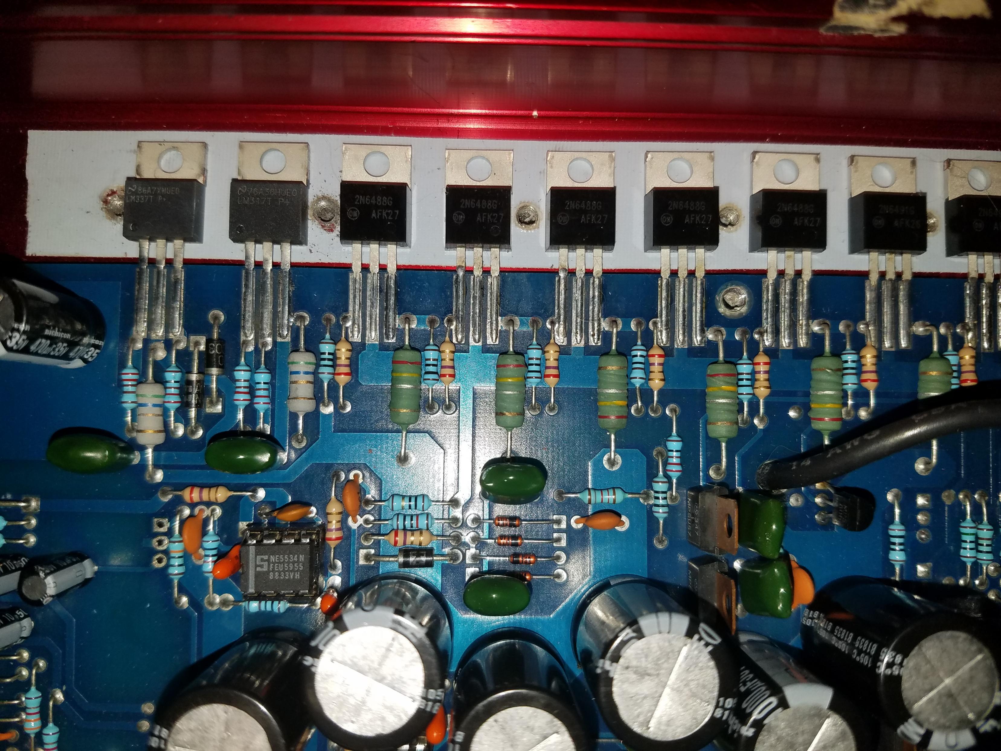

Here is a couple of photos of that area.
Do all of the orange diodes that it drives read as OK?
Are all of the drivers and pre-drivers original?
I know the diodes should be pulled from the circuit to properly check them. Is there a way to check them in circuit?
All the drivers and pre-drivers are original.
You can check them on diode check. None should read open. I'd expect them to read about 0.55v when forward biased.

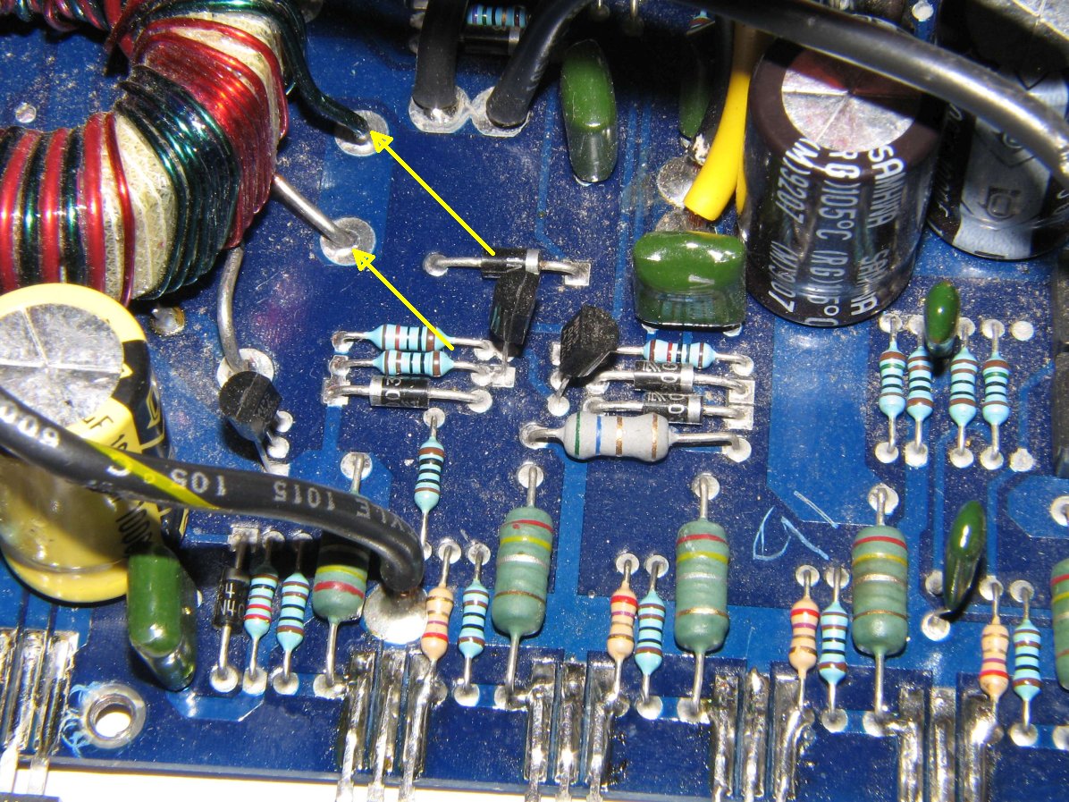

Also check the resistance from the RCA shield to the secondary center tap on the transformer.
Do you have a current limiting resistor or dummy load?

Will you show me the the secondary center tap on the transformer?
The resistance between the RCA shields and the non-bridging speaker wires is 0.1 Ohms (my test leads are 0.1 Ohms).
