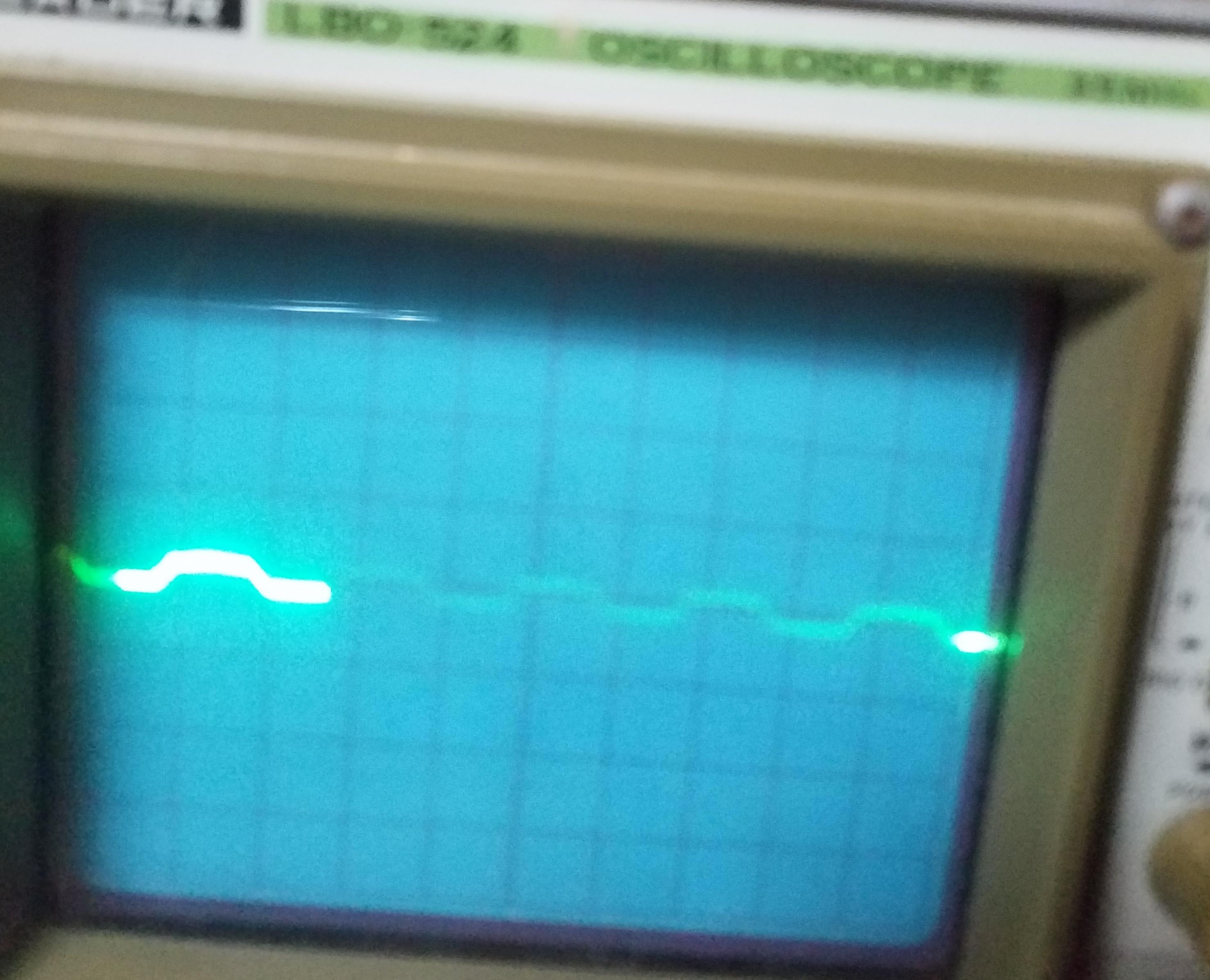

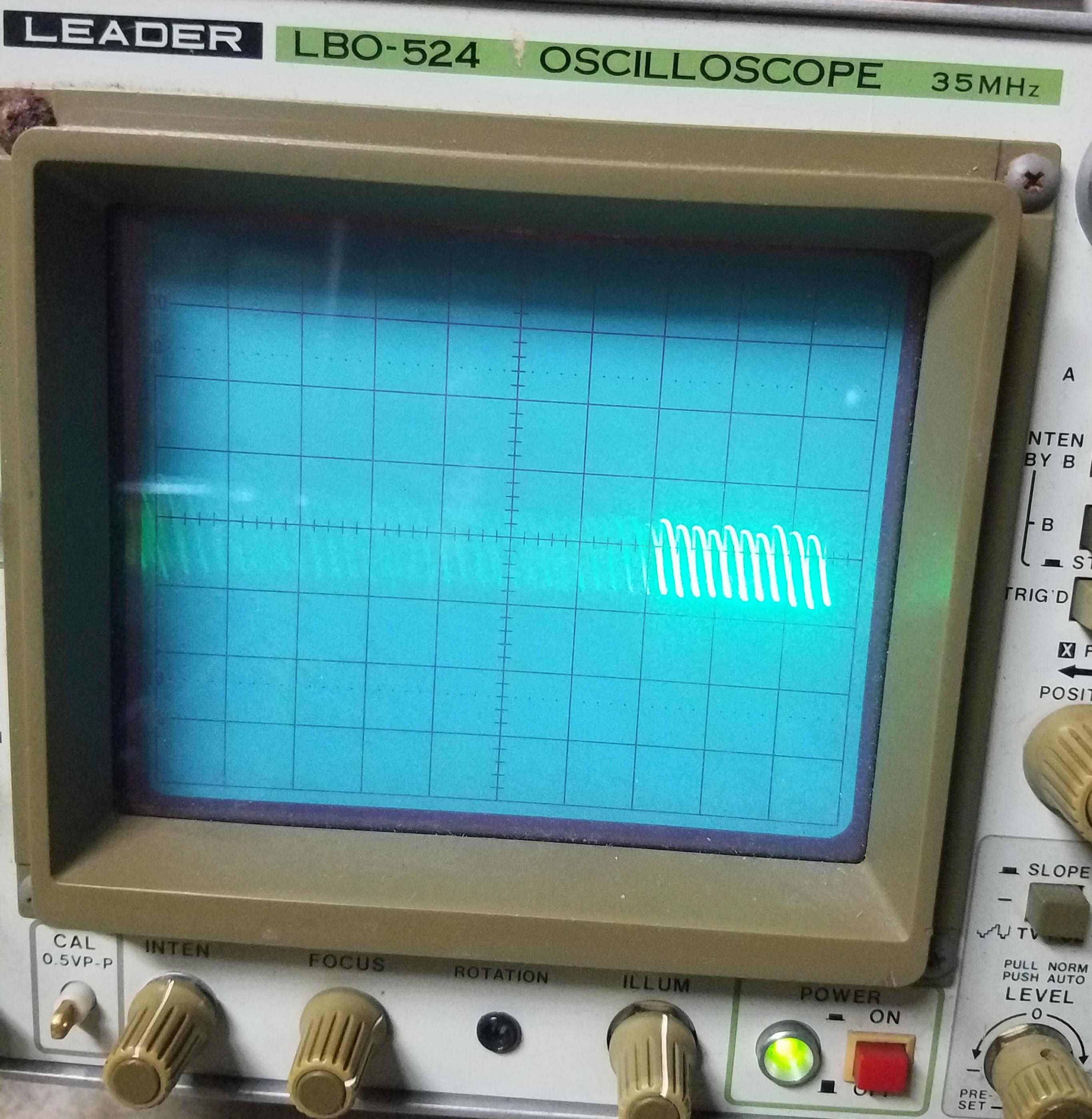

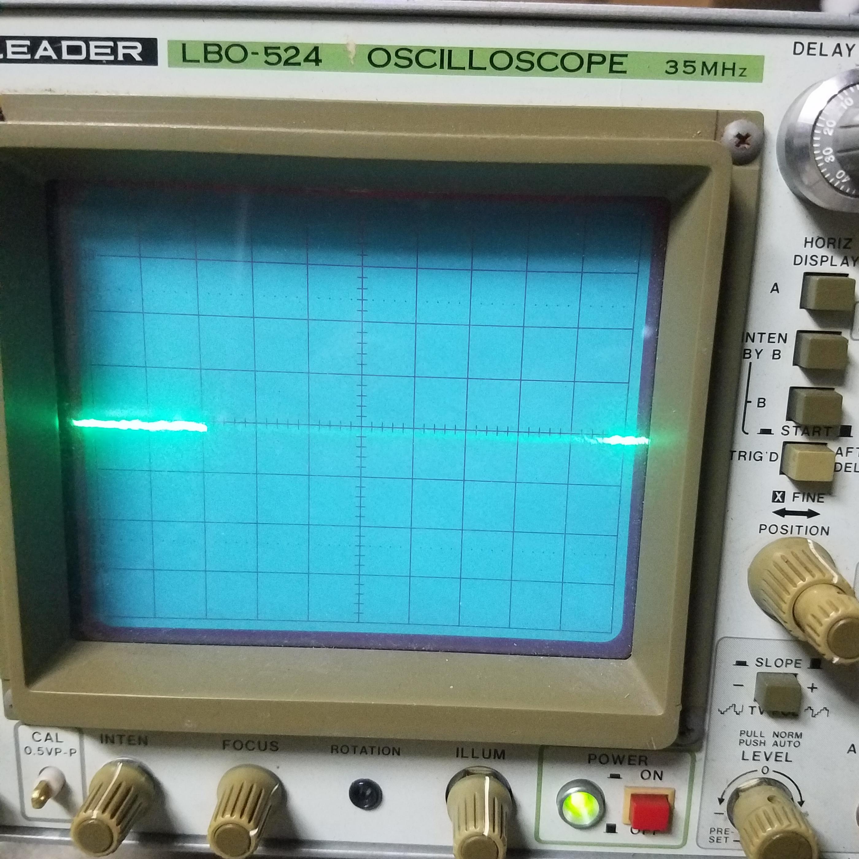

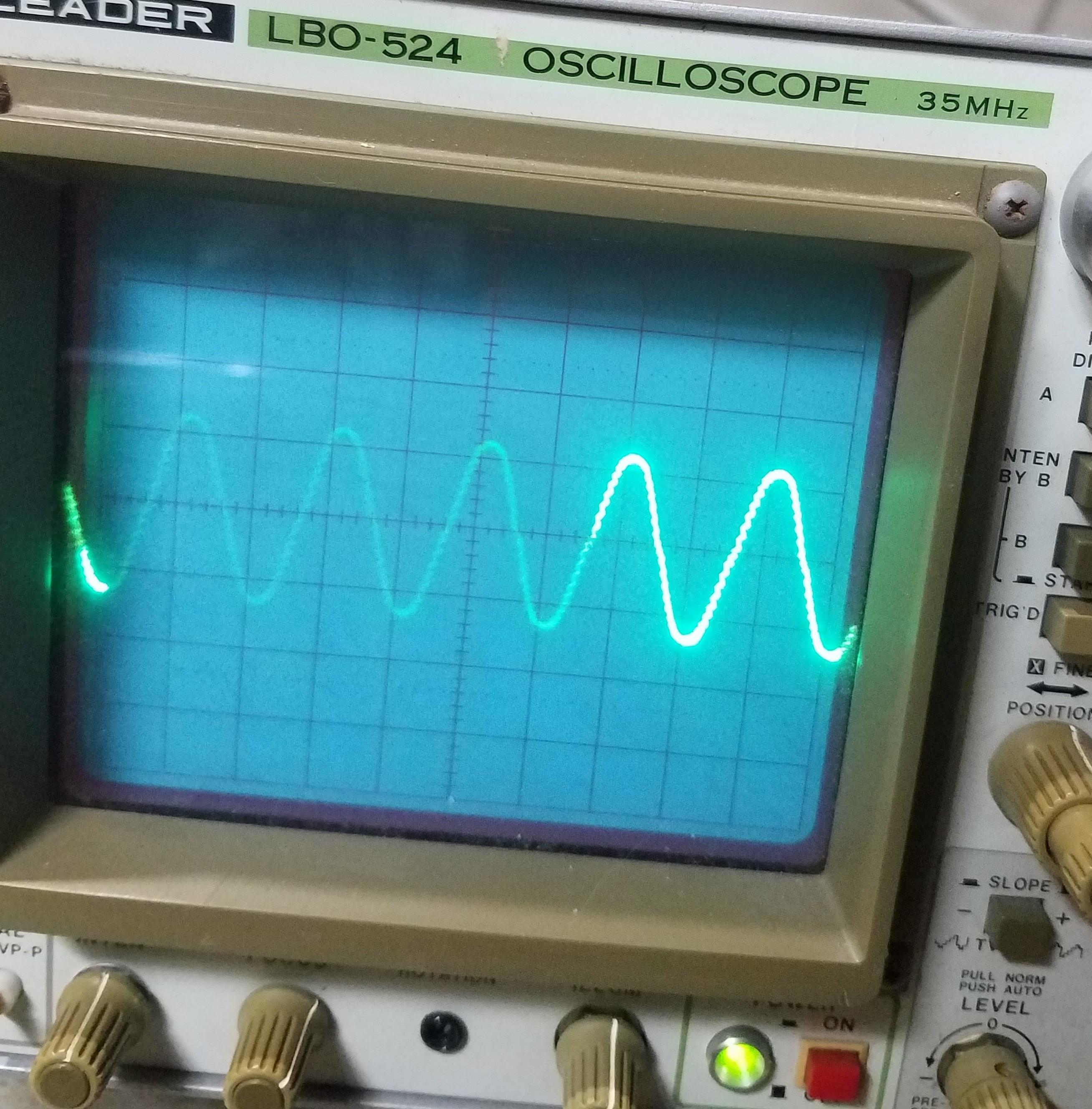

What are your thoughts on what my scope is doing? When I first power it on, the screen looks like the first photo. After it starts warming up the the waveform slow starts getting smaller until eventually it is a flat line. After that it seems to function basically as it should.
As to your question in post #22: As I mentioned, now when I power the amp up it only produces a waveform form for about 30 seconds. After that, if I shut it down and turn it back on it only produces a waveform for about one second. If I let it sit for 10 minutes it is back to square one again. Catching from the start the signal on pin 3 of the NE5534 looks to be staying clean.
I don't know what's wrong with the scope. I only know what I have to know to keep mine running.

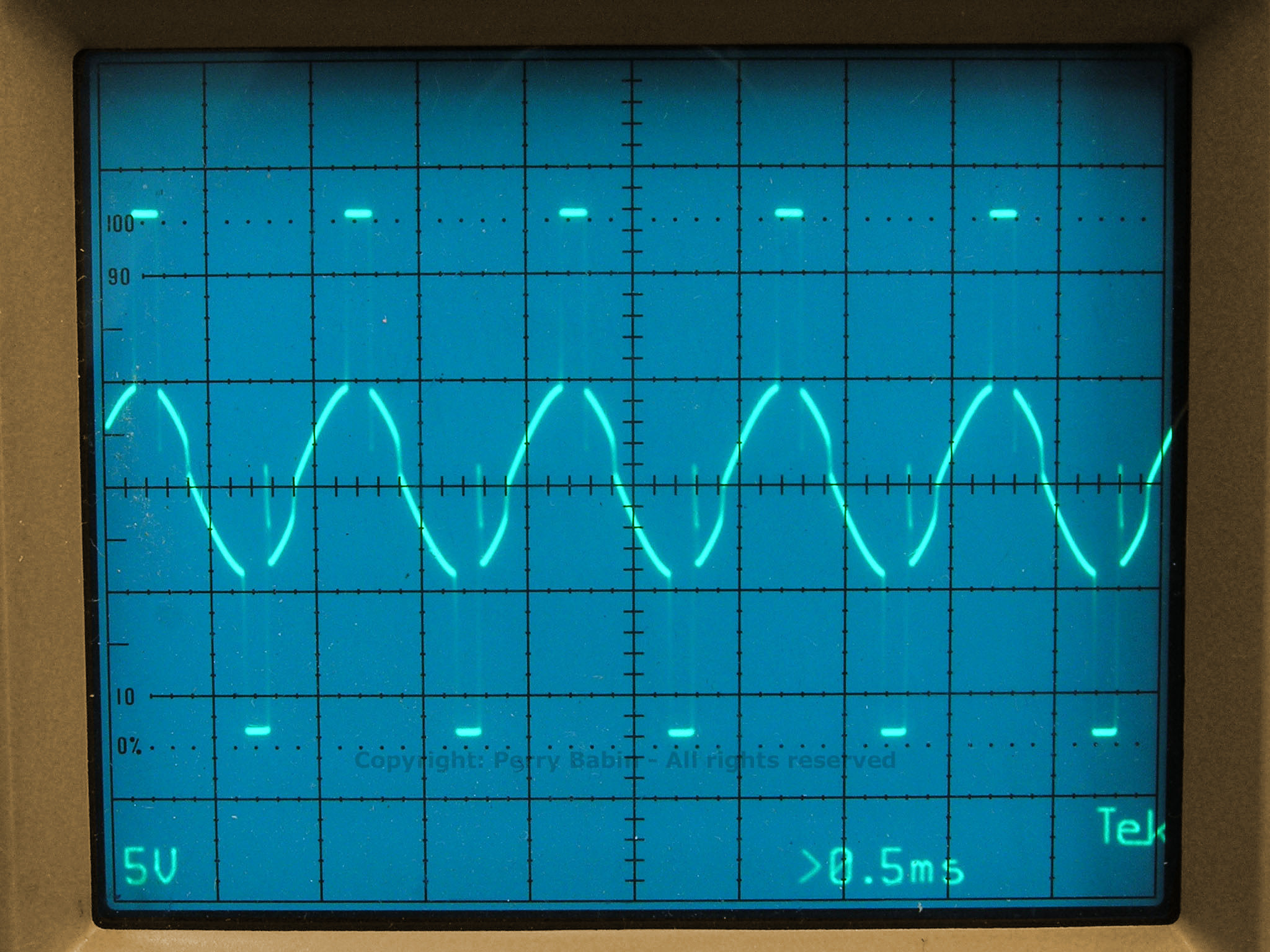

When the amp starts to clip, the output of the 5534 should go from a slightly distorted sinew wave to a highly distorted waveform that swings to the supply rails of the 5534. Is that what you're seeing on the output terminal of the 5534?

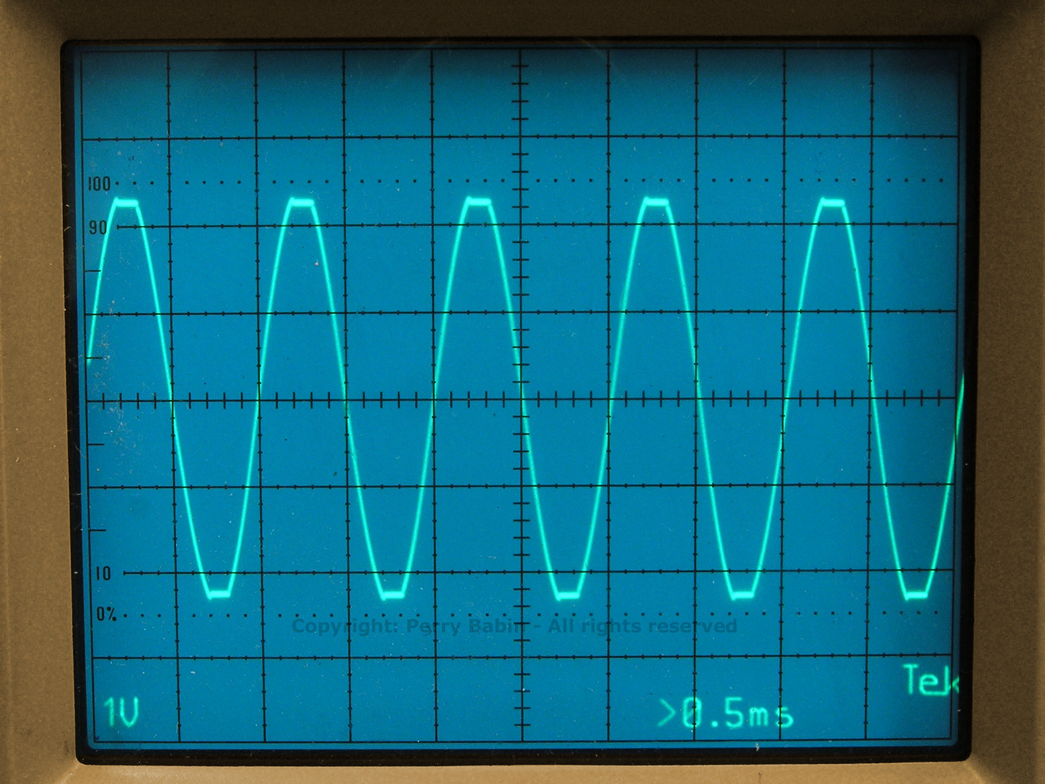

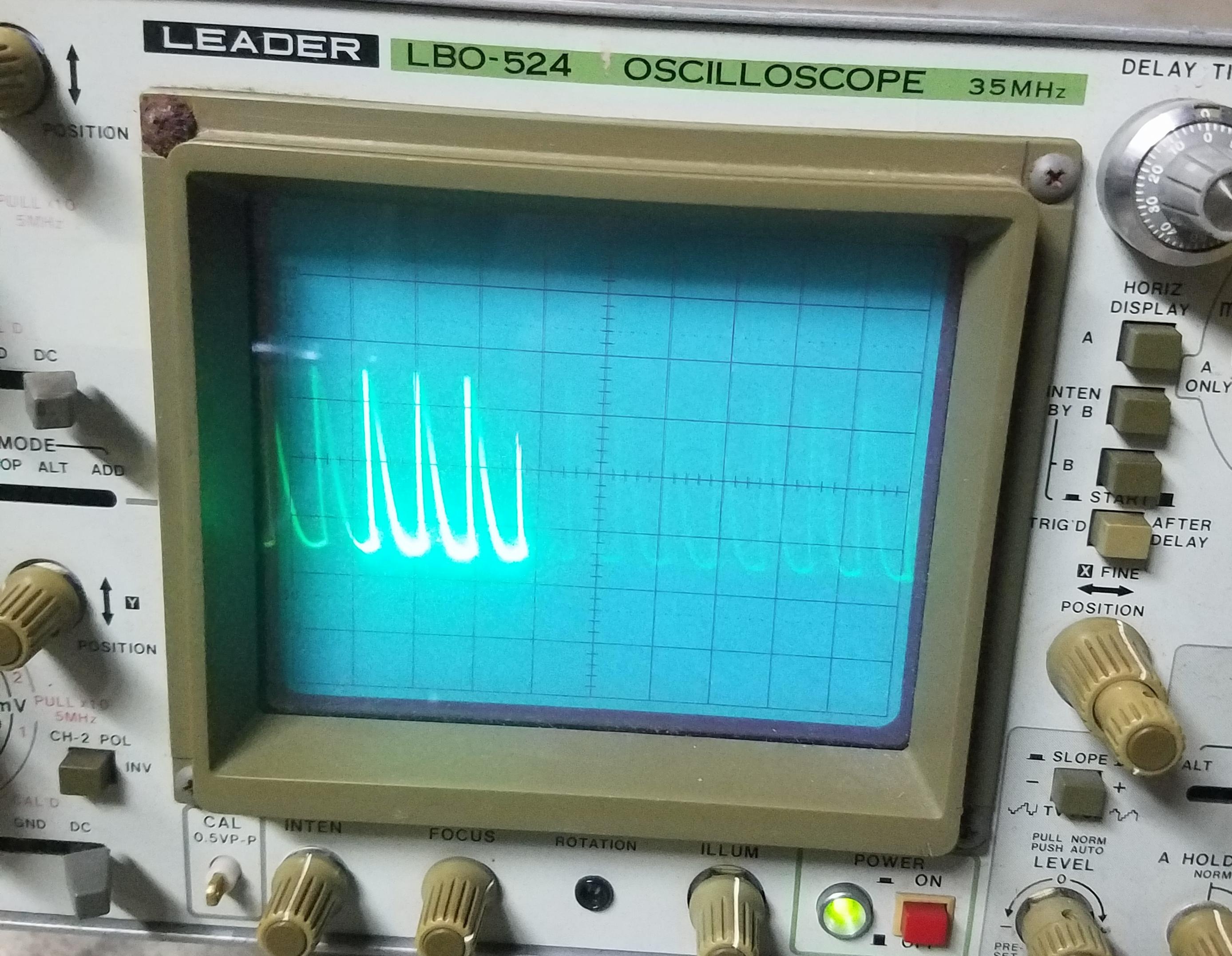

I attached photo's of the wave form on the output of the 5534. Starting with it not clipping to clipping. I noted during this that when the amps drops down to virtually no out put I also loose signal on the output pin of the 5534.
The image on the right shows the drive from pin 7. It's a rough sine wave up to the point when the amp starts clipping.
The left image is feedback from the output of the amplifier that's driving pin 6 of the 5534.
When the amplifier starts to clip, the drive signal goes from a sine wave-ish signal at a relatively low level (about ±5v) to a large spike (as far as the op-amp can drive) as it tries to compensate for the distortion caused by the output reaching the rail voltage.

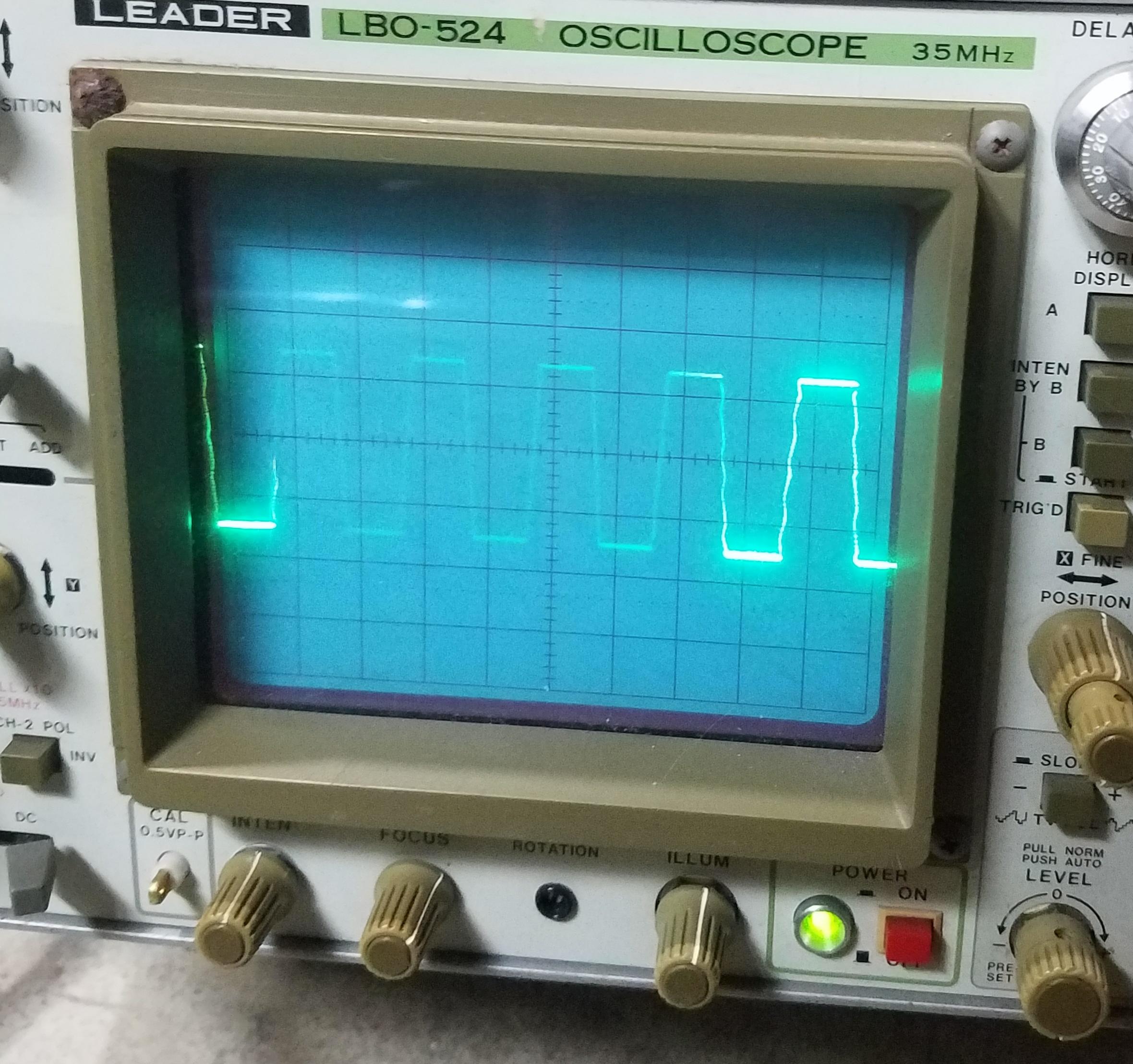

The left image is the feedback, showing distortion from clipping. This is driven back into the inverting input of the op-amp (pin 2 of the 5534). The right image shows the output of the op-amp (pin 6 of the 5534).
What you should be looking for it input to the op-amp that remains clean (pin 3 of the 5534) and an output on pin 6 that drives as far as possible at the onset of clipping (visible on pin 2 of the 5534).

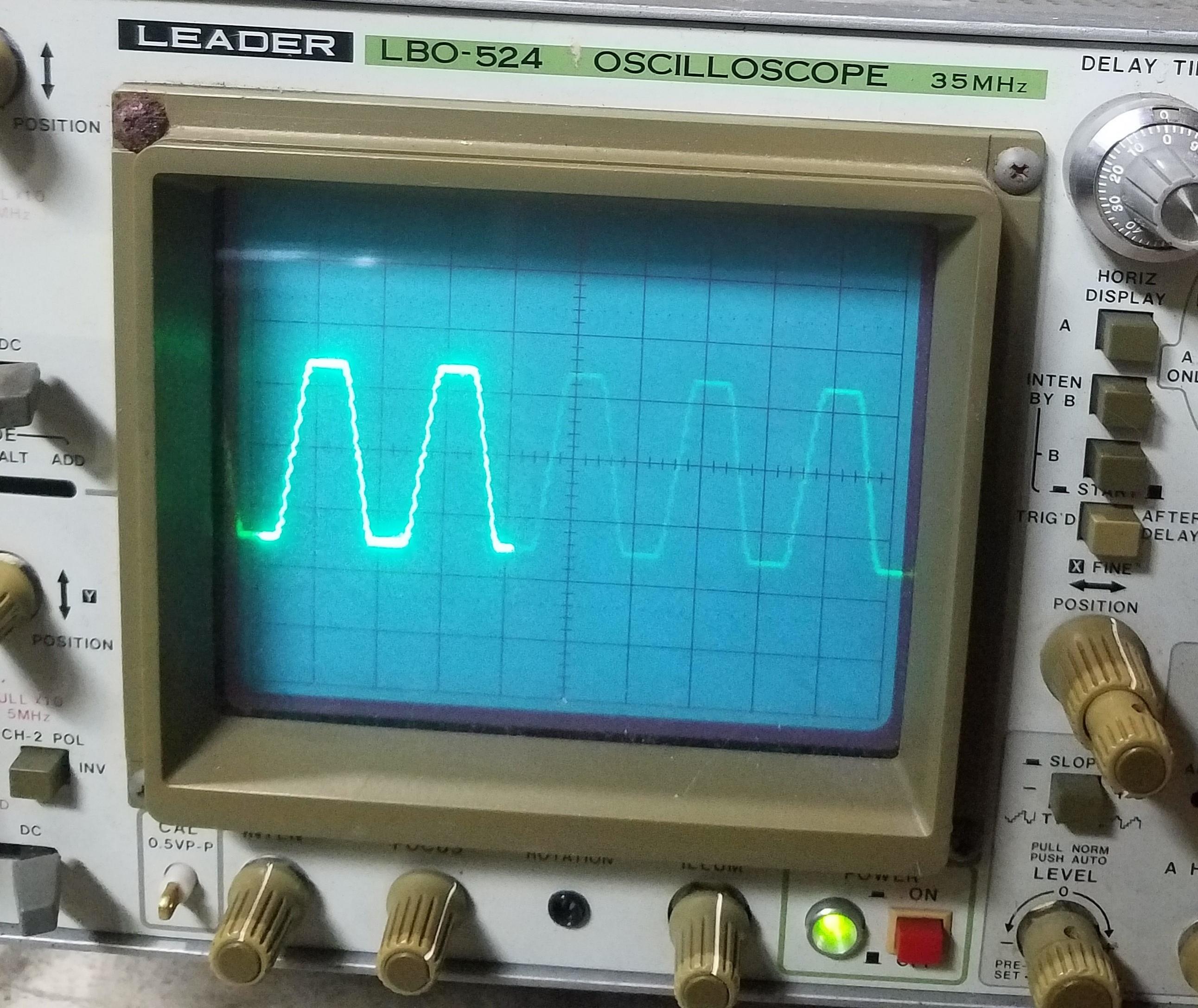

The photos in post #30 are of pin 6 of the 5534. The attached photo is of pin 2 of the 5534 at the onset of clipping.
Sorry about the blurriness of the photo. It is difficult to get a photo with only having a few seconds in which to take it before the amp drops output.
When photos of waveform are posted, the scope settings need to be included.
Unless you're 100% sure that the scope is relatively close to being calibrated, touch the B+ terminal to confirm that the deflection agrees with the settings.
What was the vertical amplifier setting in post #30?
