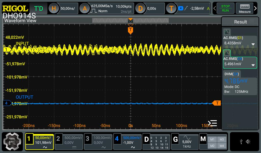

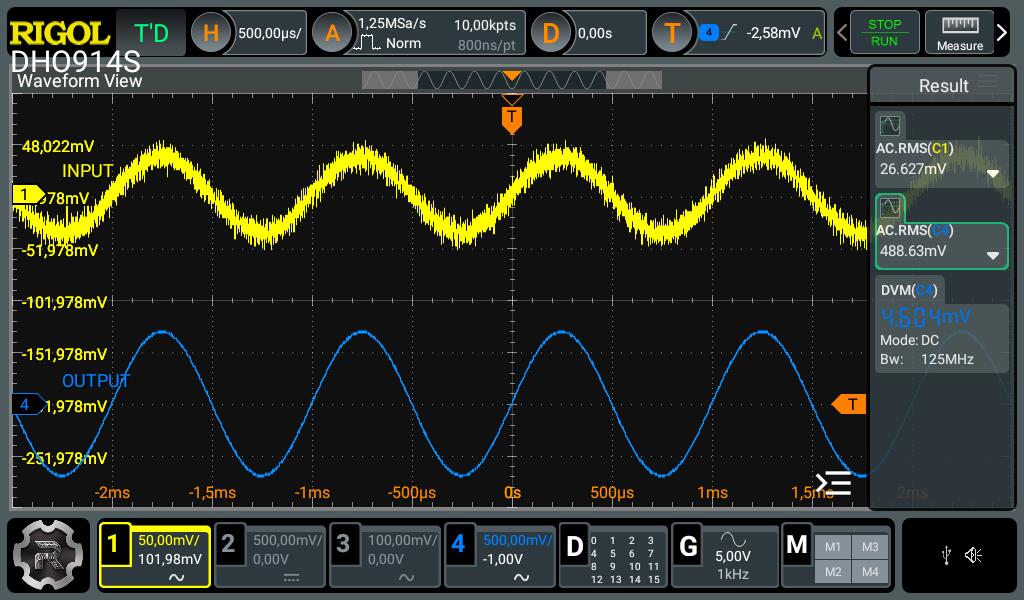

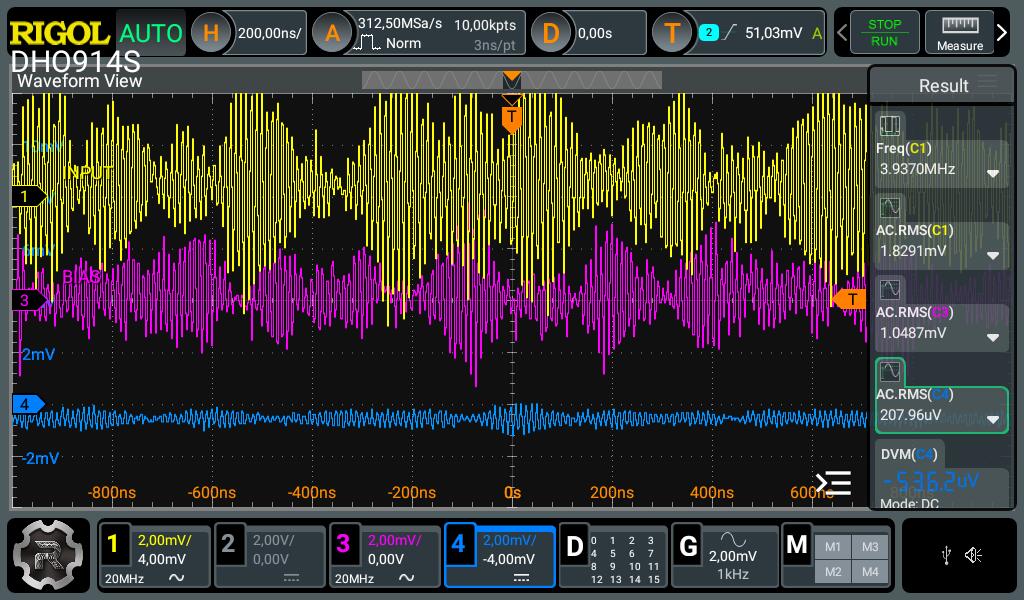

I wonder if this is not just noise caused by the signal input level that is low. When I inject 1kHz the oscillation observed is still there but only if I stretch the time base to the extreme...Now that's something maybe revealing... After a test, I turned off the Power Supply rails AND the Power Supply themself and the oscillation is still present. The circuit isn't alimented in DC and my scope can still see the oscillation at the input. I even try the second channel with it's new probe and I have the same result. This oscillation seem to come from nowhere!
Then, the 100MHz seems to be common mode pick up. Try reducing the scope bandwidth to 20MHz.
However, I'm not in a hurry to say the amp is stable or without other issues, as you still do pick up a burn smell, and VAS transistors unexpectedly heat up.

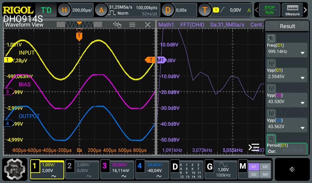

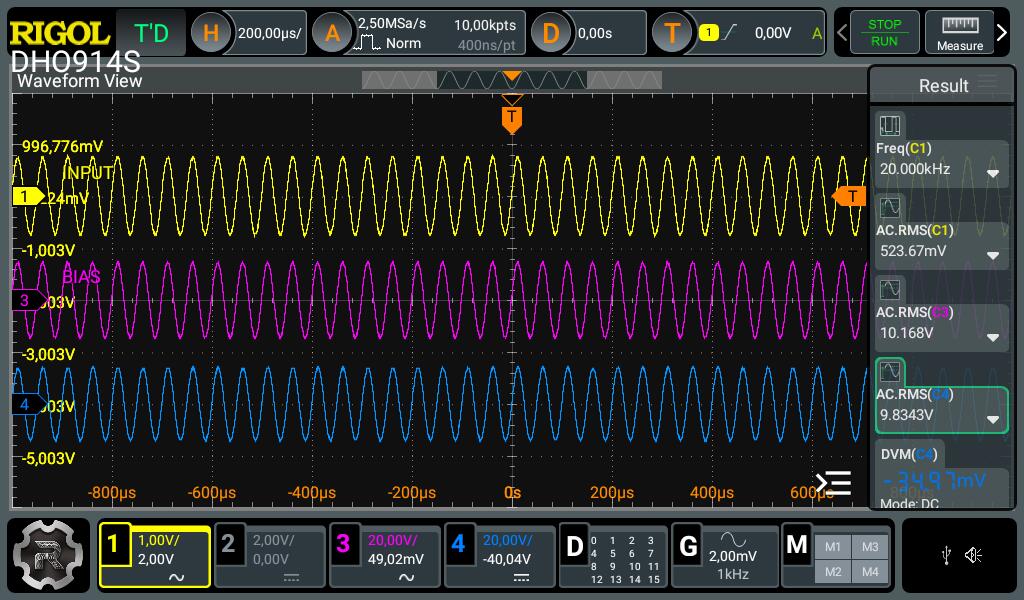

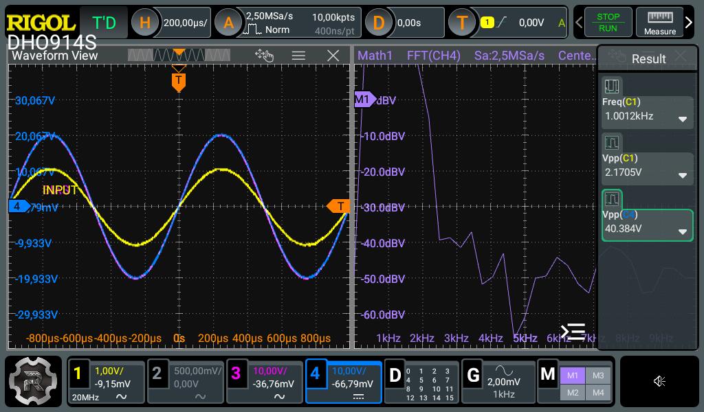

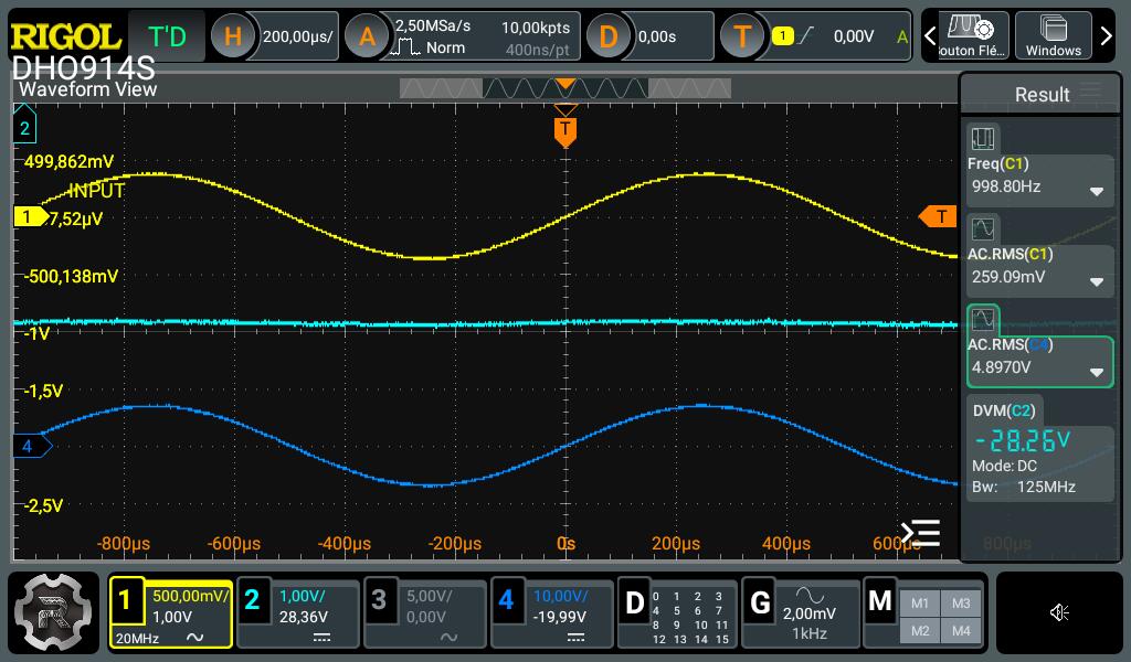

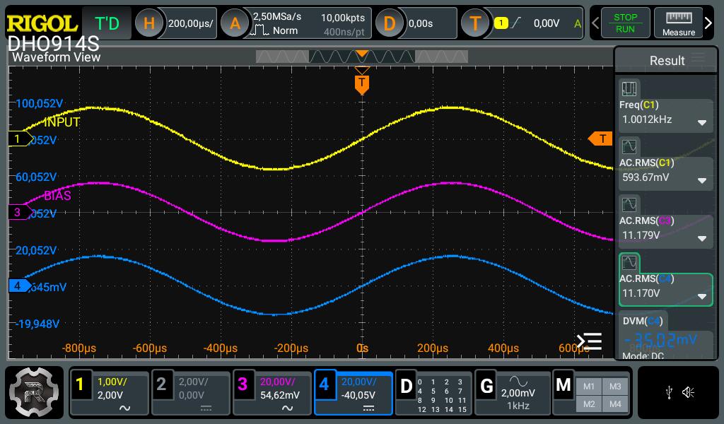

Here is a picture of the actual measures with the modification above. The DVM of the scope measure -526uVDC at the output. My Multimeter measure -5.979mV. The noise at the input; 1.8291mVrmsrms give 1.0487mV at the BIAS TP5 and 207.96uVrms at the output. Is it time to test with a signal?

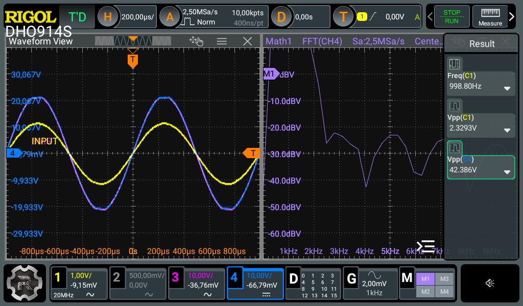

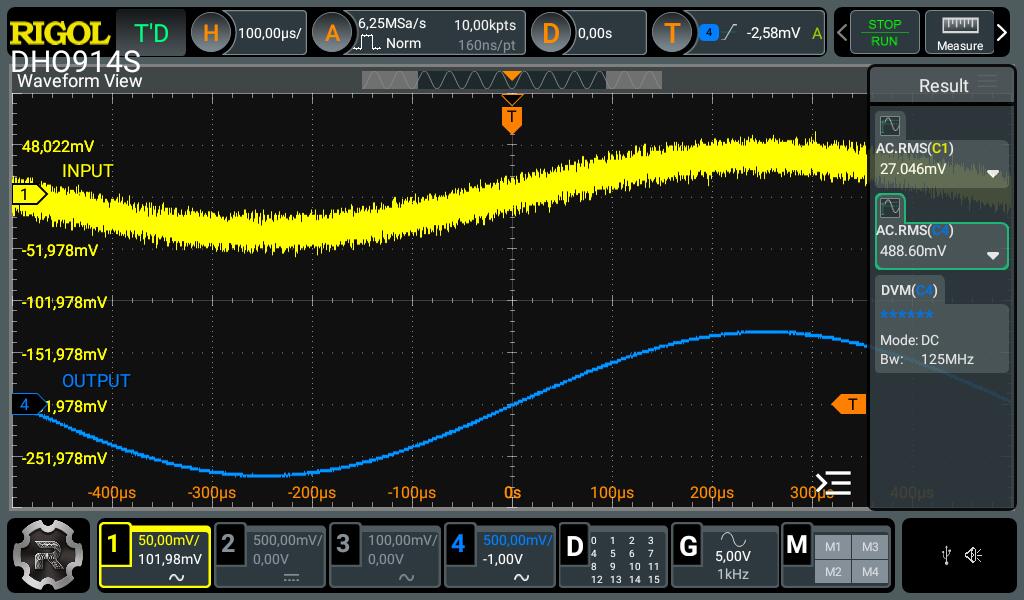

I tried to inject a 1 kHz signal at the input. It look's good. I was able to raise the input to 593.7mVrms with a clean output of 11.170Vrms. Raising it more started to distort. The voltage across R503 is stable around 1.4 VDC until I raise the frequency. I don't remember at witch frequency the voltage start to raise across R503, but at 20 kHz I measured 4.131 VDC across R503. It started to be hot at the finger there but no transistors become enough hot to be apparent to my finger.
The DC voltage at the output was at -35mVdc but I am not totally confident with this DVM precision on the scope yet.

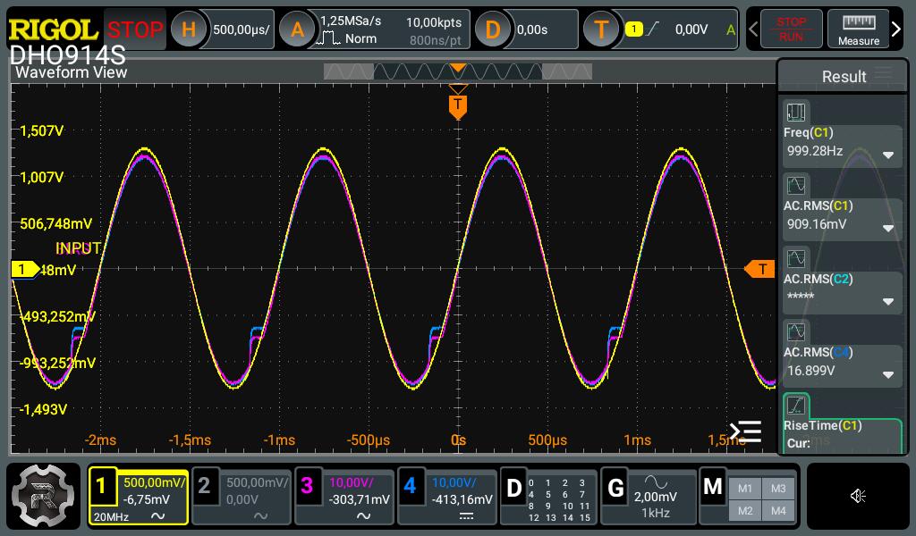

You probably did not realize the Zobel network (10-ohm and 0.15uF) at the output can become a significant load to the driver transistors, now de-facto output transistors, at higher frequencies and at sufficient signal amplitude. At 20KHz 10Vrms the load current would be about 160mA rms, far greater than enough to load the driver transistors out of class A, into class B operation. That was why the rise in measured DC voltage over R503.

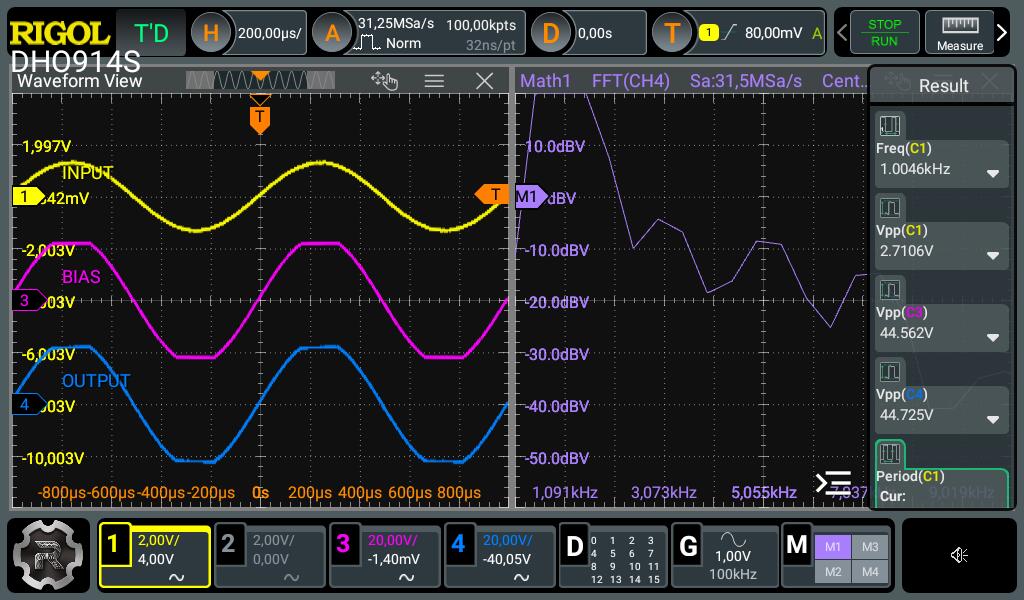

At 1KHz I would expect a distortion-free swing at least -25V - +25V at the output. I don't know why it distorted at a much lower level.

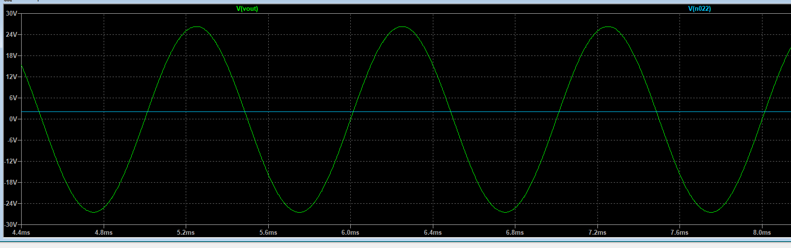

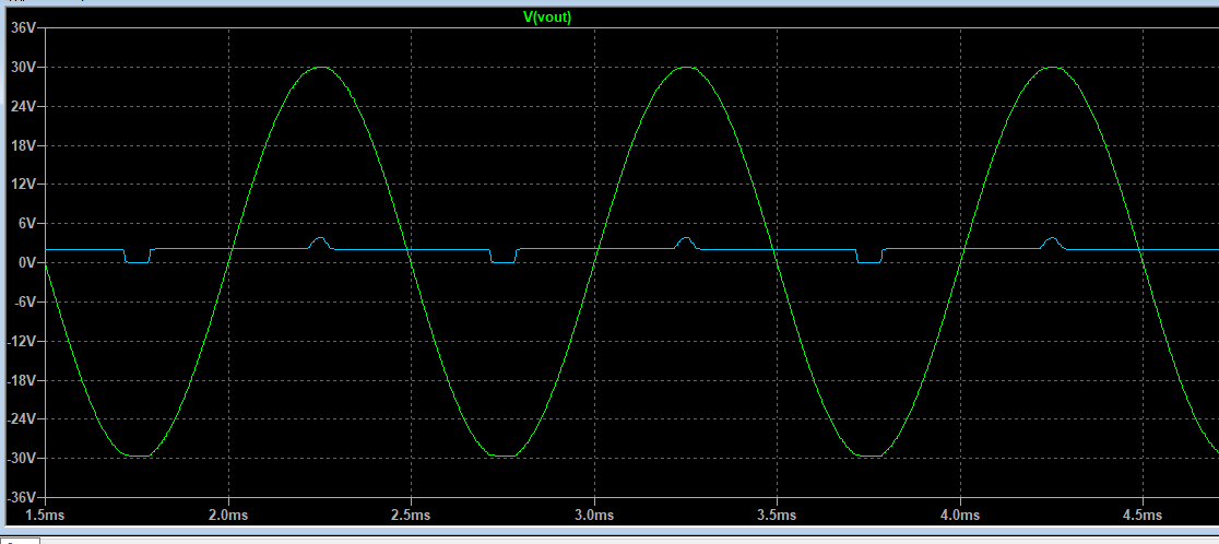

By probing the new 1Kohm resistors protecting the VAS stage you can tell if clipping is actually taking place.
This is an expected waveform at +/-25V p-p output, without clipping. The blue trace would be the voltage at collector of Q301. It is a straight line at 2V, meaning working at a constant 2mA
Ic.
This is an expected waveform when clipping starts to kick in. Notice during clipping the Q301 would either shut off, or try to overdrive the VAS but gets clamped by Q302 (Q302 action not shown).
Likewise, you can probe Q401 and see what's going on there when the distortion takes place.

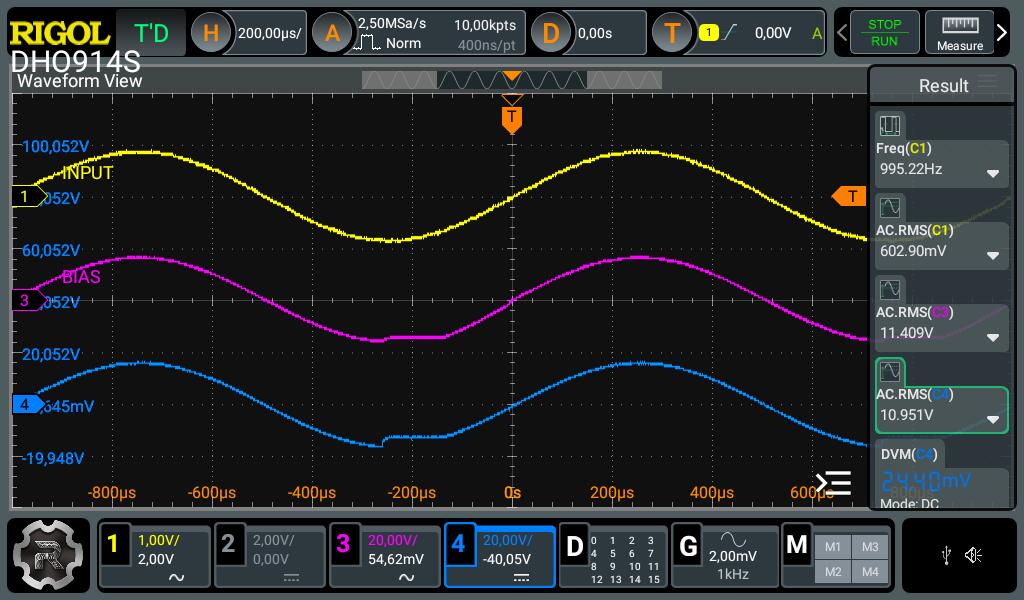

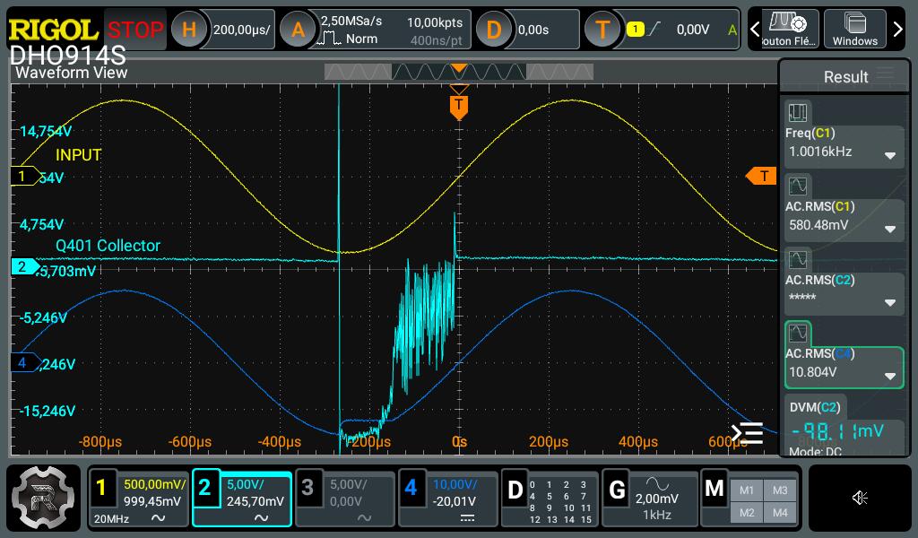

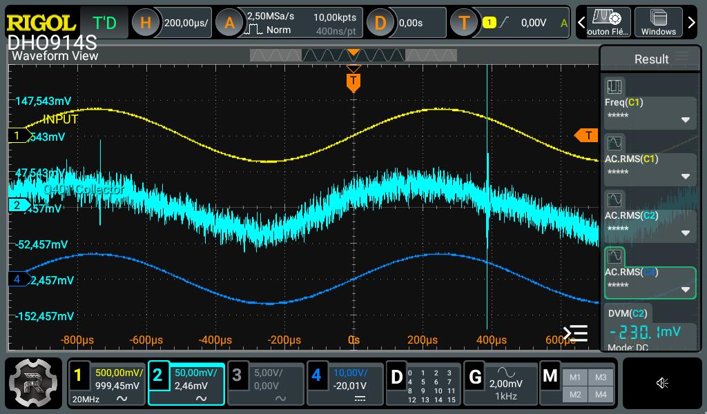

I probed Q401 instead of Q301 because the collector is more accessible. Resistors 1K are soldered under the PCB and aren't accessibles. The first screenshot is with 250mV at the input and the voltage across R503 is stable at 1.062 VDC. The voltage across Q401 collector is at -28.3 VDC (VDM measurement at C2 Cyan).
EDIT: I just noticed that my probe was 1X while set to 10X. That would explain the 28.3 VDC instead of 2.83 VDC. To confirm...
If I measure only AC and raise the sensitivity of the channel, I can already see a little sine wave on the Q401 Collector but no distortion.
At 500mV at the input, I measure 68mV at Q401 Collector. The output sin wave isn't distorted yet but I can see a beginning of distortion at Q401 Collector.
At 550mV at the input. similar , but if I raise it 10 mV more, the Q401 Collector is raising high and the Power Supply current raise also. So I raised it temporally and stop the scope acquisition, then lowered it down to 130mV. Here is the capture.

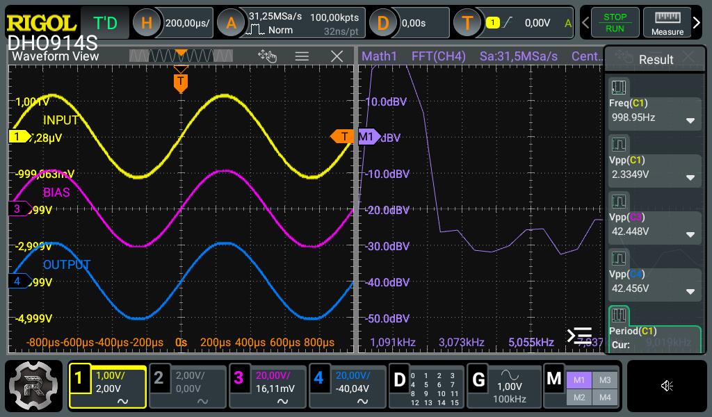

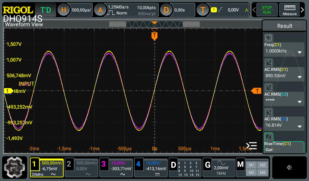

I replaced all transistors in the IPS. I get the same results. At 550mV at the input the signal is clean but at 560mV the distortion bring in and the voltage across R503 start to raise to 3 VDC and above. It goes down to normal as soon as I lower back the input to 550mV.

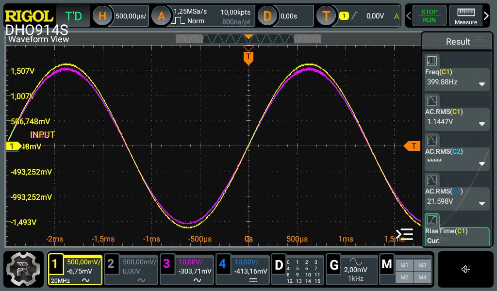

I realized that my generator was set to 600 Ohms. Once configured to HiZ, I am able to raise the input to 610mV before the distortion came in. So it looks like an input impedance problem...
If I change the Frequency for 400 Hz, I am able to raise the voltage input to a point where the output reached 21.598Vrms.

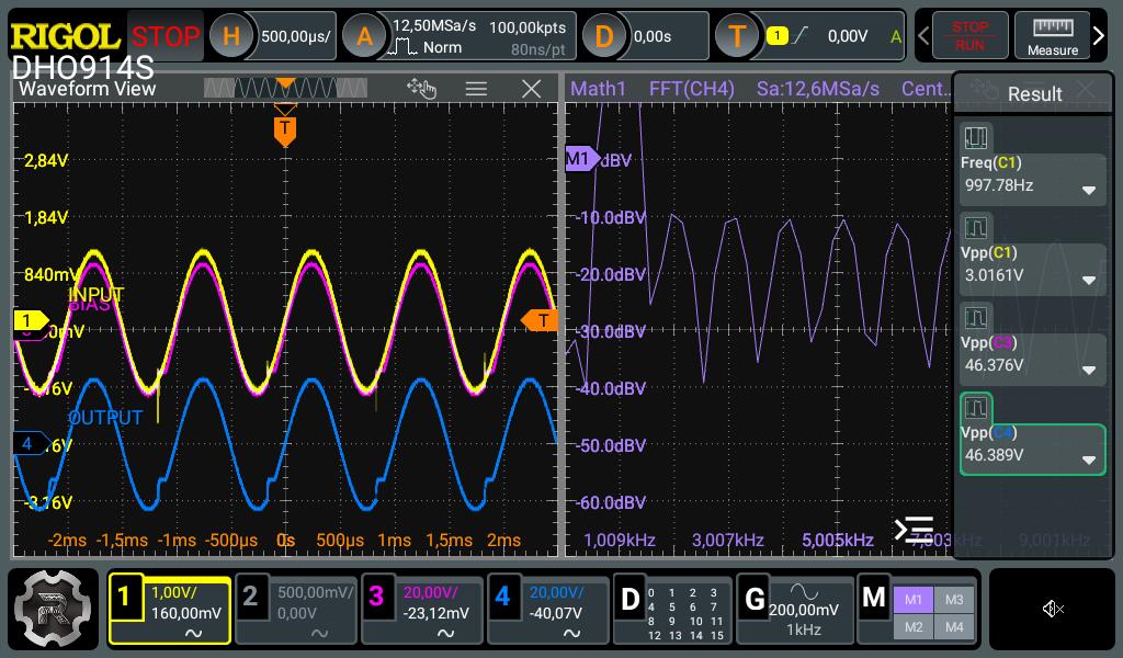

Back at 1 kHz but turning the RV1 BIAS fully clockwise, the voltage across R503 is around 0.3 VDC and I can raise the input to reached 16.814 Vrms at the output before distortion.
Above 1 Vrms at the input, the distortion came in...

@SevyThe voltage across Q401 collector is at -28.3 VDC
What we want is the DC voltage ref GND at Q401-C, so that the static DC operating current could be easily made out by Icq401 = Vcq401/1K
However, assuming power rail is at 35V, assuming Q402 did not kick in (it appears so from the scope shot), at 28.3V Vce Q401-C would have been too much apart from GND, or too high a standing current. By design you should see -2V at Q401-C, or 2mA standing current. Something is not right.
Also, the clipping response is much more violent at that small overdrive level than would anticipated, and it lasted way too long before recovery, about 1/4 cycle of 1KHz! Something is really not right.

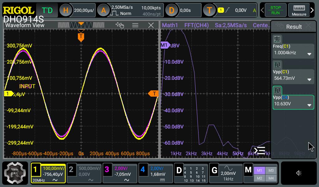

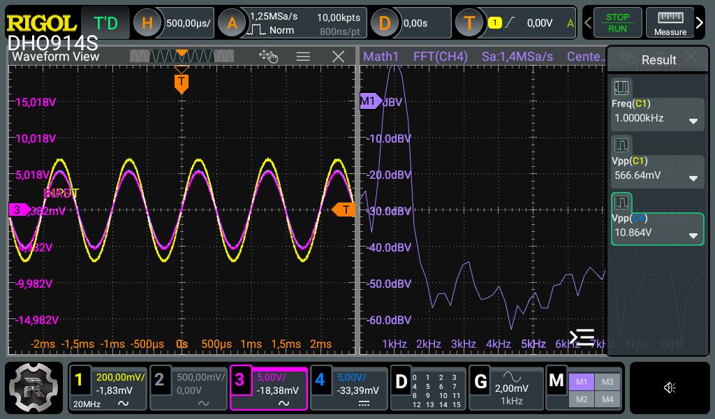

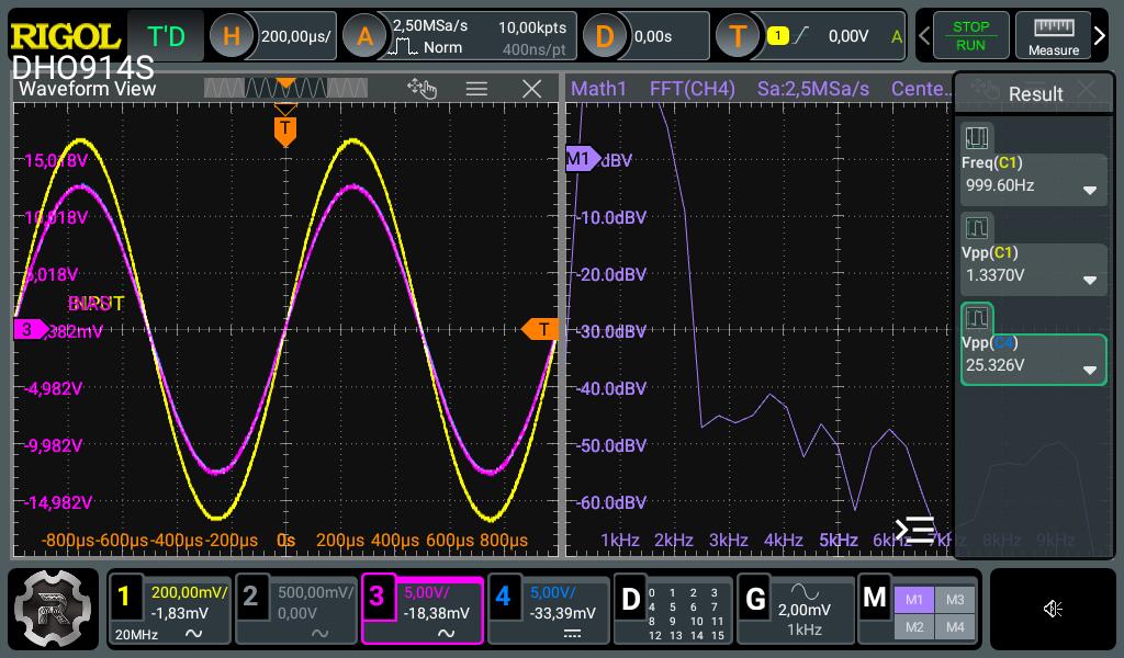

Then while doing new tests, I realized that all preceding tests was done by measuring the rms voltage instead of the peak-to-peak voltage, that is more representative to the rails supply voltage limits.

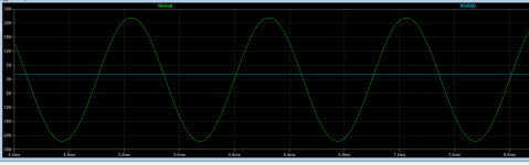

Starting at low +/-10 VDC for the rails voltages, the distortion was flat and symmetrical.
At 10 Vpp at the output, third harmonic is at -50dB:
At 10.864 Vpp at the output, third harmonic is at -45dB:

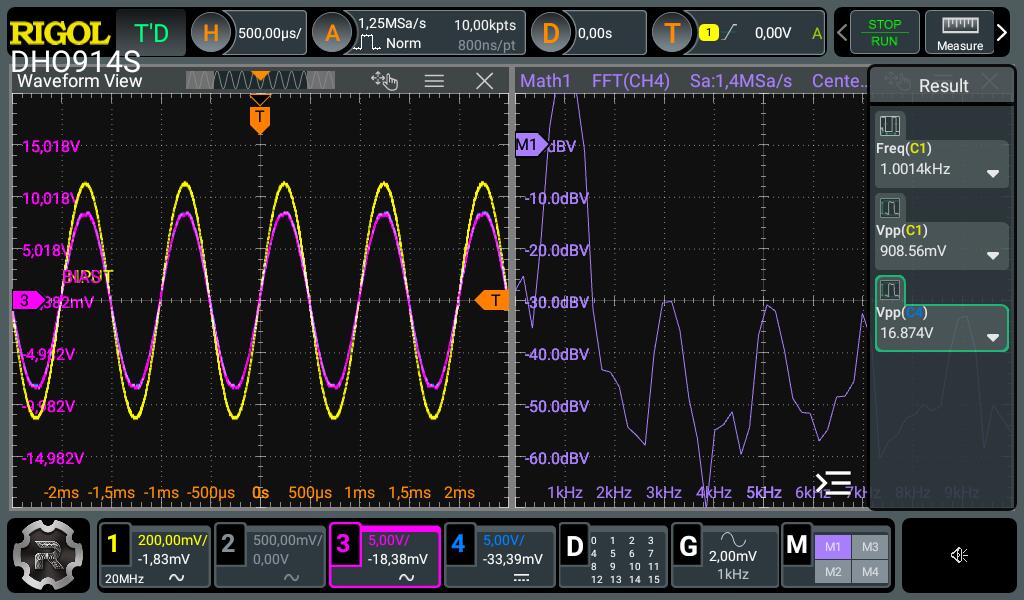

At 16.874 Vpp at the output, third harmonic is at -30dB and we start to see the flat at each top:

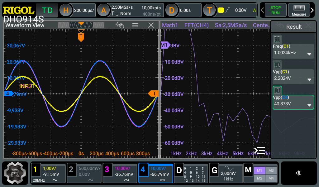

Pushing the rails at +/-25 VDC, the distortion was still flat and symmetrical.
At 25.326 Vpp at the output, third harmonic is at -42dB:
