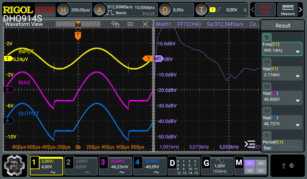

Interesting!While waiting for the delivery, if you'd like some solid evidence, raise the rail voltage from +/-35V to +/-40V while having the same amplitude, 1Vrms, 1KHz sine at the input. If the maximum peak output decreases we know the transistor breakdown took place.
I putted back the 620 Ohms resistor R6 and both R501, R601 in circuit.
I injected 1 Vrms at the input with +/-28 VDC at the rails. Distortion is flat and symmetrical.
Then I raised the rails to +/-29 VDC. just 1 volt more on each. And look at that!

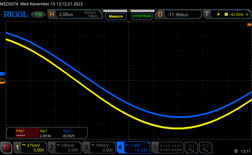

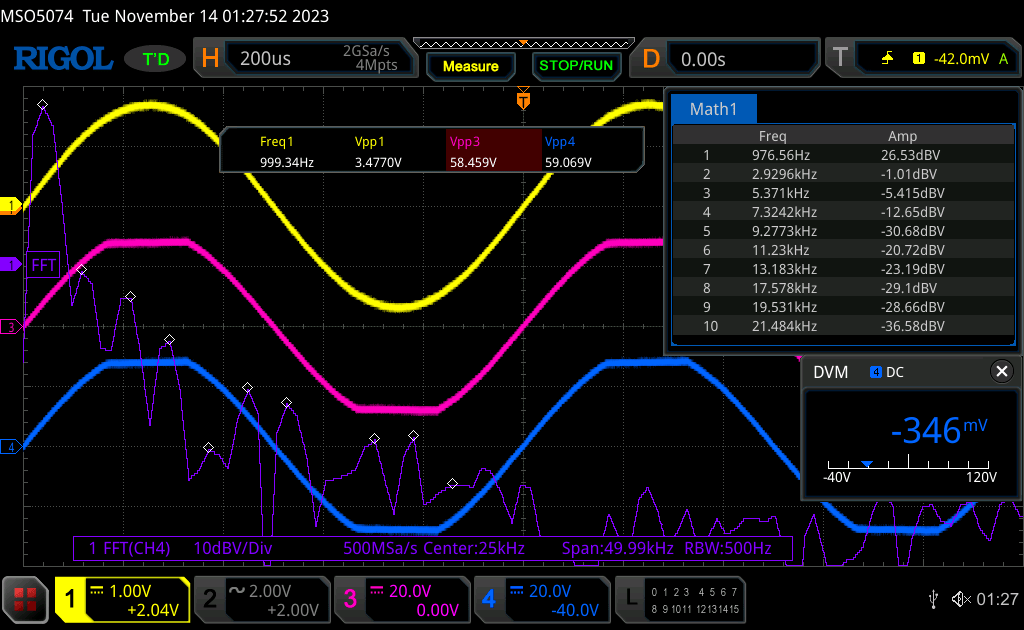

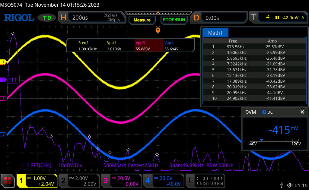

I received my transistors and replaced them.
I have my rails at +/-32VDC, the voltage DC at output = -415mV (DVM), the voltage AC at the input is 3.0106 Vpp at 1 kHz (Trace 1), and I have a clean sinus wave at the output at 55.694 Vpp (Trace 4).
DC voltage across R503 is stable at 1.04 VDC. There are no part that show heat on my fingers.
My FFT show the fundamental peak at 976.56 Hz at +25.53 dBV with the third harmonic at -26.48 dBV, that's (+25.53 - (-26.48)) = 52.01 dBV below the fundamental.
If push the input to create more distortion, the flat are very symetrical.

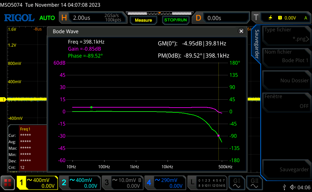

With the goods results above, I soldered back the two resistors R301 and R401 and the C3 capacitor. Then I raise the frequency and could reach 4.5 MHz without oscillation. I just had to lower the input voltage to preserve the 1.04 VDC across R503.
After that I installed the AWG License that I just received and did a Bode Plot from 10 Hz to 500 kHz to see the Phase Margin. It is really good in my point of view. The PM(0dB) value is the frequency and the phase where the gain fall down to 0 dB, the safe point before oscillation. At that frequency of 398.1 kHz, the phase shift is -89.52 degrees! From what I read in the book, we must make sure that we never reach 180 degrees before unity gain. I think we have achieve that ;-)

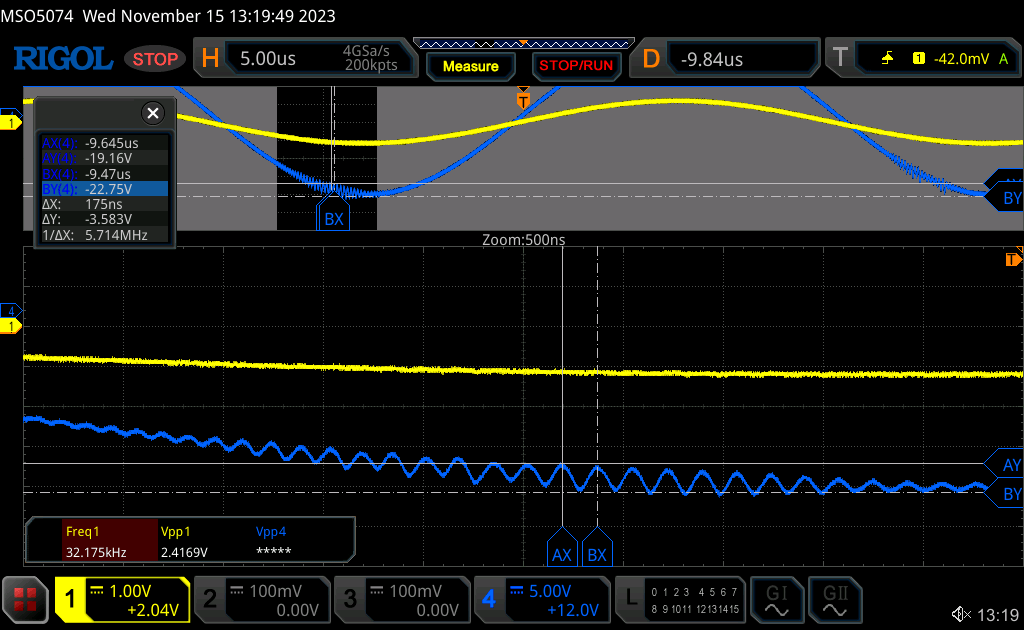

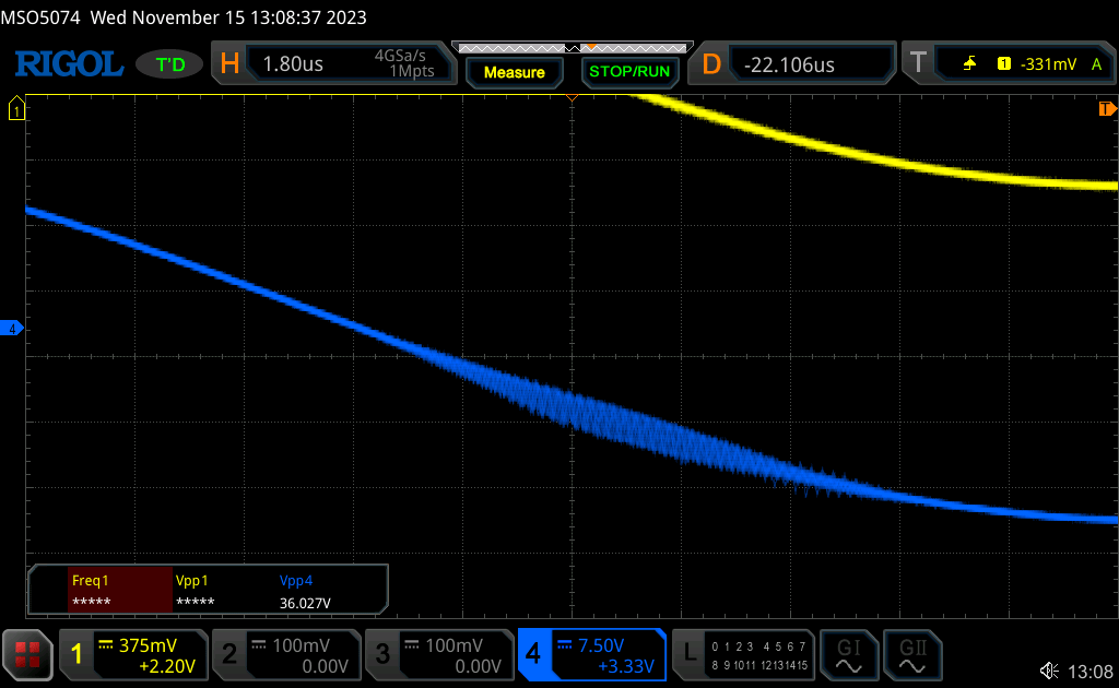

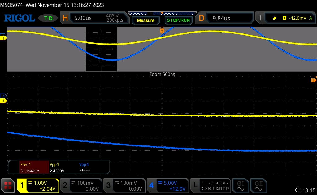

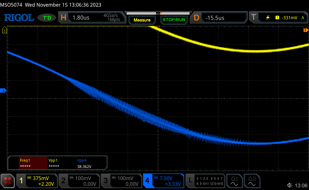

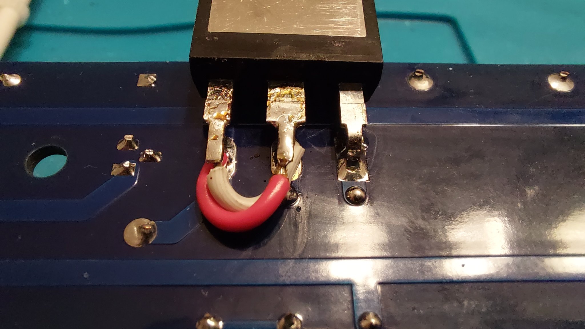

This morning I soldered back two output MOSFETs to make further tests. Everything was looking good for the voltage at 1 kHz. When I started to raise the frequency, I noticed an oscillation at the output around 22 kHz. On my new scope, I can zoom in with a rectangle on the touch screen.
From that point I could get ride of it by calibrating the BIAS. Then step by step in a loop I was raising the frequency until the oscillation came back, readjusting the BIAS, to the point where I had no oscillation at 31 kHz but could see the beginning of an oscillation at 32 kHz. And I wasn't able to adjust more the BIAS to get ride of it. Rails are at +/-32 VDC. Output at 38.62 Vpp.
The oscillation frequency is 5.714 MHz and the DeltaY 3.583 Vpp for a 43.032 Vpp output.
Any idea what would be the source of this oscillation?
Maybe this:

470 Ohms. You should be able to download the PDF at post #63I can't read from your schematics (too small) what gate stoppers you are using...
OK, so assuming you are using double die Exicon LatFets, these gate stoppers should not be identical (for P/N devices), or extra caps should be added to N devices.
For single die Exicon latfets they should be the same. Check the sheet what Cis they have.

I am using Exicon ECX10P20 and ECX10N20.
I tried replacing the 470 Ohms of the ECX10P20 with 220 Ohms. It was worse. I replaced the new 220 Ohms with 680 Ohms and it may be a bit better, but nothing really impressive.
I don't know what you mean by double die or single die. The Cis of the daasheet says 500pF for both.

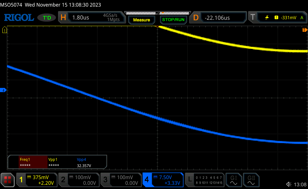

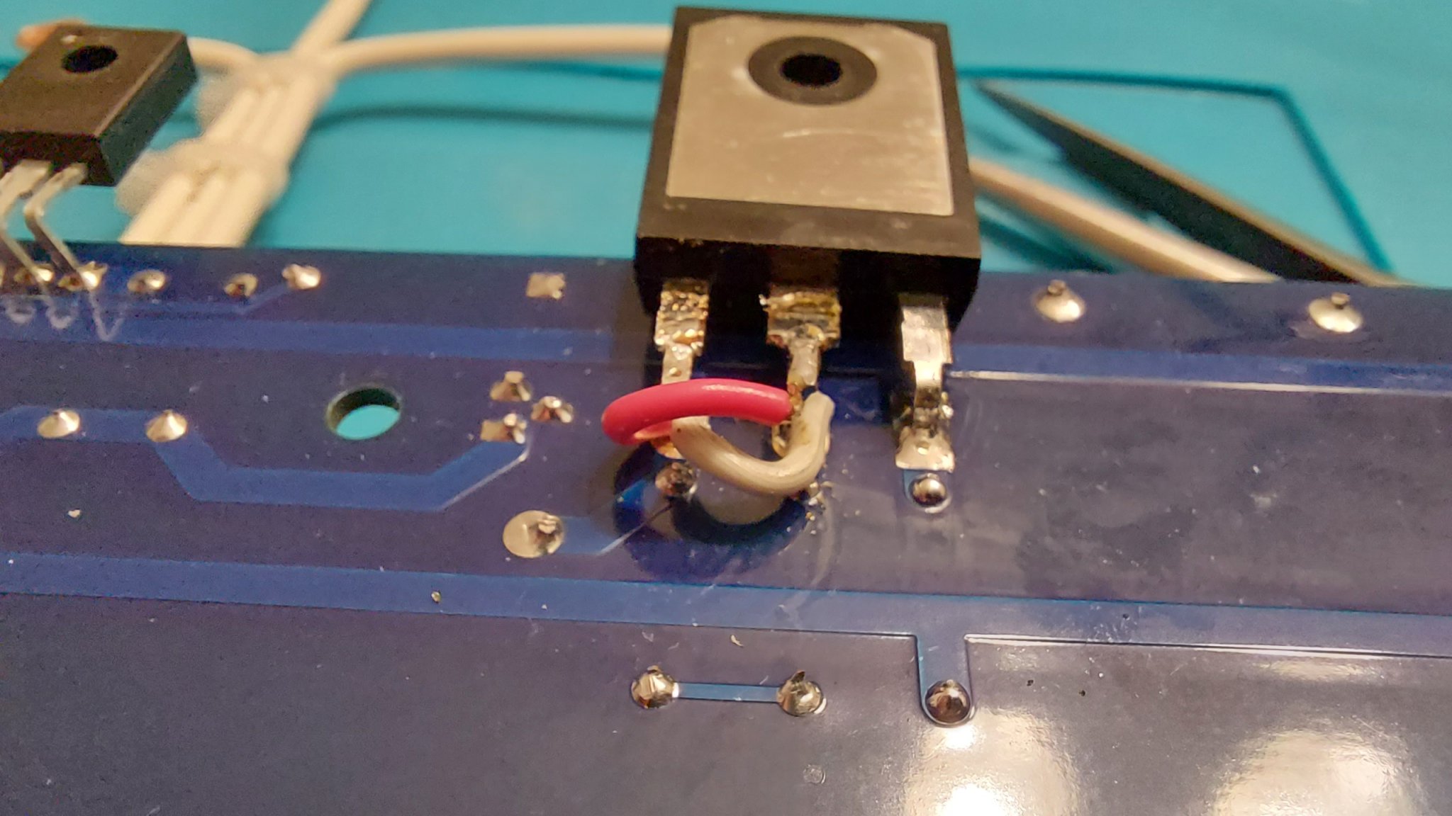

But I may have found my problem. Because I made a mistake on my PCB, by inverting the Drain and the Source of the ECX10P20, I must cross two little wires to revert my mistake. Like this:
So I tried to separate them bit like this:
And since this change, I can now go as far as 52 kHz before the oscillation came in, compared to 33 kHz in the preceding picture. These wires must create a capacitor between the pins...
