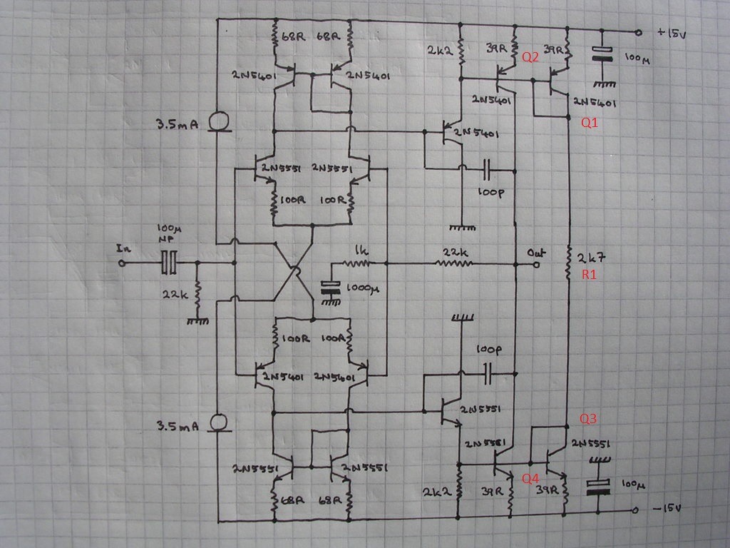

You should search DIYA for posts about symmetric IPS amps. The usual solution is to nix the current mirrors in favor of a resistor and most importantly, put a emitter degen resistor on the two VAS transistors. That could be by moving the VAS current limit resistors and transistors down from the upper cascode transistor to the lower VAS transistors. The current limit transistor collector would have to drive the first Darlington transistor.
The problem with a symmetric IPS is that the NPN and PNP LTPs always have a slightly different DC offset, so if the NPN LTP wants a higher DC offset than the PNP LTP, then the two VAS transistors are driven to a high current and if the NPN wants a lower offset then the two VAS are driven to zero current. You have two feedback loops that want (slightly) different results, so you need limits that are still usable operating conditions, ie limited DC gain.
I posted a bias servo idea in DIYA that measures the VAS current and biases both current mirrors, a common mode feedback that finds the desired VAS current automatically. I think Bob C has a circuit that adds some resistors to the current mirrors, along with VAS degen resistors, so that the current mirror voltage is somewhat defined. Search for "symmetric IPS".
The two-pole compensation is not exactly done my favorite way. I would return the resistors to the output and not to the supply rails. That gives a smother phase response and is less critical.
I would nix the voltage sense resistors on the output protection so that you have just a current limit, but that requires recalculation of resistor values.
As Hayk suggested, you should disconnect the FETs until you have a working stable amplifier unloaded. Then connect the FETS with a current limit on the supplies, ie the "light bulb" or large resistor kif you don't have a bench supply with current limiting. Shooting in the dark is a recipe for eternal failures.
You could also short the bias (VBE multiplier) until you get the VAS current under control, to prevent excessive driver current.
I'm not a huge fan of symmetric IPS because of the bias problems, and it does not provide much benefit, ie a single IPS can give PPM THD. And a symmetric design reduces even harmonics, which are desirable over odd harmonics. Instrument amps deliberately generate even harmonics.

steveu posted the remedy: replace the current mirror load with a resistor and add emitter degeneration to the VAS. That will bring the gain down.
I agree with all of steveu's points except the last: I like the complementary IPS because it cancels bias currents, provides symmetrical +/- drive, and faults tend to result in zero output voltage. It is safer especially for DIY.

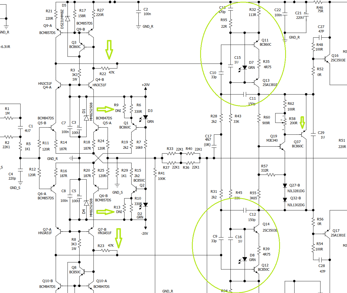

The original design use 2SJ162 and 2SK1058. I replaced them with ECX10P20 and ECX10N20I cannot read the MOSFET types in the schematic above.
ok, my comments were too abbreviated, so i'll try again.The Amp is already built with much effort, it is not the time for lamentation but resolution. The fellow is asking help to make it function not opinion about his choice.
elsewhere on this board is extensive discussion by others who have built this circuit (unsuccessfully) and folks with acknowledged expertise (such as Bob Cordell) on design changes needed to make a design of this topology work; otherwise it will not do so reliably. it is even possible one could unnecessarily damage expensive parts. not a pleasant experience in my opinion.
it would have been wise to review that info first, but that train has left the station...
so it would be prudent to review that info now to determine what fixes can be applied to the existing boards to increase the chances for this project to have a happy and successful conclusion, in addition to being more of an encouraging educational experience.
"i" think it is especially important to avoid the sour taste of frustrating failure for beginners and others interested in this hobby - we want more people to indulge and enjoy, not run away crying and screaming😢!
p.s. i just now see steveu's comments in post #21. read it closely! even for experts, it is difficult to simultaneously deal with trying to stabilize the design while troubleshooting its basic operation. negative feedback loops make it difficult to clearly isolate multiple problems so they can be resolved appropriately.

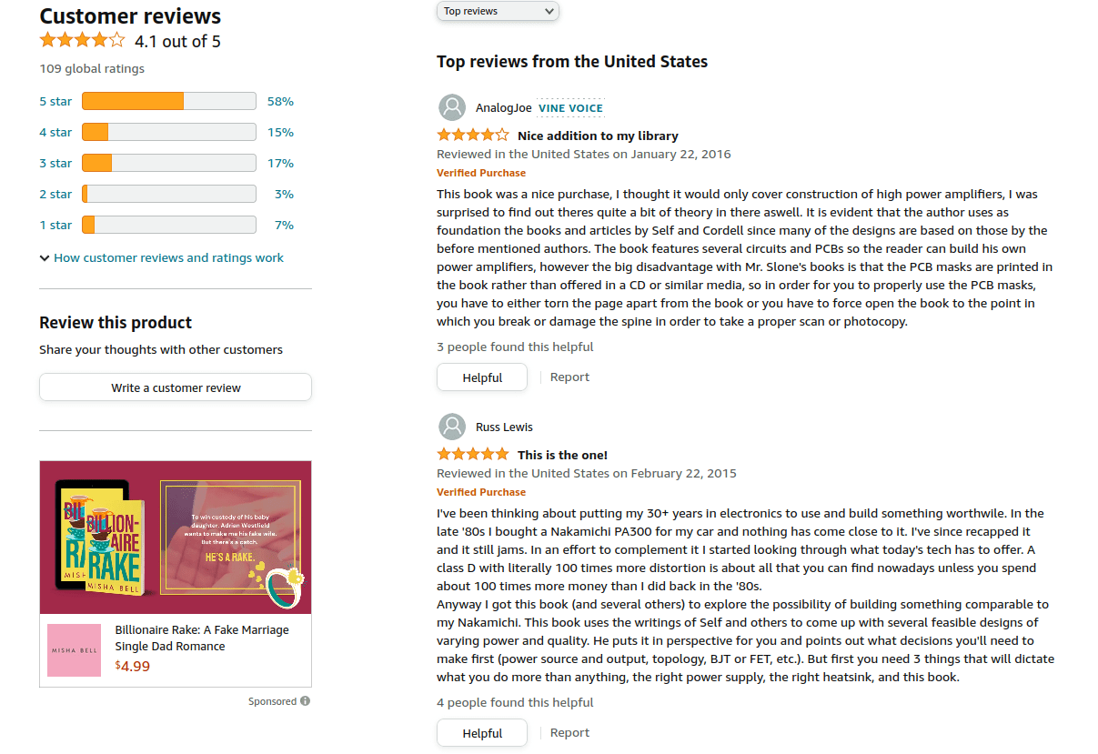

@mz543578854 From where did you see the 1-star reviews... When I look back at the book reviews, it seem for me that the book is well quoted... From the screenshot below...I really hope you will not be getting discouraged from this great hobby and maybe even get this amp to function. Looking at the (1-star) Amazon reviews, I would not be too confident. They say what the knowledgable folks above say, uncontrolled bias etc. Many circuits in the book seem to be really bad.

You need first to bias the VAS. Apply 1k resistor across R104 39ohm and measure across R304 39ohm the voltage to be about 400mv by adjusting the value of the added resistor.

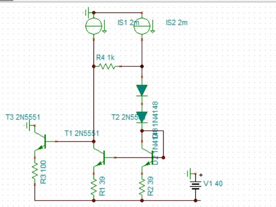

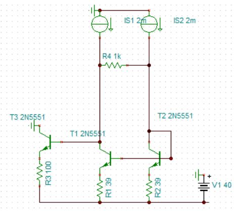

In order to resolve the undecided VAS standing current problem associated with Sloan's mirror-loaded, complementary push-pull LTP input-VAS stage, fellow member @chalky posted an approach a few years ago as attached and put it to a successful test. The idea is to force a standing current onto the VAS by mirroring a known, stable reference current into both the VAS transistors.
Apparently, in a real world build, the R1 that decides a 10mA reference current should be replaced with a quality constant current source circuit that is immune from the noise and fluctuation of the power rails.

Another way to fix the undefined VAS idle current issue would be to connect resistors between Q1 and Q2 collectors and also Q3 and Q4 collectors. This would be easy to add to your assembly.
True. That measure was suggested by many. Bob Cordell also has a discussion in his book 👍, where he cautions its sensitivity to the LTP tail current balance between the PNP and NPN arms.Another way to fix the undefined VAS idle current issue would be to connect resistors between Q1 and Q2 collectors and also Q3 and Q4 collectors.
I actually used that circuit, with amendments, in one of my own 200W amps, with success. And that amp has been serving in my living room system 24/7 for more than 8 years non-stop.
In a nut shell, what the shunt resistors do is to establish a determined relationship between the VAS standing current and the LTP tail current. In the example in Bob's book , the VAS current is about 10x the LTP tail current, decided by the ratio (~20x) between the degeneration resistor values at the VAS and the input stage current mirror load.
However, in a real world build, one may not feel comfortable with ratios like 10x for a VAS current to follow at.
Back then in one brief simulation with LtSpice, by artificially changing one of the transistor parameters by about 20%, I found the VAS current would "re-settle" at 3-4mA apart from where it was before.
In my actual amp build, several measures were taken to address the possible aftermath.
-- The VAS stage was changed to Hawksford cascode that has a higher value degeneration resistance, hence reduced sensitivity. (upon prompt from @Dave Zan 👍)
-- In the PCB layout the LTP tail current sources have trimming resistor provision, for easily trimming out the LTP current imbalance if needed.
-- The Vbe multiplier bias current controller gets a bleeder transistor. It would allow the Vbe multiplier to work at about 4mA, anything excessive would be bypassed by the bleeder transistor. This would eliminate the possible output stage bias current hike on the VAS current drifting.
-- Using matched dual transistors in the input stage, the input diff-pairs, the cascode transistors, and the current mirrors.

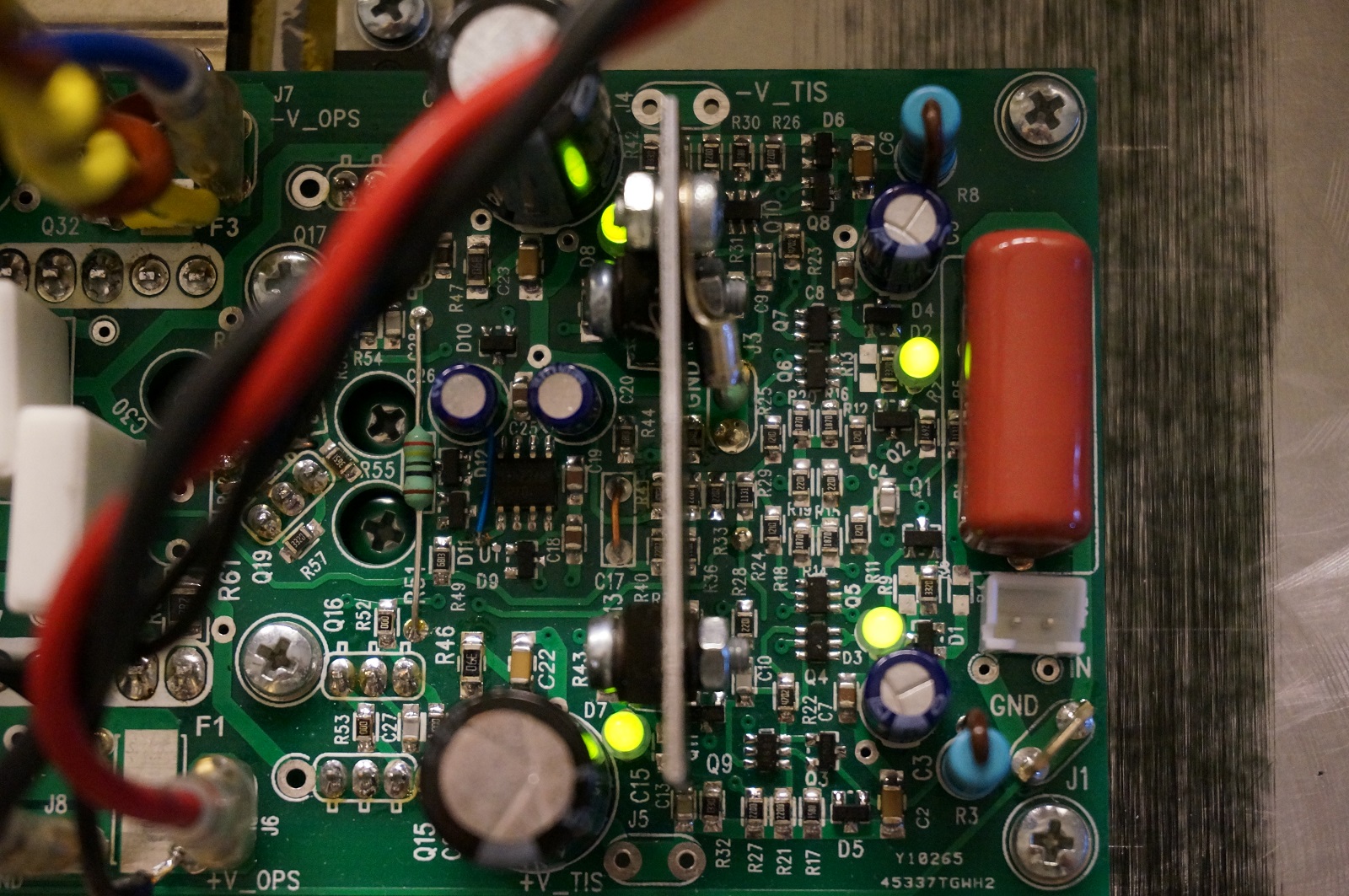

this is the actual build Input-VAS
In the middle is an aluminum sheet metal heatsinking the cascode transistors to the VAS. To its right is the input stage.

Yes, overall reviews look nice. Click on the left 1-star line to see the comments for 1-star ratings.@mz543578854 From where did you see the 1-star reviews... When I look back at the book reviews, it seem for me that the book is well quoted... From the screenshot below...
In general when looking at Amazon ratings, it always is a good idea to check bad ratings too. Of course also always take them with a grain of salt.
What I wrote is that the 1-star ratings exactly said what the knowledgable folks had replied in this thread.

@mz543578854, I did your trick for the 1-star link above... Man... Reading all those comments brought me down a bit. My mind though that the book was one of the best, and now my mind feel bluffed by the simple cover of a book. I know I should take them with a grain of salt like you mention but still...

@HAYK, I did solder new resistors in parallel to R104 39 Ohms and measured the DC voltage across R304. The voltage seems to be constant at 57mV. I tried 1k Ohms, 100 Ohms, 39 Ohms and I am now at 10 Ohms in parralel for a resulting value of 8.1 Ohms at R104 but still the DC voltage across R304 is stuck at 57mV.
Should I understand to do the same on each mirror side, by means of R204 and R404 reciprocally?
