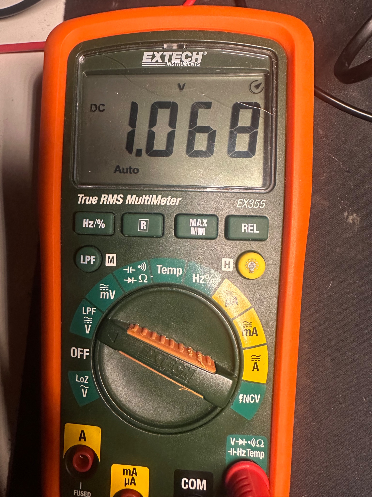

Did a new measument with my multimeter and actually it got 1v set probes to black and grey.

That's way too much, but probably not enough to trip the overcurrent protection. Have you checked the bias current? What's the DC voltage across the test points when there's no load connected and no signal? You should have less than 100mV across those two.

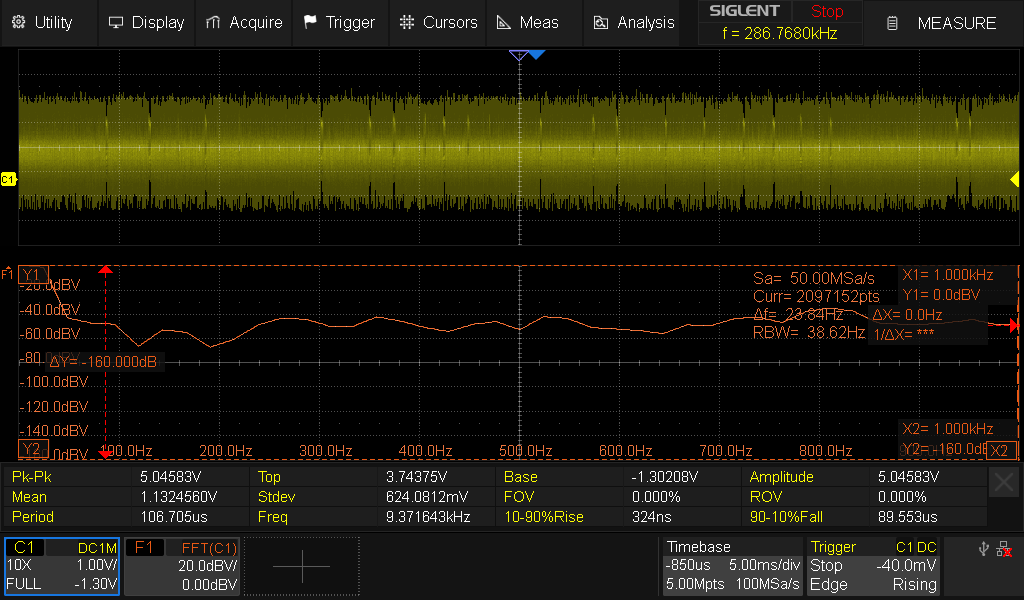

And what does the output look like on the scope?

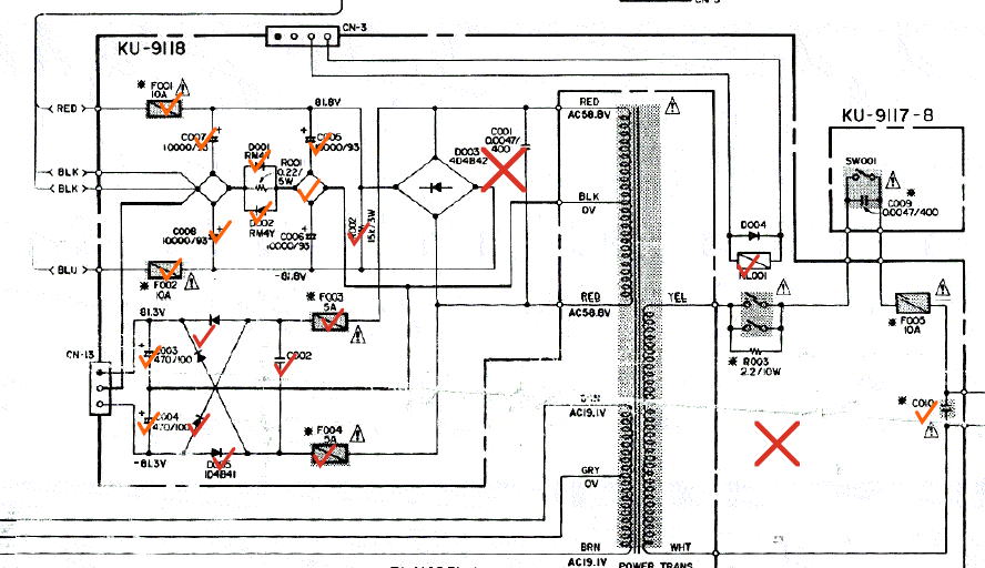

Something that i noticed for some weeks ago is that somone replaced capasitor C001 with 0.47uf instead of 0.0047 witch service manuel states.
I have replaced it with correct value. Considering this i was thinking maby this wrong capasitor has stressed the Bridge Rectifier just next to it. So I connected my scope to positive and negative lead on it to se if i had any ac ripple or oscillation there. What I cant understand is that the waveform has trouble getting steady, it is jumping up and down all over, look at video down below. I also did same measurment after filter capasitors but still got that jumping waveform. When i place probes on CN-13 to check i'm not getting same problem there. Is this jumping waveform a normal behavior?
Again, you should only connect the ground lead to ground. It sounds like you connected it to a negative rail. Don’t do that!
And no, it should not jump around like that, but it’s hard to tell what’s going on unless you probe correctly.
