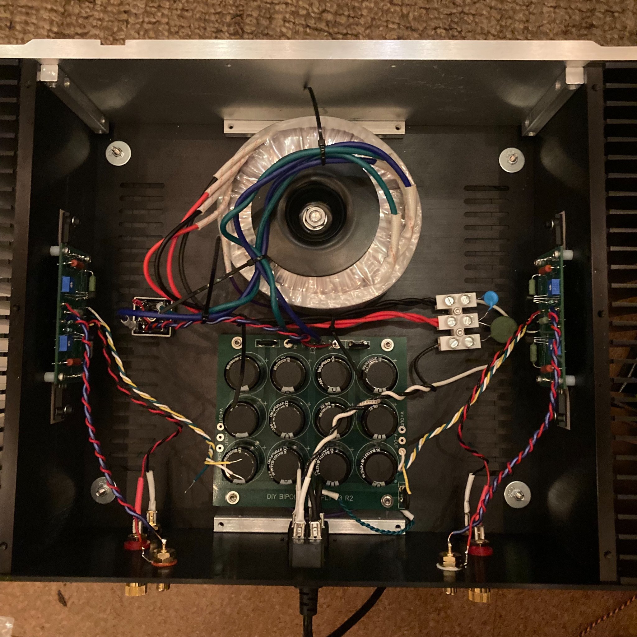

Unable to do so - There was a very brief loud hum and a blown fuse.
OK, everything up to the rectifiers (both measure 16.8VDC) checks out, but when the board is connected fuses blow.
Am I wrong or would that point to the board at this point?
Yeah... that's not right.
Ok, one last thing to try... remove the thermistors and see if you still get the hum and blown fuse.

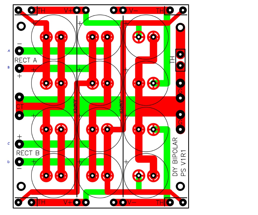

All capacitors removed? Using your meter. What is the resistance between A and B, and C and D?

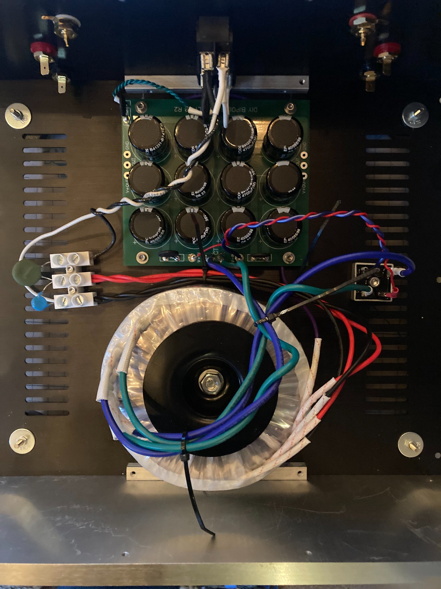

In the interest of being very thorough can we verify that the correct blue/green wires are going to each rectifier?
The correctly matched blue/green wires are zipped tied together.
Also use your meter to make sure there is no resistance between the two blues which would indicate a transformer defect.
Measured OL btween both blues.
Also, use your meter to make sure there is infinite resistance from each blue wire to the chassis. No shorting of the transformer to the chassis.

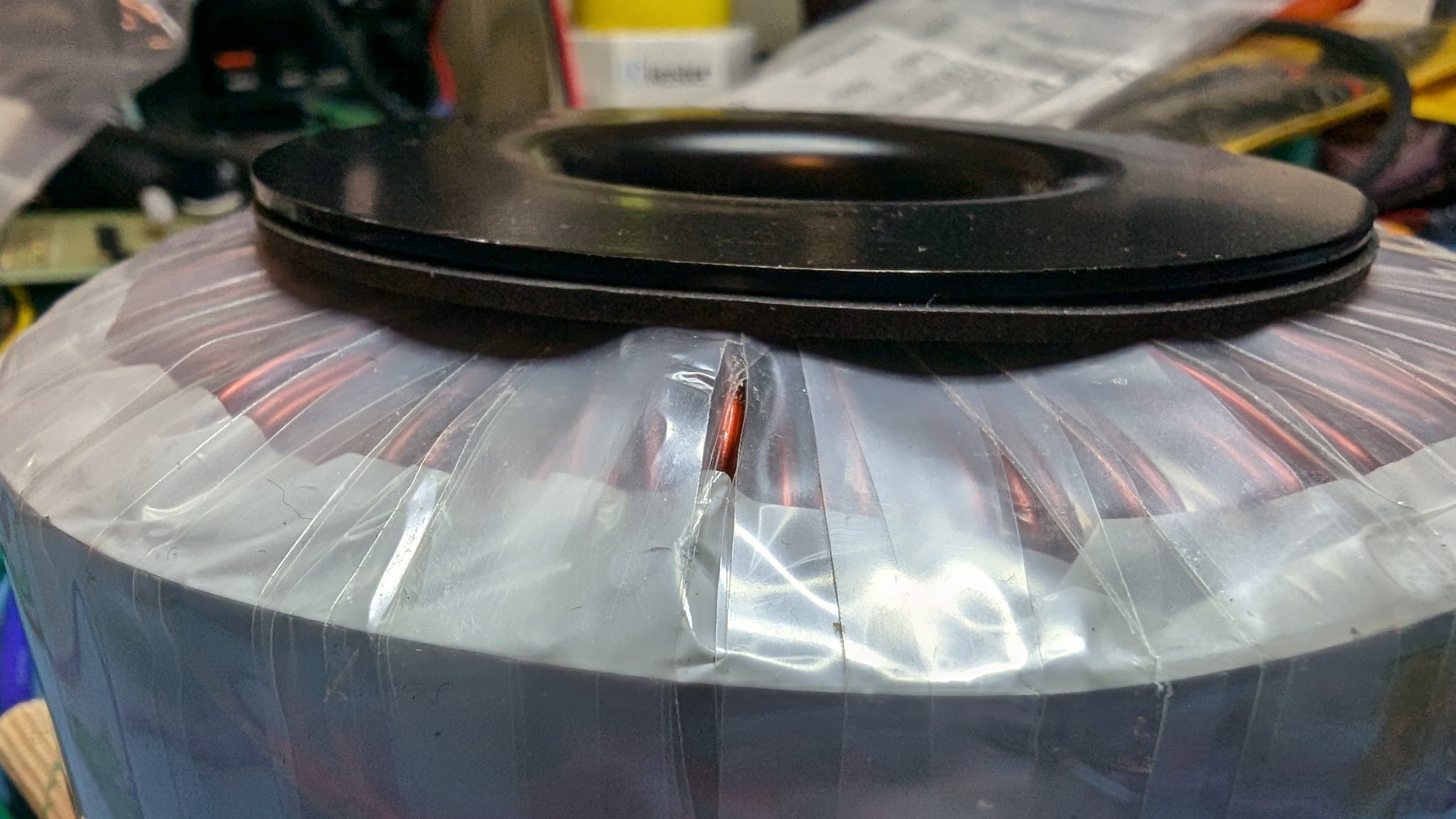

I measured both blues to the chassis. One was OL and the other was.......wait, what?.......0.7 ohms!
I flipped the transformer over and saw a small break with a wire exposed.
That can't be good.

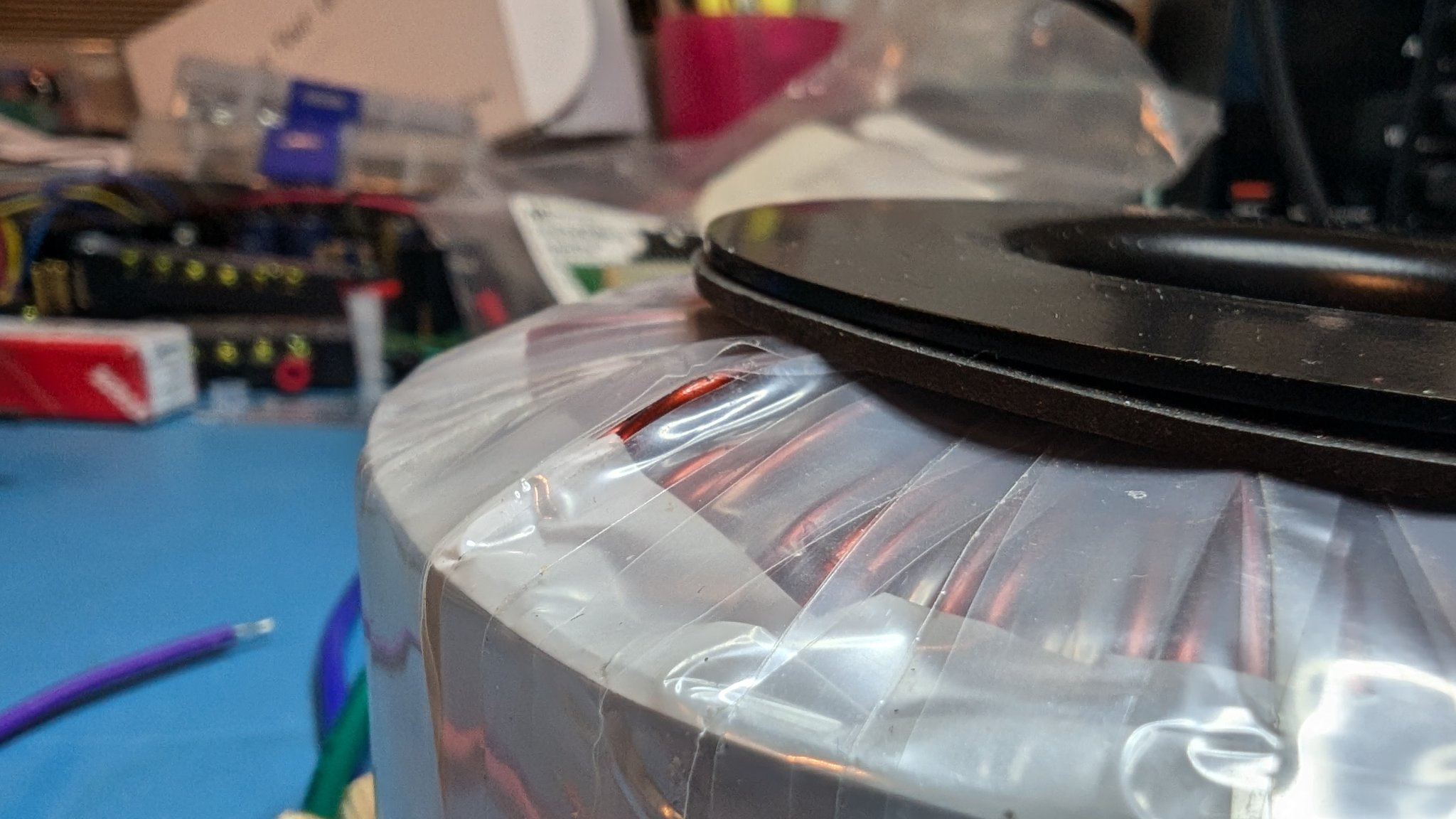

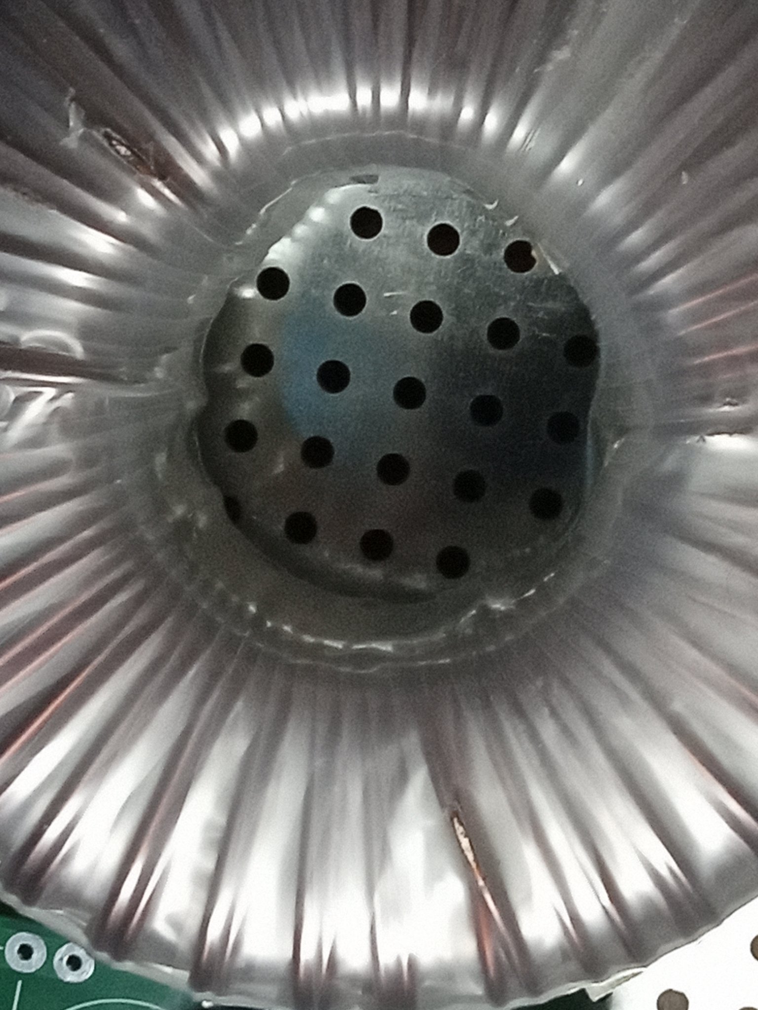

I got an AS-2218 for mine but haven't wired it up yet. While looking at it yesterday I noticed something similar. Luckily the bottom seems fine and it's just this one winding on top. This is going to make me be extra cautious with transformers now.
Were you using the rubber mounting washer?
I had only one mounting washer which I put on top. Tomorrow, I am going down to my hardware store and buy a rubber mat to put under my transformer. If you have stock in fuse manufacturers I recommend you sell immediately.

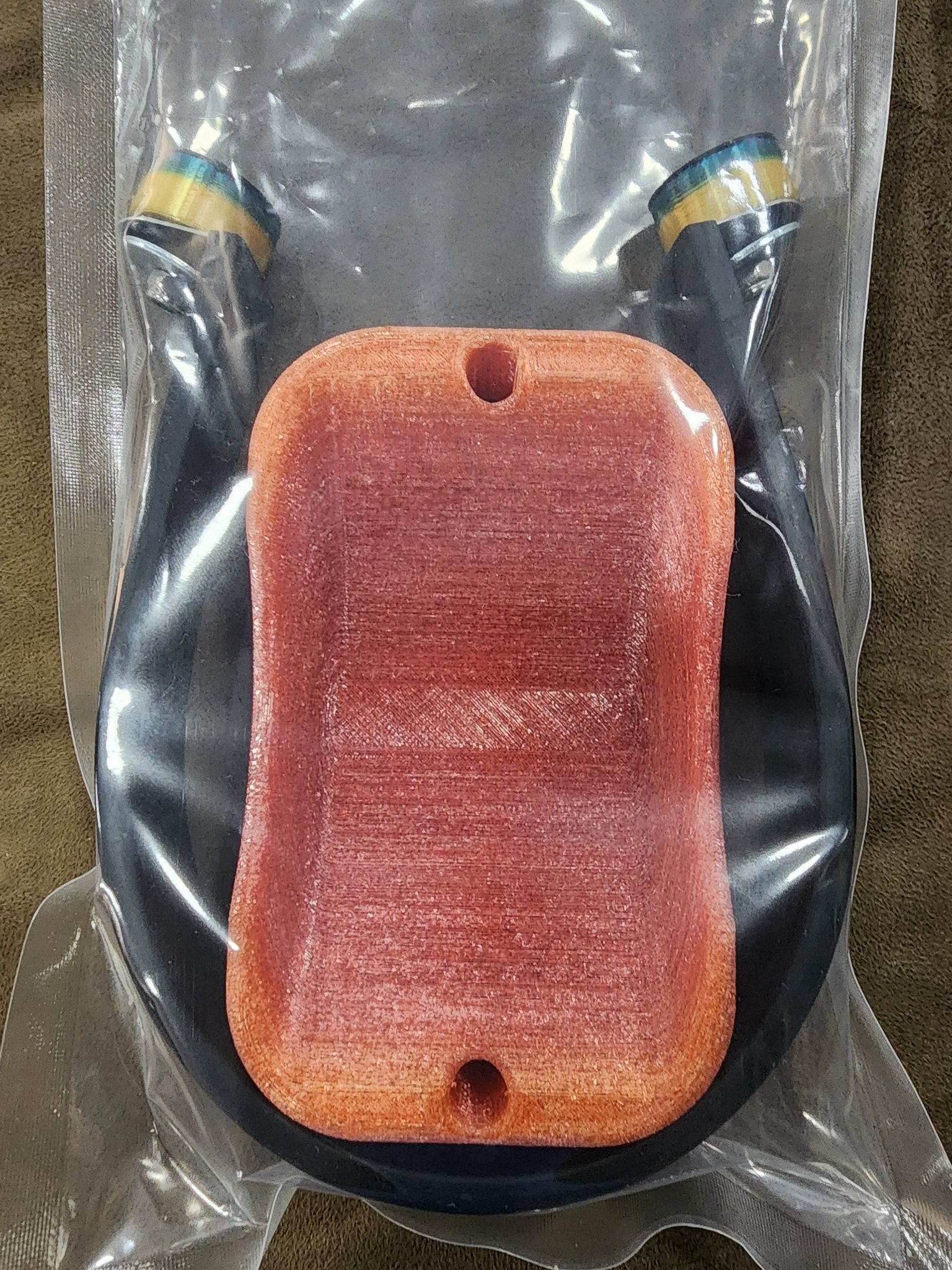

I'll share this 3D printed solution if anyone else wants to give it a try. If you don't have access to a 3D printer, I'm willing to provide parts. I have full kits of the vertical mount ($5 + shipping) per kit [that's less than my cost by some change]. The horizontal mount I'm willing to give away for free if shipping is covered. Just sharing as both options avoid the shorting issue that was found. Another cheap option is the L-bracket approach, but that may not work in a 3U chassis.
I will be donating a number of the vertical kits above to the raffle at Burning Amp Festival this year. They work with Antek 200, 300, and 400 VA AS and AN transformers.
That can't be good.
Okay, so there WAS voltage on the chassis 😱
Luckily nothing more happened!
Hi Guys,
It's official. After taking the weekend of I cut a rubber mat under the transformer and taped up the bare wire, I hooked the PS, held my breath and turned on the power. And nothing happened. No loud hum, no blown fuse, just 49.5 watts at the rails.
I want to express my sincere gratitude for your generous time and advice. You guys really whipped me into shape for troubleshooting. You had me checking things I never would have thought of, assuring me it was only a matter of time when started feeling a bit discouraged. It's fantastic that the community would rally around an amateur with rudimentary troubleshooting skills. It speaks volumes about you.
Tomorrow I am going to wire the PS to the amp boards, put on some music and hear the fat lady sing.
Thanks,
Dave Chorney

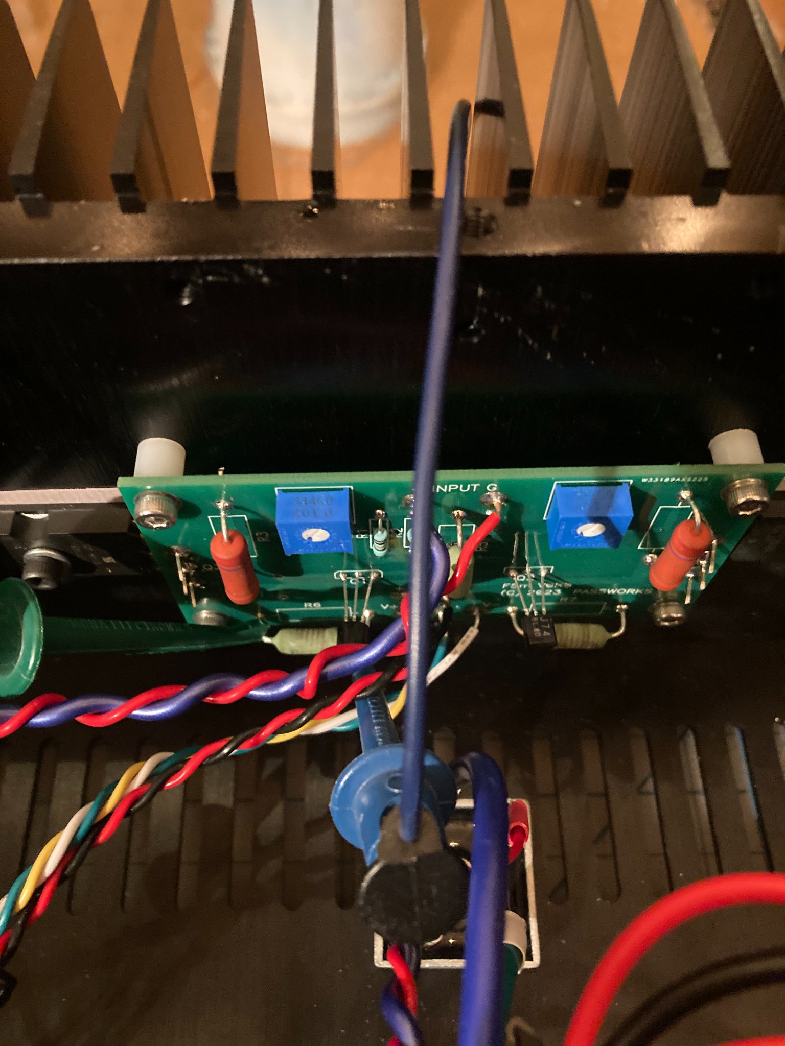

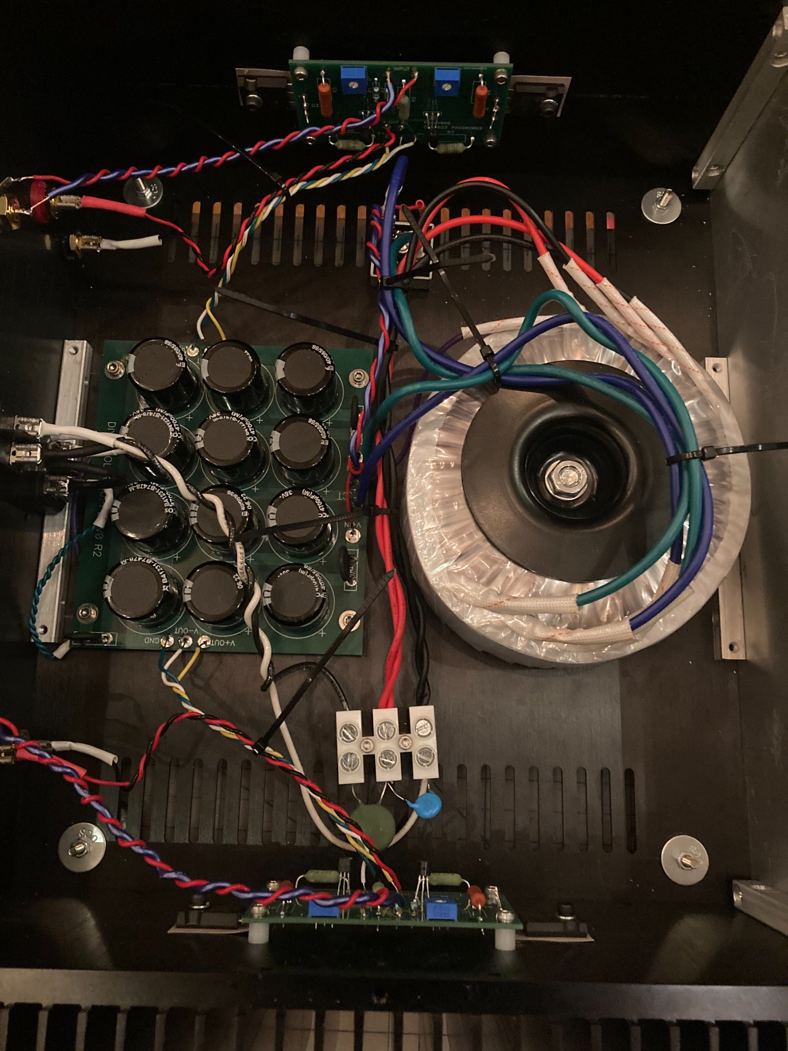

I'm going to piggy back on this one as I also need help with a F5m build. I tested the power supply, everything seemed good, powered down, came back today. Hooked up the channels, turned the potentiometers, powered up, smoke on one channel through R6&R7. The power supply is putting out ~26V each side. Maybe I should be using dual rectifier bridges? I don't understand why the short wouldn't be symmetrical. Anyway, should I be starting over or is there a way to salvage the boards?

Check the case of the mosfet to ground. After that, pull the mosfet off and look for discoloration on the mating surface of the mosfet.
I assume for the secondaries, you have
AC1 to one side of the bridge
AC2 to gnd
AC3 to gnd
AC4 to the other side of the bridge?
........ I tested the power supply, everything seemed good, powered down, came back today. Hooked up the channels, turned the potentiometers, powered up, smoke on one channel through R6&R7. The power supply is putting out ~26V each side. .............
When you tested the power supply, did you measure +26V between V+ and Ground and -26V between V- and Ground?
Looking at your second picture I see that the right channel is not connected to the power supply and the left channel appears to be only partially connected to the power supply. Was this the wiring when you powered up?
The V+ out of the PS should be connected to V+ on the amplifier board, V- out of the PS should be connected to V- on the amplifier board, and G out of the PS should be connected to G on the amplifier board.
Very important: did you turn both pots fully counterclockwise before powering up?
The mosfets don't look discolored but I'll take a closer look at the back.
On the bridge, the positive from the board (red wire) goes to the positive on the bridge. Negative from the board (blue wire) kitty corner.
Yes, ~26V - positive and negative both sides.
Sorry, that picture was in-process (updated attached). Everything was soldered and aligned prior to power up - green ground, white negative, yellow positive.
Pots were turned fully prior to power up but after connecting to power supply.
