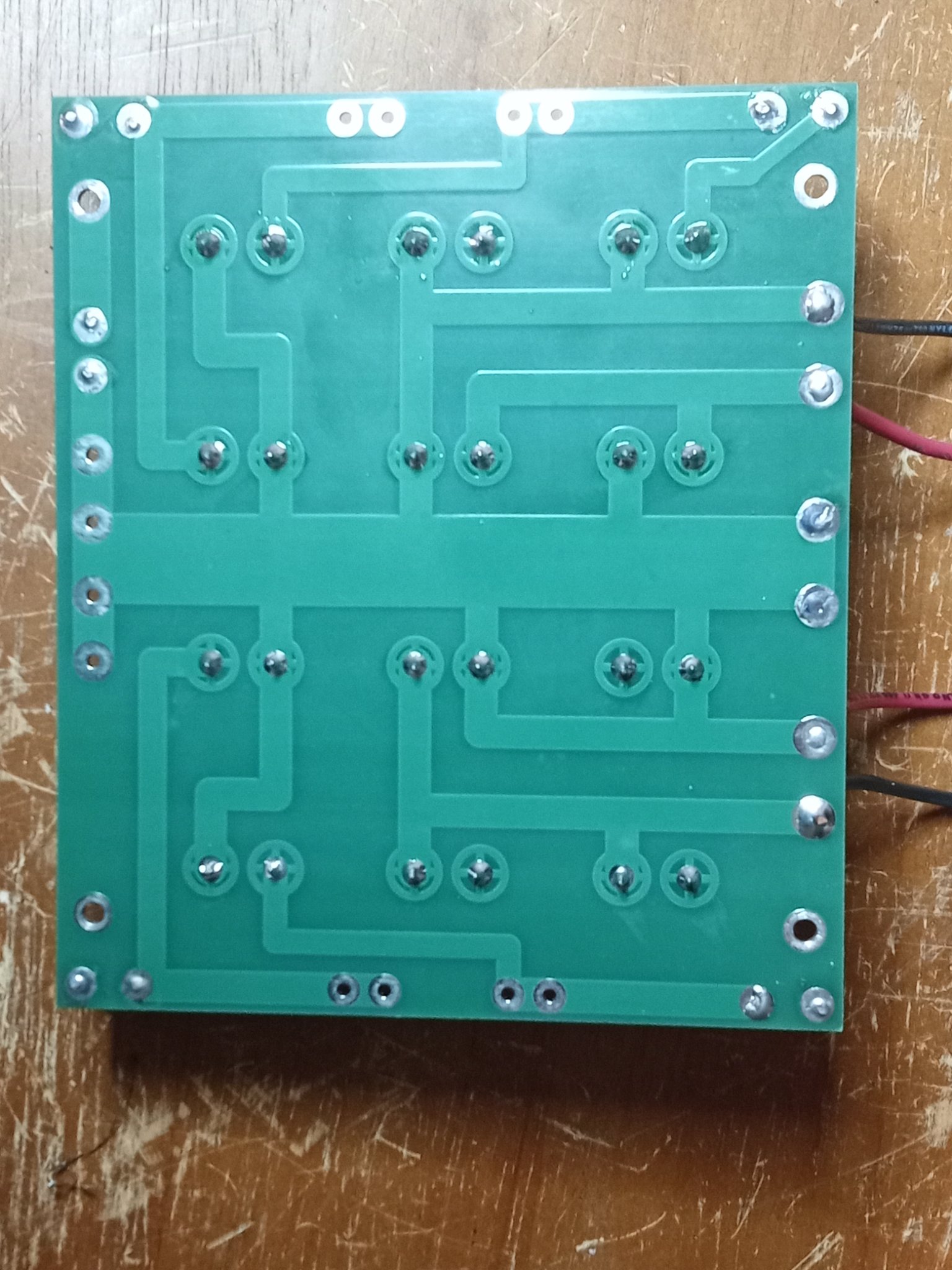

Post a picture of the bottom of the PS board. Check that the wiring is correct. Also check that the board and components are not touching the chassis and shorting the power supply to ground.

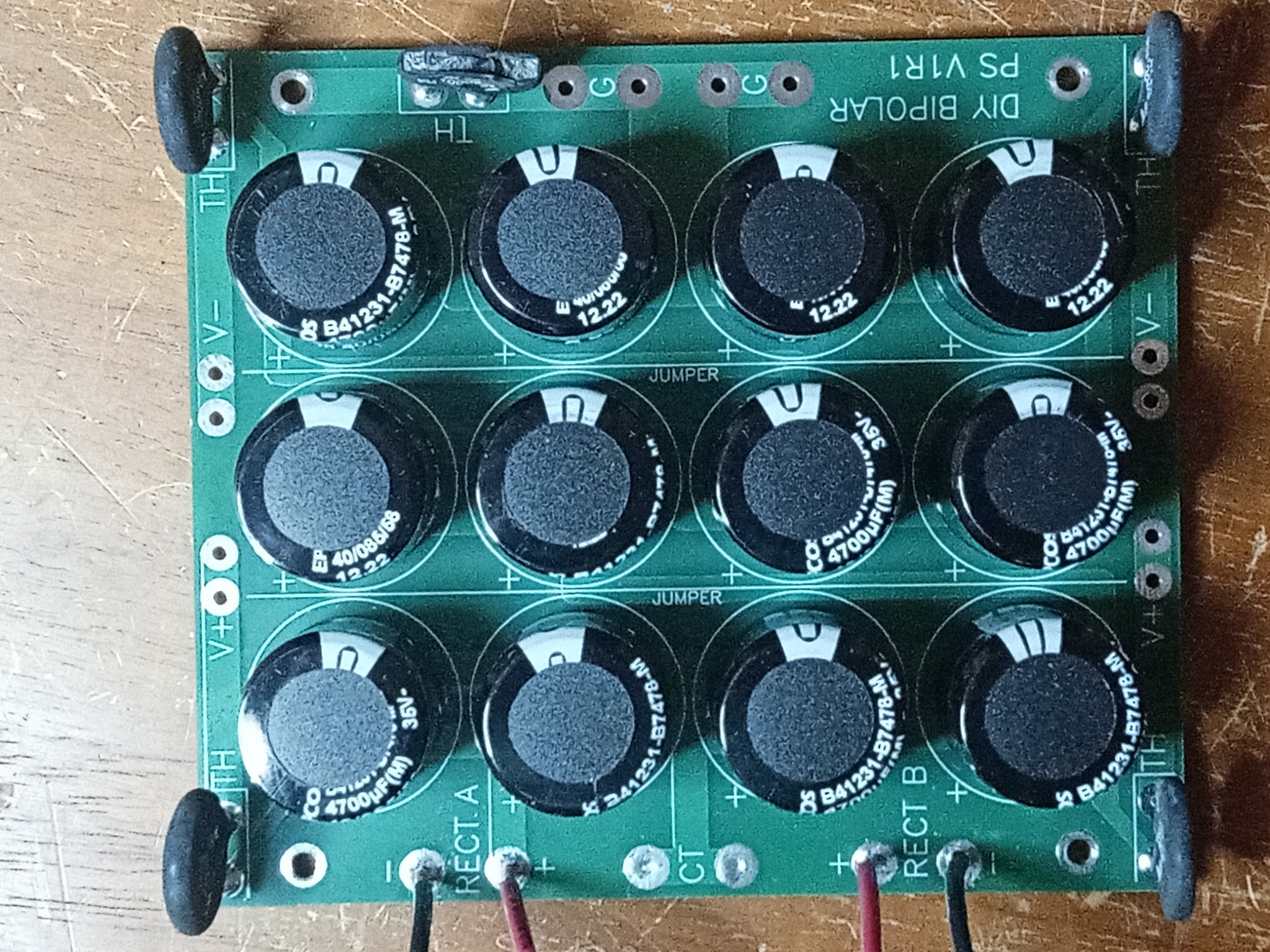

Here is the PS board, bottom and top. I don't see any problems with the soldering and the top view shows the capacitors oriented correctly. At the top of the top view, you can see that the ground thermistor cracked while I removed the board. I'm going to replace this thermistor ASAP.
The thermistor to ground that glowed indicated that somehow current was flowing from the PS board ground through the thermistor to chassis safety ground. So that path needs to be found and corrected before powering up.
That's the $64 question. How would I look for that short/path? I believe I have eliminated any possible problems from the IEC to the board, unless you see something I didn't (in which case, feel free to berate me). That would seem to leave the board. I would be grateful for any suggestion where the problem might be.

You, Ben, and I can easily go through this step by step by step and verify everything. From the posted conversation so far everything up to and including the rectifiers appears to be correct (assuming you have the blue/green pairs correct). I'm with Ben on some sort of short on your PS board. A bad capacitor? Doesn't appear to be any capacitors installed incorrectly. PS board touching the chassis? It's always something simple.

That's what I'm betting my two cents on.I wonder if there’s a shorted capacitor…
That would send DC to ground. If everything else checks out, that would be something to check.
That’s the thing… I’m looking at these photos with a magnifying glass and can’t see anything wrong. I suspect we’re at the point where it’s not visually obvious.
That seems to be the simplest explanation at this point.I wonder if there’s a shorted capacitor…
The solder joints look nice. No splatter. So any short would have to be on the top side. It would be a shame to have to unsolder all those caps to find a short. Maybe cut traces, and then bridge later when done? Still ugly, so maybe unsoldering is the better coice. You can definitely narrow it down to one of the two secondaries by unplugging at the diode bridges before starting on the caps.Here is the PS board, bottom and top. I don't see any problems with the soldering and the top view shows the capacitors oriented correctly. At the top of the top view, you can see that the ground thermistor cracked while I removed the board. I'm going to replace this thermistor ASAP.

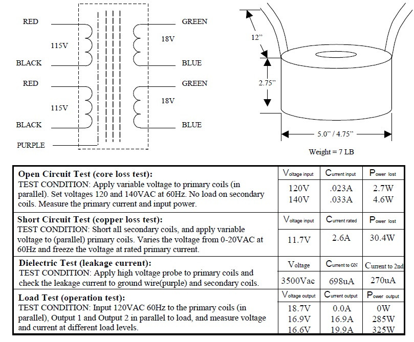

What's up with your secondary windings? I find it highly unusual that windings have mixed color wires, usually one winding will have one color. Could it be that one secondary is actually green/green and the other is blue/blue?
Hi, one thing isn't clear; you wrote that the thermistor at the power inlet got hot and cracked. But one of your pictures shows a cracked thermistor at the output of the psu (the ground lifting one), which isn't the power inlet, while the one at the AC inlet is intact. Could you please clarify this?Thermistor at power inlet got hot and cracked. I haven't turned on unit since but just got a new thermistor,
