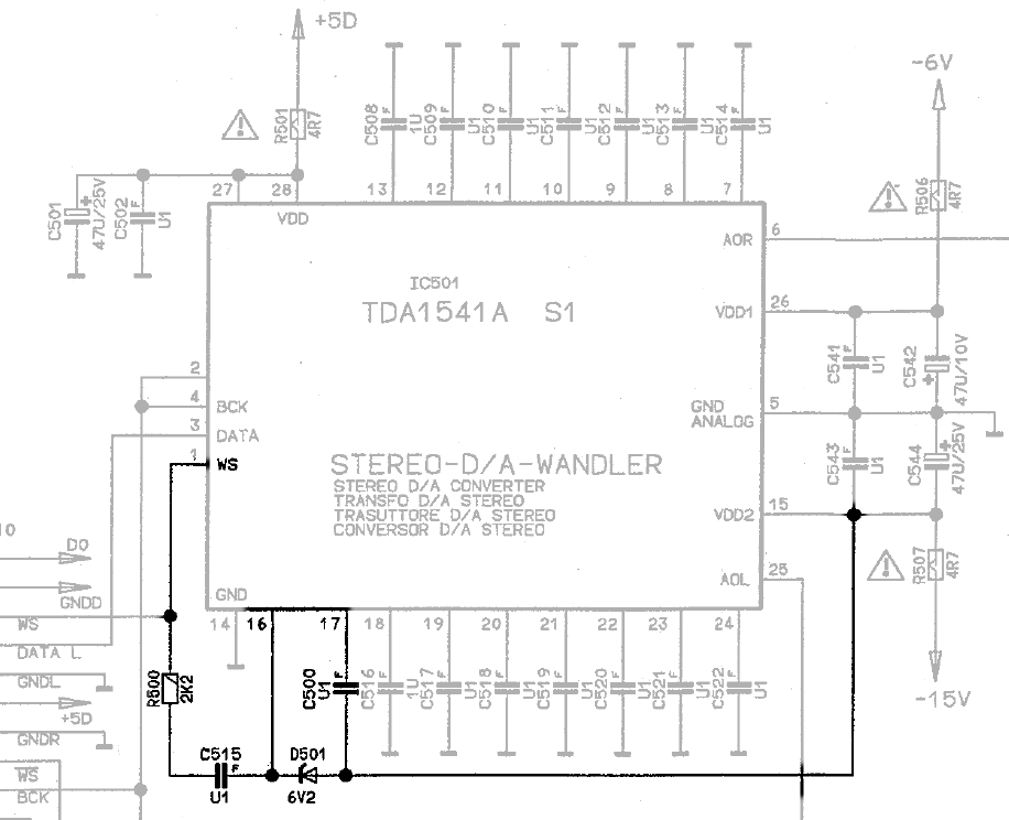

I am using a 7HC4040 (not a 74hc04 which is a hex inverter) which is a binary ripple divider that has 12 outputs, each one half the frequency of the preceeding one. Ie it can divide by 2,4,8,16 etc.
So by connecting a 6 way dip switch to 6 of the outputs I can choose the divider output for whatever clock input I use. eg for NOS, bck = 2.8Mhz so by selecting the divide by 8 output, gives a dem clock of 350Khz
So bck or a divided version of it goes to pins 2 and 3 (the inputs of one gate of the 74HC02, pin 1 being the output) or in my case, a74HC14 schmitt input inverter. (The others are used along with a 74HC02 to 'split' the I2S into separate left and right data streams for feeding to each dac in my dual differential set up.)
I have read and re read all the replies I've had to some of my inane questions and have decided to quit while I'm behind - I usually quit when I'm ahead !
I know what I want to do but do not have sufficient grasp of the technicalities behind it. Neither do I understand the workings of my machine sufficiently to enable me ask the right questions nor complete the task the way some of you have.
So I'm going for the attached - whose design I think belongs to ecdesigns.
I am sure I can implement this and have most of the bits to complete.
If this IS actually DEM re clocking then I will be DEM re clocked in a few days.
The nice thing is however - if I completely blow up my dedicated / separate DAC board it will be the spare one - not the one I've moderately modded and listen to daily.
I apologise for my ineptitude on the subject but will let you know how I get on - no further questions - I promise....😱
Andrew

Grundig way seems easy to do and if I can't put a resistor and a cap from pin 1 to pin 16, put a cap between pin 15 and 17 and finally place a diode between 16 and 17 by now then I must concentrate on speakers, gardening or stamp collecting. I have done more complicated things than this.

I just read the datasheet for the TDA1541 and it says pins 16 and 17 are N/C is that right? so it seem I can't use DEM reclocking, does to SQ of the the TDA1541 differ that much from the TDA1541A?
I bought one of the TDA1541A chips form china for $5 do you think its a fake, because its so cheap?
Does the DEM reclocking from the Grundig circuit work as good as the one with the 74HC02. How does it work exactly why would it take the signal from WS and not BCK like the other circuit?
Some TDA1541s have de cap on chip. All confusion is to blame Philips and their lousy data sheets.
You can easily check if it's present by running the DAC with a -60dB low level sine signal without the cap attached at pin # 16-17. If it's missing and not built in you will see gross crossover like distortion on your scope.

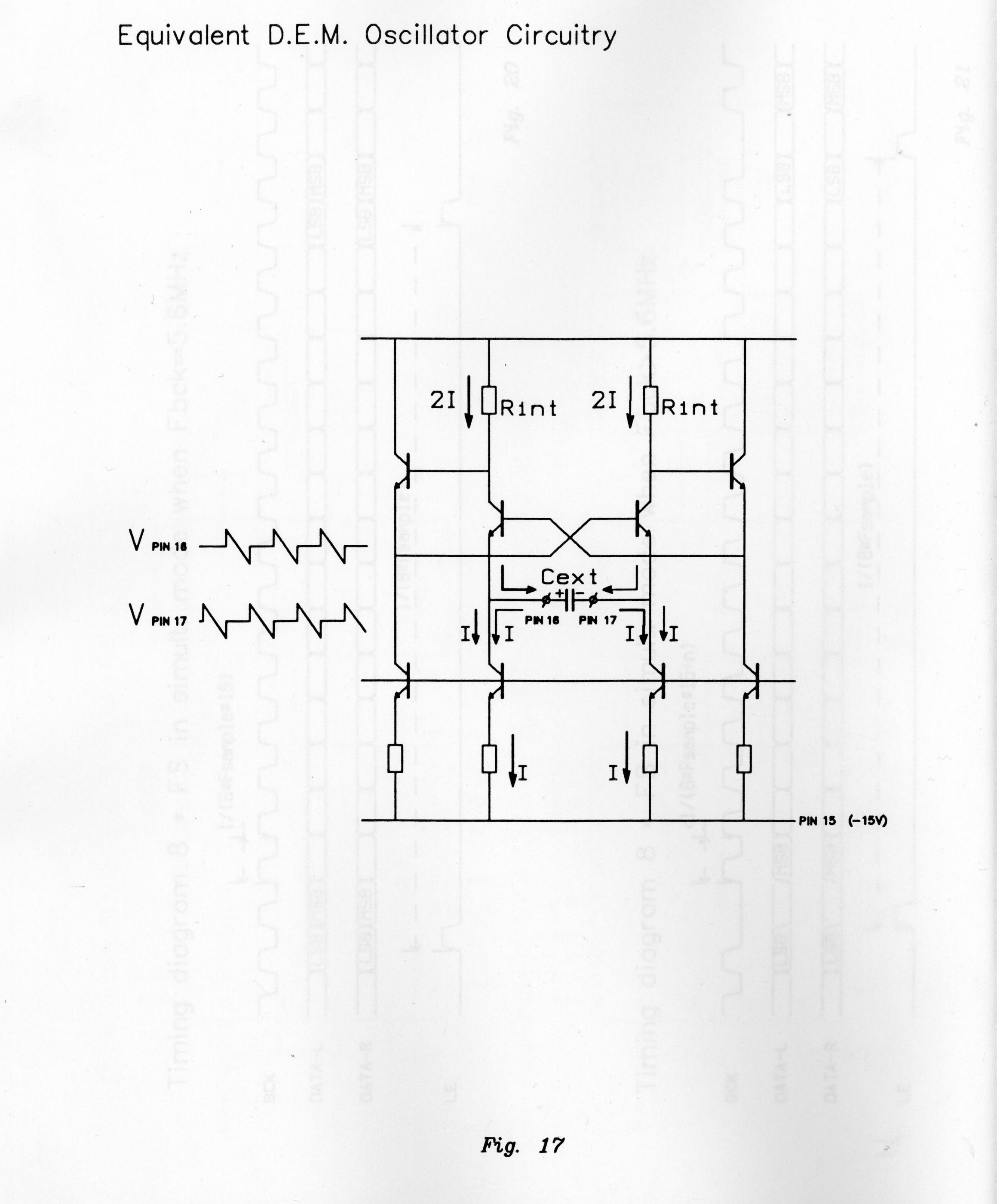

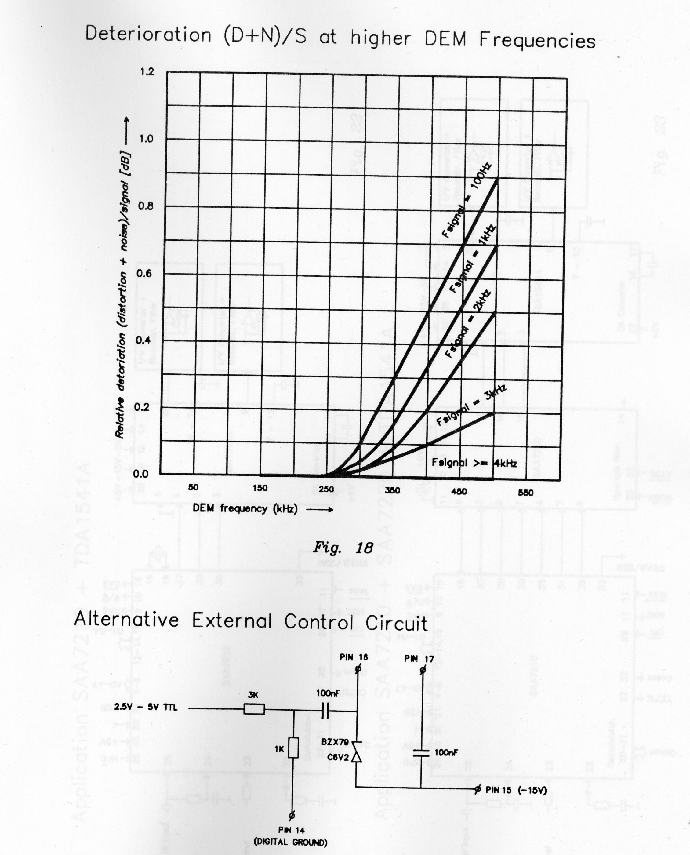

Attached some info from Philips on DEM
The diode is clearly a 6.2V zener diode.

I've gone for 352.8 khz using a 250pf capacitor on pins 16 and 17 and it was good. That is not DEM reclocking of course but a simple mod to improve jitter performance by using better value cap across the DEM pins.
It was this mod that made me want to go further and do the job properly. At this point in time I do not fully understand it. I can tell you I will be doing DEM as per the attachments I posted earlier - it's easy enough if you take a look at it - I just want the clever guys to tell me it will be OK and better than standard.
