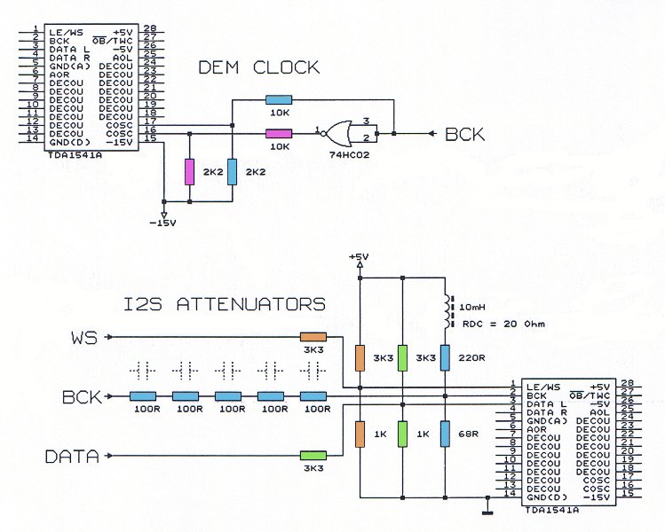

What is DEM Re-Clocking exactly and does it improve the sound quality?
Can I add DEM Re-Clocking to the AnalogMetric Board by copying the setup in the first picture I uploaded.

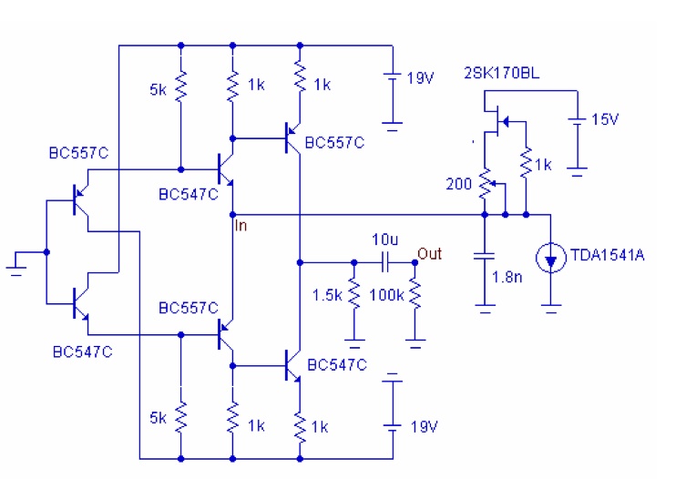

I have found two output stages that seem to be really good, Which one has the lowest distortion, noise, and best SQ?

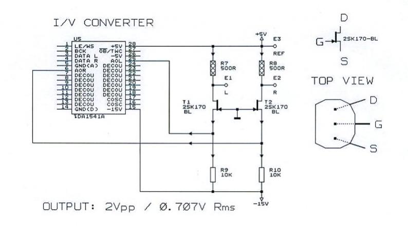

for Pedja Rogic DDNF IV Stage can i sub the transistors for BC560C,BC550C and the JFET for a BF256?
Neither of them filter out the sampling frequency.

This is designed for TDA1545 (by me) and it does not work for TDA1541. There is simple modification that will make it work either.
There are several versions of analog stages for TDA1541 that I have posted over time. More info here:
http://www.diyaudio.com/forums/digital-source/54817-thorstens-valve-output-stage-tda1541dac.html#post614527
Past that, the Analogmetric DAC (and in fact most of the cheap as chip's china kits that copied Thomas [Tubelovers] designs are so riddled with errors, it is probably better to make a DAC from schematics on Veroboard, paying attention to layout and grounding (self adheasive copper foil is an excellent tool here).

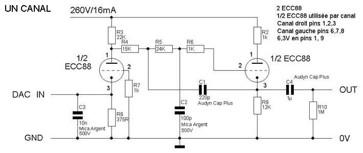

I head that grounded grid is good for i/v conversion.
how would you make this work for the tda1541

DEM is short for dynamic element matching.
It is a technique used in the TDA1541 to improve the converter accuracy without having to individually laser trim the chips (as is done with other multibit DAC's). It uses more than one element per Bit and switches between theme, averaging out any errors.
Stock the TDA1541 DEM circuit runs of a separate local clock, which normally does not synchronise with the digital signal. The result is that the remaining error is randomised between samples, however as there is no guarantee that there is a certain number of DEM cycles in a sample a different kind of error is introduced. DEM reclocking cancels that error.
If you remove the SAA7220 Filter you can fit a small PCb in it's place and fit the DEM reclocking parts there, You can use the 4040 to give you the neccesary clock divider from BCK.
