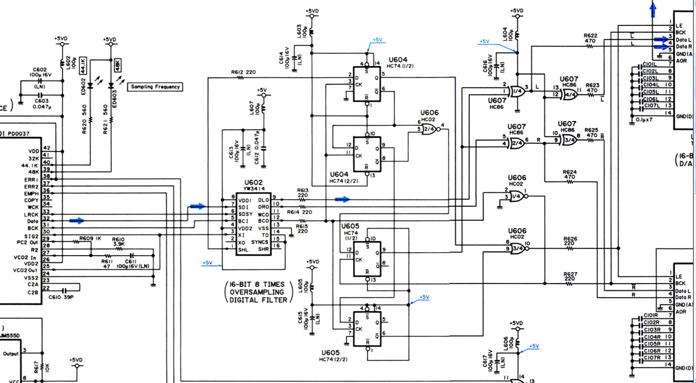

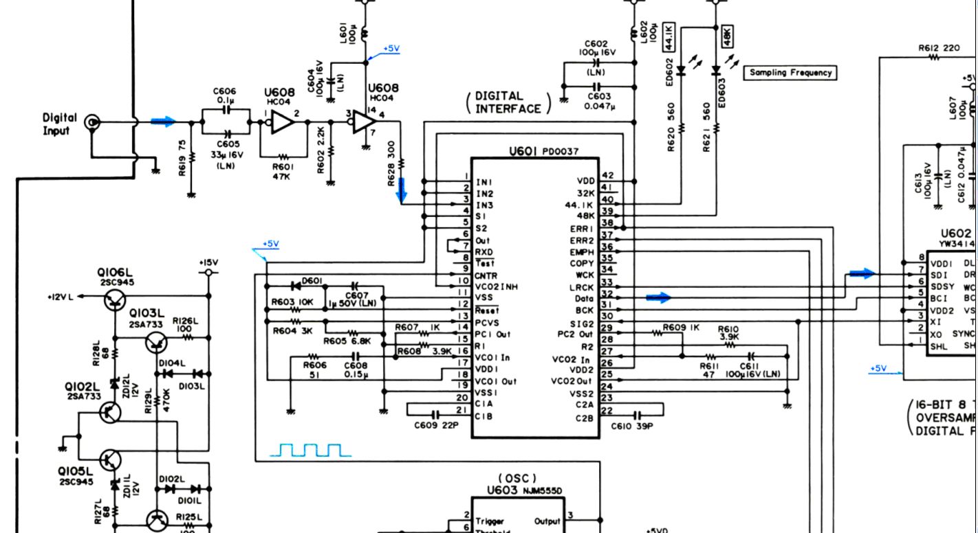

Just want to direct your attention to this DAC if you are into TDA1541. This unit is made for car entertainment, but it contains two TDA1541A S1 Single Crown in what seems to be differential mode. I got hold of one from Ebay. They show up from time to time. Am in the process of disconnecting the built in switch mode power supply (12v to +- 15 and 5v) and change to an analog supply.
This is a very nice unit to do some tweaking on. BTW I paid $100 for mine.
