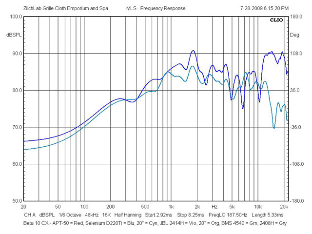

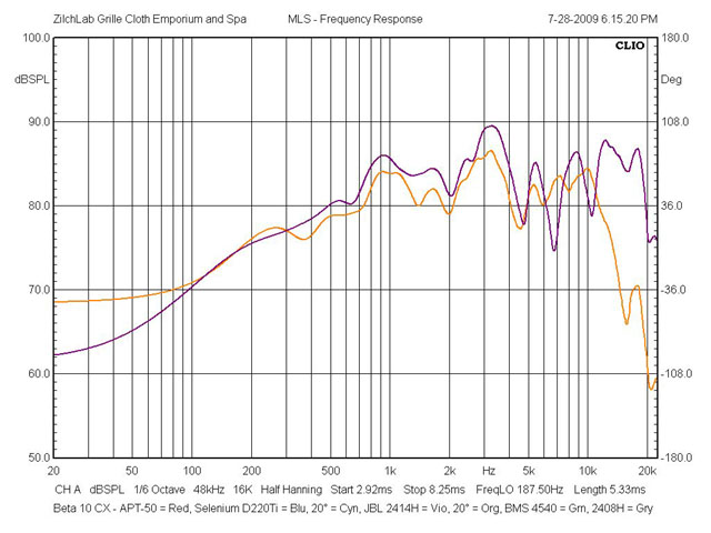

We tested various compression drivers, as you can see. I preferred the D220Ti and 2414H over the others, especially off-axis. As the D220Ti is ~ 1/2 the price, it looks like I will go for them.

It's windowed MLS, and there's nothing measured below ~200 Hz.
We weren't concerned with the HF/LF balance once we shifted to the high-efficiency filter, same one you Spiced for us earlier. I started to wire up an L-pad but decided it was really the HF we were interested in for comparing drivers, so we just left it with no additional attenuation, knowing that it would balance from hearing it with too much.
Even as such, it was listenable. There's BSC in the low pass, so once we get it dialed in, whichever driver we choose, I believe it will have good bass; we'll tweak the tuning at that point, also.
Just now reviewing the several links earlier in this thread that show 10CX HF response, these anomalies are evident in all of them except one, which would appear to have been stitched together using "idealized" response of APT-50. The recommended crossover for use with this combination does not appear to have any compensation, rather, is merely a generic from the Eminence line, and is not going to "fix" anything:

I still think it would be beneficial to cross a little higher if the woofer transitions to the HF well ie off axis and cone breakup/ . Since we are really dealing with a horn and an interference woofer cone acting to support the low end ie psuedo waveguide. Balancing the two evils as it is.

He claims +/- 3 dB across the band! Looks like a slight horn loading on the 8' midbass with 78Hz reflex tuning.
300 Watt continuous seems hopeful for an 8 incher w/o lots of compression.

I'm seeing some familiar notching there.
Let's call it the "Coax Syndrome...." 😀
It is; that's what's making trouble, presumably....

infinia said:I wonder why the horn output is non centric to the cone? (The horn to cone transition may actually cause 2 dips, looking closer)

ZilchLab said:I'm seeing some familiar notching there.
Hmm, yes, similar indeed. Are they using an Eminence unit?
I am not a speaker engineer, but the first thing I noticed about the 10CX was how much the horn mouth edge protrudes above the beginning of the cone. Feels almost like a 1/4". Sure to produce some nasties... Compared to a tannoy, it's a real cliff!
Eh, it works ok. A nice waveguide down the road would be a good upgrade.
