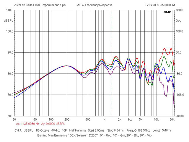

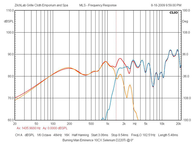

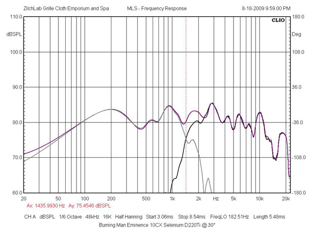

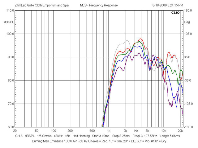

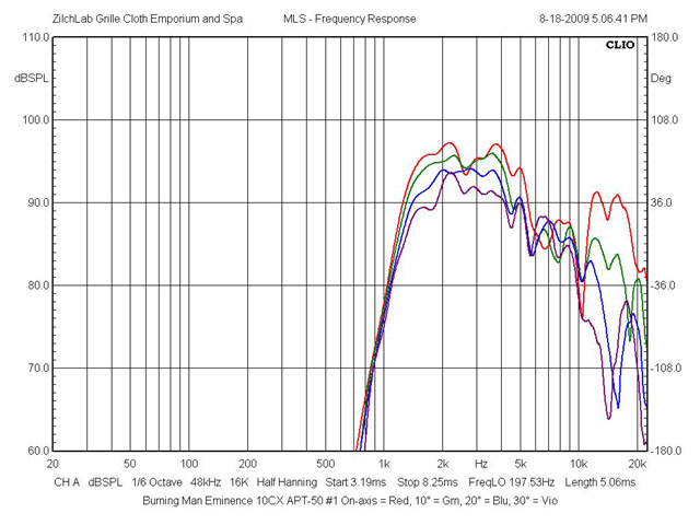

With Selenium D220Ti, we tried several EconoWave filter combinations, ending up with additional BSC for use outdoors in the lowpass, and the standard low-sensitivity highpass running full on. The acoustic crossover frequency is presently at 1.436 kHz:
attachment.php
Yes, it has 5 dB of extra "sizzle" on axis, but we opted to leave that there in favor of better spectral balance out to 30°, i.e., 60° beamwidth. Kent is adding fiberglass damping and completing the second unit for listening tests outside. If we have an opportunity before they are "deployed," we'll measure to determine where these are tuned, and maybe tweak that a bit, but we're getting surprisingly good bass extension presently.... :yes:

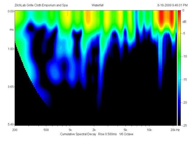

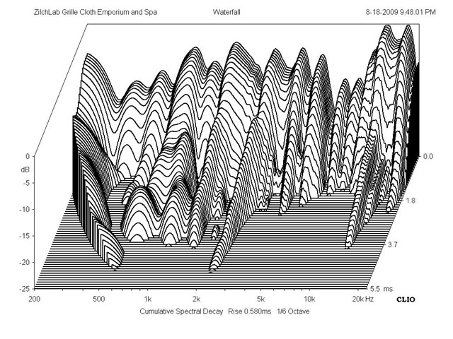

Hi Zilch
Back at the honing grind stone I see.:cool:
Interesting there is that 10" woofer midrange suckout again. As seen on the US speaker Eminence chart, wondering if that was real before...guess so. Not too much help with using a passive Xover for that.
FWIW What was the rational for all the changes ie more BSC and reverting to the low eff Xover version, Considering 1) you got good/better bass. 2) IMO lower crossover may measure better but a trade off sound wise (music) at higher SPL? Not questioning any judgement just wanting to know your thought processes:bulb:. edit>The woofer at 95dB eff is just at the eff cut off and with the mid suck out and extra BSC (tiny baffle) you will need to use the low eff Xover.
BTW Good work you guys!

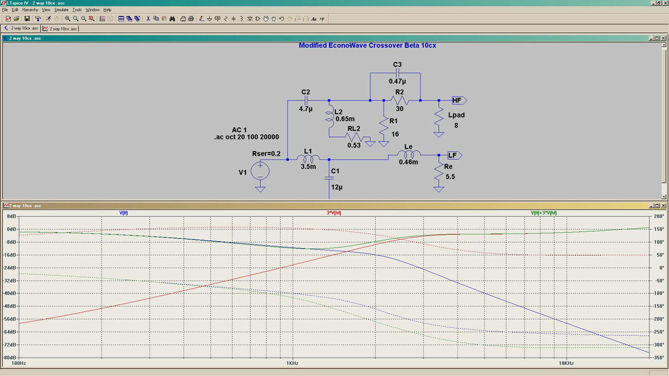

The high-efficiency variant would require an L-Pad to balance; I wanted to avoid having one at all in the hostile environment of the intended use. I could set the attenuation almost anywhere desired by varying the values in Wayne Parham's HF comp filter, so I tried to bracket the range by running on the <95 dB version, which balanced well with the L-pad bypassed. In the previous testing, ~5 dB "hotter," we ignored this element entirely.
Baffle step, we shot from the hip, trying different lowpass values, measuring, and listening, because 200 Hz is as low as I go with MLS indoors. I acknowledge that we may have overshot it, as the acoustic crossover frequency came out a bit lower than I was anticipating, and you suggested maybe a bit higher, instead, but we did crank it and heard no distress. I wasn't watching the cone excursion, but perhaps Kent might pay particular attention to that when he runs his listening tests outdoors. Can we talk you into modeling the filter for us? Here's the circuit, except L2 is 3.5 mH, DCR 0.36 Ohms:

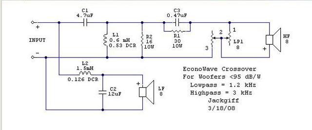

I'll model it fer sure, just not sure when. It might be OK for BSC 1st order if woofer doesn't breakup high? :bulb:use a parallel resistor with the big inductor? Any high pass changes?

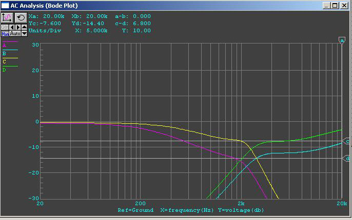

Highpass is as shown, but with the L-pad bypassed. Lowpass is 2nd order; the 12 uF remains. You can see they are summing reasonably, but there's still time to tweak. We may have kicked up the VLF too much is the concern. Kent can tell us if the amp he'll be using has a highpass filter to protect the woofer when they start bumping on the Playa.... :p
Yup SPL vs SQ/BSC outdoors... my concern from the git go. Try and get a little more SPLs with 1st order and then you can adjust the HPF to match the natural woofer rolloff, say 30 degrees or so (horn directivity up high). But Kent knows the application best, so a tradeoff decision is his ultimately, with your sweat and good will of course. Id say you got it pretty good so far as SQ, but will it be loud enough? SQ bass bump maybe best with amp tone controls YMMV.

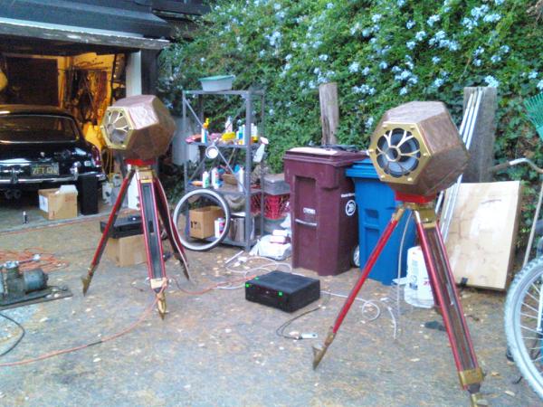

Thanks, guys! Both speakers are operational, finally. I did an outside sound test. They sound very good- perfect for the application!
Yes, they give a bass thump. The LF drivers are moving quite a bit at high levels. Travel ~8mm on the thumps- above the rated xmax. How unsafe is that?
Hard to est. the power into them. With the ipod at full, the amp volume was at ~20db attenuation, the speakers get plenty loud at that level.. It is a 100w per channel amp.
I leave in 2 days....yikes!

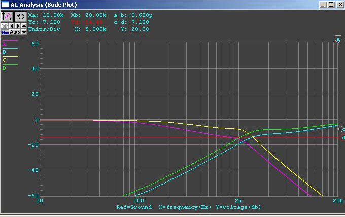

Trying my upload again, and it worked this time. We're running violet and cyan:
Copper speakers have survived BM09!

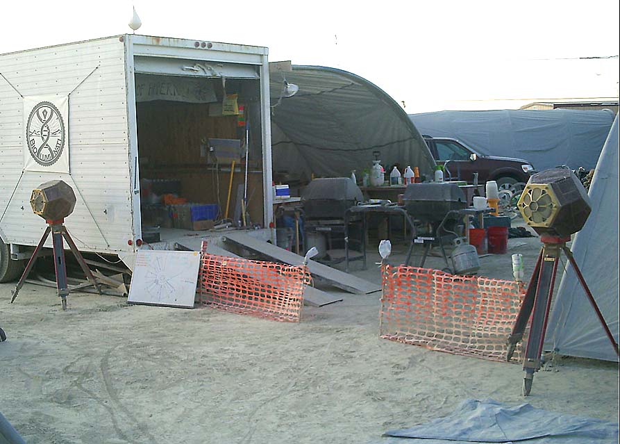

Hi folks-
just a quick note to say the copper speakers performed flawlessly and have been unpacked in their dusty state into my garage.
Our sound never got real high. A few times it got a bit loud for the public I noticed the woofers moving a fair bit, but not excessive. We always kept it to a lower level and I observed no over diving. I did have the speakers hooked up to a receiver with a crude 5-band EQ. I raised the 5kHz some 5 db and lowered the 60Hz band about the same.
Lot of pics were taken by others; I was too busy to get good shots. Attached is one of the few I took with the speakers around mid-event facing into our bike-decoration courtyard.
They were stable, robust and appreciated. I will try to bring them to Burning Amp in October. I'm thinking on leaving them in their dusty state; though an examination of dust penetration into the HF driver is in order.
Thanks again to all, and especially Zilch for all the help and knowledge to make these possible!
More pics soon!
Cheers- Kent

But aren't those notches just because of the time-misalignment of the drivers? Surely the woofer needs delaying.
Let's see: wavelength at 6kHz is a tad over 2 inches, or just over 1" for 180 degree phase shift... and how far behind the cone is the D220i diaphragm? I bet it's a little over an inch. I'll try and measure how well delay cleans this up after I assemble my 10cx/220ti vocal wedges in a few weeks...
