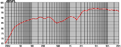

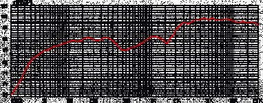

They don't publish the FR curves of the APT50 on the Eminence website, but some of their other tweeters have awful frequency linearity. I would think that the response has to do with the particular tweeter at the volume levels they test at.
Can we mount other tweeters in the Eminence coaxials? I would think so but one of us should call them.
Here is the graph that I found 10cx and apt-50 (post 38)... looks like it's on a baffle with maybe a standard text book crossover ie the low bass droop. No attenuation on the APT-50. But what worries me is from 550-1.5K Hz looks very problematic.

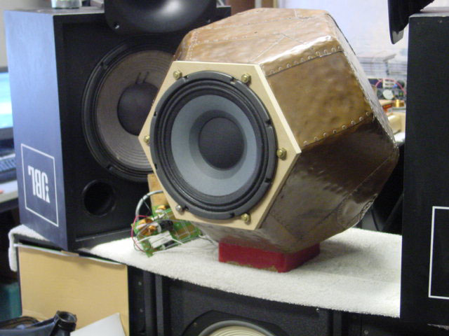

Tweets for 10cx
I had a good chat with Zilch; once the 10CX's arrive and I make a new front baffle, we will try different compression tweets and see how they do. A very generous offer on Zilch's part to help- thanks Zilch!!

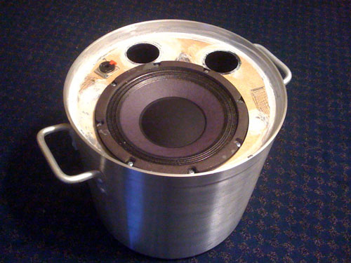

Used the Selenium compression driver mentioned in this thread with the Beta 8cx. It's crossed at 2.5 kHz using a Dayton audio crossover. An l-pad is turned down almost all the way. I used an iphone RTA to adjust it.
20-quart commercial grade stock pot with 1/4 inch aluminum walls. Crossbraced with a dowel held in place with plumbers epoxy. Walls sprayed with damping spray. Stuffed with some fiberglass insulation. The back of the pot uses some fiberglass sandwiched between mdf and the aluminum.
Amplifier is the Dayton rebrand of the t-amp.
All in all, it sounds quite nice. It has enough power so that the dynamics are realistic and surprisingly loud for ~10 watts. My first PA speaker, and a rugged one at that!
I think the front will have something decorative made out of cloth to keep the dust out and make it look nice. For storage the stock pod lid can be put on. Feeling sleepy...

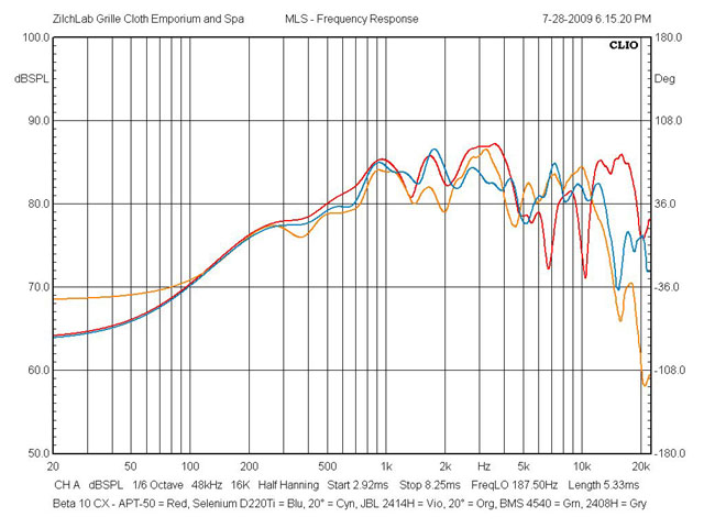

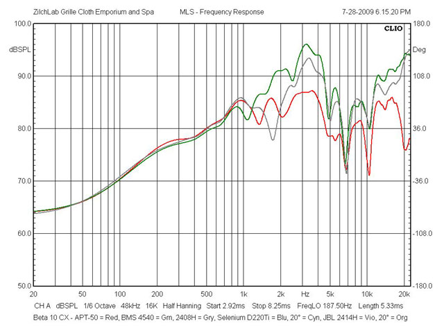

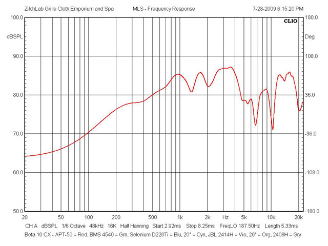

All drivers were tested using EconoWave HF compensation, a minimalist implementation of Wayne Parham's Pi-Speakers crossover. We were surprised to find that the low-sensitivity variant, designed for use with woofers <95 dB sensitivity provided too much attenuation to balance with the Beta 10CX which is 93.3 dB. Switching to the >95 dB version with ~5 dB more HF output was required. Subject to verification, the coaxial "horn" appears to be less efficient than a typical waveguide.
First up, the Eminence standard APT-50, Red, which would require different HF compensation to play flat. Seeing the two HF notches and generally uneven response, we moved on immediately; more on this below.

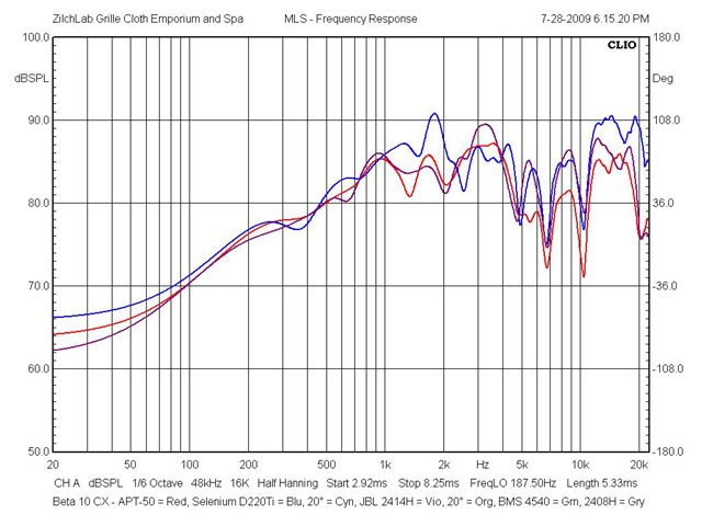

Next up, the ring radiators, BMS 4540 and JBL 2408H, Green and Grey, respectively, which would also require different HF comp, and likely, a notch filter at the very high frequencies to roll off the spike. Ut, oh, the notches are there with these drivers also. What's up with Beta 10CX?
Theory: the coax horn is axisymmetric, and on-axis "holes" develop where edge diffraction at the sharp transition between the central throat and the cone, which comprises the flare, at a substantially wider angle, generates interference. Yet more to come; we test this theory below.
20° off-axis measurements with D220Ti and 2414H, Cyan and Orange, respectively, substantiate our axisymmetric interference theory. We listened to music with both to determine if it is audible. It is, but acceptable, considering the application.

Zilch thanks for lots of data
Man thats plainly ugly (plugly ) as in plugme . I'm sure it looks worse because of 1/6 smoothing, but tis good data here ie doesn't hide the 2 (or 3) high Q notches that becomes a familar pattern. Not sure how to identify the cause of the 2 notches or that they might combine to cause a general suckout in the band between them. My guess as posted before is 2 poor transitions between the HF driver entry adapter at 10.1KHz and the horn to cone at 6.8 KHz . Hmm... I wonder why the horn output is non centric to the cone? (The horn to cone transition may actually cause 2 dips looking closer)
Data looks very bass shy... because not much of a baffle and locating the port in the rear along with mike position?
important>Please post the complete Xover as tested (w/ lpad position if you didnt adjust too much)
I think the woofer is closer to 95dB/2.8 V/m
