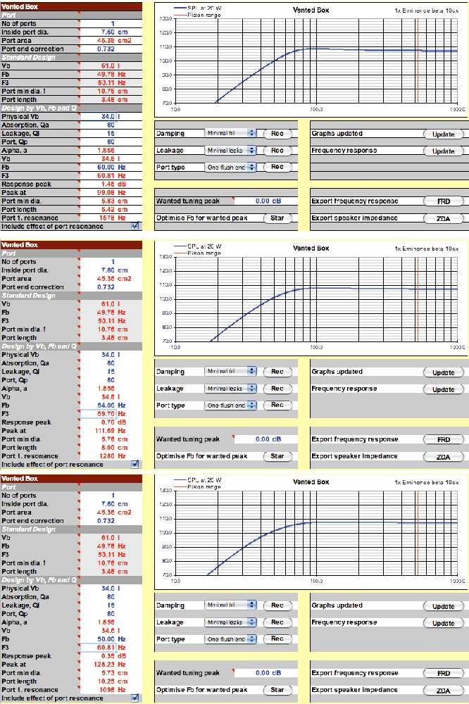

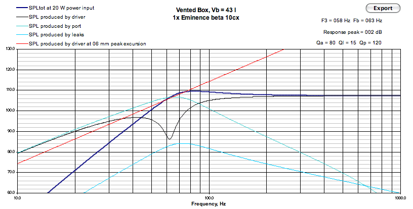

fiddling with Unibox
I've been fiddling with Unibox. Kinda fun to play with!
First, the Speaker Design sheet. At the top, I entered in the Eminence 10CX TS parameters. Set constants to default, except gave Linear Cone Overdrive= 1.15. Selected single driver, of course.
Down to the vented box section and entered in my existing port diameter (7.6 cm). Port type= one flush end. Then, to the 'Design by Vb, Fb, and Q' subsection- I entered in cabinet size (34 L). I didn't know the port Qp, so I entered in 120 (saw some other 10" with that number). Then, I played around with Fb until the port length matched what I have in the box (8.0 cm). So Fb landed on 62.5 Hz. Please see attached result graph.
I went back to the top and adjusted my power so the 'SPL tot' dark blue curve on the graph just crosses the red SPL Xmax line= 20 watts. That should get me ~109db.
Back to the design sheet- the calculated numbers (in red) give me a port min dia. of 5.27 cm? Why not 7.6 cm, as I entered?
Does this look right?
cheers- Kent

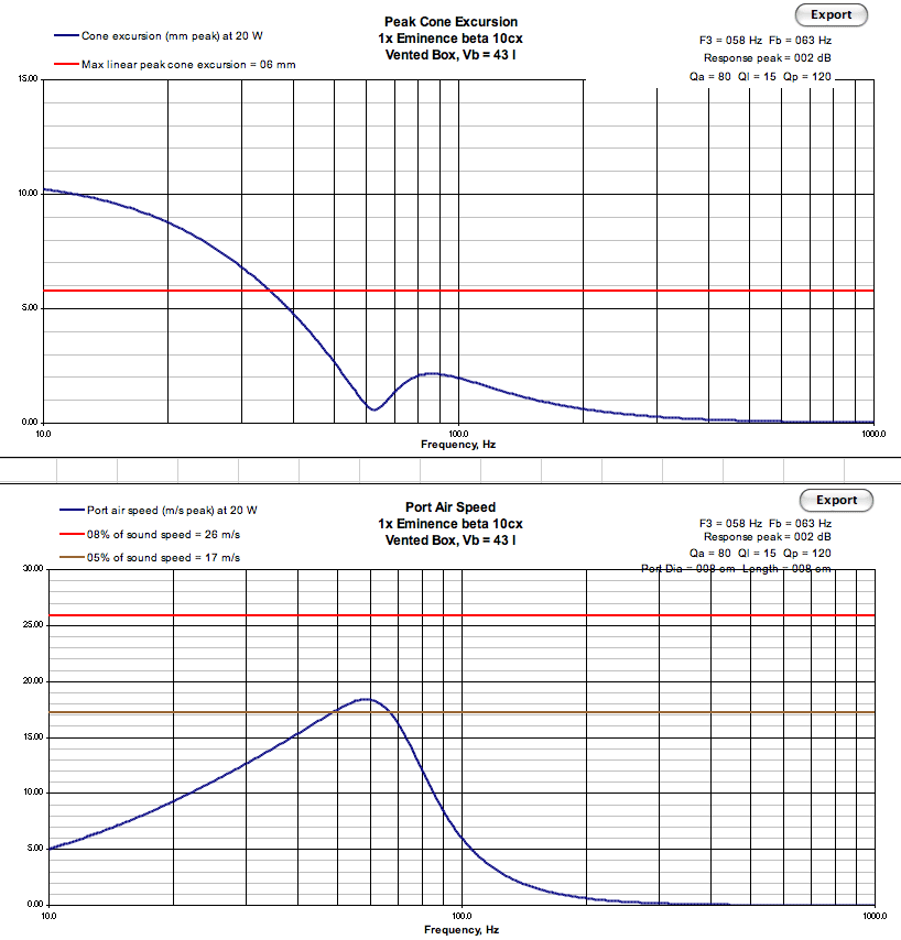

...and here are the cone excursion and port airspeed graphs.
I start exceed excursion at ~35 Hz. But as the driver is ~20db down from peak at 80Hz, do I need to really worry?
Port air speed is up slightly, going over the 17 m/s line at 60Hz. I guess that might mean I would get very slight 'chuffing' @ that freq?
-Kent

Looking at your first chart, the vented box SPL is composed of two parts, driver + port response. So at the peak around Fb, the ports contribution is not constrained by the Xmax limit line.
For high SPL's depending on musical content <Fb and SQ, the real limit is really somewhere between Xmax and Xmech. As you already know, line level HP filtering can be applied but at some expense of circuit complexity and low freq sound. Another choice is to simply stuff the port. Either with a fixed (removable) plug giving the closed box response or a variable amount of acoustic wadding, giving an aperiodic response.
AFAIK there is a bug in Unibox. I usually use WinISD before plugging in Unibox and double check with a port calculator

What I would do is a add a simple passive line level filter (2nd order) between the pre and power amp giving 3 dB extra overhead. As well using a port plug when in transport/storage or when somebody else has access to the gain knob.
[I went back to the top and adjusted my power so the 'SPL tot' dark blue curve on the graph just crosses the red SPL Xmax line= 20 watts. That should get me ~109db.

Thanks, infinia. A bug, you say? I have been noticing some odd behavior with unibox.
I open two unibox spreadsheets, enter the same driver, but get different results.
On the one with the screwier-looking results, I get an 'OBS!' warning. On both, I get an '!' warning, too. What's the OBS warning?
Sometimes when I hit the update button I get a 'run time error 1004'. Sometimes I don't- I just keep on hitting the update button until it goes through. My OS is mac OSX 10.5.
Yep, I guess it's buggy.

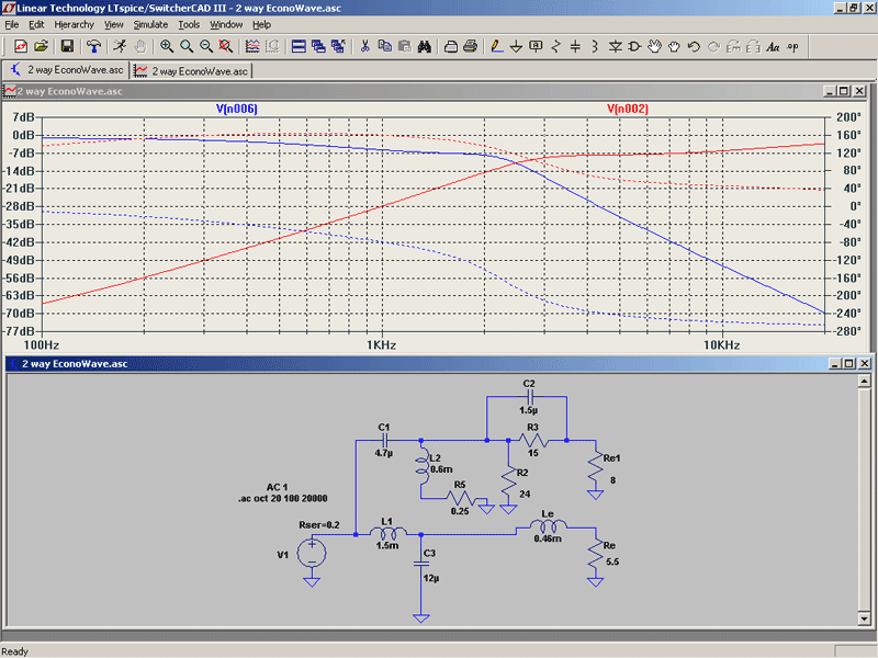

Hi
Here is the baseline Econowave crossover ( version for Higher eff woofer) SPICE model this will give you a teaser of how the circuit behaves. More work on the Pi pad and possibly moving the frequency around a bit higher.
Full baffle step 6 dB with a further loss of about 1dB at LF.
crosses around 2.4KHz.

Hi Infinia- Thank you very much! I was wondering if the x-over would need some BSC. I am pretty green when it comes to x-over design, so I really appreciate your help.
