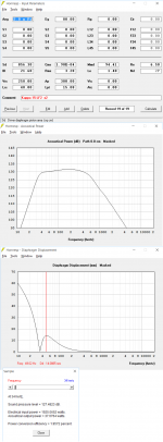

I'm simulating a pair of 15"s in a ported box tuned to 35Hz. To get 130dB in-band, excursion is hitting 15mm one-way at 50Hz. The 8ohm drivers have 6.7mm Xmax, so I'd expect severe compression.
This is with Hornresp, 2pi environment.

Chris,I'm simulating a pair of 15"s in a ported box tuned to 35Hz. To get 130dB in-band, excursion is hitting 15mm one-way at 50Hz. The 8ohm drivers have 6.7mm Xmax, so I'd expect severe compression.

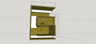

Does this look adequate for bracing? I"ll hollow out the middle one of course, maybe just with a hole saw it will be quicker I have also added the cavity for handles, but would prefer to build them and determine the center of gravity before deciding on an exact placement. Should be trivial to cut them out with a router and template afterwards.
"Hmm.... you mean the drivers are not just in parallel? I'm using the 8 ohm version, I don't really want a 16 ohm load to my amp do I? or am I not understanding? Is there a schematic somewhere?"
Sorry, I was describing the dual 4Ω driver version (most of mine are that way, I bought 100 drivers), you have 8Ω drivers so they will be parallel connected.
Your bracing will probably be OK.
Chris,
Are you using a 6 cubic foot box like DJK did for the two speakers in your sim?
Art
Approximately, yes.
I'm not sure its relevant, though - a smaller cabinet reduces efficiency by reducing excursion for a given power input. A smaller cabinet EQ'd to the response of a larger one will have the same excursion but larger power requirements.
I'll run the sims with the exact drivers and double-check, but I strongly suspect something's amiss with the SPL vs Xmax claims made so far.

Ran the Hornresp sims. 2x Eminence Kappa 15 LF2, ported box tuned to 35Hz, and then I played with cabinet volume to get a near-flat response in-band. This is approximately 1kW per driver to achieve the 130dB SPL claimed. See attachments for the Hornresp dump.
Chris

Hornresp shows the cone excursion of the drivers. Using 2x Xmax would imply your driver(s) can move 8mm when rated Xmax is 4mm etc etc.
Chris
