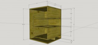

I'm going to Draw up the cab in sketchup and post here for a double check on the assembly. I like to see stuff in 3D before I build it makes it go smoother for me. Then I'll make some sawdust this weekend! (hopefully, my job wrecks my schedule sometimes, on call 24/7/365)

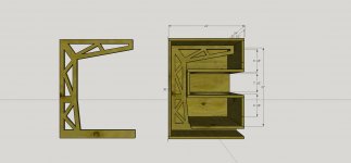

Here is a quick sketchup model I did. Everything Is from the cutlist in the PPSL thread linked above, except the brace in the port, which isn't there but I see it in all the cabs actually built. I assume it is the length of the Port shelf? No other bracing?
3d model shown with 1 side removed. If anyone wants the SKP file I'll be happy to share. .skp is not an allowed attachment so I'll have to .zip it I guess.
Thanks!

I extended mine up the back to meet the back of the slot. In hind sight I'd take it to the top panel and to the front, making allowance for the drive motor.
You plan could add drill holes, a neutrik connector for the slot driver, rear twin neutrik plate and maybe some rebates. I made handle into the slot then boxed them in, according to djk the depth is important not so the width.
I'll extend the brace, though the only other area Im concerned with is the back panel, I think the plenum framing should sturdy the sides up real nice.
I'll definitely add connectors and maybe handles. one question, how did you seal the penetration through the plenum for the speaker wires? Is something like silicone caulk sufficient?
The brace runs down the middle of the port, across the back, and up the other side.
You may want to add a glue block around the inside perimeter of the plenum (it helps for when you drop them off a loading dock). I used a 1x1 cut diagonally, glued it, and nailed with a brad nailer.

Hows this look? Or I could just do Circles with a hole saw.
What about ptting somethng in the port an plenum to attach grills to, will that affect performance? I'd like to Grill the port to keep out any rodents since these will get stored in my garage. I'm not aware of any mice being in there, but you never know.
I would use individual boards, it's easier. You're welcome to try your idea of course.
Mice can get through very small openings, and will eat grill cloth (and the tinsel leads off the woofer). I store (and transport) them face down.

For the slot driver I put an nl4 chassis socket in and used an nl2 plug to connect the driver. I think o would use a 4 way handle design as moving them is difficult.
I'm hoping you can include all these design treaties into your cad drawing as I want to make another. My grill can attach to the boxing of the handle backing plate.
I'll see what I can do with the sketch up drawing. Are saying you put an nl2 in the baffle to connect the slot driver? With an nl2 plug inside the cab wired to nl4 on the back of the cab? Or maybe the other way around with the plug in the slot and receptacle in the baffle....
How deep did you box in the handle so? It looks a little more than needed to me but I don't have big hands either.
I have some nice salvaged metal grill material with about 1/4" squares openings. I don't think mice can get through it. I may just make front mounted caster boards though as I don't like casters on the sub they tend to rattle too much.
Hi, in the back I have 2 nl4 round chassis. On the inside they are wired to the upper driver and another nl2 chassis which is in the slot. From the slot the driver has banana plugs on a 1ft run of cable and a speakon plug into the nl2 chassis. I dont have a great pic
Need to measure the depth of the handle box i think it was 45mm.
