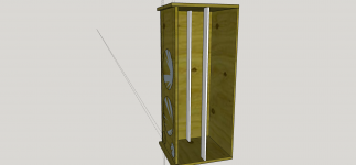

"Is this waht you mean for the bracing? "
Yes, that's the general idea. Probably want one on the back too. 18mm Top and bottom seen dead enough as is.

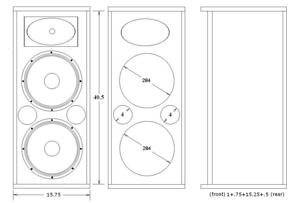

my application is very similar to your and currently looking at subs for my yamaha club tops which i too will sell soon (will keep 2 for small gigs) when i build dual 12" tops.
so my question is - should i build these or look at other options considering that i actually haven't bought any drivers and you were suggested these since you already had 2 drivers suited for this cab.
earlier i was planning to go with 4 18tbx100/18nbx100 (single BR) or 8 3012lf (dual BR).

How much do the subs weigh? I'm going to guess maybe 60lbs or so, but it don't have any way to actually weigh them at the moment. I can just barely move them around myself without a dolly.
As for what you should build. I don't know. I like these, but 18's should go lower. If the size isn't an issue, or the amplifier power, then some sort of 18 might be a better way to go for deepest bass. I think someone here built an 18" version of this cabinet even. That said I had the drivers already for one cabinet, and ordered drivers for the second after hearing the first. I think I'll build at least two more, the size is about as big as I can move myself and two will fit seize by side in my Van. Both things are important to me as I tend to work alone most of the time.
