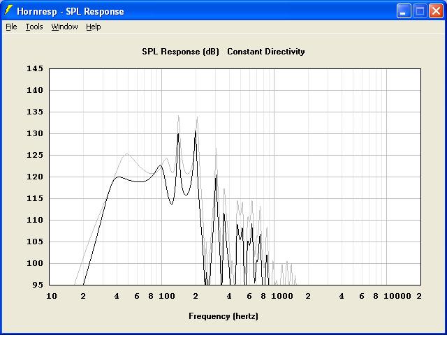

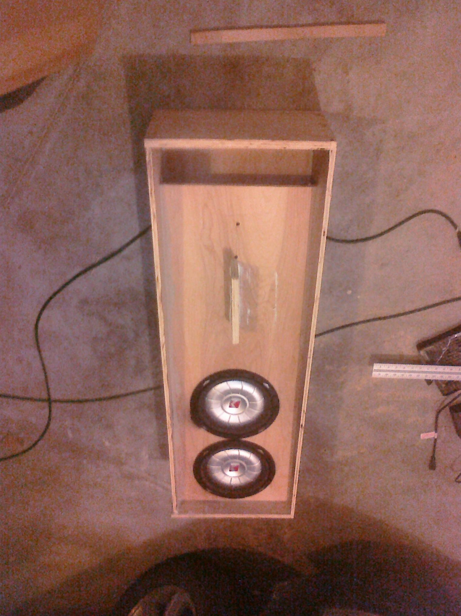

THE BOX IS FINISHED AND IN THE BOAT!!!!!! 124.2 ON A SWEEP TEST AND IT HITS WAYYY DEEPER THAN THE OLD SETUP.. Thanks for the help.. Any idea how to get this thing over 130 db? subs, box change ?? let me kno I wanna get to 130 +
Isn't hornresp nice... THANKS DAVID!!!! You measured within a db of the hornresp prediction. (and you were probably measuring c-weighted, which means that at 50hz for example, you have to add about a db to correct to flat, and add about 2db at 40hz) Which means that your box is spot on the sim.
BTW, that nice 'deep' sound is the 50-60hz hump that the TH gives you vs the roll off at those freq from your sealed boxes.
6db is easy, double cabinets, double power in. What space do you have on the side of the boat, where your third kicker was?
The hard part, is that you probably don't have the amount of space you need to do this.....
Best guess, be happy with 124, and do a couple quick tests. (outdoors obviously) Sit in the front of the boat, and see how loud the bass is, now go around behind the boat the same distance. The directivity of the TH, and it's location centered at the back of the boat, should keep your bass more 'in the boat' so to speak. I personally think you'll have more 'usable' bass at 124, than if you came up with some other non tapped horn arrangement that could actually hit 130 at 1m.
And to think... with a nice acoustic cloth grill cover to match your boat carpet covering the opening.... it's 124db of invisible bass. Now THAT's something to be proud of...
post pictures of your efforts please, and remember, the high pass is your friend. You want more spl's, you need to high pass... If you set to 60hz HP at 24db/oct, you may be able to crank up the power and hit 130, but be careful of burning coils... (I don't advise doing this, I think it'll sound like crap.... but it is theoretically possible. Personally I think you should high pass at 40hz)

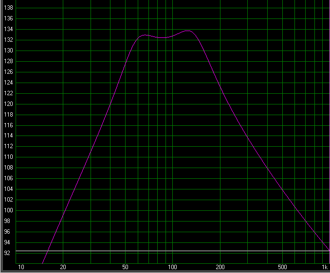

I did some bandpass sims last night and managed to come up with 134 db with a pair of 12" drivers that will fit in the space you have. The drivers are expensive though, and the bandpass won't cross high enough for the pro mids. I think the reason for more output than the TH is that we are trading in some extension. The bandpass trades some extension in order to squeeze out chest pounding midbass punch. The big challenge is getting the vents to work at such high output.
Nothing wrong with what you're doing, and what others have suggested. I'm just entertaining the idea of hitting the max SPL possible.
