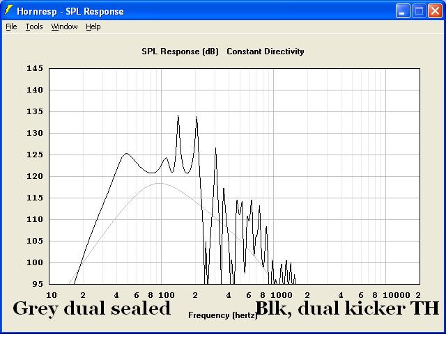

Even better option for you. Build the above cabinet, 2" dimension in the 'throat.' and use your dual kickers.
Here's what you get. xmax limited at 50hz 56volts for TH, in series. xmax limited at 40hz, 48volts sealed in series.
all it costs you is plywood and some time.
and the software is hornresp.
awesome!!! I got the exterior dimensions of the box but how do I determine the slope of the driver board and the length of the driver board? I am sure this is in your chart somewhere but I do not know how to read these.. Thanks for the help
The easy way to do it, is to draw it out on the 'side.' board. Start with 2" clear space from the top to the baffle boards to create the 'throat' and then run the board down to it's centered at the end. Roughly 4.5" away from top/end/bottom. It should be in the neighborhood of 45 or so inches. If you want to be 'exact' then make the dimension of the center/end of the baffle board to the 'top' at 4 3/8", the dimension from the end of the baffle to the end of the cabinet at 4 1/2" and the dimension from the baffle center/end to the bottom at 4 5/8"

jbell just to confirm I should still use the same size port mouth for the 2 10"s as what the 1 15" would of been? also I am assuming spacing of the subs should be as minimal as possible and as close to the side wall as possible?
yes, approx 8x15 opening, obviously following the angle of the baffle board. Both 10's as close to the 'throat end' as possible. You don't have to stagger them, inline in the center is fine.

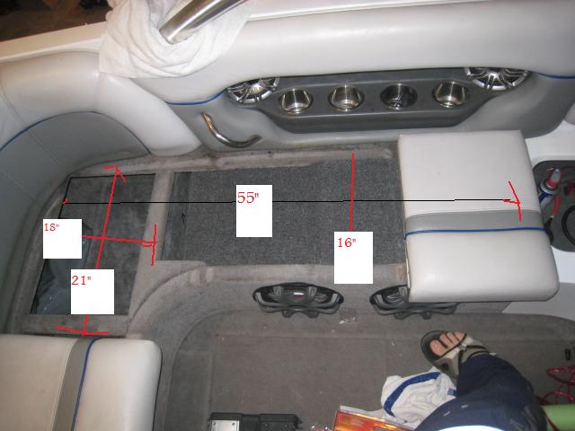

There's no reason to switch. However you should do a through investigation of the area where you plan to put the sub. Dig in and see if there's any hidden obstructions. Most features of your boat are structural in some sort of fashion, this box will support the seat. It looks like there is more height than 10" available, accurate measurements of the area are important as size = performance.🙂What if I get rid of the kickers and get some eminence subs for the Th?
The dimensions are right on... I really don't have a budget limit on subs and I don't mind switching subs either.. If you guys think that a different sub or design is better than my kickers post it... I am going to start building next weekend..
literally it is 10" I couldn't fit a pencil between the sub and the floor or the sub and the seat .. It is exactly 10"
