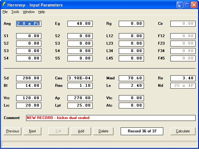

I attached the hornresp input page, so you could play with the
Vrc (volume rear chamber , cabinet in liters)
Ap (area port in sq.cm.)
Lpt (length port in cm.)
and figure out exactly what where you want your box tuning. (you may want something higher or lower than I had guesstimated.)

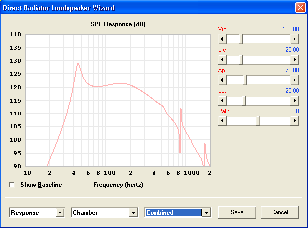

You can see that it is not xmax limited (+-8mm on the 55.2421) above 40hz at 24v. I've had good luck using these drivers in small folded horns for PA, and not had any issues up to about 24v per driver. If' I'm being very careful, I'll limit to 20v. I would not recommend going up to 28v (250w) per driver long term.

I attached the hornresp input page, so you could play with the Vrc (volume rear chamber, cabinet in liters) Ap (area port in sq.cm.) Lpt (length port in cm.) and figure out exactly what where you want your box tuning. (you may want something higher or lower than I had guesstimated.)

Perhaps it is also worth mentioning that the Loudspeaker Wizard tool recently added to Hornresp makes "box tuning" even easier now... and is fun to play with 🙂.

hey jbell maybe I am dumb but I see the input parameters that you used what other items do I have to input to show the same response chart you have.. Mine is not matching yours.. Thanks for the help
are you using 8 drivers? (aka double click on Nd in 4parallel x 2 serial)
You can always double click on any of the driver fields and it'll prompt you for T/S params so you can easily use any driver.

(and yes, the wizard for loudspeaker, not just tapped horn wizard is really cool.)

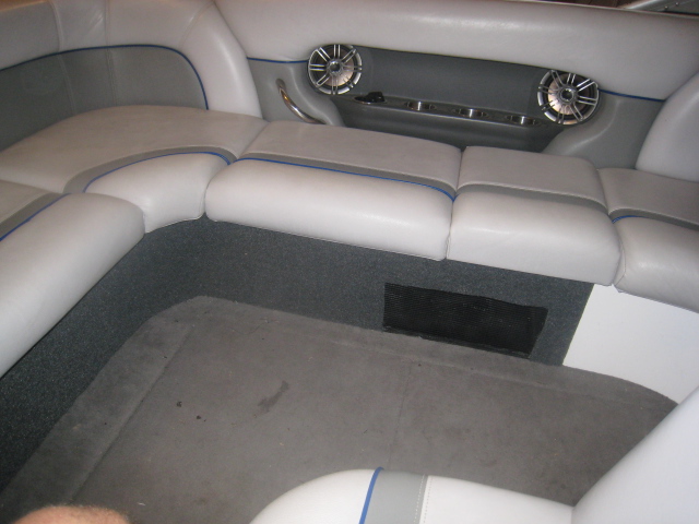

stealth TH installed
so I decided that the stealth box was enough for now.. I will continue to mess around with Hornresp and configurations until I find a combination that seems significantly better but for now this box rocks and people can't figure out where my subs are.. Check these pics!!!
Hey Jbell can you quick tell me the dimensions of this box ? I think I have it right in my head but I rather have a pro confirm this before I start hacking up $40 pieces of wood.. THanks
What driver is that??? Your LE and RE look way off.
kicker cvr 07104

I was not thinking of the DVC, so the LE looked high to me. Here are the corrected inputs for 2 woofers wired as a 4Ω nominal load.
Hint: Start by entering SD and double click in Cms, Mmd, Bl, Rms, and answer the questions to enter the parameters.
