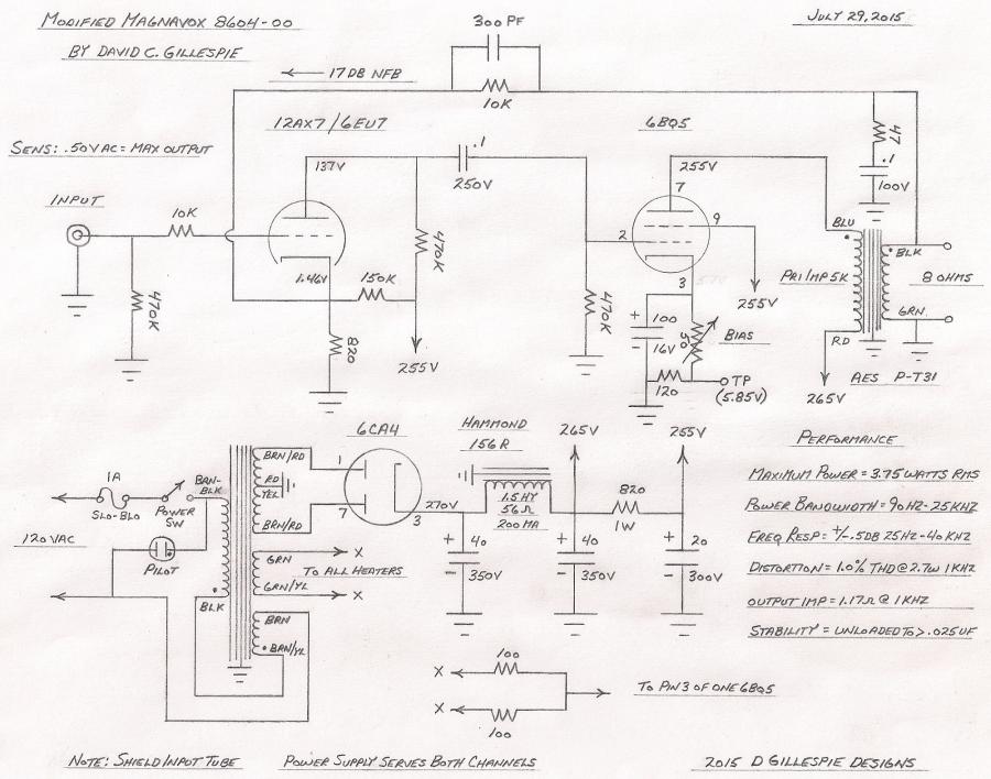

I still have a hard time to understand the final schematics which you are trying to describe across multiple pages in this thread. Where to place that OA2 tube etc.
Let's focus on Mr. Gillespie's power supply. A full wave center tapped (FWCT) vacuum rectification scheme feeds a CLC, AKA Π section, filter. We will use a "full wave" voltage doubler (graphic previously provided), followed by a LC section. Think "extended" CLC filter, with the doubler stack in the 1st position. 😉 We will take advantage of SS diodes' ability to work into substantial capacitances. Use 2X of this 180 μF. part to form the doubler stack. Please notice that the effective capacitance in the 1st position is more than 2X the 40 μF. used with the vacuum rectifier. To tame the power on surge, a CL-140 inrush current limiter is placed in the line between the N-68X power transformer and the "center" of the doubler stack. Use this low cost Triad filter choke between the doubler stack and the reservoir capacitor. Use this part as the reservoir capacitor. Again, more than twice the capacitance of the vacuum rectified supply is being employed. There will be no shortage of energy storage.
We don't know the exact voltage of the B+ rail described. "Breadboard" the supply and determine its voltage value, under load. That number will control the resistance values employed in remainder of the power supply.
The reservoir cap. feeds the 0A2 current limiting resistor. That resistor feeds the anode of the gas discharge regulator. The cathode of the regulator tube is grounded. This 0.068 μF. noise suppression cap. is placed across the 0A2's electrodes. The screen grids of both O/P tubes are connected to the regulator's anode.
All that's left is a dropping resistor between the reservoir cap. and the decoupling cap. that feeds the 12AX7 anodes. The 20 μF. Mr. Gillespie used here strikes me as being quite adequate.

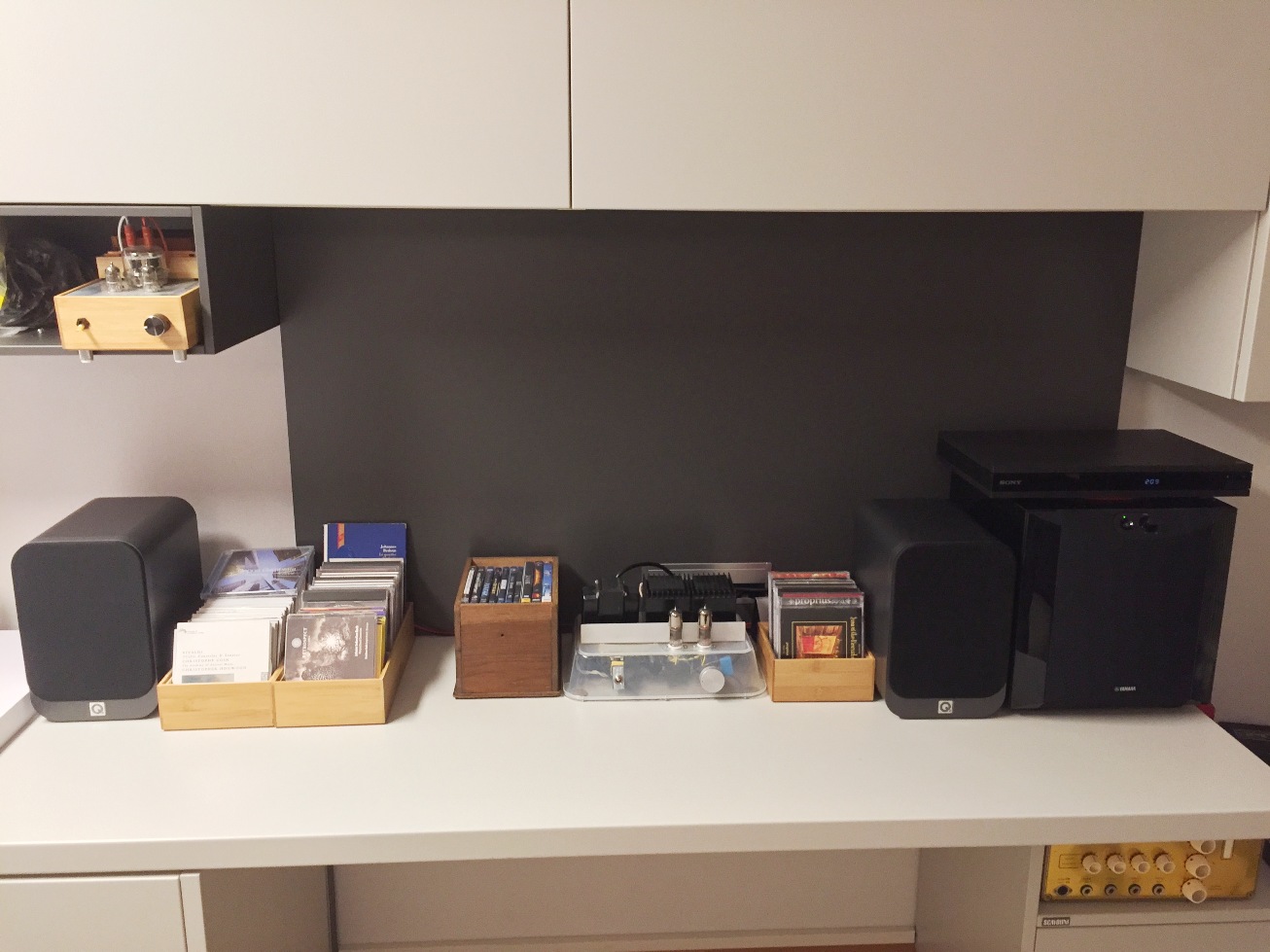

The attached picture is the current complete setup. The speakers are specified for 88dB sensitivity and 64Hz-22KHz frequency response. The HDCD player has a nominal output of 2Vpp. I get a normal listening volume when the potentiometer is at 9. The active subwoofer controls are set near the minumum because it only helps to fill the bottom frequency range (8'' driver). On most classical music I can turn it off and I barely notice the difference. I also have a passive sub but it does not work well with this amplifier without global feedback.

Let's use Mr. Gillespie's 29 July 2015 signal schematic as our point of departure. It contains a very important feature, the ability to adjust the O/P tube's control grid (g1) bias. Remember, O/P tube anode dissipation must be held within documented limits and manipulating the bias is exactly how that goal is reached.
Several changes to that signal schematic are already known to us. A 0.082 μF. film dielectric cap goes in the line from the I/P jack's center pin, to suppress infrasonic noise. The 12AX7's grid to ground resistance is 100 K, not 470 K. The 12AX7's grid stopper is 100 Ω, not 10 K. 6Π15Π-EB (6p15p-ev) O/P tubes will be employed, but future use of the 6BQ5/EL84 is not excluded. A 10 Kohm carbon composition stopper is used on the O/P tube's control grid (g1). The O/P tube's screen grid (g2) voltage is "150" V. (as required by the 6Π15Π), not 255 V. I state "150", as the exact voltage will depend on the 0A2 specimen acquired. Edcor O/P "iron" will be employed. The value of O/P tube anode B+ will be in the vicinity of 300 V. and the exact value will be determined experimentally.
A few more changes are to come, but they are not world shattering.
