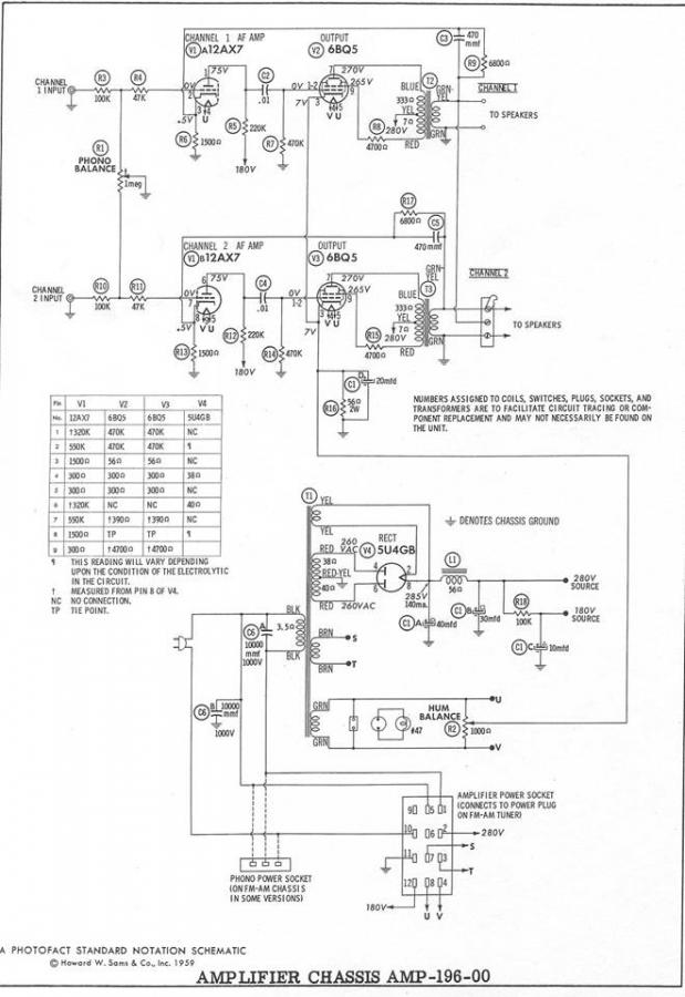

The 12AX7 section into "12" W. O/P tube is the sort of thing found in low cost console amps. With the right parts, that sort of setup can be both "boombox" or HIFI, at your whim. Plug the right (high efficiency) good speakers in and your listening room is filled with 1st class sound.
Quite a bit can be "borrowed" from the Magnavox schematic I'm providing. "Maggotbox" used ultra-linear (UL) mode O/P tubes. We will use full pentode mode, for both technical and cosmetic reasons. Our power supply will be SS rectified, for reasons of cost and space. BTW, 6BQ5 = EL84.

My vote is for the Magnavox type amp- 1 watt is very small. Those would have to be crazy efficient speakers to get a reasonable SPL out of it.
No need to worry about the two voltages- one extra resistor and capacitor in the power supply and you're good to go.
If you're worried about the cost of the 6BQ5 tubes, the 6AQ5 is a slightly smaller (7-pin base) tube that is available for a few dollars each. They are electrically equivalent to a 6V6, and a SE 6BQ5 design could easily be modified to use 6AQ5s. If you can find some used output transformers for a 6V6 or 6BQ5 from an old console amp, you might be able to save some money over the Edcors. These seem to pop up on eBay all the time (or maybe it just seems that way to me since I'm never looking for them).
You only need one 12AX7, by the way, since they have two triodes in one tube- save 10 bucks.

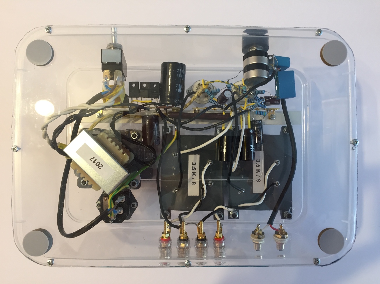

The schematic and a picture of the bottom of the 6e5p amplifier are attached to this post. You don't need matched tubes. Eli Duttman idea about the gas discharge regulator tube is excellent. I believe that on this amplifier you may use two 85A2 regulators in series; the recomended current trough this type of regulator is 6mA. The cathode current trough the 6e5p is about 30mA. Anode current and plate impedence are low, this means that the output transformer is not critical and you may use cheap toroidal transformers. The big transformers you see on my build were meant for KT88 tubes, but they turned out to be of subpar quality on the intended application. On this circuit they sound perfect. You may use much smaller transformers, such as the 3500 ohm version of the GXSE15 (I believe that the regular 5K version would also work, altough with lower output). A word of caution if you want to use cheap power toroidal transformers as output transformers: because this circuit is single ended, you need to oversize them a lot to avoid saturation. Try 100VA. Some are good for this application, other aren't, you may want to try out.
I build my smaller prototypes on clear plastic containers, they are easy to drill and placement of components is simplified. The L shaped aluminium bar on top is essential to avoid deformation due to the weight of the transformers.

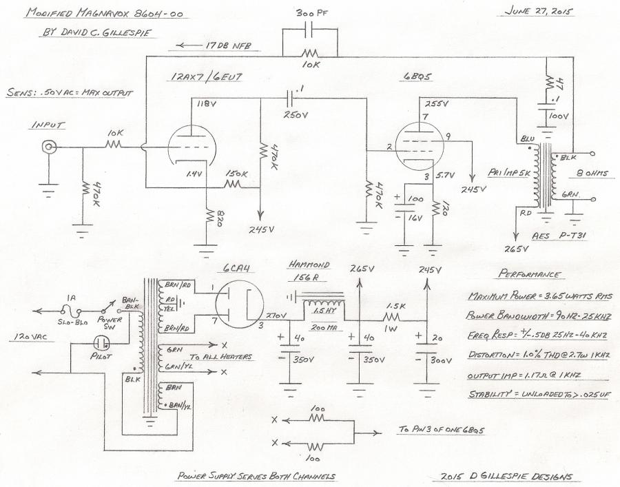

Here is a modded Maggie SE for more modern speakers and better sonics which is well liked on another forum and it can use the PT-31 Output Transformer electrix posted in #32.
Mr. Gillespie knows his stuff. However, I'll pick a few small nits. The 470 Kohm grid to ground resistance at the I/P will adversely interact with the voltage amplifier triode's high CMiller to cause HF info loss. IMO, 100 Kohms is a better choice for that job. The 'X7 triode exhibits low transconductance (gm) and presents a minimal risk for parasitic oscillation. IMO, the 10 Kohm grid stopper is overkill and a 100 Ω carbon composition (CC) part is quite sufficient. Where I would like a 10 Kohm or even larger CC grid stopper is on the O/P tube's control grid, where the drawings show none. While parasitic oscillation is always a matter of concern in a DIY project, a substantial value in this position also aids in the blocking distortion dept.
Assuming a 100 Kohm I/P grid to ground resistance, insert a 0.082 μF. cap., like this, in the line between the RCA jack's center pin and the grid to ground resistor. A high pass filter that "corners" at 19.4 Hz. is formed that provides protection against infrasonic noise driven O/P "iron" core saturation.
Pentode plate current is much more influenced by screen grid (g2) voltage than it is by plate voltage. We are going to 0A2 regulate g2 voltage at 150 V. Wherever the voltage doubler B+ supply comes in, it will be OK. O/P tube control grid bias will be adjusted to ensure that plate dissipation does not exceed a safe 11.5 W.
The Zobel network on the O/P transformer secondary and the 300 pF. phase compensation cap. are "iron" specific. The Edcor trafo may or may not need a Zobel network. Exact setting of the phase compensation part's value requires a square wave generator and an o'scope. If necessary a brute force method of phase compensation is available.
