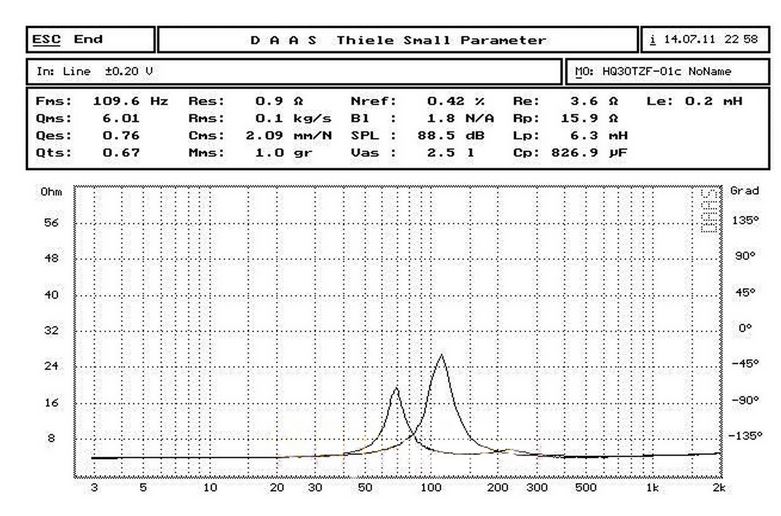

The spec. sheet for the Faital driver "Lingwendil" suggested contains (IMO) a very interesting number. Notice the Qts of 0.7, which suggests excellent performance in a bass reflex setup. FWIW, I did, and still own, a 4 inch high Qts driver in a 0.55 ft.3 enclosure whose ports tuned the setup to 55 Hz. The simulation was flat within 3 dB. down to 50 Hz.
While that sort of cabinet volume is not available in a "boombox", a well thought out bass reflex setup should get the 3 dB. down point lower than the documented free air resonance of 110 Hz. Port the enclosure to the rear.
To be fair, that DROK driver's Qts of 6.7 is also attractive. What I see as an important negative is the 4 Ω nominal impedance combined with the 88.5 dB. claimed sensitivity. As 2.83 V. into 4 Ω is 2 W., not 1 W., the "true" sensitivity is 85.5 dB. 😡 Unlike an output transformerless (OTL) SS amp, a tube amp's O/P power doesn't increase into a 4 Ω load.

Which speaker parameter does tell you that this is efficient speaker or not?

Sensitivity is (perhaps) a better word than efficiency. Forget the "hype" found on Amazon and look at the real provided info. Sensitivity (SPL) is stated as 88.5, which as previously explained has to be derated to 85.5, given the 4 Ω nominal impedance. So, the driver will produce a sound pressure level (SPL) of 85.5 dB. at a 1 Meter distance, when fed 1 W. of power. Remember Joppa's 102 SPL Rule and an amp of more than 60 WPC is in order. Each 3 dB. increase in SPL requires a doubling of the driving power. Now the 91 dB. sensitivity of the Faital 4" driver is not high, but it is a heck of lot better than that of the DROK driver. "Only" 16 WPC are needed to satisfy Joppa's 102 dB. Rule.
