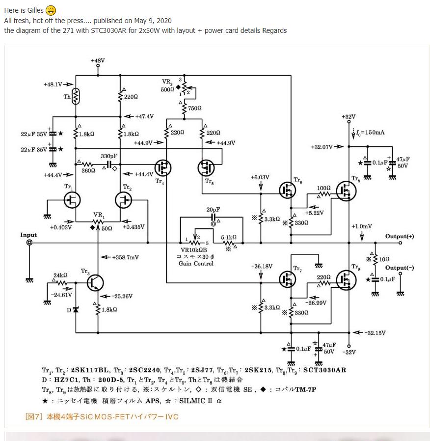

While scanning some of my downloaded KiCAD files (for reference), I found this one zipped folder, it contains 3 schematics in a whole KiCAD job files. The files I believe was shared by one member, he provided the link for downloads. It does contain one completed pcb lay out with gerbers included and one incomplete lay-out. The zipped files attached contains them all, (opens in KiCAD program).
The BJT version looks interesting to me, are these schematics a true Kaneda designs?

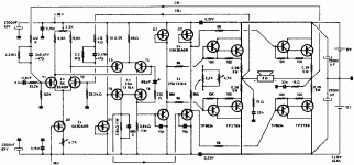

50W Class A published in La Revue de L’Audiophile. From Bonavolta link https://www.bonavolta.ch/hobby/en/audio/tp2788.htm

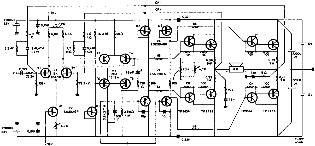

Schematic by Pierre Johannet published in "L'Audiophile"
Not every Double-Differential circuit is original Kaneda.
https://www.diyaudio.com/community/threads/kaneda-50w-class-a-amplifier.17178/post-3227431
https://www.diyaudio.com/community/threads/kaneda-50w-class-a-amplifier.17178/post-3227437
The picture also does not correspond to the link above (TP2788).
Maybe this one :
http://6bm8.lab.free.fr/Documentations/Revues/Audiophile/1977-1988/43/CLASSEA/CLASSEA.html

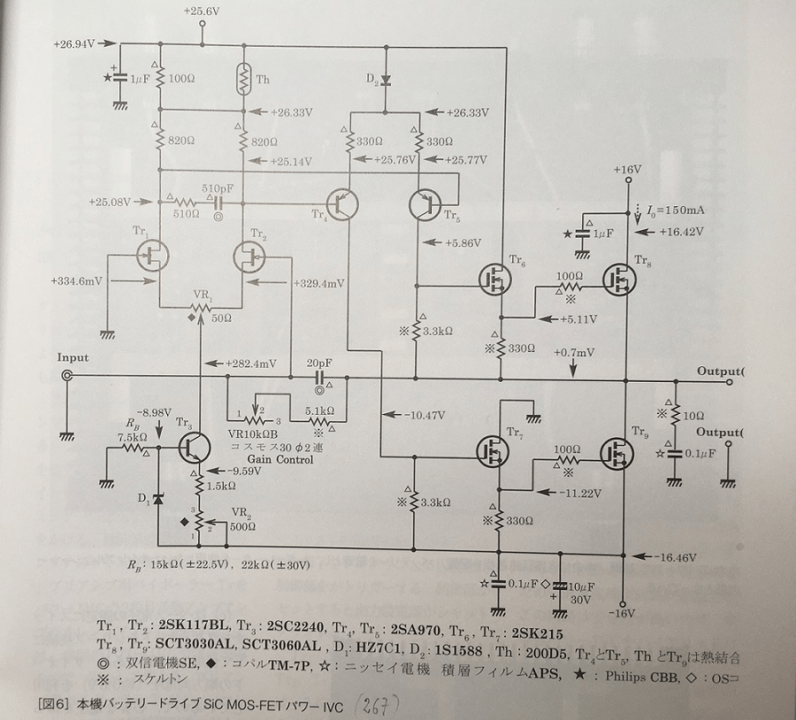

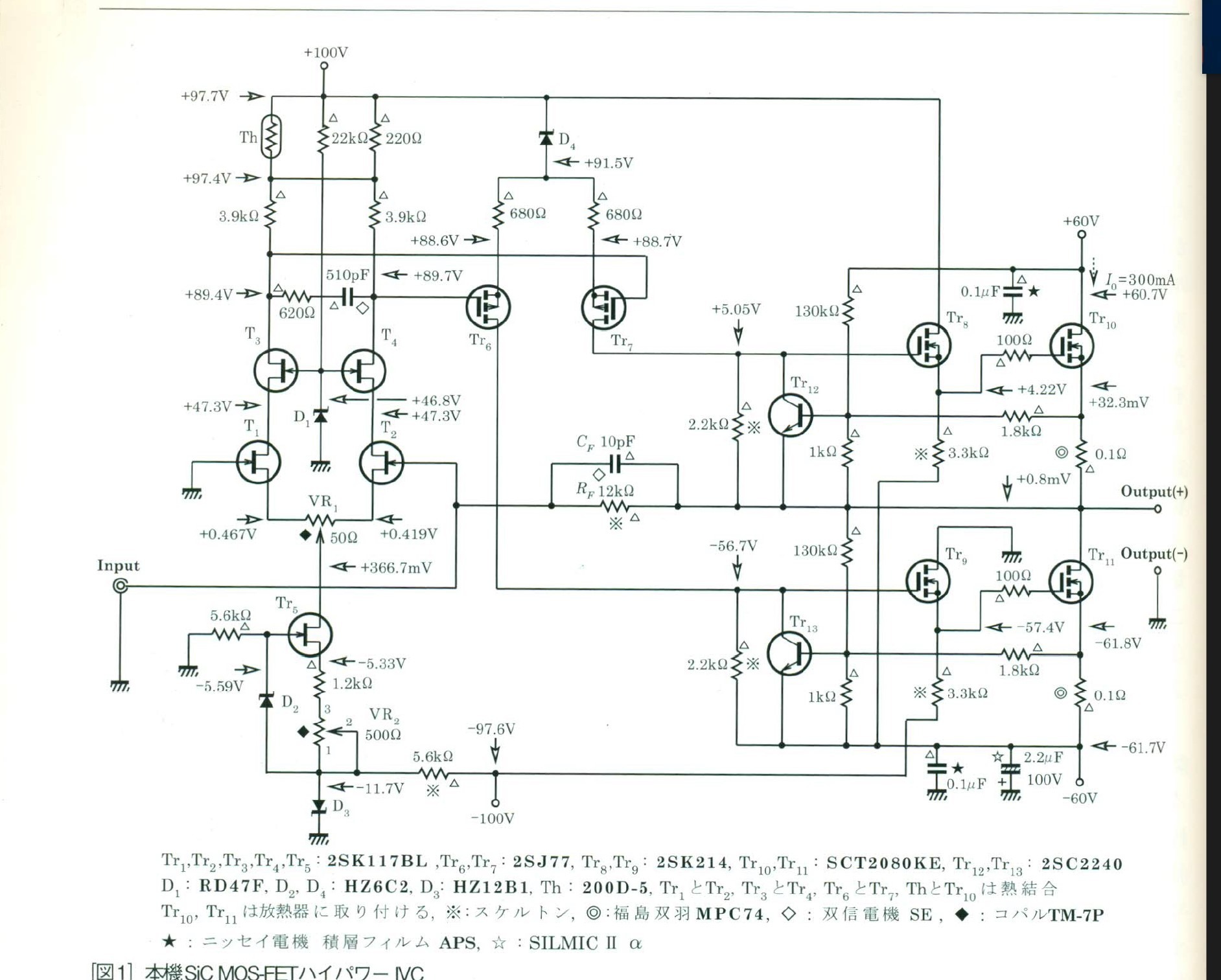

I was very impressed by your idea that you can get 2sk190 with 4x 2sk209. I want to make a Kaneda amplifier and it is difficult for me to get 2sk117. Can we create a 2sk117BL jfett using new generation jfets. There are currently jfets such as 2sk208-209-880 etc. LSK170 etc. You know better than me.
Which one do you recommend among Kaneda amplifiers? There are a few versions that I have chosen... Which one do you think is suitable?

2SK209 is the SMD version of 2SK117.
But it has much lower dissipation.
I would not use it for more than 50mW.
The above schematics have a lot of voltage values given.
You can easily work out the current through a resistor using Ohm's law ( I=V/R).
If that resistor is in series with the JFET, it is safe to assume that they have the same current.
The power is simply P=V.I
If the JFET sees 50V and has a current of 2mA, then clearly 2SK209 will not do.
Using two in parallel doubles the capacitances.
So not direct replacement.
See also :
