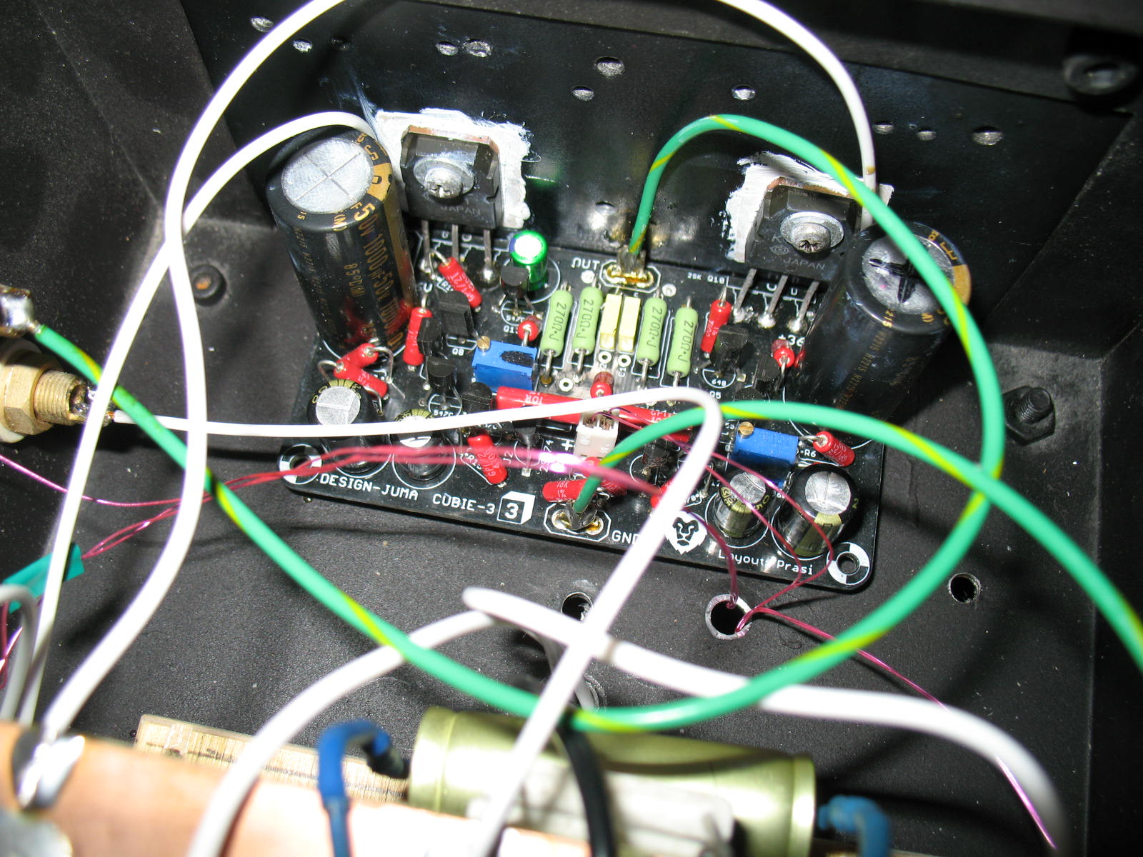

Today I finished another amplifier JUMA's Cubie 3.
It is a Hitachi lateral mosfet amp.
Biased into a couple Watt in to Class A.
Rail voltage 37 to 38V and bias set up 520-530 mA. Comfortably warm.
It is a keeper amplifier, sounds good but at the moment I prefer the Kaneda over the Cubie.
It has more air, more separation, not that (too) soft, smooth lateral sound. A bit more punch, somehow a bit faster or more dynamics.
I know the Kaneda can be improved even more with a bit higher bias and some better capacitors on the PCB.
I am happy to the Cubie also, now I have 2-3 amp as tool I can compare those when I try to improve sound wise.
While I work on one amp I can listen the others.
The Cubie was built all exotic parts, not much to do there, just need some time to break in!
Greetings

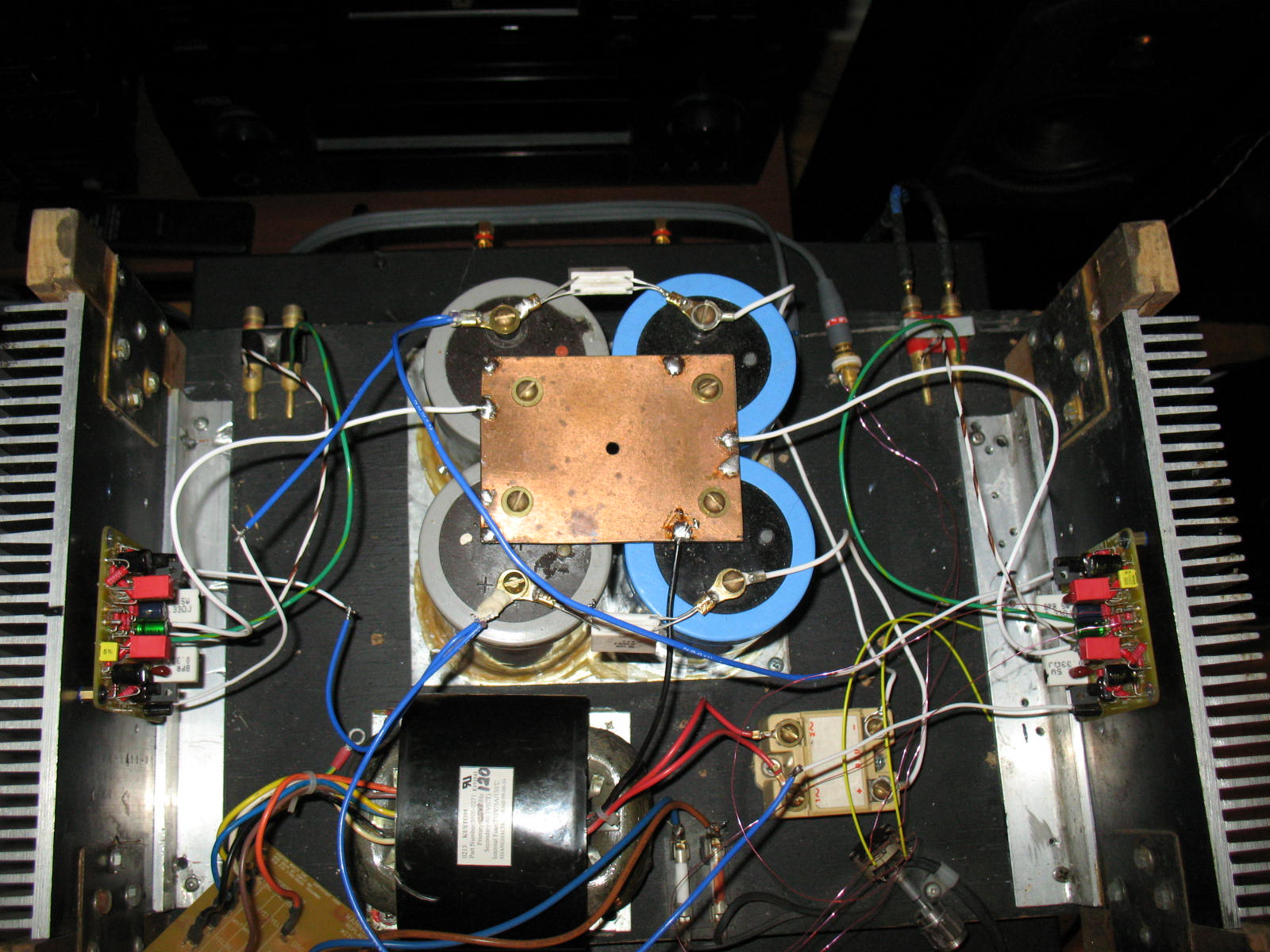

Today something total different on the test bench. A Musical Fidelity A 1 clone.
Only one channel up and running (finished).
Both channel OK but I run out basic stuff like signal wire, solder etc. I may use what I find for testing.
That one channel up and running on 25V rail voltage 1A bias.
Would love to compare to the original M Fidelity which came back to the market, was revived.
To early to say anything about the sound other than it is very promising.

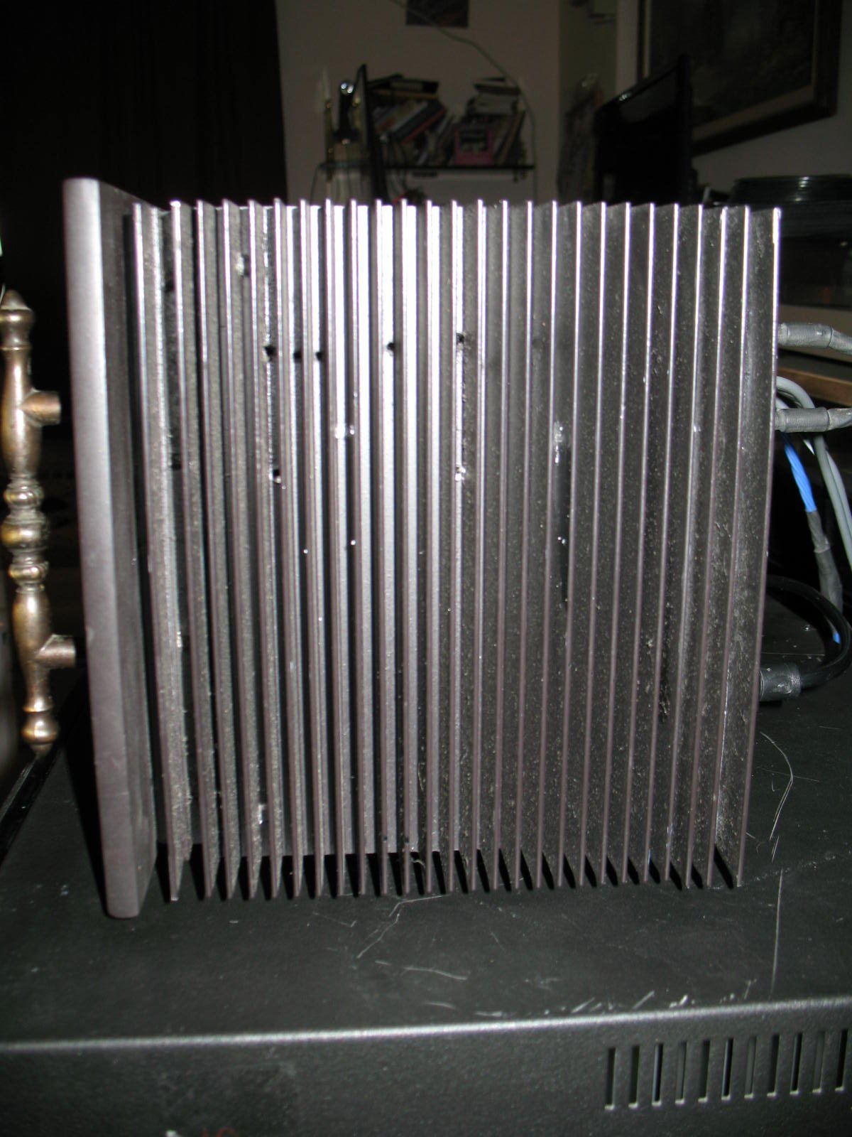

My test heatsink is to small, I can not run it more than one hour at the time.
- That is not the final amplifier build, it just the testing wood model.
I am happy because both channel alive (under power), biased, working. No smoke no burning etc.
Last 10-15 years I populated several amplifier kits / PCBs and never tested, now I have sometimes and I have appetite to test them.
Some pictures

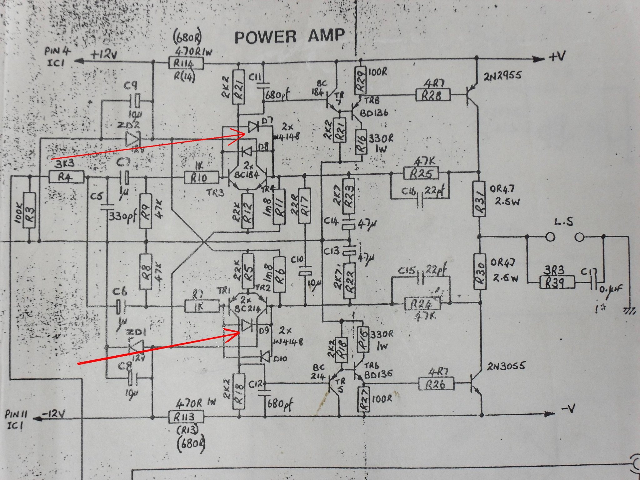

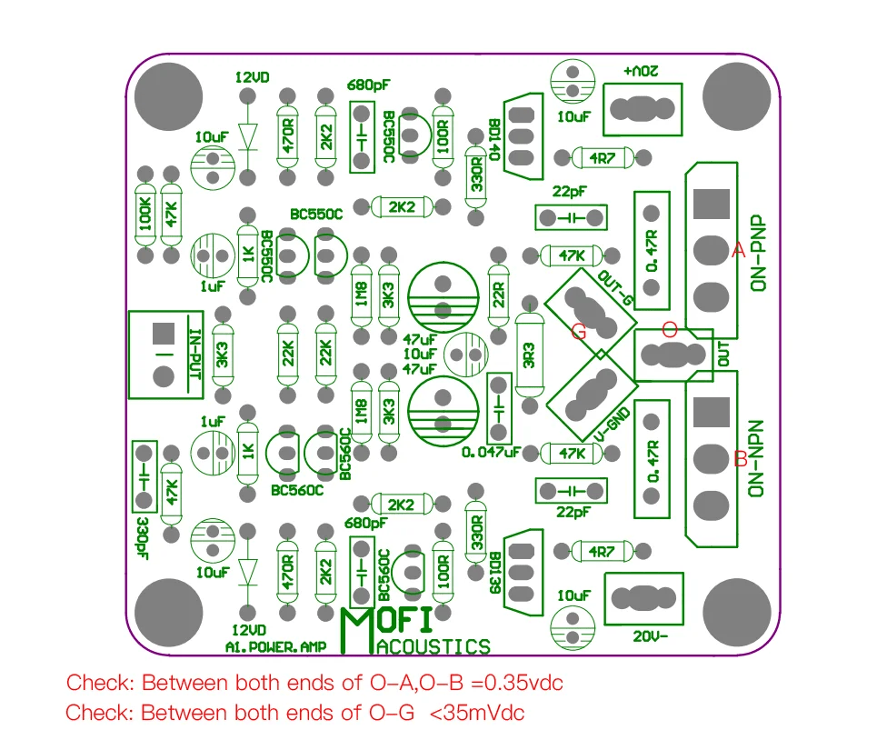

I have a question
On the schematic there are 4 piece of 1N4148 diodes (I marked with red). How important those, please see the picture?
Does those diodes influence the performance (sound) of the amplifier or only for safety purpose?
All the schematic I find on the net it include those diodes!
The PCB I purchased does not have neither the parts list include those. I wanted to ad those but I forget.......
The amplifier up and running, both channel.
Some instrument sounds wonderful like piano, strings, sax etc, vocals are also nice.
But when it come to the whole music I wish it could have more separation between the instruments.
The bass a bit clouded, like greasy bass strings, Not to bad but it is there.
Maybe the DC blocking Wima capacitors? I sow people upgraded the orig M Fidelity and they used Wima also instead the 1uF electrolytics.
Of course it needs more time to break in, also those large can caps (they are not bypassed with smaller caps) with some amp tend to produce that type of sound! Soon I will replace the capacitors bank with the one I plane to use in the final build.
This amp runs hot, very hot!
Of course I will use bigger heatsink. At the moment all 3 of my other amplifier outperform this.
Not bad sounding amplifier but that is the truth.
The N Pass F5 with Toshiba power mosfets, the JUMA amplifier and the Kaneda to. My favorite still is the Kaneda before the Juma's amp.
Again it is too soon for the final evaluation and I plan to modify the power supply ASAP.
One more time, They all need more break in time accept the F5 that already run like 200 hours.

You can also connect two green 2mm low current leds antiparallel to the C5, the 330pF capacitor, in conjunction with the R4, the 3k3Ohm resistor, this rudimentary limiter works perfectly.
It is important to prevent rail-to-rail modulation of the output stage.

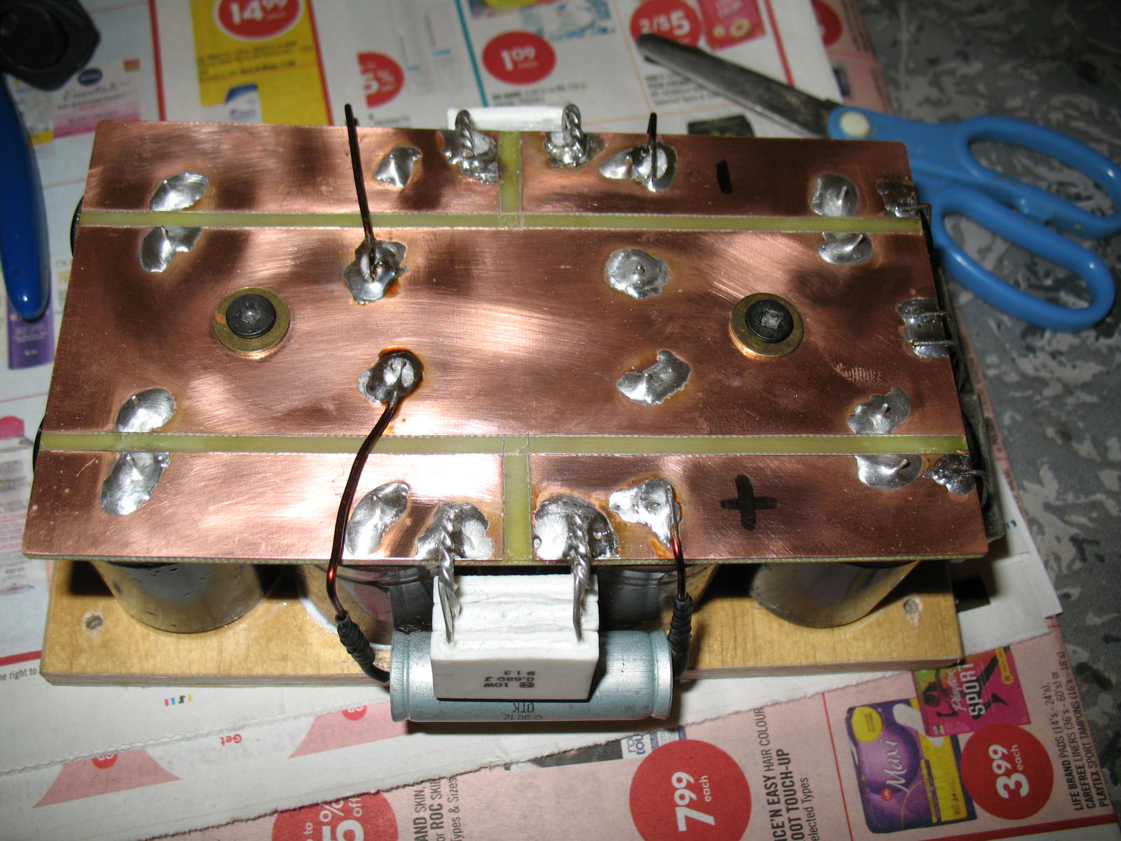

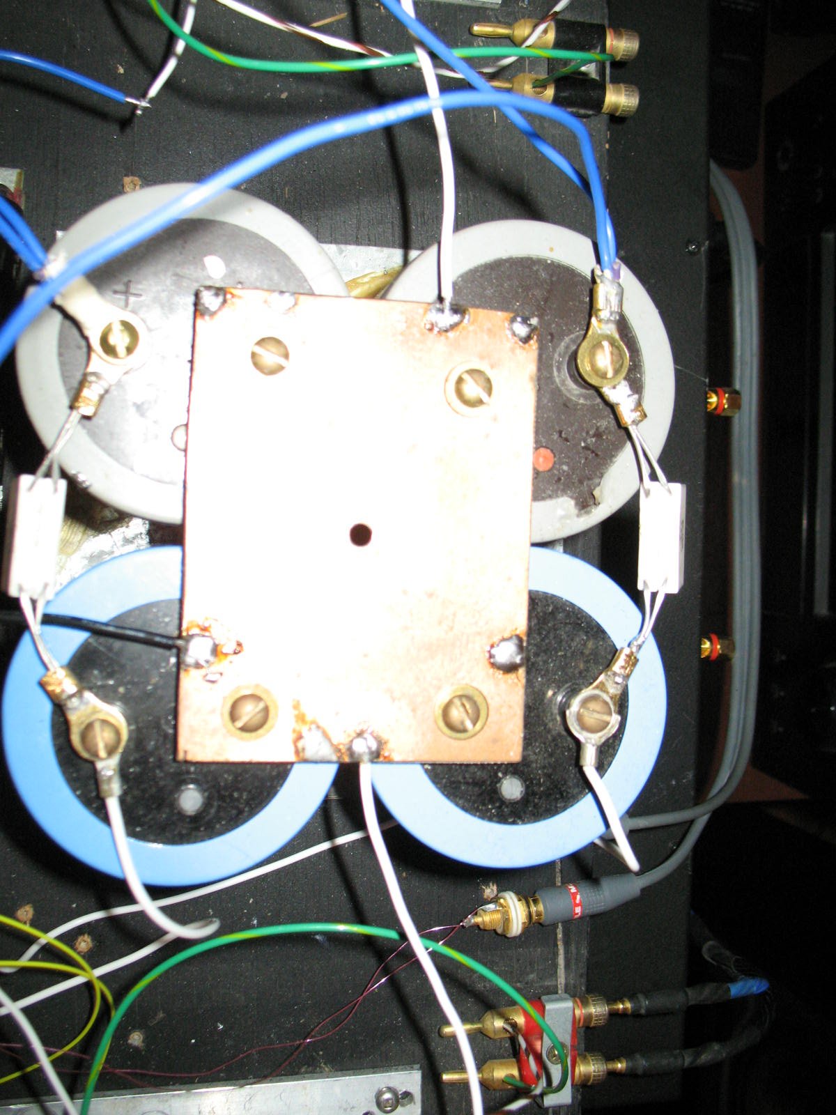

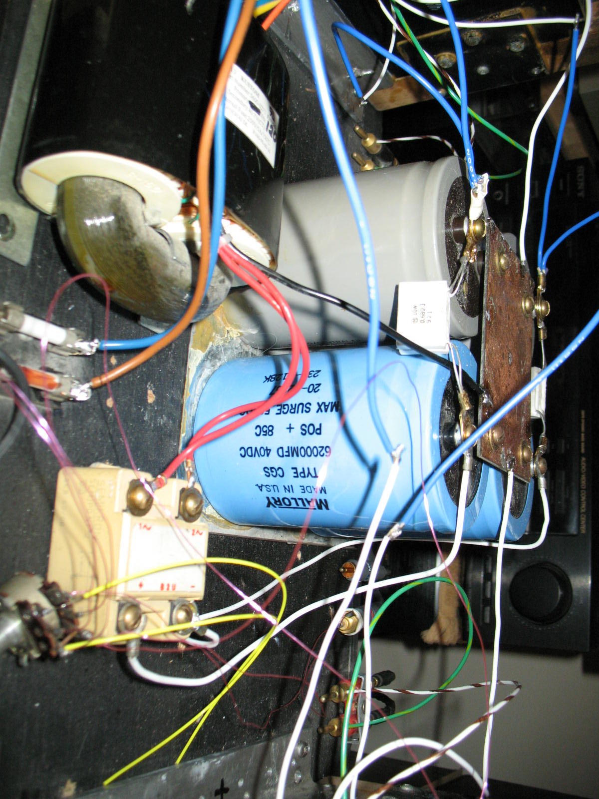

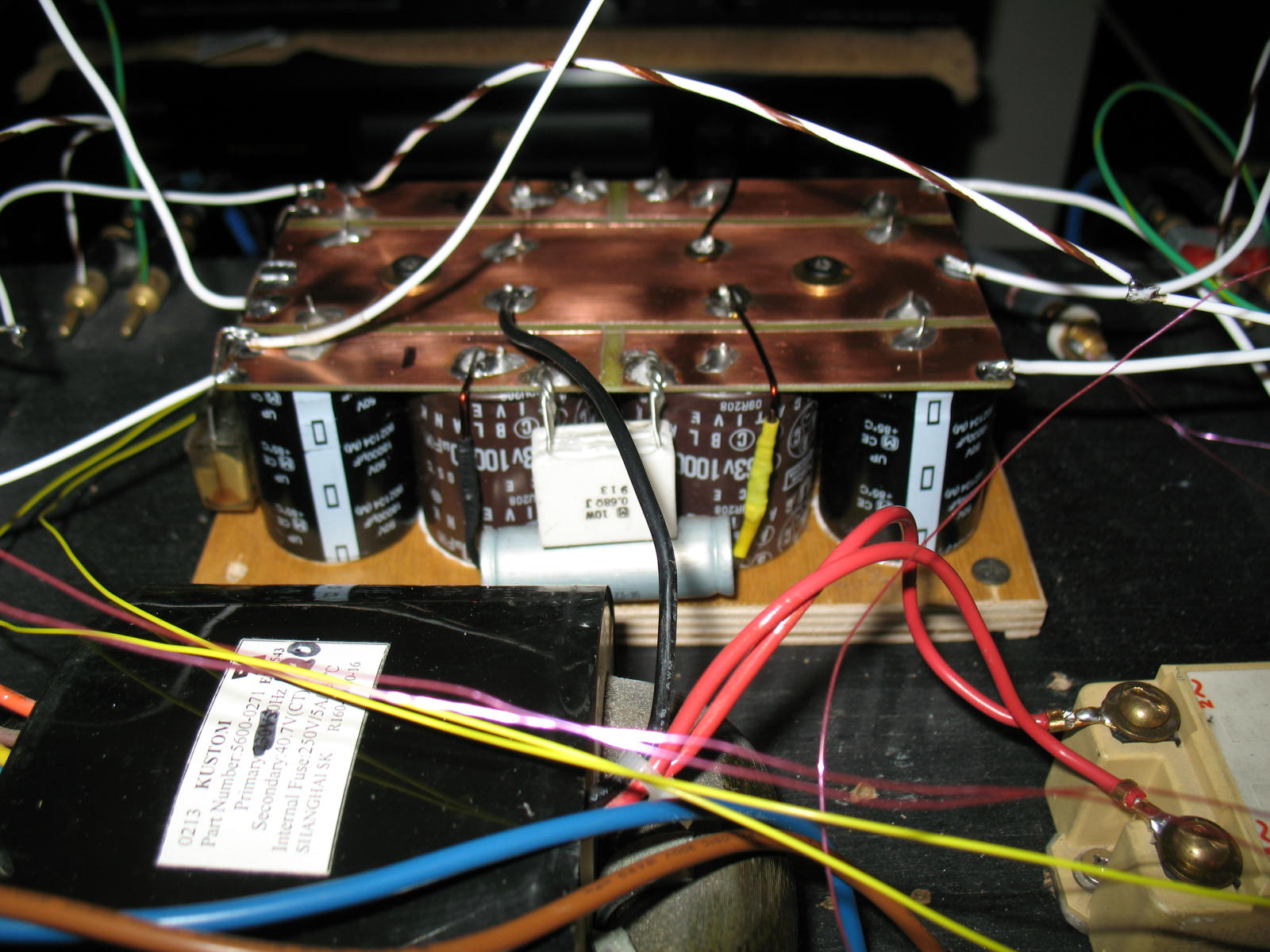

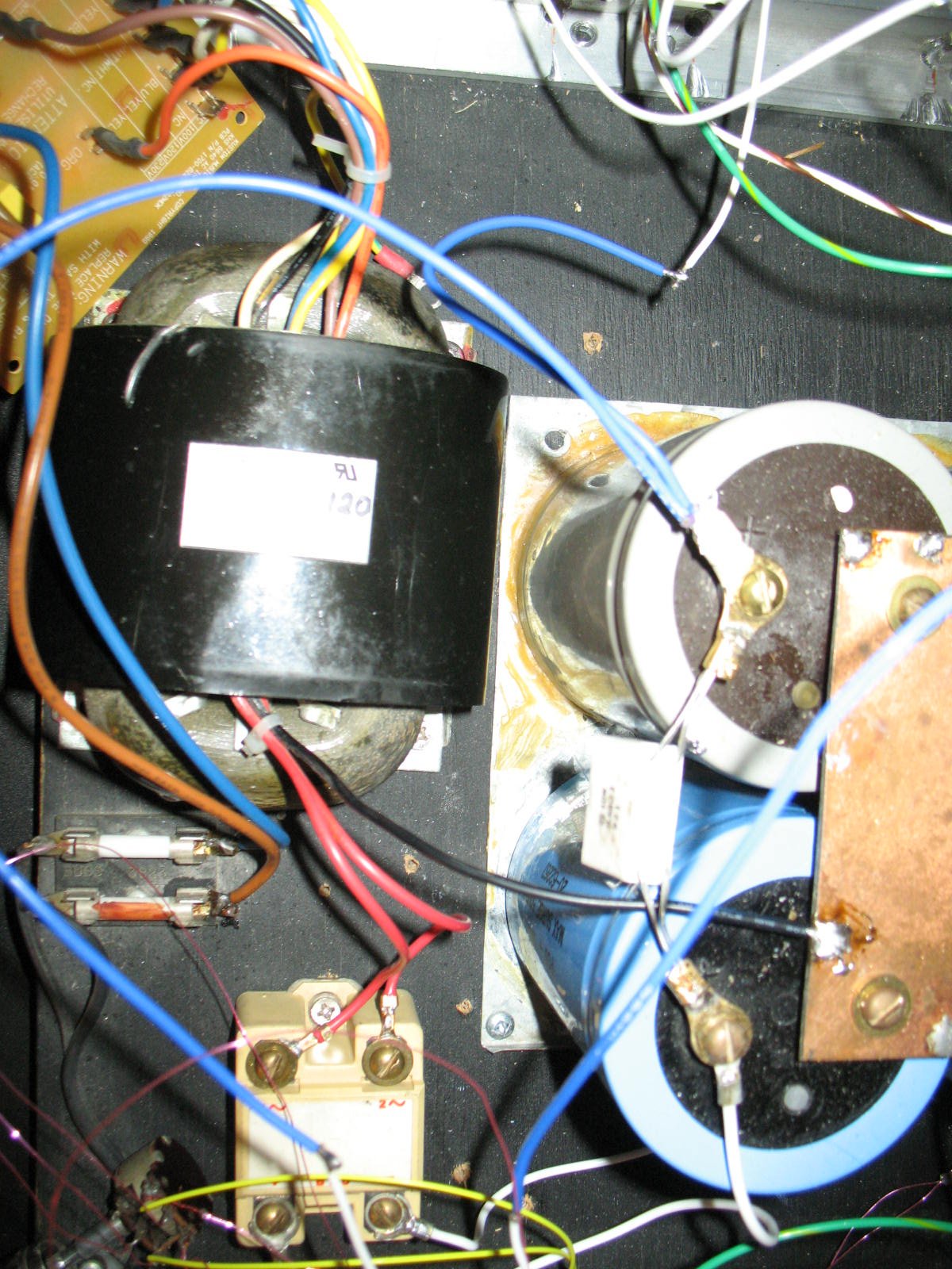

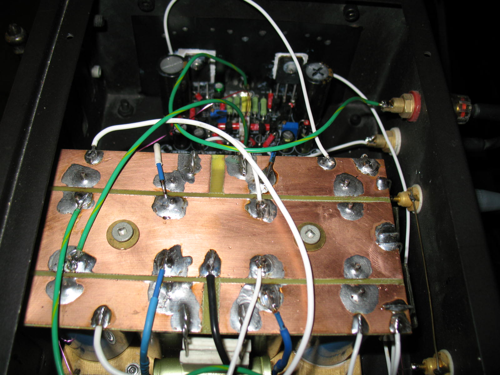

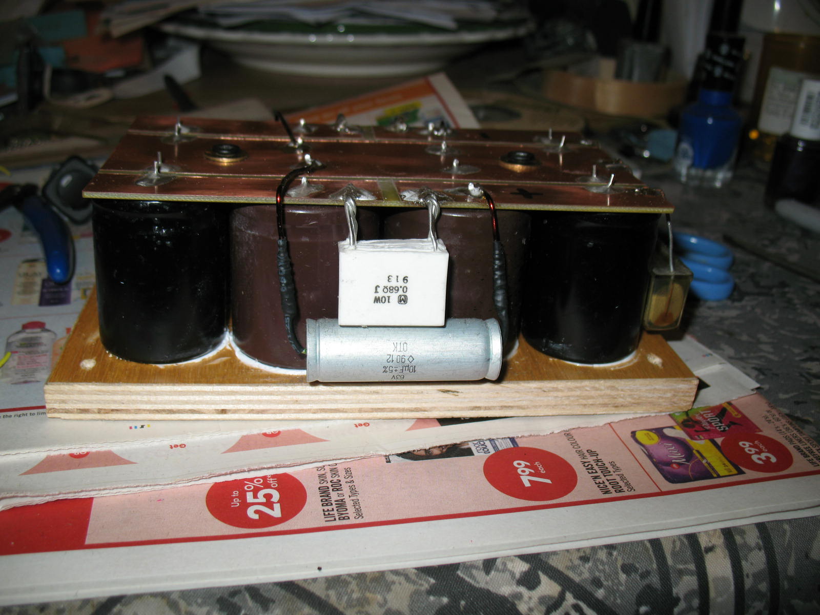

Today I replaced those big can capacitors, just finished.
First CD after that, yes the sound open up! Of course it need to break in. I added similar capacitor bank like Juma's and Kaneda amp having.
Thank you for the advise about the green LED.
I only have at home 3mm type if that fine I can test it later when I remove the PCBs from the heatsink.
Not much room around 330pF capacitor.
Also the PCB so delicate (small in size) I have to be very careful soldering and de-soldering components.
I have a small Class A amplifier case and I wanted something into it.
I pick this M Fidelity A1 amplifier. I read and heard a lot of good things about her.
Right now it has 56 000uF each rail.

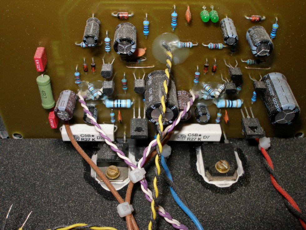

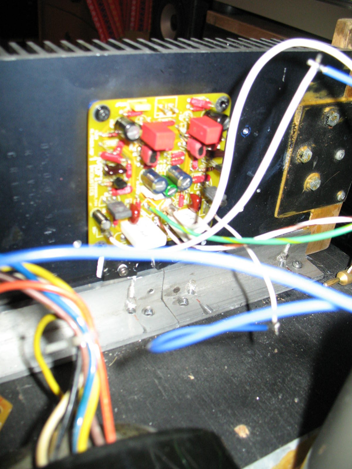

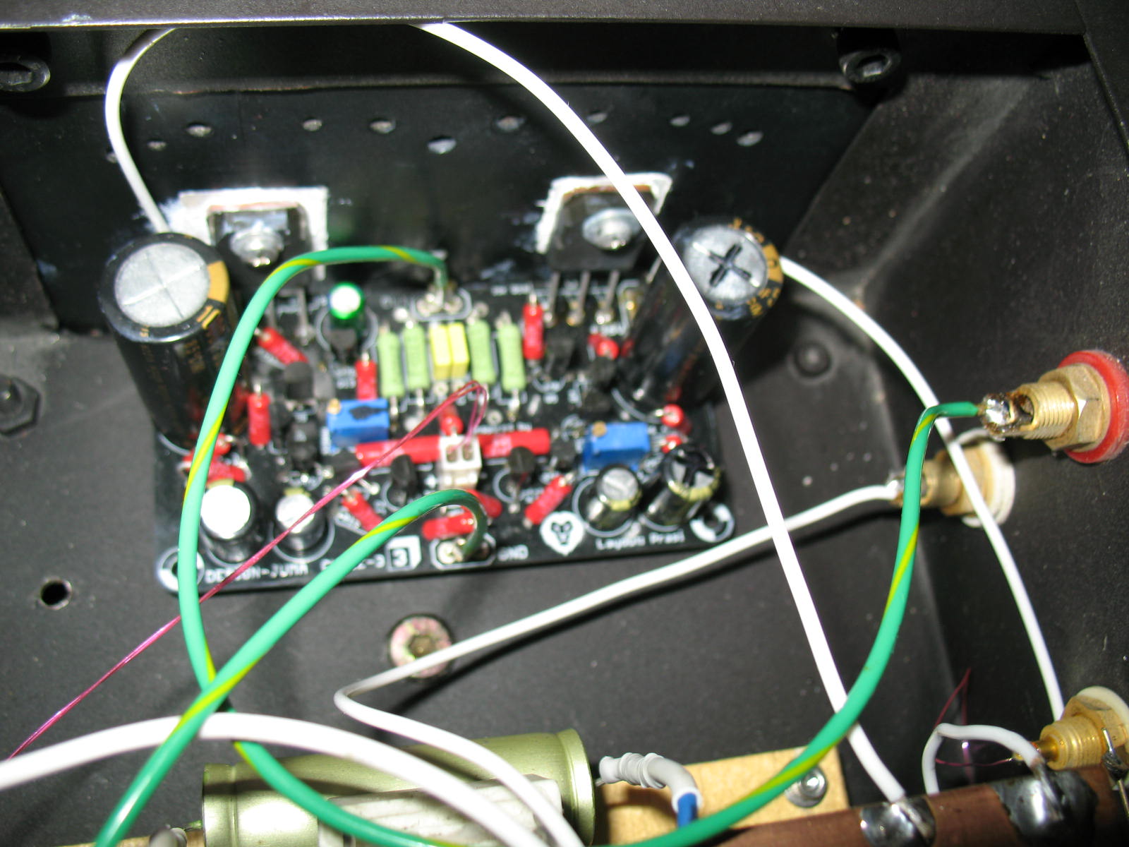

These is how the PCB looks like. It is about 80 X 75 MM, small size with skinny traces.
For a Class A amp it is a very bad PCB design!!
I would like to upgrade some parts like the BD139/140 to a Toshiba device. I have some original good quality Toshiba VAS transistors.
Because of that I afraid to de-solder anything!
Also instead the 2 X 1uF I used Wima 2 X 1.5uF WIMA capacitors.
Someone upgraded his original M Fidelity with Wima, I follow that.
Maybe I upgrade to 10uF Silmic or Nichicon MUSE (green). I am not a big fan of the Wima caps on the input.
Sometimes I use what I got at home.
You can see they left out the 4 piece of the 1N4148 diodes and also not much room to ad the 2PC of LED next to the 330pF capacitor.
By replacing the big can capacitors the sound definitely opened up! Almost like a different amplifier. Sound much better not that boring, clouded mid-bass anymore.
I need to run her at least 50 to 100 hours to burn in for better evaluation. ( to compare to the other amplifier). It is a promising amplifier, not bad at all.
