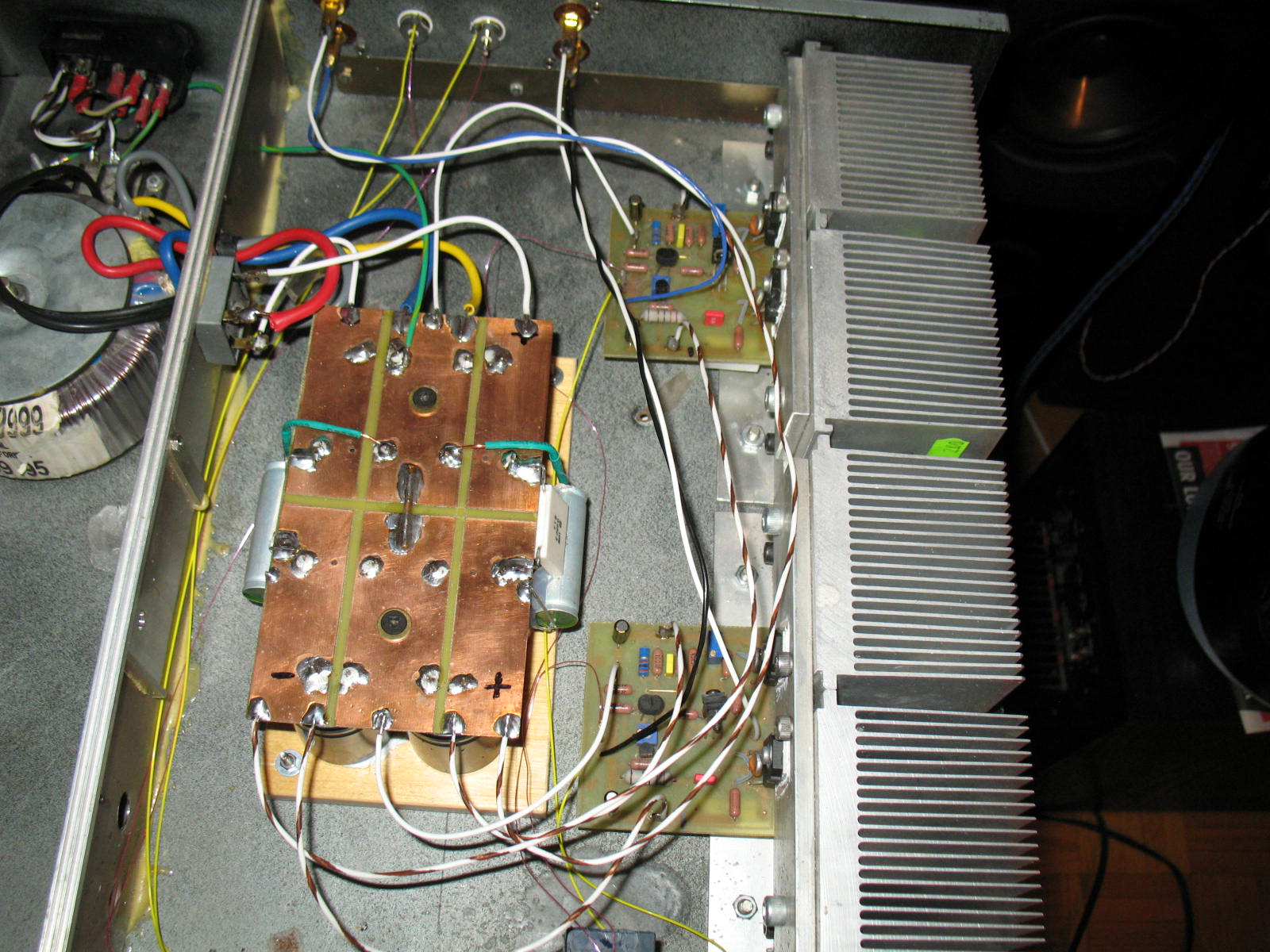

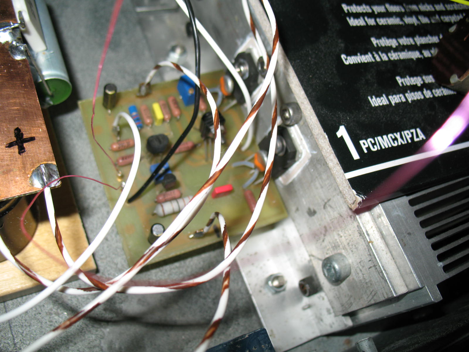

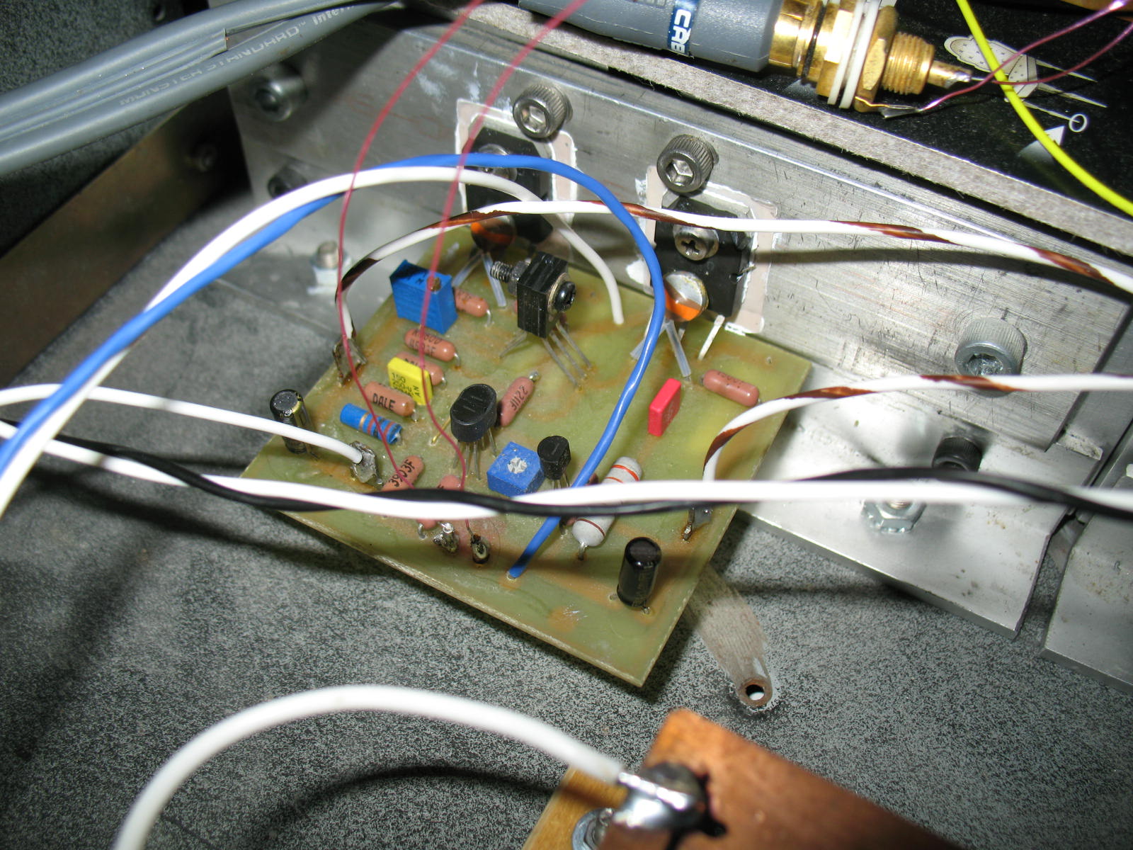

Some picture coming up as I promised.

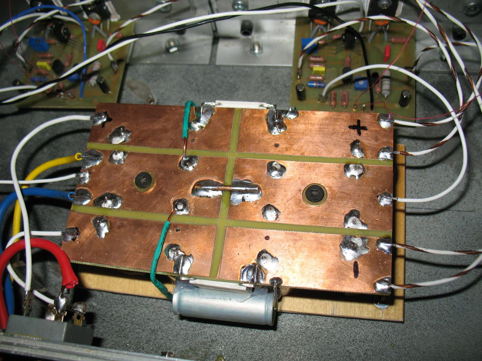

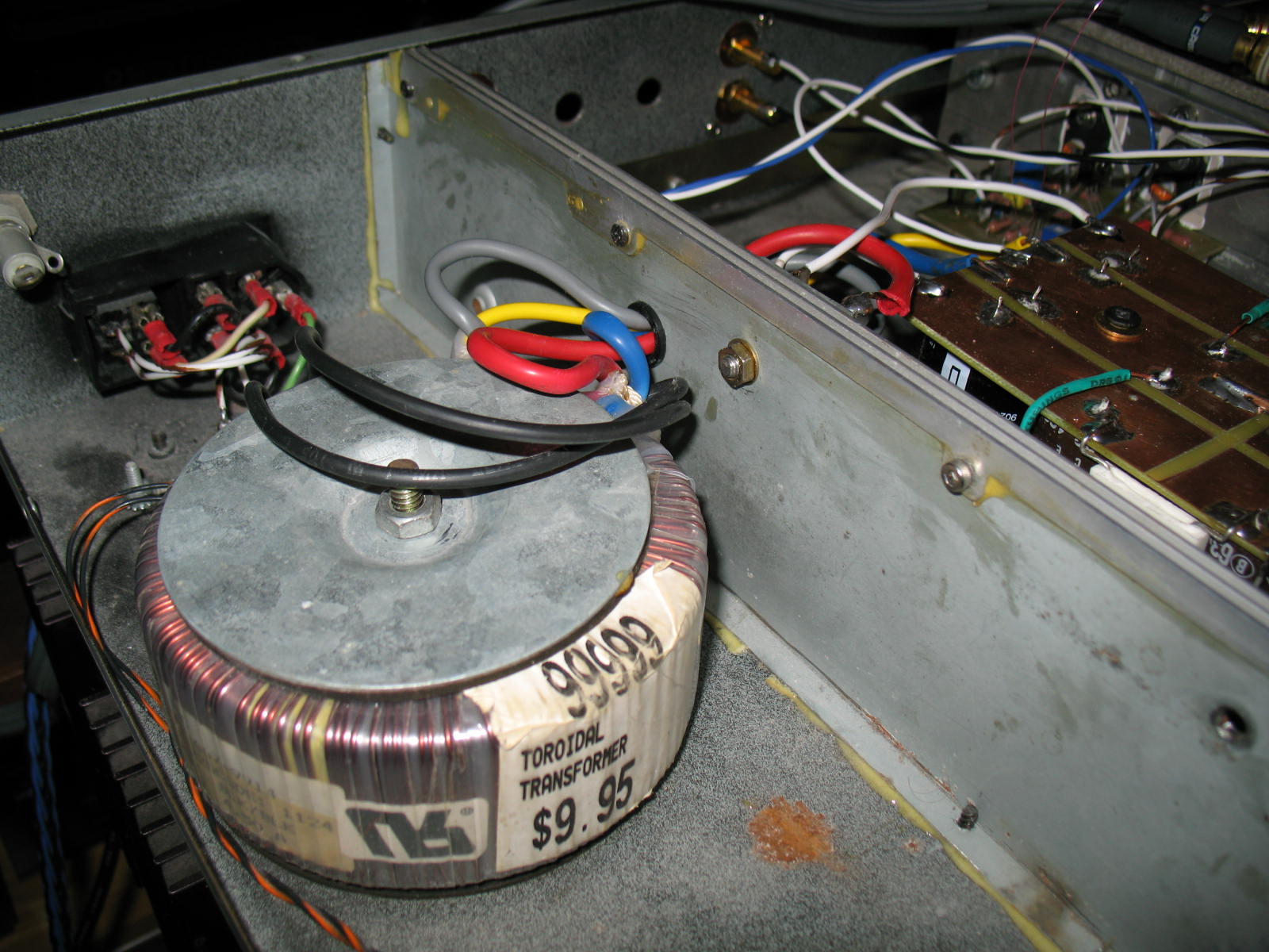

I use a 250VA, 2x20VAC toroid transformer, 56 000uF capacitors per rail, C-C-R-C-C setup.
For the drivers instead the old caned transistor I use from ST BD140 transistors.
I had at home JFets 2SK117 enough to get the two matched LTP.
The power mosfet I have the original but because it is in plastic case and has only a 50W heat dissipation I replaced other type of Hitachi power mosfet.
I did compared the two different mosfets and no sound degradation.

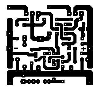

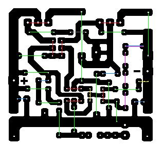

The layout I posted the 2.0 version (improved) and you must use the mirror image when you printed out.

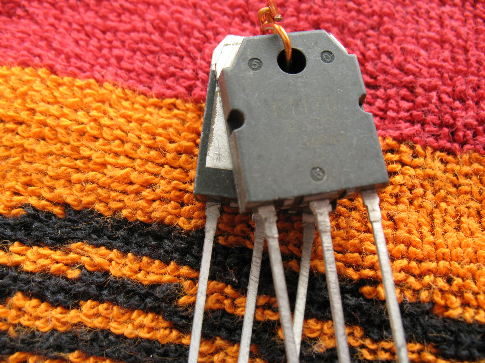

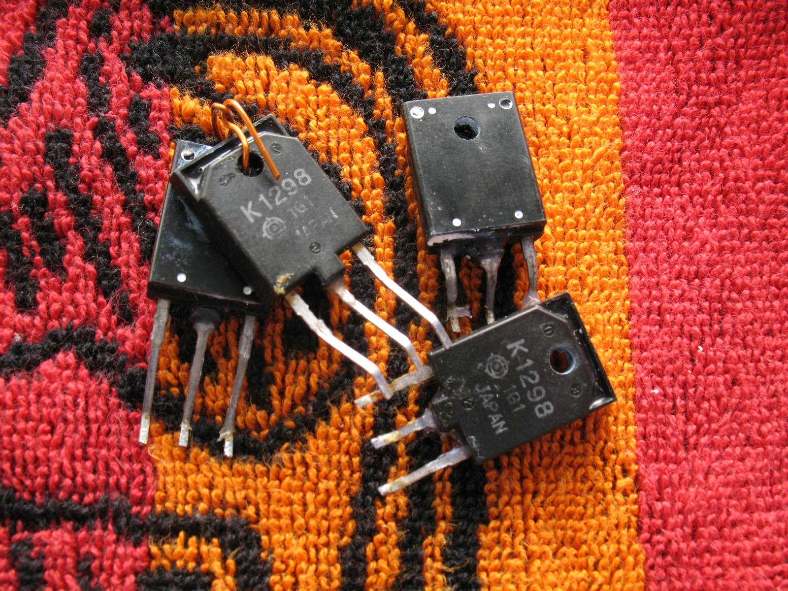

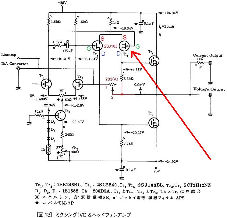

This is the original mosfet from the circuit. Please see the pictures.
I felt very un-easy to keep those in the amplifier, only plastic case and 50W heat dissipation.
I ordered something similar Hitachi (based on the data sheet) 2SK1170 and did multiple A-B tests between them.
Maybe it would work with other type of mosfet (Hex-fet) also. I did not tried.
Ali-express sells mosfet as the original with the heat spreader.

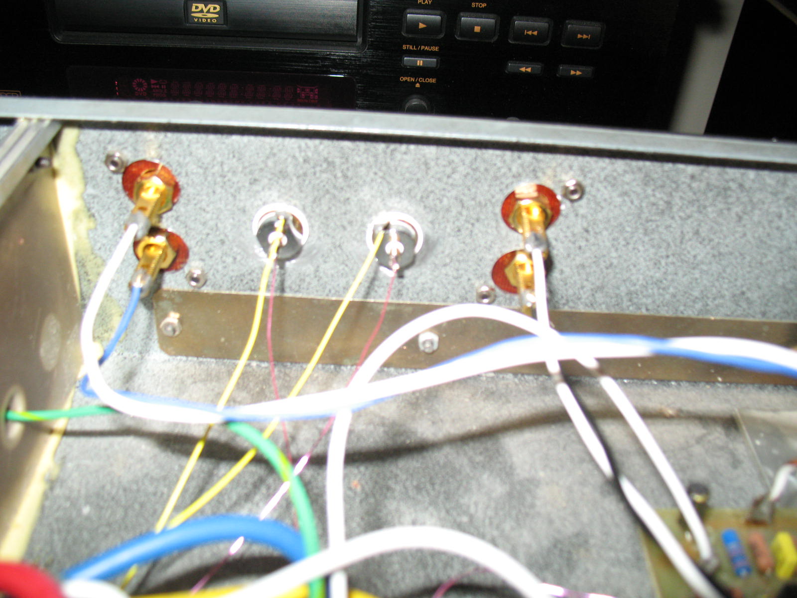

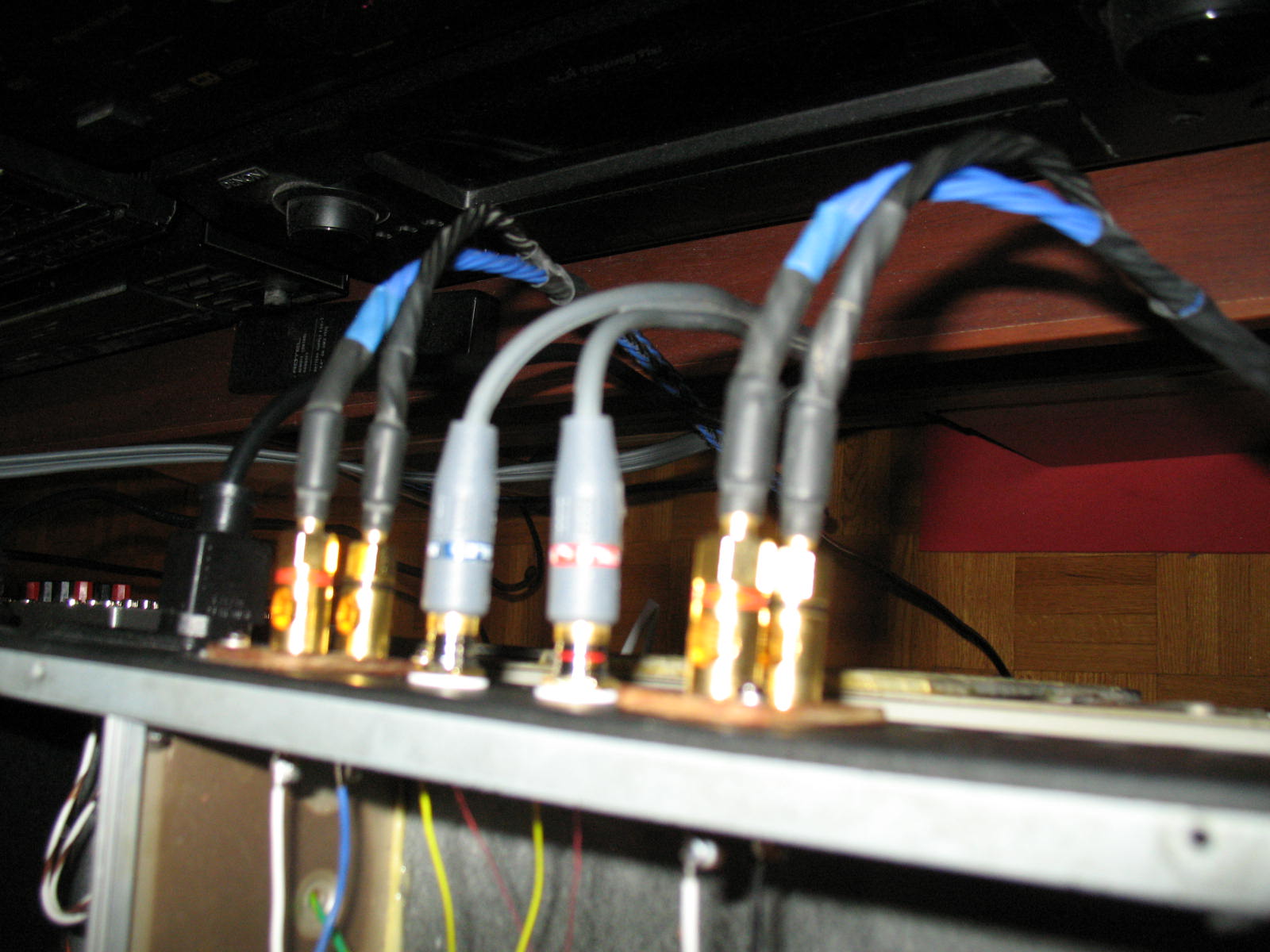

Today I gave the amp it is own Alps Blue potentiometer, rhodium plated RCA connectors, I wire up those
I need to find a better fitting volume control knob because the one I got not satisfy me, does not match the amp (looks fugly).
Time to put the lead on and enjoy her. It is a keeper especially for hot summer days.

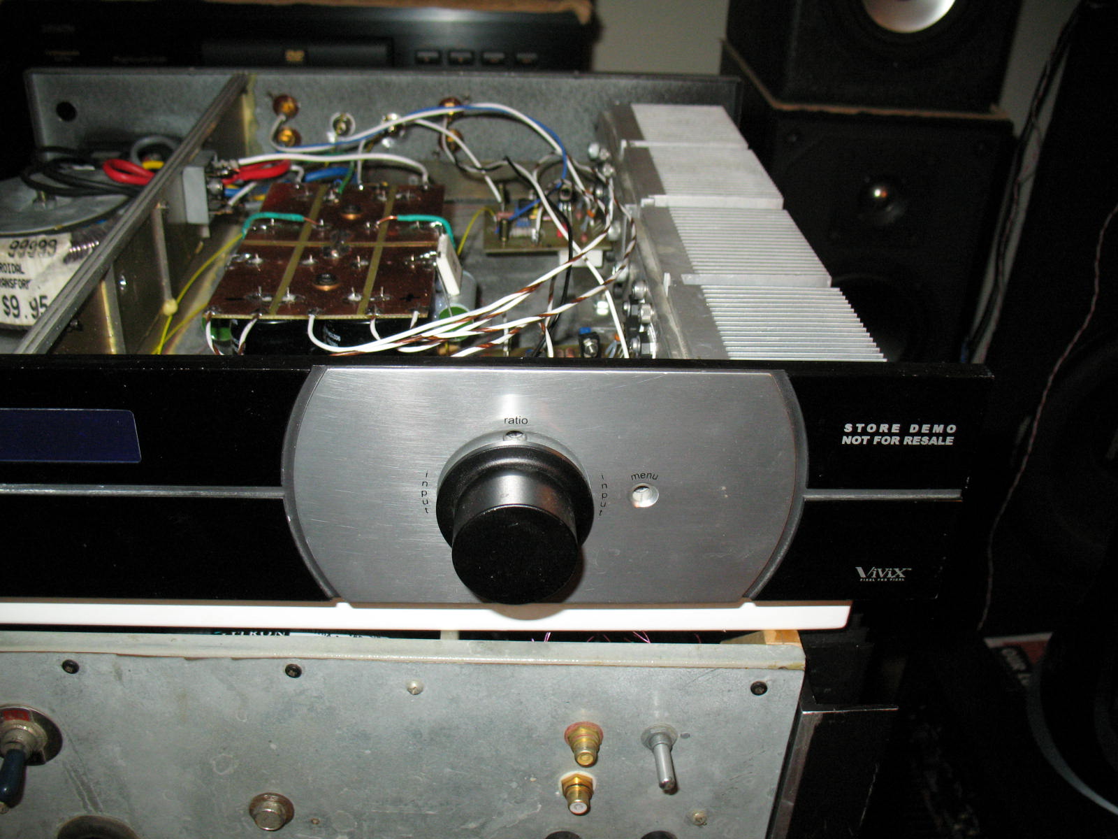

Some pictures from the last touches, before I put the cover on.

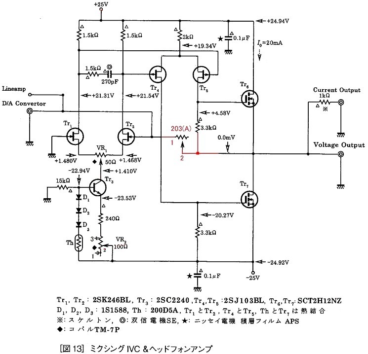

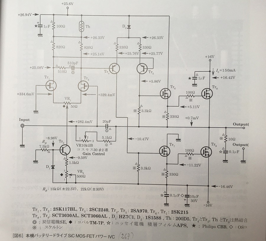

This Kaneda circuit is the twin sister the one I built. This one also uses a SIC power Fets!
Very likely from the same power supply it would work.
Of course it need to take care of the different semiconductors pin-out when it comes to the existing layout.

I think I got the layout. NOT tested(!) yet. I modified the original layout with the paint program.
Soon I will test it and let you know if I got it right.
I need to collect the parts.
Colors are codes for different parts,
Greens are resistors, Reds are Semiconductors, Blue are Cap, Purples are diodes..... Yellows are trimmers...
