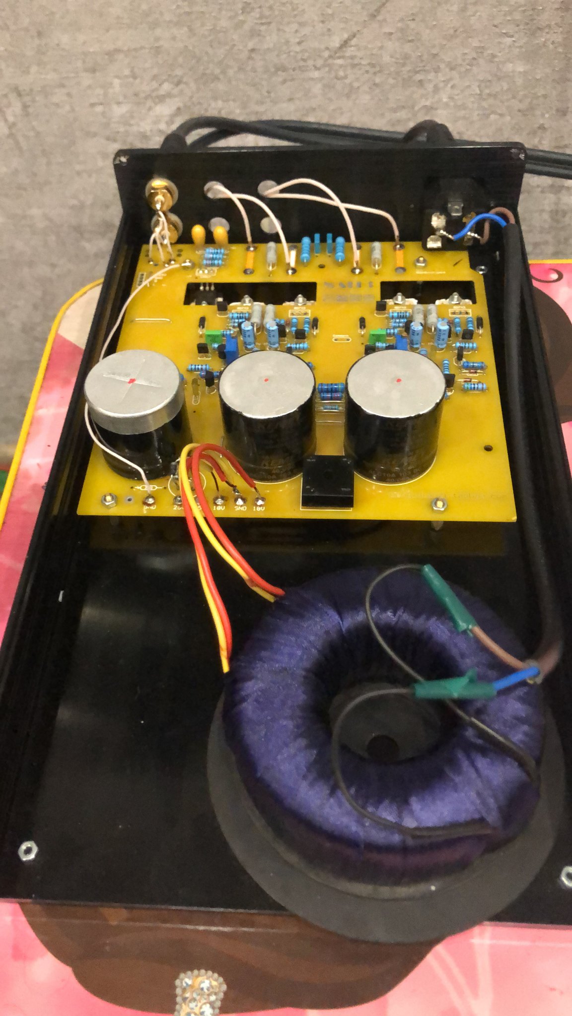

Working Nait3 DIY amp
Output voltage without signal about 3-4mV
Input transistors the original BC239C

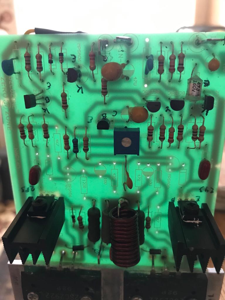

I buy the original NAP250.2 board
in this stage without one transistor 🙂
But nobody Known about NA00* Output transistors Volts/Ampers/h21e/max freq…
Good idea or not for DIY I don’t known
Richard D from Naim forum say only about 80 Ampers output current of nap250.2
Nap250.2 Monster transformer monster output currents for wat? 🙂 maybe Focal Utopia loads …
That's great ! I remember that you found errors in 250.2 clone PCBs circulating on a Chinese forum. I've saved the supposed 250.2 schematics if you want a starting base for doing reverse engineering. (I imagine that there must be quite a few errors in these diagrams)
For the output transistors it's always a concern the 80 amps I don't know the BDY58 don't have this capacity only the BUV22 and BUR51 have that but I don't think they are still available. The BUV22 is available. The BUV 22 have 40 Amp so 80 with a matched paired.
Namely that if the circuit works like that of the original 250 depending on the routing carried out and the transistors used, you will have to adjust the RC circuits of the phase compensation.

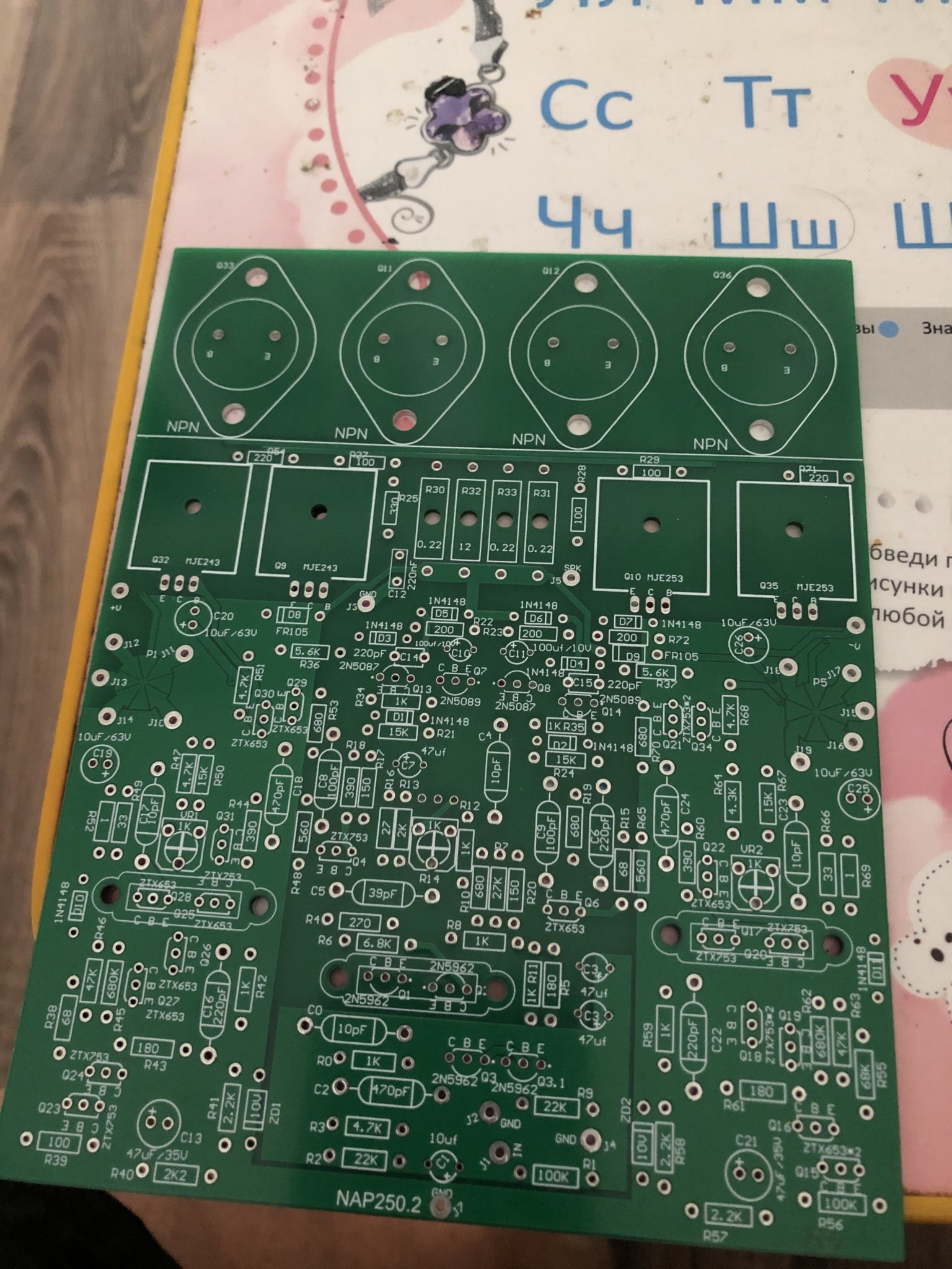

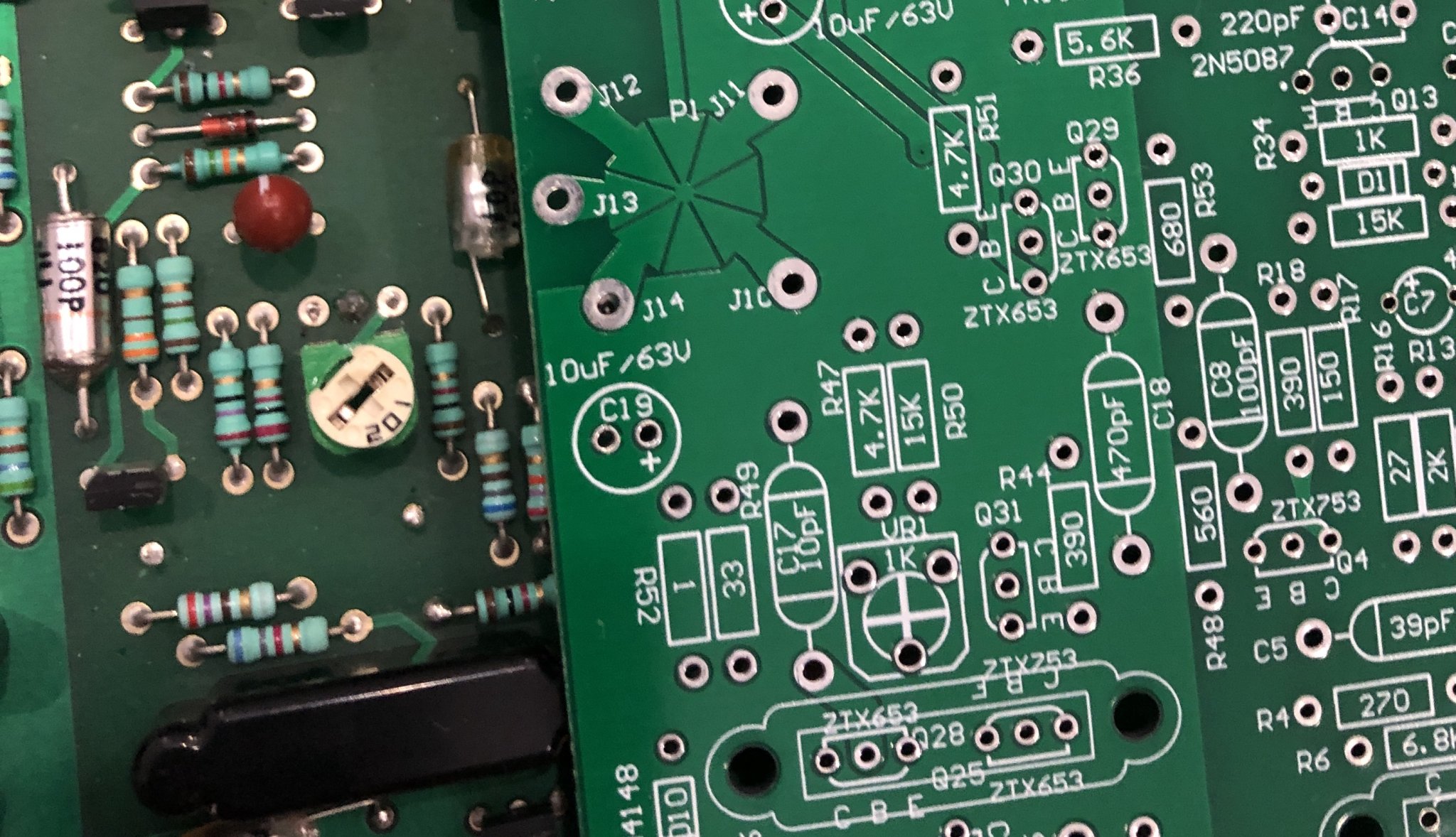

Can you please wrtite PCB errors? I bought 2 kind of pcb and I don't see any errors.
Good day
In attachment
China clone board of 250.2 with mistakes
I search about 5 but I think this one sh..t have more…
P.s this boards are still with me because
not have chance for trade or DIY the boards with mistakes

What amused me is that on their forum many contributors say they have mounted this clone of 250.2 and that it would work... not a single one found that it did not work correctly and that there were errors.
the mythomania is spread on the internet or once they bought the thing they didn't want to lose face and admit that it was a scam.
Reactions: Oleg Turbin
My friend maybe his buy the normal boards maybe not 🙂
I think you right
In my boards from Ali is not have many roads between parts
just check up photos
q4 is not connecting with 15k resistor… hhhhh and this just one error
Best way is a DRAW of new boards from original and make gerber to board in pcb factory
