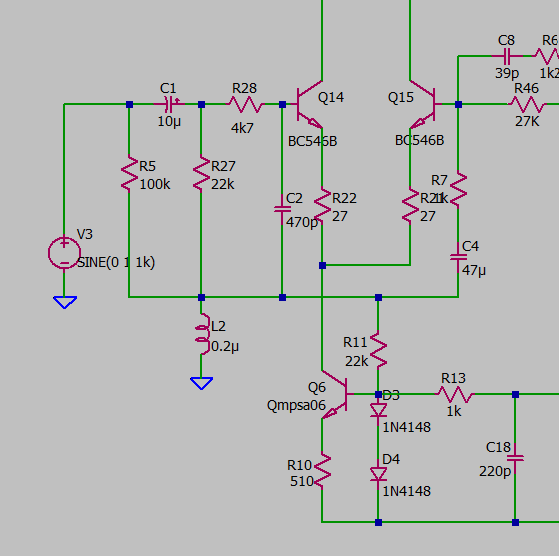

I think this is the answer: 47uf+47uf feedback capacitors (series with 1k) are charging. This charging & capacitor type are changing offset for half an hour.NAP140 clone works fine! I have a question output offset voltage. When turn on the amp. Offset is larger than 50mv. decreasing very fast and after perhaps half an hour after it decrease to 1mv and stay at 1 mv. How this mechanism work?
If there is no simple answer. Forget it

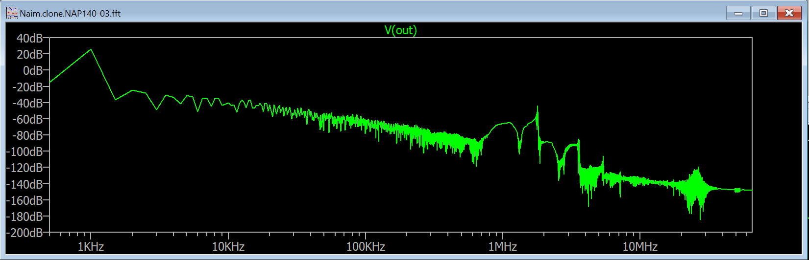

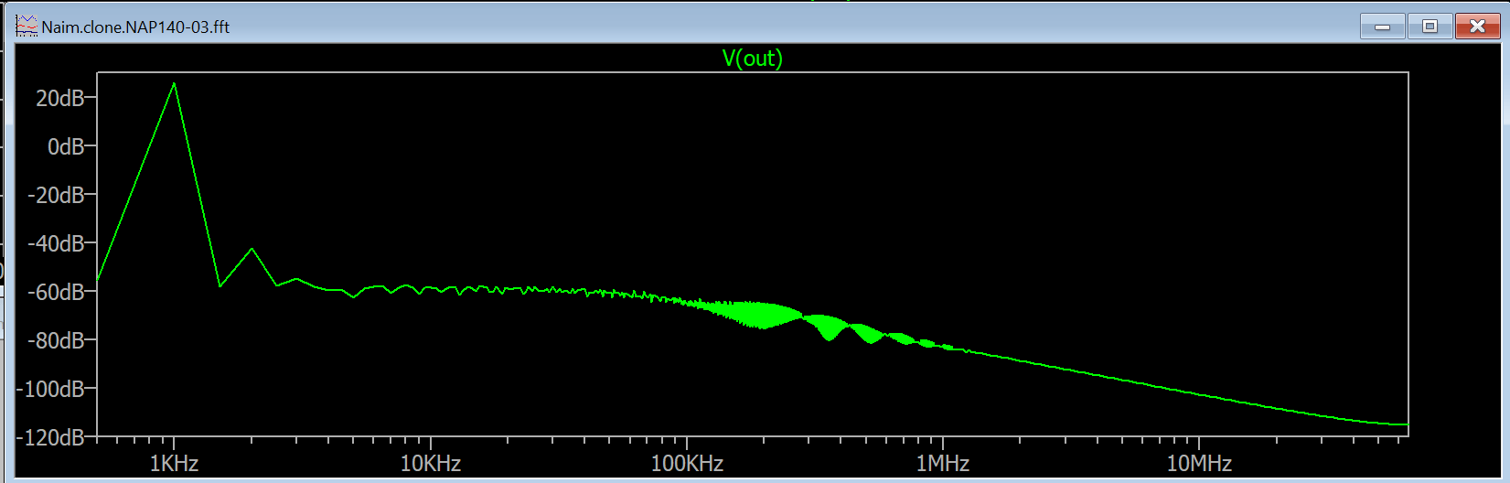

For information:
Look 0.2uf inductor. Perhaps 2,3 round cable. How important cable connections are!
Attached files are without inductor and with inductor. Ltspice simulation.
Using different power transistors, system may be more stable or not.
