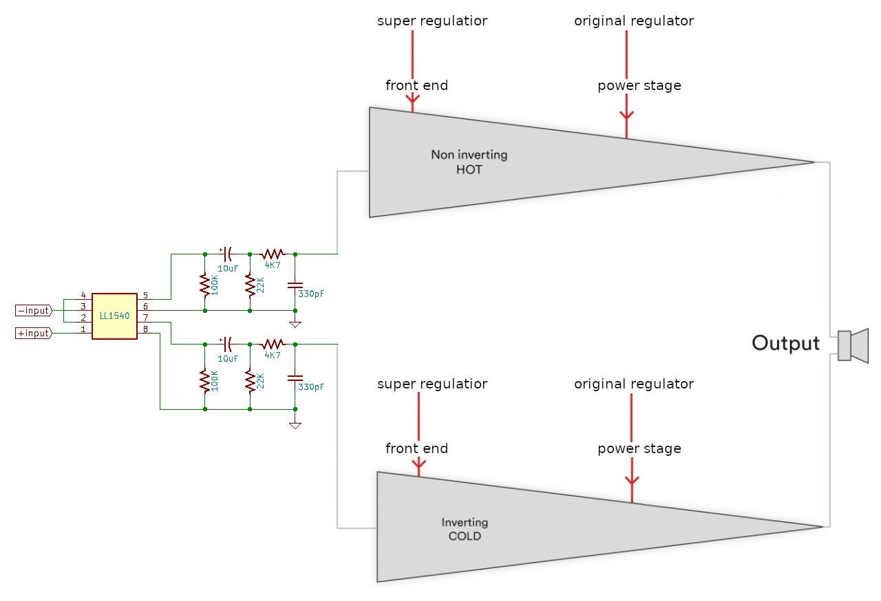

I studying yours photos and I think that nap500 it’s BTL nap300 and nap500 have more voltage lines on power supplyI am not so sure if it's just a bridged 135. There might be more into it...
Ian, I don’t think I would be an investor of capital in Naim right now. It has become blandocratic.
I can’t see anything special in your NAP500 block diagram. I’m not sure how they split the input signal into inverting and non-inverting; maybe a function of that x1 input buffer. Each amp has 4 “DR” blocks; high power for the output stage and low power for the rest.I am not so sure if it's just a bridged 135. There might be more into it...
What else do you think there might be?
The simple block diagram is my guess work. The official diagrams are from Naim white papers...
I remember that the 500 can deliver full power into almost a short, happily drives 2R and has extremely clean 0V returns because of the topology (see also here and here).
If it's just a BTL the PDIP8 could be the inverting circuit or phase splitter and the additional smaller PCB the protection circuit (or vice versa). If it's that simple, the attached diagram should work...? Or do we need to connect the feedback resistor to the opposite amp as shown in fig.1 here?

I would not do the ESL method for bridging. It’s one of those ideas that looks great to a toddler but has practical difficulties.
I would be surprised if the NAP500 works like this (unless Sells designed it <brutal, sorry>). Feeding one amp from the output of the other - let’s throw stability out of the window.

I think NAP500 build for very power acousticsI would not do the ESL method for bridging. It’s one of those ideas that looks great to a toddler but has practical difficulties.

Is it possible to take the inverted signal from the input LTP?
I guess it’s possible but not without difficulties. Easier to make an input buffer/phase splitter I would think, which feeds two identical amps.Is it possible to take the inverted signal from the input LTP?
