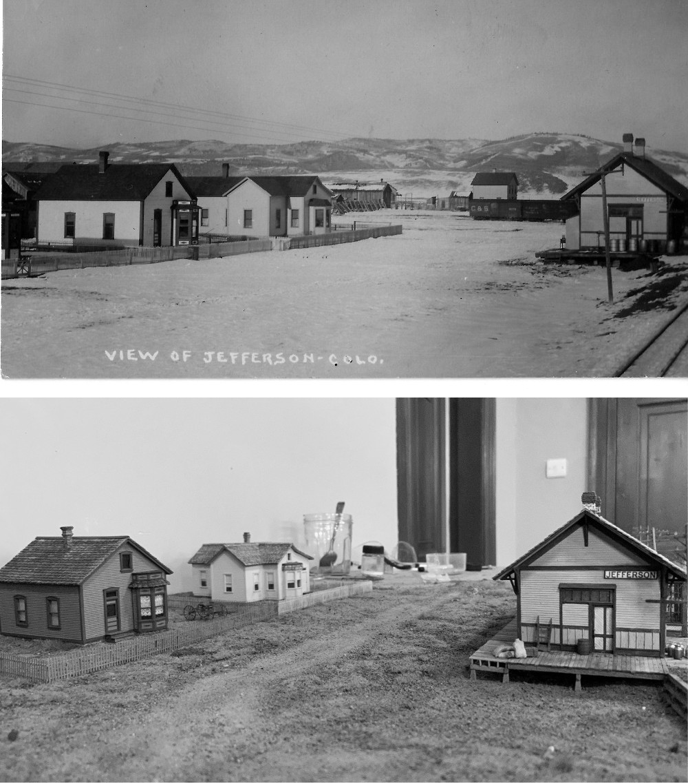

Here's a train picture for Traderbam.
At the risk of being seriously OT...
The grass and scrub is really impressive, it's so difficult to get that sort of thing to scale. Buildings and staging look great.
Congrats. Always thought that with most layouts the surroundings take much more time and care than track and rollingstock...
How big is the layout? Of a specific region, area? Or just a figment of your imagination...

The towns modelled will be Silica, Jefferson, Kokomo and Sargents, all in Colorado. Most buildings are historically accurate except for Kokomo (which was razed in the 50's). The layout is a 'G' shape, approx 17' x 15'. HOn3 scale.
I withdraw my sarcy quip! That’s masterful. Your attention to detail is impressive.Here's a train picture for Traderbam.

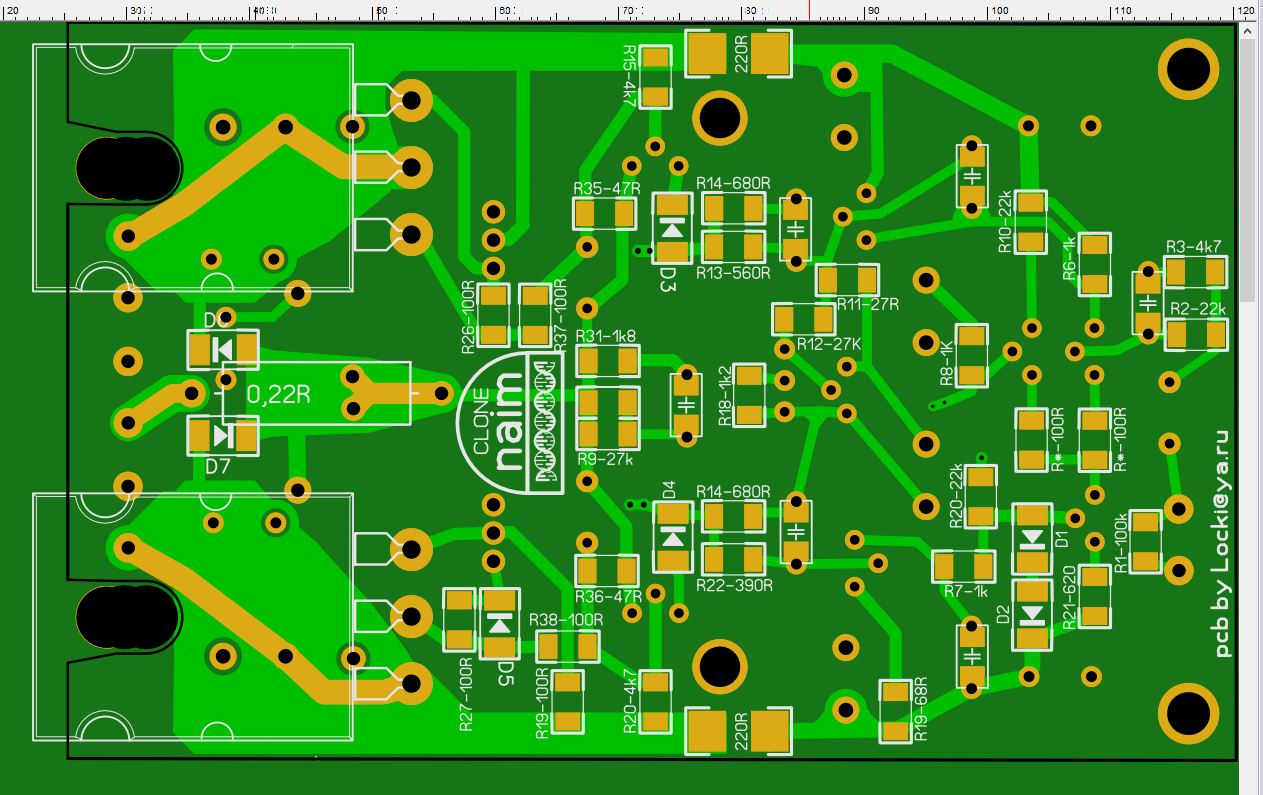

the sound of Naim is highly overrated. Perhaps then it was some kind of breakthrough, but now in stock, without some modifications, I could not listen to it. Namely, i replaced ceramics with wima film, tantalum with electrolytes by Elna silmik2 and raised the quiescent current of the transistor to 100mA
and yes, I agree that no clone will sound like an origigal (is it really necessary?) I need it as it became after my modification, my improvements.

If you aren't looking for the Naim sound (whatever that is) then there's really not reason to build a clone when there are so many other options available.
I found my clone was a bit too harsh sounding on my PMC floorstanders, which tend to be bright. It will never be my main amplifier but I like having it in the stable, it has a texture to the sound that is certainly not 'clean and neutral' (published reviews describe it well) plus I enjoyed engineering it to provide a more professional thermal management approach. I'm going to reduce the supply voltage to it at some point to bring it closer to stock.
Whoa! I am impressed. Serious stuff.
I once passed through near this area on Amtrak, and later by bus.
Looking for a little advice. I built a couple boards with spare parts I scrounged together, and used the stock schematic with the protection circuit intact. One functions perfect, the other has no gain. Both bias fine and have very low DC on the outputs but one just doesn't make gain in the VAS. All DC voltages are the same on both boards, the AC is the same in the LTP, and differs when it gets to the VAS where one simply fails. I thought it was a malfunctioning protection circuit that was dumping the voltage but i removed the two protection transistors and the problem remained. Should i replace the ZTX's? even though the DC matching implies they are functioning? Any guru have some advice?

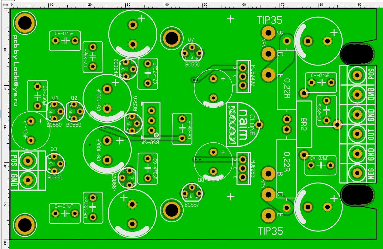

For building Nap 250 clone, what is the recommended transformer and capacitance ratings?
35v 500A toroid and 30,000uf is enough?

Ok! I have used 2N5551 and changed with ZTX108, then bias doubled. If they are similar transistors, how the bias doubled?
I'm not sure about what orjinal Q5 is ZTX108 or ZTX384? Or really doesn't matter 2N5551, BC550, BC239, 2SD786 or some other similar transistors? 😕
A pair of 2N5551s could easily be different enough to double the bias, and that's the same transistor. That's why there's a pot to adjust the bias.
500 amps should be enough. 😉
